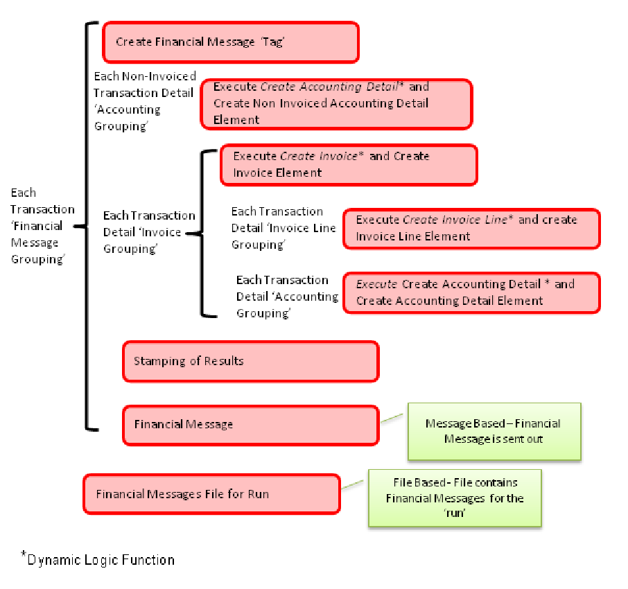

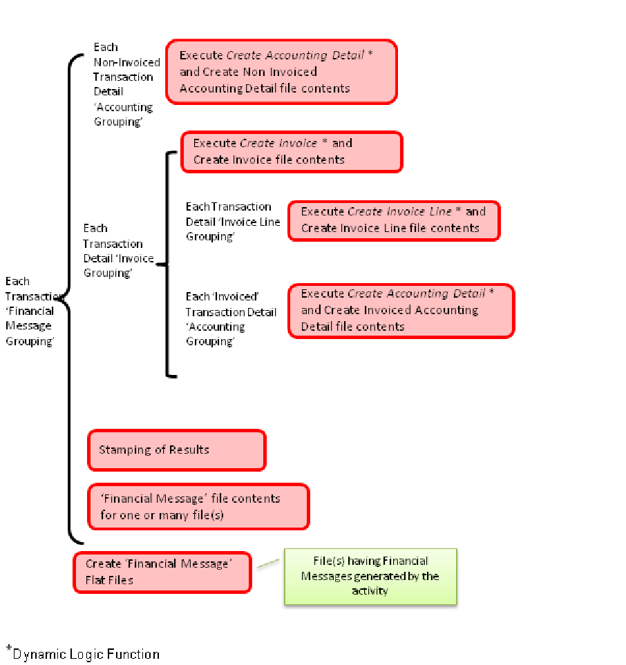

Processing
Financial Transaction Selection for Message Creation
This activity selects all the financial transactions for the message creation process that are:
within the financial transaction set
within the bounds of the specified activity parameters
not superseded

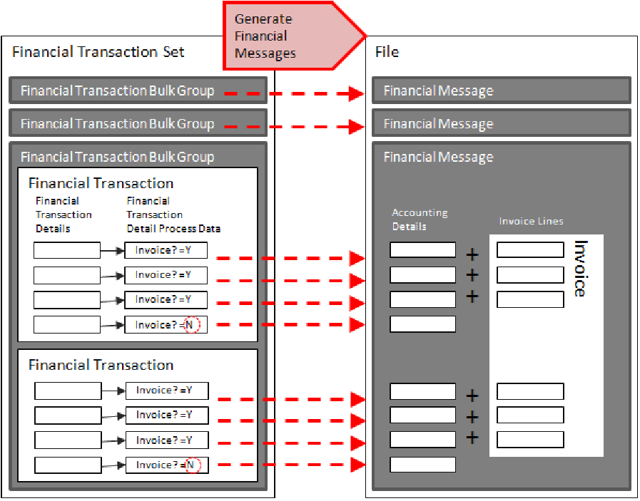

The next step is to group the financial transactions that are going out on the same financial message. The transactions are grouped as follows:
Transactions that have the same Financial Message Bulking Group label are grouped together. This label is an attribute on the financial transaction process data record. By default, this is set to contract code and financial transactions for the same contract code are grouped together into a single financial message.
Reversal transactions are automatically included in the same group as the next non-superseded financial transaction of the same base object.
For each resulting transaction group, the activity creates a single financial message. The image above shows an example of two transactions that are grouped into a single message. A financial message can include multiple invoices and accounting details. The activity recognizes invoices and accounting details as follows:
Financial transaction details on which the invoice indicator set to
Y
are mapped to invoice lines that are subsequently bundled together into invoices. One invoice is created for each distinct Invoice Bulking Group label. If this label is unspecified, all invoice lines within the message are bundled into a single invoice.By default, each financial transaction detail maps to a single invoice line, as shown in the image. It is also possible to have multiple details map to a single invoice line by setting the Invoice Line Grouping indicator to
Y
and specifying the same Invoice Line Bulking Group label on all the details that should be grouped into a single line. -
All financial transaction details are mapped to accounting details.
By default, each financial transaction detail maps to a single accounting detail, as shown in the image. It is also possible to have multiple financial details map to a single accounting detail by specifying the same Accounting Detail Bulking Group label on all the Financial Details that should be grouped into a single line.
The activity always separate accounting details for financial transaction details that are invoiced and financial transaction details that are not invoiced.
