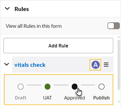

  7. If the rule generates the expected result for all scenarios:
    1. On the Rules pane, next to the rule's name, click the rule status icon to show the status slider.
    2. From the slider, select Approved as the new status.
      Tip:
      Make sure you move a Form or a Question in the Approved container. The rule will show only in the Design and Testing tabs. If you omit to move them, the Production and Training tabs will show the forms and questions incorrect as N/A.
      Click the menu icon (Menu icon) and select View to see a rule's details in read-only mode.
      The rule status slider displays below the rule name and allows you to select the next status: like from UAT to Approved.
    You can move the slider back to Draft at anytime.
