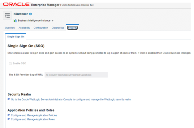

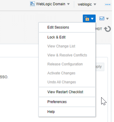

Disable Oracle Analytics Server 12c Enterprise Manager SSO authentication
With Oracle Analytics Server 12c, SSO authentication is enabled by default. For Oracle LSH users to access Analytics, disable the SSO authentication as described in the following procedure.
