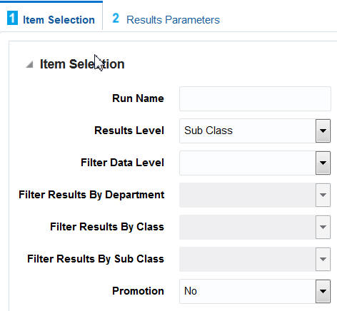

To create a custom run, select Create Custom Run from the Action drop-down. You see the Create Custom Run pop-up with two pages - Item Selection and Results Parameters. Need more info about recommendations to create a run.
Use the Item Selection page to select the items to include in the results, including the level of the results and the hierarchy nodes to include.
Provide a meaningful name for the Run Name that can help identify the run.
The Results Level defines the level of the hierarchy that the data is created for. Lower levels can require lower thresholds on the Results Parameters page (in order to find results), while higher levels can include too many results if the settings are not increased on the Results Parameters page.
The Filter Data Level is used to define rules regarding how to filter data. For example, if the results are only required for specific departments, then select Departments as the level and then select the departments.
A Promotion value of Yes only includes results in which the If component was on a promotion. A value of No is used when there is no concern about whether a promotion was present or not.
After entering item criteria, click Add Item Selection. The bottom section of the screen is populated with the results of the selection. You can also see this information in the right panel.
