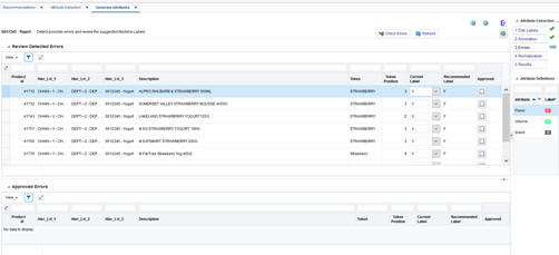

Errors Tab
The Errors tab is used to review the instances where the current attribute type assigned to a token is different from the attribute type recommended by the machine. You can review these potential user errors and fix them if needed. For each instance, you can take one of the following actions:
Table 6-7 Error Tab Actions
| Action | Description |
Approve the Recommended Label |
Check the Approved check box to approve the Recommended Label. The approved instance will be moved from the top table to the bottom table. You can use the check box in the bottom table to undo the approval. |
Change the Current Label |
If neither the Current Label nor the Recommended Label is correct, use the drop-down list to change the Current Label. Do not check the Approved check box in this case. If the Current Label is correct, no action is needed. |
It is recommended that you review the errors after you complete the annotation step and extract the attributes. However, you can navigate to the Error tab at any time to review the errors and change or approve the labels for some or all instances.
