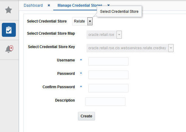

Credential Store
You can use the Manage Credential Stores screen, shown in Figure 19-1, to maintain ORCE credentials in the application.
Figure 19-1 Manage Credential Stores
Description of Figure 19-1 follows
Description of "Figure 19-1 Manage Credential Stores"
Enter the following information into Manage Credential Stores:
Table 19-4 Manage Credential Stores Information
Field Description
Username
Credential username created by ORCE to enable integration
Password
Credential password (at least one character) created by ORCE to enable integration
Confirm Password
Confirm password
Description
Credential store used for Customer Segment integration with Oracle Customer Engagement

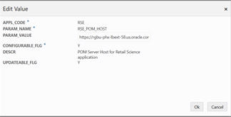

POM Server Detail Configuration
To ensure AIF application to Retail Insights integration configuration is correct, verify RSE_CONFIG configuration for POM Server details.Select Control & Tactical Center > Strategy & Policy ManagementFilter APPL_CODE as "RSE" and PARAM_NAME as "RSE_POM_HOST". Determine if the value set as part of the deployment is correct. If the host is not correct, update the entries.
Figure 19-2 Edit Value
Edit Value
