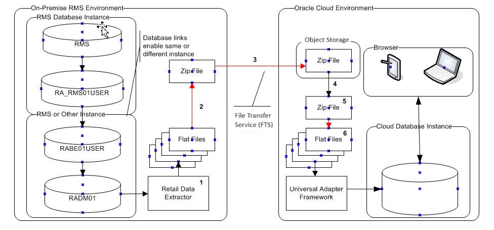

Batch Process Flow
Figure 20-1 illustrates the batch process flow.
Here is the process.
The on-premise batch shell script extracts data to files initiated by the customer scheduler.
Merch batch script creates the zip file named RI_RMS_DATA.zip. Additionally, zip files named RI_CE_DATA.zip and RI_MFP_DATA.zip should be created.
You should upload the three zip files to Object Storage using File Transfer Service (FTS).
Once the file is in Object Storage, the cloud service batch processing will retrieve the files from Object Storage after they have passed an anti-virus and malware scan.
The batch load process begins with tasks that
Archive the files that have been received in a date/time stamped directory.
Perform the presence validation exercise that verifies that all expected files for the customer's subscribed applications in the zipped files. This terminates if any expected files are missing.
Clear the previous day's files from the $MMHOME/data/staging directory.
Unzip the zip file into the $MMHOME/data/staging directory.
