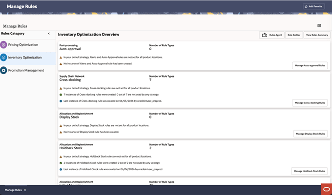

Figure 11-3 Inventory Optimization
Manage Rules screen
