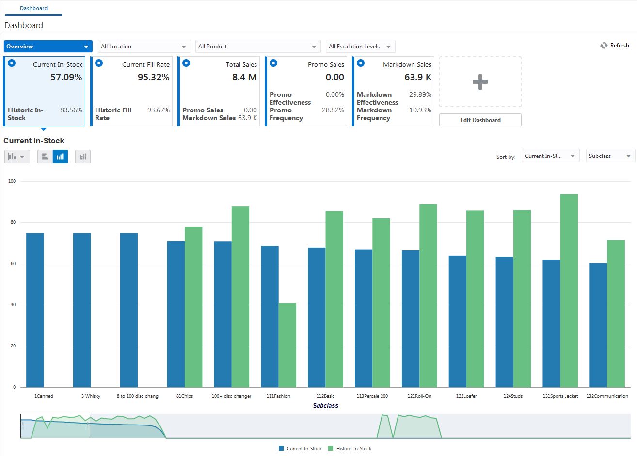

Overview Dashboard
There are five GA tiles in the Overview dashboard.
Figure 2-4 Overview Dashboard
Overview Dashboard
This view has a dual Y-axis and the scales of the Y-axes could be different from each other.
Current and Historical In-stock Rates
The first tile displays information about how often stockouts occurred. If every four weeks, a stockout is registered, the in-stock rate would be 75%. This information is driven by how often stockouts occur. The tile displays current and historical fill rates.
Stockouts
The second tile displays information about the current and historical fill rates, which are related to service levels. This information is directly tied to the amount of lost sales caused by total or partial stockouts.
Breakdown of Sales
The third tile shows the breakdown of sales. The total sales are the sum of regular, promotional and markdown sales. The promotional and markdown sales are displayed as secondary metrics to gauge the amount of sales driven by these extraordinary events.
Promotional and Markdown Sales
The last two tiles display information about promotional and markdown sales. Besides the total units, additional information is displayed as secondary metrics. For instance, the tiles display how often the merchandise are promoted or marked down, as the promo or markdown frequency. Also, it shows the effectiveness of how promoting or marking down merchandise is increasing demand as compared to regular demand.

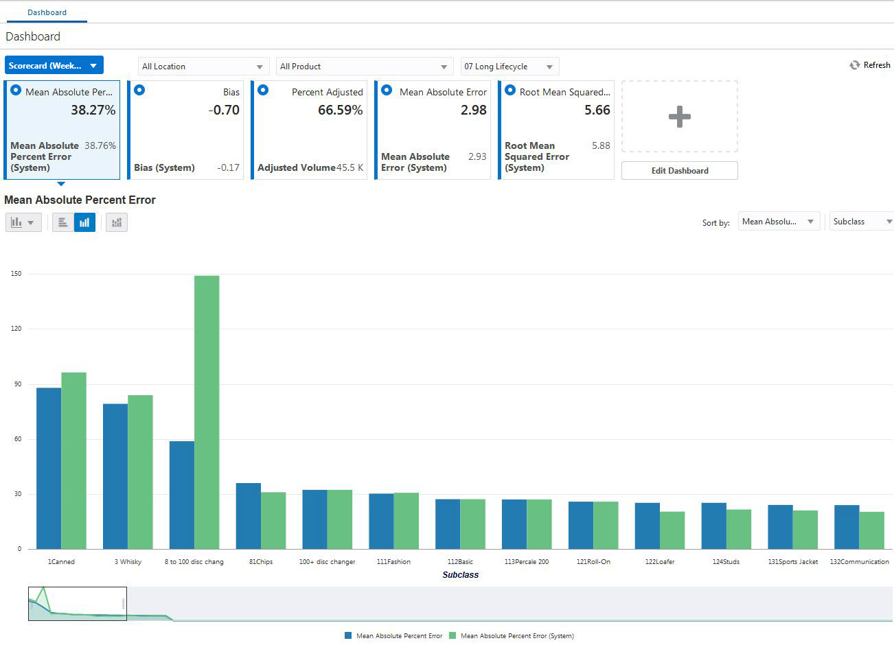

Forecast Scorecard Dashboard
The information displayed in this dashboard helps the forecast analyst or forecast manager determine how accurate the forecasts are.
Figure 2-5 Forecast Scorecard Dashboard
Error Metrics
These are the error metrics:
  • Mean Absolute Percentage Error
  • Root Mean Squared Error
  • Mean Absolute Error
  • Forecast Bias
  • Percent Adjusted
The error metrics are detailed in Appendix: Forecast Errors in the Forecast Scorecard Dashboard. They are calculated for both the user-adjusted, as well as for the system-generated forecasts, allowing a fair evaluation of the performance of the analyst versus the system.
Forecast Bias
Another tile is dedicated to the forecast bias, a useful metric in determining if the forecast is consistently over or under the actual demand.
Percent Adjusted and Adjusted Volume
Finally, there is the Percent Adjusted tile, with the Adjusted Volume as the secondary metric. Here is displayed the percent of adjusted forecasts, and the volume resulted as the result of the adjustments. For instance, if the percent adjustment is high, but the adjusted volume is not significant, the analyst may want to spent time and effort on other areas of the merchandise.

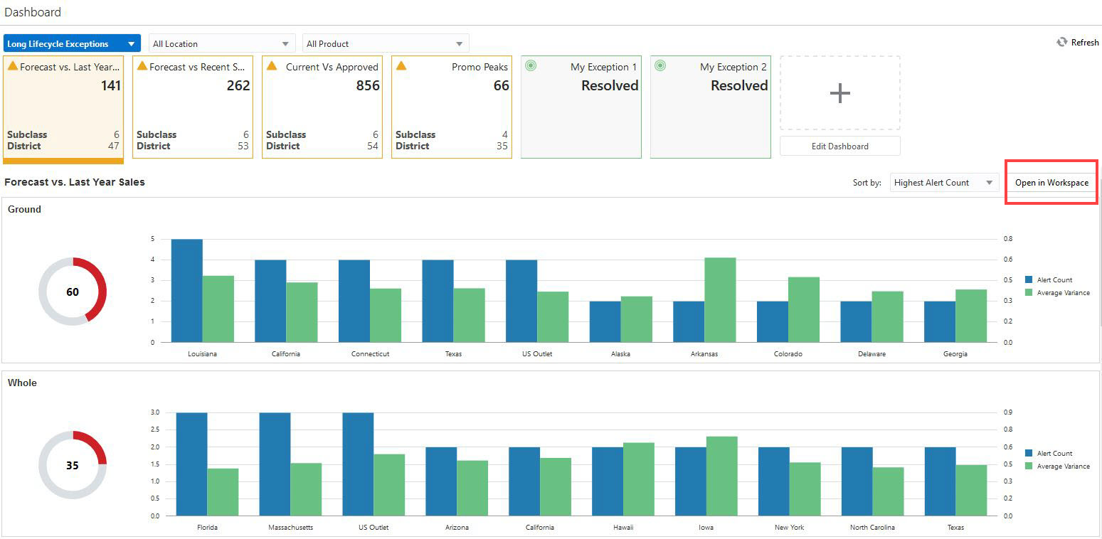

Approval Alerts
This is the exception profile that shows the result of the approval business rules.
Figure 2-6 Approval Exceptions
Approval Exceptions
Exceptions
The information displayed in the tiles is based on exceptions, or business rules defined to check if the forecasts are within bounds with respect to some thresholds. The exceptions definitions and expressions are detailed in Appendix: Forecast Approval Exceptions.
Number of Hits Count
The main metric in the tiles is the number of hits count which is based on the product and location filter settings. If the filter settings range products and locations to a narrower selection than, All Product and All Location, then the number should be reflected in the tile; that is, it should decrease.
Number of Subclass and Districts
The secondary metric on the tiles display the number of subclass and districts that are affected. Note that the dimensions are configurable.
Charts
Each tile comes with a set of charts where the hit count information is broken down to lower levels and sorted based on hit count, or average variance.
The average variance represents how much off the forecast is versus its target. For example we compare the forecast against last year sales. If the sales are 10 units and the forecast is 15 units, the variance is 5 units. The average variance is the average of all the differences between forecast and last year sales.
The hit count represents how many times the forecast did not pass the configured business rules. The average variance represents by how much the forecasts were off. This is useful, because if a subclass is heavily alerted, but the forecasts only barely miss the threshold, the user may want to concentrate on other merchandise, potentially less alerted, but where the forecasts were off by a larger amount.

Forecast Review Workspace
Finally, when a user makes a decision as to which merchandise and locations to review, the user can launch directly in the Forecast Review workspace by clicking Open in Workspace, with the locations and product ranged down to the desired selection. Once in the workspace, you can choose to use the navigation alerts to navigate to product/locations. Every navigation exception can have a workspace counterpart. Using these exceptions you are guided to the exact product, location, and time period that needs your attention.
The Open in Workspace button is located in the right corner above the top chart
Alternatively, you can right-click on any exception chart and select Open in Workspace
