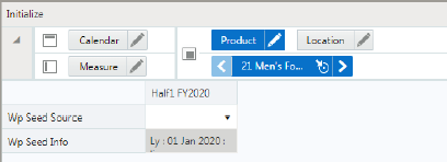

Seed Plan Sub-Step

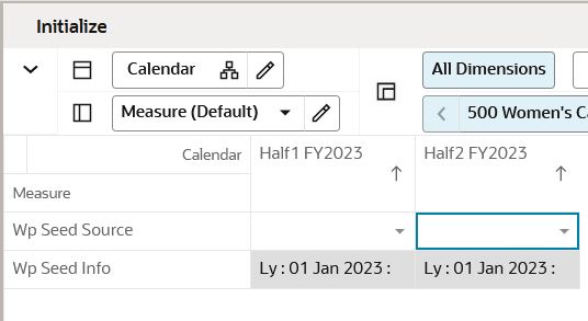

The first action to take when creating a new plan is to seed the plan.
Initialize View
With this view, you can choose to seed your plan Last Year (Ly), Forecast (Fcst), or Targets (Tgt) data to create a demand curve on which to initially spread the new plan. Or, you can instead choose to not seed the plan, which allows you to create a plan that is not influenced by last year's performance or forecast (plus last year's performance).
Figure 11-1 Create Plan - Seed Plan Initialize
Table 11-1 Create Plan - Seed Plan Initialize Measures
| Measure | Description |
Wp Seed Source |
The seed source used to seed the working plan. Use this option to seed or not seed the working plan. You can seed with Last Year's (Ly) or Forecast (Fcst) data. Alternatively, choose the Blank option if you do not want to seed the working plan. |
Wp Seed Info |
Includes a few pertinent facts about the last time that the Seed custom menu was executed: last seed source concatenated with last seeded date and the last user to seed. If blank, then the given intersection has never been seeded. |

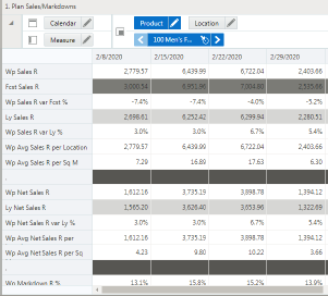

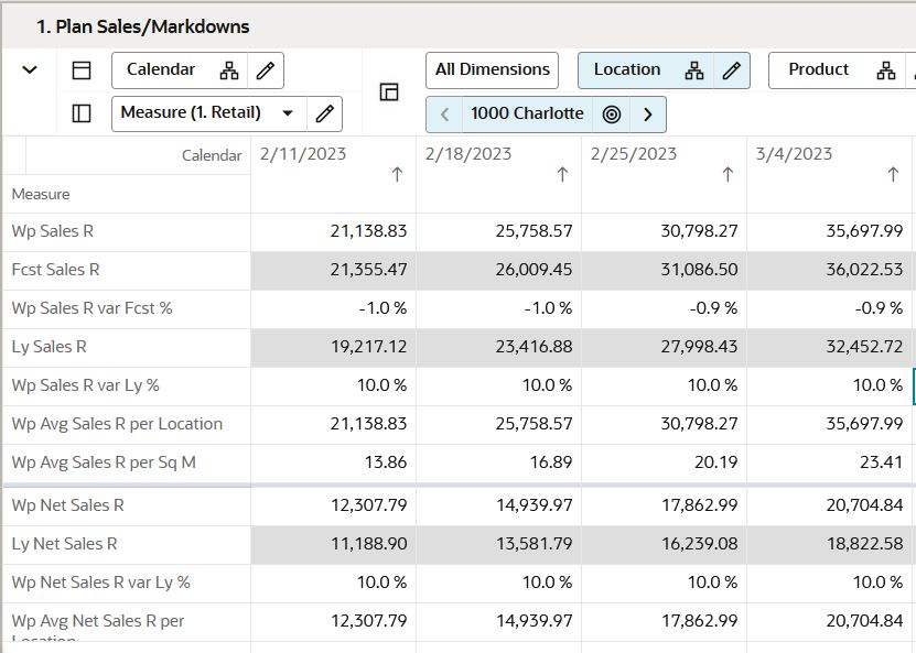

Sales and Markdowns Sub-Step
After seeding, you can verify the seeded sales and markdown data in this view.
Figure 11-2 Plan Sales/Markdowns View

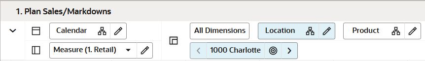

You can verify the seeded sales and markdown data in this view. After you have seeded, develop the sales, and markdown location plan for those departments.
If you are planning a Wholesale/Franchise location, use this view to plan Net Sales. Then use the W/F Sales and Markup View to complete planning.

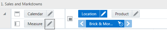

There are several measure profiles available to logically guide you through the plan variables.
A measure profile is selected by clicking the Edit View button next to the Measure tile.
Figure 11-3 Location of Edit View Button
The following measure profiles are available:
Retail (Default)
The sales measure profile shows the key sales planning metrics including sales, net sales, and returns.
To use the Average Sales/Net Sales/Returns Per Location measures to see averages, you must rollup the Location Dimension to a level above Location. The average calculated is limited to the average of the active locations of the workspace segment. A segment with one location will have an average equal to the Wp. In the same way, a dimension with only a single location which rolls up to it will also have an average equal to the Wp.

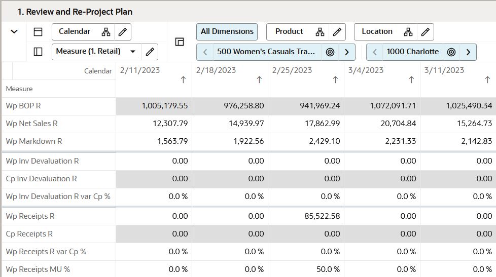

Plan Receipts/Inventory View
After you have developed the sales and markdown plan, develop a receipts and inventory plan that can support the sales and markdown plan. The purpose of this step is to ensure that you have a receipt and inventory plan that supports the sales that you are projecting. Like the Plan Sales and Markdowns view, the Plan Receipts/Inventory view contains several Ly metrics that you can reference when setting your targets. Additional measures can be used to adjust your inventory targets.

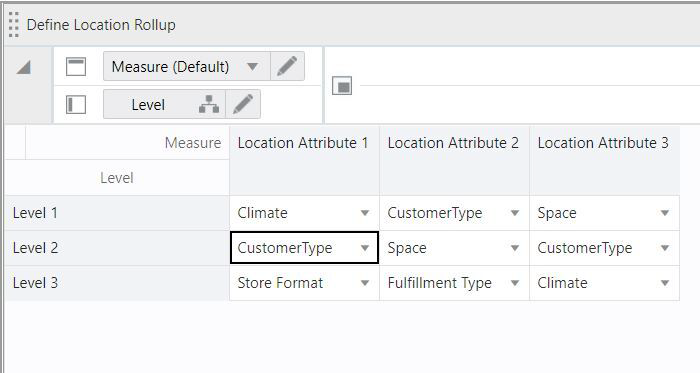

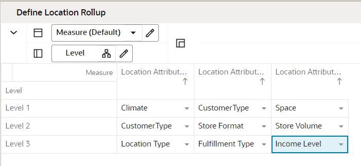

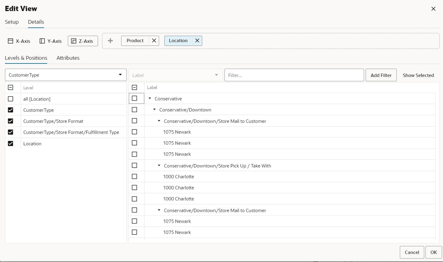

Define Location Rollup
The Define Location Rollup view is used to select location attributes to view in an alternate hierarchy. Nested location attribute roll up is provided with three levels. A planner can set up to three different combinations for nested rollup with a maximum of three levels in each combination. Nesting of dynamic attributes is a configurable option. For example: As a first combination, you select Climate as a Level 1, Customer Type as Level 2, and Store Format as Level 3 by clicking the list of attributes available. This allows you to roll up your location by Climate, then Customer Type inside each Climate and then by Store Format inside each customer type. This feature also allows you to view subtotals for each of the levels. You can edit subtotals and spread the values to all the associated child positions.
Perform the following steps to complete this process:
Select up to three dynamic location attributes from the list.
Run the Refresh Location Rollup Application Action.

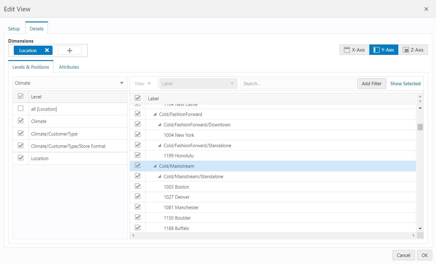

To view the location attribute:
In a view that displays location level, click the Location Hierarchy tile.
Select the attribute (Attribute 1 or 2 or 3) that you would like to view in the nested dynamic rollup.
Click OK.
Figure 11-4 Define Location Rollup
Figure 11-5 Edit View
Table 11-3 Define Location Rollup View Measure
| Label | Definition |
Location Attribute 1, 2, 3 |
List to present location attributes for nested dynamic product hierarchy rollup |

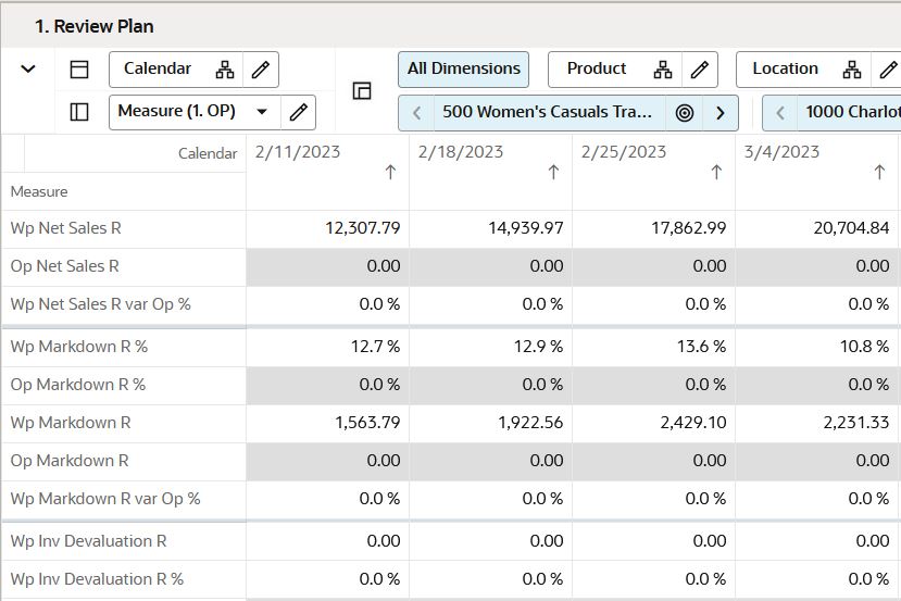

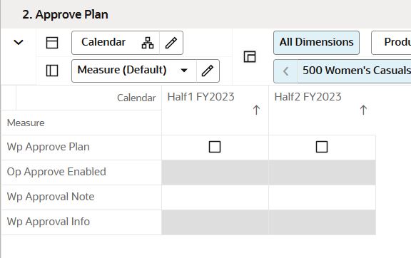

Review and Approve Step
In this step, the location planner can review and approve the created location plan. The Review and Approve step contains two views: Review Plan and Approve Plan.

Review and Reconcile with MFP Sub-step
In this step, review and compare your plan to ensure the goals set forth in the Merch Plan are being met. This sub-step has two views:
Review and Reconcile View
Define Location Roll up View
Use the MFP OP and the MFP CP measure profiles to reconcile your location plan to the Merch Plan.
Define Location Roll Up View
Click OK.

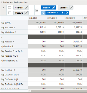

Review and Re-Approve Step
Use this step to review the location plan during in-season for On Order and Open to Buy and to update the plan and reapprove if necessary. The Review and Re-Approve step has two views: Review and Re-Project Plan and Approve Plan.
