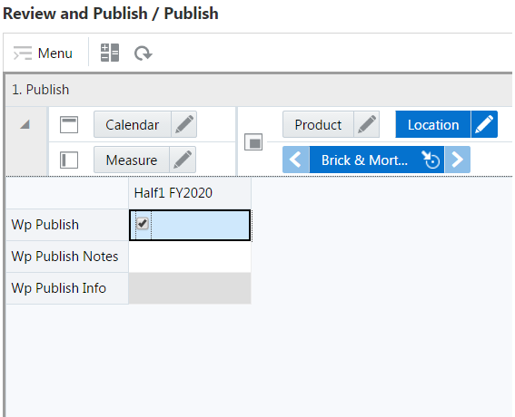

Publish Sub-Step
This sub-step is performed when the targets are completed for all locations in a channel.
Publishing a target copies the targets you built in the Wp measures to the target (Tgt) measures, and then commits then to the database. Once committed, Location Planners can retrieve those targets and take action planning to them.
The Tgt measures are shown in the Review Targets view found in this sub-step. These measures initially have zero values. After the targets are published in this step, those measures are populated with the target information.
Publish View
To publish the targets:
  1. Place a checkmark in the Wp Publish Targets measure for the halves that you want to publish.
  2. If desired, enter relevant information in the Wp Publish Notes measure. This is optional.
  3. Repeat Steps 1 and 2 for other channels as desired.
  4. Click Publish Targets. This button is located in the bottom right corner.
  5. A success message is displayed. Click Dismiss to close it.
    The view refreshes and clears the data in Wp Publish Targets and Wp Publish Notes measures. The action has populated Tgt Publish Info with name:date:notes.
Figure 10-5 Publish View
Publish View

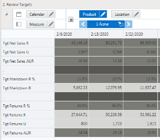

Review Targets
This view can be used to verify and review the currently published targets. The targets in this view are static and not editable. Changes to targets must be executed in the Wp plan and then published into the Tgt version.
If plans have been published or republished since you created the worksheet, click Refresh to reload the latest values. A refresh will reload all data in the worksheet to the last committed version.
Figure 10-6 Review Targets View
Review Targets View
