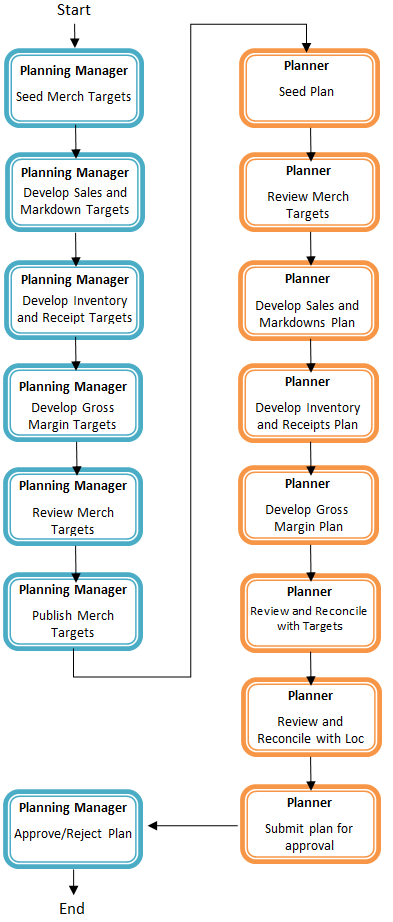

Merch Planning Process
The Merch planning process can be separated into two sub-processes: pre-season and in-season planning. Creating the merchandise financial plan occurs during pre-season planning. Managing and updating the merchandise financial plan occurs during in-season planning. Pre-season planning focuses on creating the Original Plan (Op) against which to benchmark in-season progress. In the pre-season process, the plan is initialized by seeding from Last Year (Ly) or from a forecast. This seeding gives users a curve of demand against which to spread their new plan. Users then plan sales, receipts inventory, turn, and gross profit measures.
There are two types of users in merch planning:
Planning Managers. These users are planning directors or managers. They create the overall targets for the Merch Plan.
Planner. These users are the merchandise planners. They create Original Plans (Op) and Current Plans (Cp) for approval by the Planning Managers role.
The targets are published by superior levels to the subsequent level: Planning Managers pass targets to the Planner. The Planner then submits the Op, Cp, or both to the Planning Manager for approval. The Op and Cp plans are not created until they are approved by the Planning Manager.
This process is shown in Figure 1-1 and Figure 1-2.
Figure 1-1 Create Merchandise Financial Targets and Plan Process

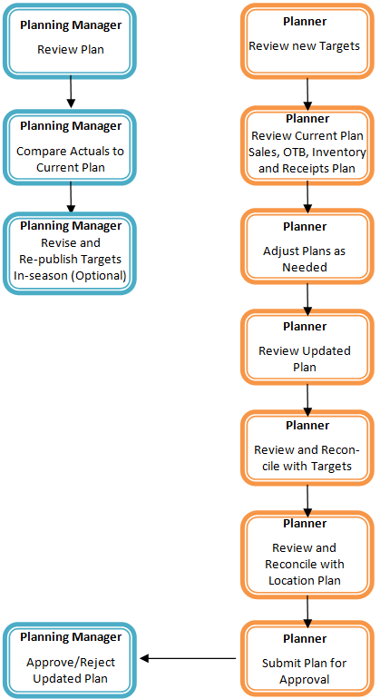

After the planning period has begun, the process of in-season planning begins. The objective of in-season planning is to track progress against the original plan in order to identify opportunity and risk for the Original Plan (Op).
Figure 1-2 Manage/Update Merchandise Financial Plan Process

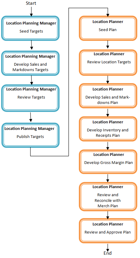

Location Planning Process
The Location Planning (LP) process is also separated into two sub-processes: pre-season and in-season planning. Creating the location plan occurs during pre-season planning. Managing and updating the location plan occurs during in-season planning. Pre-season planning focuses on creating the Original Plan (Op) against which to benchmark in-season progress. In the pre-season process, the plan is initialized by seeding from Last Year (Ly) or from a forecast. This seeding gives users a curve of demand against which to spread their new plan. Users then plan sales, receipts inventory, turn, and gross profit measures.
There are two types of users in LP:
Location Planning Manager. This role may be performed by location planning managers or location planners, meaning that the location targets and plan may be created by the same user. This role's task is to create a target version of Sales/Markdowns that is corrected for non-repeating events such as store closures, bad weather, construction, and so on, at a total company level. These are passed down as targets to the location planner.
Location Planner. This role is often performed by the same user as the merch Planner. This role's task is to create Op and Current Plans (Cp) at the lower, department level. The total sales, markdowns, and so on are planned through the use of average store metrics, using a number of user-defined hierarchies with location attributes (such as comp, volume, size, climate, and demographics).
The targets are published by superior levels to the subsequent levels: top location targets pass targets to the location plan. The location plan self-approves the Op, Cp, or both. Once the working plan is approved, it is promoted to either the Op or Cp.
This process is shown in Figure 1-3 and Figure 1-4.
Figure 1-3 Create Location Targets and Plan Process

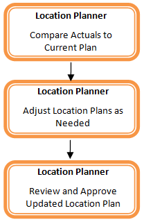

Figure 1-4 Manage/Update Location Plan Process

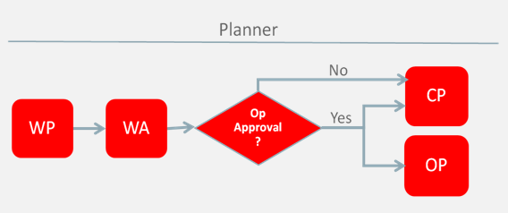

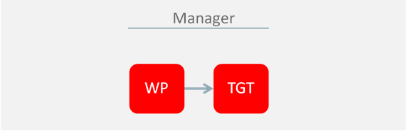

Plan Versions
MFP Cloud Service provides the capability to have more than one version of the plan. This allows users to track actual data against the original plan, update the plan for the current season, and save to a new plan.

Target (Tgt)
Target measures contain values set by a higher role that are then passed to a lower role. For example, the Planning Manager role passes a target plan version down to the Planner role.
Targets are created from Wp by way of the Publish Targets custom menu, which is executed by the Manager role. After the data is committed to the database, those targets become available to the Planner role.
Waiting for Approval (Wa)
A plan awaiting approval by the Planning Manager. The Planner submits Wp for approval, which copies the plan data from the Wp version to the Wa version.
The Planning Manager and Planner access the same Wa version. The Planner owns this version, and the Planning Manager reads from this version to approve or reject the plan. The Wa version is read-only for both roles.
If the plan is approved, the user must execute a copy to promote the now approved, Wa plan. A Waiting for Approval plan is promoted to either the Original Plan (Op) version, the Current Plan (Cp), or both the Op and Cp, depending on whether Op Approval is enabled by the administrator.
If the plan is rejected, the Working Plan (Wp) version is not promoted to Original Plan or Current Plan. Needed adjustments are made before the plan is resubmitted for approval by the planner.
Original Plan (Op)
A pre-season plan that has been approved and promoted from Waiting for Approval (Wa) to Original Plan (Op) version. This plan is considered the budget.
The planner's plan is the only plan that is approved and becomes the Original Plan (a manager plan becomes the Target).
All roles can view the Op version measures.
Current Plan (Cp)
Cp starts out identical to the Original Plan. Then, actual data values are loaded into the Cp (and Wp) version for historical (elapsed) time periods.
When an in-season plan has been approved, it is promoted to Cp (and not Op).
All roles can view the Cp version measures.
The planner's plan is the only one that is approved and becomes the Current Plan.
Figure 1-5 Plan Versions Created by Manager
Figure 1-6 Plan Versions Created by Planner

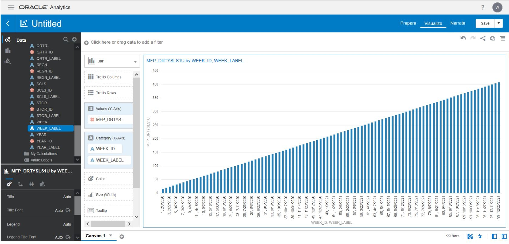

For example you can analyze in MFPCS, Last Year versus working plan sales data along with returns and markdown to make quick decisions.
You can view example reports of Sales/Margin and Inventory to get the initial view on the DV report. Import these two reports in the DV tool for reference:
MFP Sales Test report.dva
MFP inventory report.dva
Access these two DV reports from the Oracle Retail Predictive Application Server (RPAS) Cloud for Planning and Optimization / Supply Chain Cloud Services Documentation Library (Doc ID 2492295.1) located on My Oracle Support. For more details on creating reports or importing reports, refer to Visualize Data within Oracle Analytics Cloud.
For more details on creating the report OAT task, refer to the Oracle Retail Predictive Application Server Cloud Service Administrator Guide.
For more details on the Data Visualization Set up, refer to the Oracle Retail Predictive Application Server Cloud Service Implementation Guide.
Figure 1-7 Data Visualization Reports
