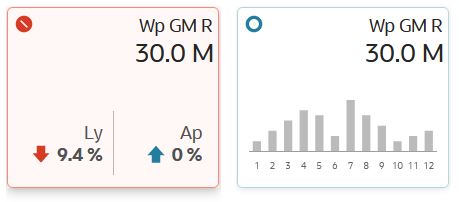

There are various styles of tiles-variance and informational.
Variance
A variance tile shows the variance between one quantity and two others.
Informational
An informational tile displays the existing measure data.
Figure 2-1 Variance and Information Tiles
The color and icon of a tile give a visual indicator of the state or health of the metrics in the tile. In the figure above, WP Sales R is showing a red octagon (a problem) because the working plan sales value is 9.6% below Last Year sales. An informational tile is always green indicating no problem because it is simply showing data, not a comparison.

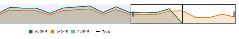

Time Horizon and Scale
The time horizon used to calculate the metric of each tile can be changed either in the drop-down list selection above the tiles, or by dragging the time horizon window at the bottom of the chart.
Figure 2-2 Time Horizon Window
