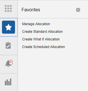

Favorites
You can select your favorite tasks without accessing the Tasks menu. It helps you quickly get into your frequently used tasks.
You can click the Favorites icon in the Tasks menu to access tasks designated as favorites. You can also select the cog icon from the Favorites menu to edit the favorite list. Tasks can be selected or deselected as favorites in the Tasks menu.
Figure 3-3 Favorites Area
Favorites Area

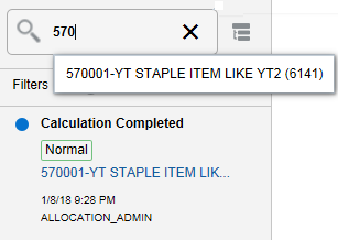

Search Bar
A search bar at the top of the panel allows for searching through notifications. The search bar has auto-suggest enabled, so it displays notifications as the user types.
Right next to the search bar is the 'List/Group' view toggle button. This causes the Notification results to be displayed either in a flat or grouped view.
Figure 3-8 Search Bar
Search Bar

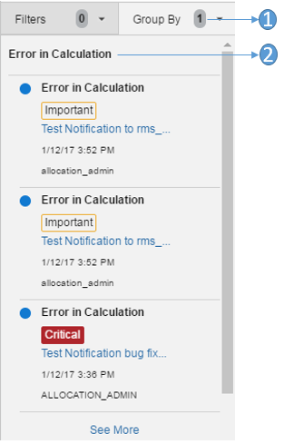

Results Panel - Grouped View
Notifications are displayed in a grouped format within the Results Panel, when the Group By drop-down in the Grouping Panel is selected.
Notifications are displayed in groups with three notifications shown for each group.
Figure 3-12 Results Panel - Grouped View
Results Grouped View
  1. Indicates the Group-By drop-down is selected on the Grouping Panel.
  2. The value of the Group-By attribute. In this example, the results were grouped by Notification Type. Hence the Notification Type is shown as the header of the group.
For each group, three notifications are shown, followed by a 'See More' link. When you click this link, up to 25 notifications are displayed for that group.

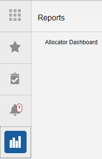

Reports
The functionality of Reports works similar to the Tasks menu.
Figure 3-16 Reports Menu
Reports Menu

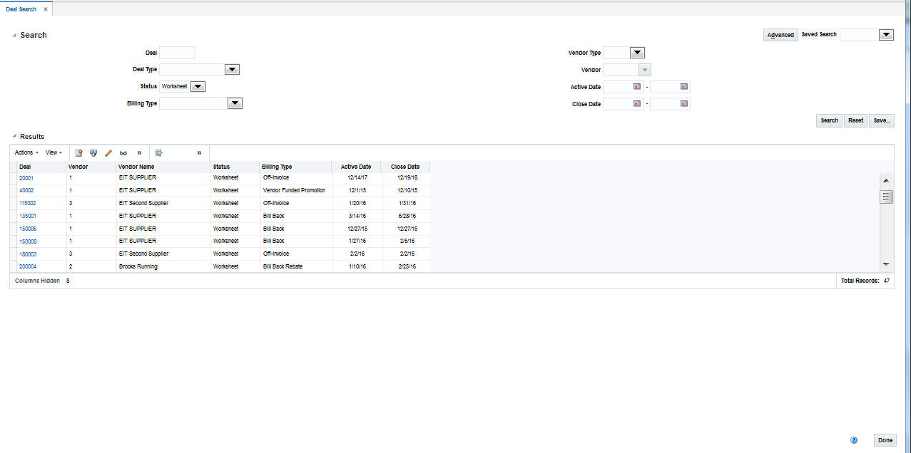

Table Level
Table Menu Options
  • Deals is used as an example which is specific to the Oracle Retail Merchandising, and may not be relevant to this application.
  • Figure 3-18, Figure 3-19, Figure 3-20 are mere representation and may be different for every window/table/popup.
The Actions menu, View menu, and icons are displayed in the form of a table. For more information on these options, see the sections Action Menu and Icons and View Menu.

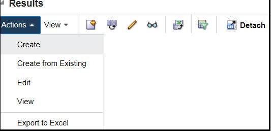

The Actions menu provides the option to take different actions related to entries in the table. Depending on the nature of the table, these actions can be add, view, delete or edit table rows, create by moving to a new screen or export the table contents to the spreadsheet. Alternatively these actions can also be performed by using the icon buttons on the table toolbar. For more information on the icon/buttons, see the Screen Level Action - Icons and Buttons.
In some tables, it may also contain some table specific actions.
Figure 3-18 Actions Menu and Icons of Components Section
Actions Menu
Table 3-2 Actions Menu/Icons and Descriptions of Components Section
Actions Menu/Icon Description
Add and Add icon Add icon
You can add a deal component by clicking Add from the Actions menu or by clicking the Add icon Add icon.
Edit and Edit icon Edit icon
You can edit a deal component by clicking Edit from the Actions menu or by clicking the Edit icon Edit icon.
Delete and Delete icon Delete icon
You can delete a deal component, by clicking Delete from the Actions menu or by clicking the Delete icon Delete icon.
Export to Excel icon Export to excel icon
You can save the table to a Microsoft Excel spreadsheet by clicking the Export to Excel option from the Actions menu or by clicking the Export to Excel icon Export to Excel icon.

Figure 3-19 Actions Menu and Icons of Managing a Deal
Icons and Managing a Deal
Table 3-3 Actions Menu/Icons and Descriptions of Managing a Deal
Create and Create icon Create icon
You can create a deal by clicking Create from the Actions menu or by clicking the Create icon Create icon.
Create from Existing icon Create from exist icon
You can create from an existing deal by clicking Create from Existing from the Actions menu or by clicking the Create from Existing icon Create from exist icon.
You can edit a deal by clicking Edit from the Actions menu or by clicking the Edit icon Edit icon.
View and View icon View icon
You can view a deal by clicking View from the Actions menu or by clicking the View icon View icon.
Wrap icon Wrap icon
You can wrap the values in the table column by using the Wrap icon Wrap icon option.

Search for a Deal Through the Basic Search Criteria
To search for a deal through the basic search criteria:
  1. Enter or select one or all of the following basic search criteria.
    Table 3-5 Basic Search Criteria
    Search Field Description
    Deal
    Enter the deal ID.
    Deal Type
    Select the deal type. The options are: Annual, Promotional, PO Specific, and Vendor Funded Markdown.
    Status
    Select the status of the deal. The options are: Worksheet, Submitted, Approved, Rejected, Closed.
    Billing Type
    Select the type of deal being created. The options are: Off invoice, Bill Back, Bill Back Rebate, Vendor Funded Promotion, Vendor Funded Markdown.
    Vendor Type
    Select the vendor type.
    Vendor
    Enter, select or search for the vendor.
    Active Date
    Enter the date on which the deal becomes active, or click the calendar icon and select the date.
    Close Date
    Enter the date on which the deal ends, or click the calendar icon and select the date.
    Figure 3-21 Search Section in Basic Search Mode
  2. You can also click on the Saved Search drop down to select one of the saved sets of search criteria. Selecting a saved search will populate the criteria section with saved criteria. If the saved search is selected to run automatically then the search will be executed too. You can also choose to manage and personalize the saved searches by clicking Personalize in the list. The Personalize Saved Searches window appears. For more information on the Personalize Saved Searches, see the section Personalize Saved Search.
  3. Click Search. The deals that match the search criteria are displayed in the Results section.

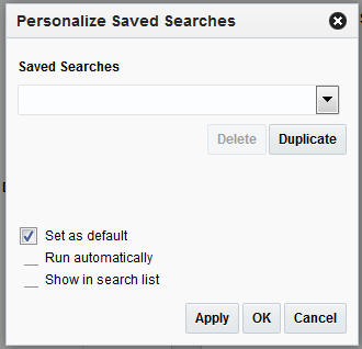

Select Personalize from the Saved Search list to view the personalized saved search. The Personalize Saved Searches pop up allows you to edit, copy, or delete Saved Searches.
Figure 3-24 Personalize Saved Searches Window

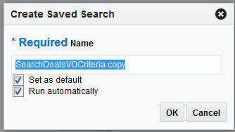

Create Saved Search
You can create a Saved Search by selecting the Save button in the Search Criteria panel after you have entered the criteria for your search. The Save button will call up the Create Saved Search window where the search is given a name and the user determines whether it should be the default search as well as whether it should be run automatically.
To view the created saved search:
  1. Click the Save.. button. The Create Saved Search window appears.
    Figure 3-25 Create Saved Search Window
  2. Enter the name of the search.
  3. You can also choose to save the combination of the search criteria by selecting the following check boxes:
    • Set as default
    • Run automatically
