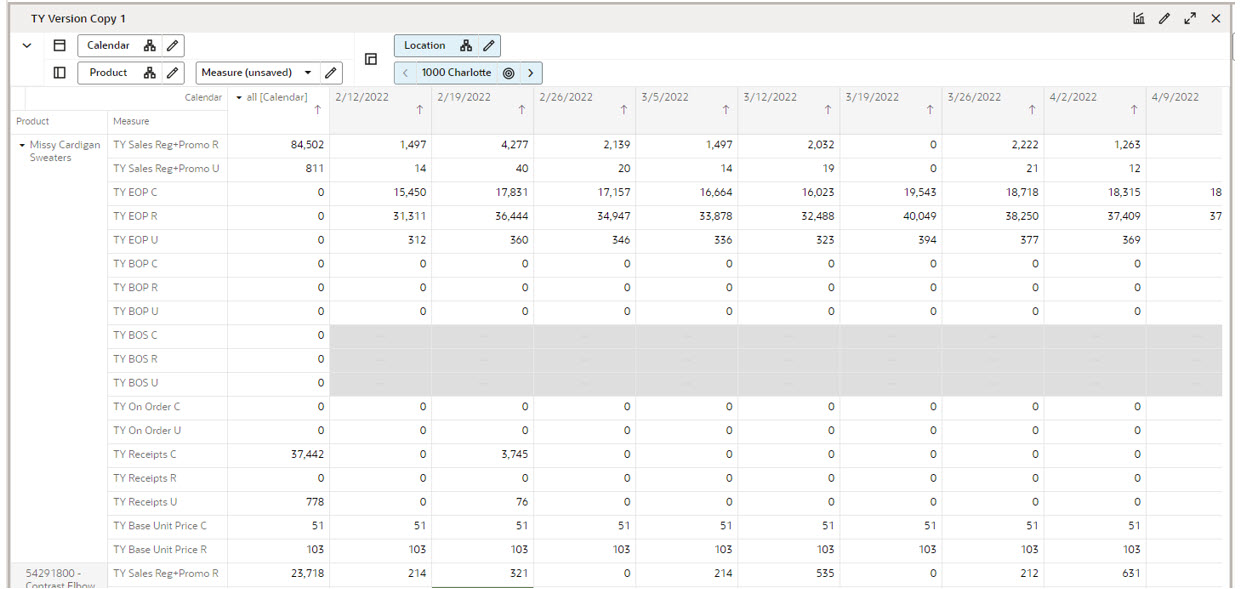

TY Version View
The step to complete this process:
Review actual data.
Additional measures are available in the Measure Show/Hide menu.
Figure 4-1 TY Version View
Measure Table
Table 4-1 TY Version View Measures
| Label | Definition |
TY Sales R, C, U |
Loaded actual Sales Retail, Cost, and Units by item, location, and week. |
TY EOP R, C, U |
Loaded End Of Period Inventory Retail, Cost, and Units by item, location, and week. |
TY On Order C, U |
Loaded On Order Cost, and Units by item, location, and week. |
TY Receipts C, U |
Loaded Receipts for Cost, and Units by item, location, and week. |
TY Customer Returns R, C, U |
Loaded Customer Returns for Retail, Cost, and Units by item, location, and week. |
TY Sales Clear R, U |
Loaded clearance Sales Retail and Units by item, location, and week. |
TY Sales Promo R, U |
Loaded promo Sales Retail and Units by item, location, and week. |
TY Sales Reg R, U |
Loaded regular Sales Retail and Units by item, location, and week. |
TY Traffic Count U |
Loaded Traffic Count Units by item, location, and week. |
TY Transaction Count U |
Loaded Transaction Count Units by item, location, and week. |
Fcst Sales U |
Loaded Forecast and Actual Sales Units by item, location, and week. |

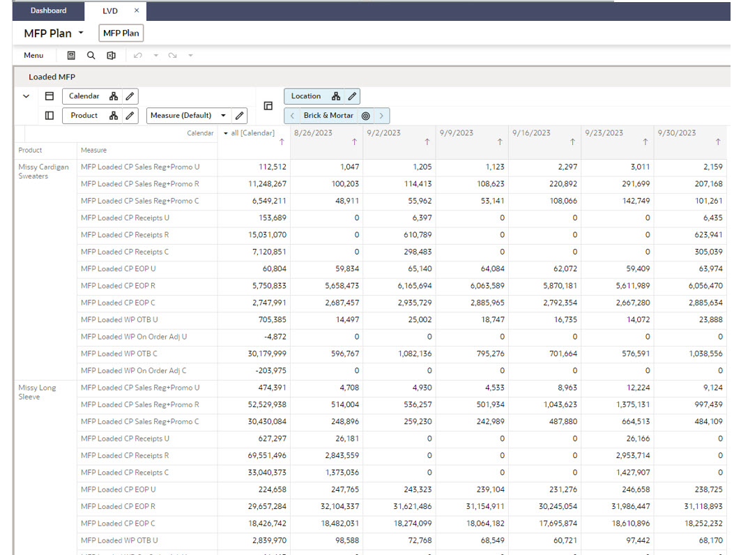

Loaded MFP View
Review MFP CP Sales R, Sales C, Sales U, EOP R, EOP C, EOP U, Receipts C, Receipts U, Customer Returns U and Customer Returns R, and MFP Loaded WP OTB U, OTB C, On Order Adj U, and On Order Adj C data.
Figure 4-2 Loaded MFP View
Measure Table
Table 4-2 Loaded MFP View Measures
MFP Loaded CP Sales R, C, U |
Loaded MFP Current Plan Sales Retail, Cost, and Units by Sub-class, channel, and week. |
MFP Loaded CP EOP R, C, U |
Loaded MFP Current Plan End of Period Inventory Retail, Cost, and Units by Sub-class, channel, and week. |
MFP Loaded CP Receipts C, U |
Loaded MFP Current Plan Receipts Cost and Units by Sub-class, channel, and week. |
MFP Loaded CP Customer Returns U, R |
Loaded MFP Current Plan Customer Returns for Units and Retail by Sub-class, channel, and week. |
MFP Loaded WP OTB U, C |
Loaded MFP Working Plan Open to Buy Units and Cost by Sub-class, channel, and week. |
MFP Loaded WP On Order Adj U, C |
Loaded MFP Working Plan On Order Units and Adjusted Units, Cost by department, store, and week. |

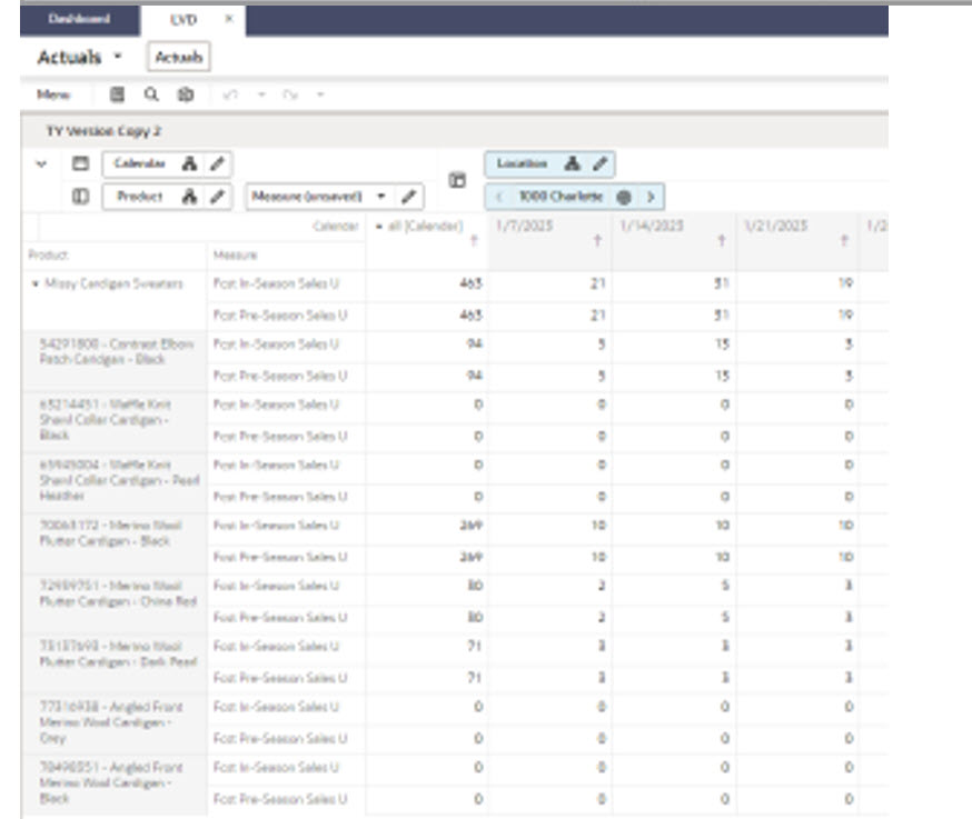

Forecast View
Review Forecast Sales U for Pre-season and In-season at style-color/location level.
Figure 4-3 Forecast View
Measure Table
Table 4-3 Forecast View Measures
Forecast In-season Sales U |
Forecast Sales Units for In-season |
Forecast Pre-season Sales U |
Forecast Sales Units for Pre-season |
