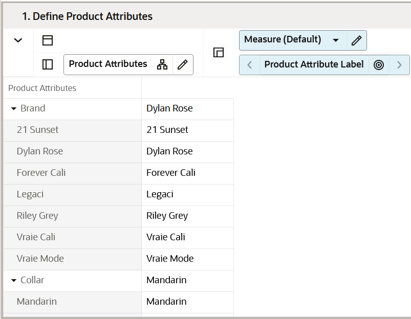

Define Product Attributes View
The Define Product Attributes view is used to view attributes and attribute values that can be used to distinguish items in an assortment based on the features. Example attributes are brand, size, product type, and color which can be used to facilitate planning, measuring, and managing a category's business in an efficient manner. It also allows creation of new attribute values.
To add a new attribute value, right-click a Product Attribute Value position and use the Add Positions option (Placeholder Maintenance functionality) to maintain new product attribute values (attribute value) mapping to a product attribute name (attribute name).
If attributes need to be updated for an existing item, the best practice is to update them in the source system.
For information on what is exported using the OAT process, see the Oracle Retail Assortment Planning Cloud Service Implementation Guide.
The steps to complete this process:
View the existing attributes and attribute values.
Use Placeholder Maintenance to create new attribute values, if necessary.

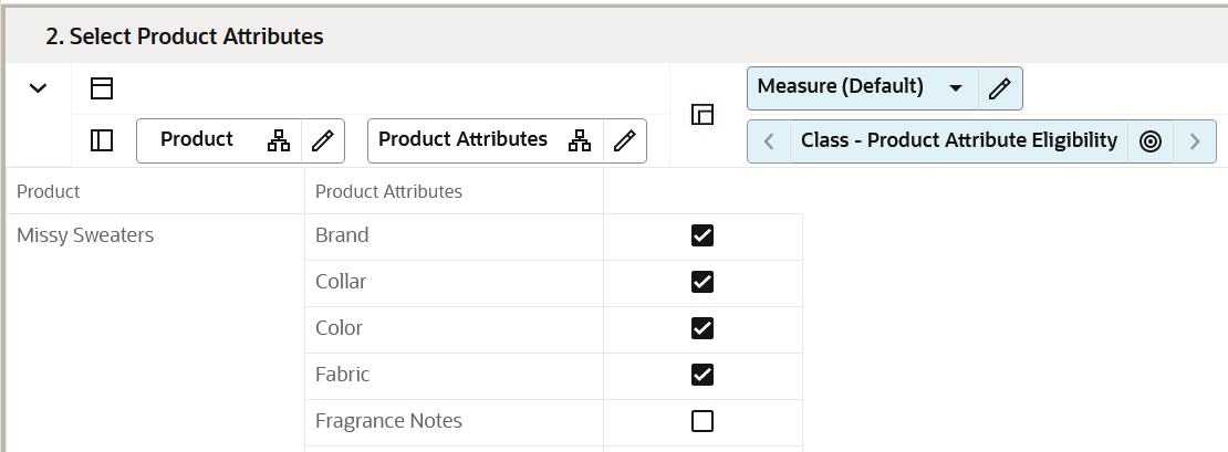

Select Product Attributes View
The Select Product Attributes view is used to maintain the mapping of attribute names to a product category. Depending on the settings selected, different attributes and their respective attribute values are made available to different product categories for attribute values modification. For example, an attribute Sleeve length may apply for the Sweaters product category, but may not apply for the Trousers product category.
The step to complete this process:
For each category, use the Class - Product Attribute Eligibility Boolean flag to assign the appropriate attributes that should be visible in the Assortment Planning segment.

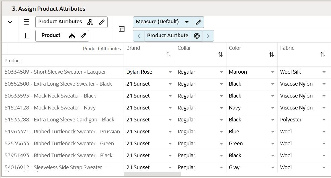

Assign Product Attribute View
The Assign Product Attributes view is used to update the attribute values mapping to a placeholder item. While the Administrator is allowed to make changes to an existing item's attributes in this view, those changes will not be sent back to a master data management (MDM) system such as Oracle Retail Merchandising System (RMS), which is the system of record for product attributes information.
If a change is made to an existing item here, it will need to be communicated back to the source system. A new Product attribute of Product Type is added to the current list of attributes that will mark an item as a basic/continuous item or a seasonal item to enable the planner to follow a simplified workflow for basic items and focus more on seasonal items every assortment period.
For placeholder items, assign the appropriate attribute values.

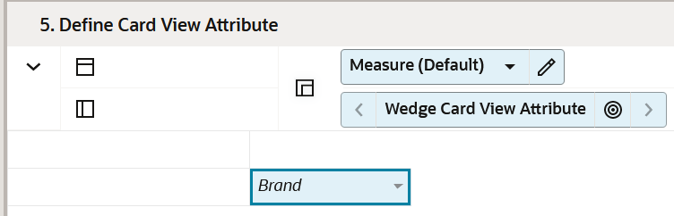

Define Card View Attribute View
The Define Card View Attribute view is used to define the specific attribute that needs to be used in the Wedge Card view that displays in the Build Wedge - Visual view of the Build Wedge step of the Build Wedge Workspace. Also, the Planning Administrator can specify the attribute that needs to be used in the Shopping List Card view that displays in the Select Options - Visual view of the Define Assortment step of the Create Assortment workspace.
For Card Views, specify the attribute that needs to be used.
Figure 3-6 Define Card View Attribute View
Measure Table
Table 3-6 Define Card View Attribute View Measures
| Label | Definition |
Wedge Card View Attribute |
Drop-down list measure that enables the mapping of product attribute in order to use in the visual planning card view for Wedge. |
Shopping List Card View Attribute |
Drop-down list measure that enables the mapping of product attribute in order to use in the visual planning card view for Shopping List. |

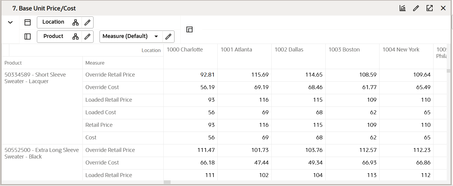

Base Unit/Price Cost View
The Base Unit Price/Cost view is used to set the price and cost of placeholder items.
If all locations have the same retail and cost for the placeholder item, roll up the location hierarchy to All location.
While the Administrator is allowed to make changes to an existing item's unit retail price or cost in this view, those changes will not be sent back to a master data management (MDM) system such as Oracle Retail Merchandising System (RMS), which is the system of record for product pricing information. If a change is made to an existing item here, it will need to be communicated back to the source system.
Locate the placeholder items and enter the base retail and cost.
Figure 3-8 Base Unit/Price Cost View
Measure Table
Table 3-8 Base Unit/Price Cost View Measures
Base Unit Price |
An item's retail value, which can be set by location, should only be adjusted for placeholder items in this view. |
Base Unit Cost |
An item's cost value, which can be set by location, should only be adjusted for placeholder items in this view. |

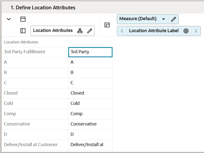

Define Location Attributes View
The Define Location Attributes view is used to view location attributes and their values that can be used to distinguish and group locations for clustering purposes.
View the current location attributes.
Figure 3-10 Define Location Attributes View
Measure Table
Table 3-10 Define Location Attributes View Measure
Location Attribute Label |
Used to store the location attribute label for a specific attribute. |

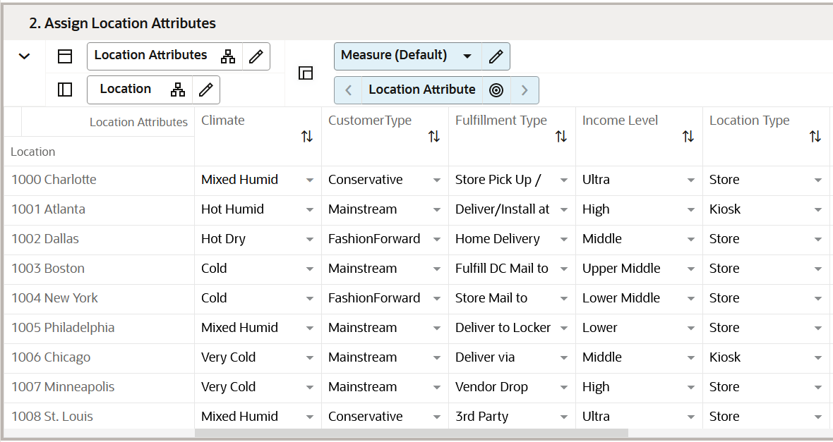

Assign Location Attributes View
The Assign Location Attributes view is used to maintain the mapping of attribute values to a store. The location attributes are available to the planner in the Location Clustering segment.
While the Administrator is allowed to make changes to an existing attribute in this view, those changes will not be sent back to a master data management (MDM) system such as Oracle Retail Merchandising System (RMS), which is the system of record for location attribute information. If a change is made to an existing location here, it needs to be communicated back to the source system.
Use the Location Attribute drop-down lists for each attribute to assign the appropriate attribute values to each store.
Figure 3-11 Assign Location Attributes View
Measure Table
Table 3-11 Assign Location Attributes View Measure
Location Attribute |
Drop-down list measure that enables the mapping of location attribute values to a location. |

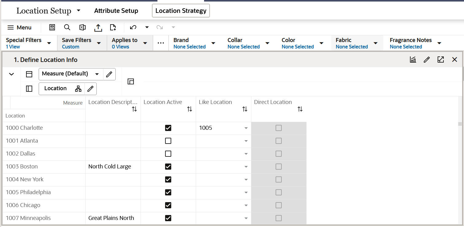

Define Location Info View
The Define Location Info view is used to enter location descriptions, enable active locations and disable inactive locations, and assign like locations to new locations.
Optionally, enter a location description.
The Location Description can be viewed as a dimension attribute used during the clustering process.
Enable active locations or disable inactive locations by selecting or un-selecting the Location Active Boolean flag.
Inactive Locations will not be available in Planning segments.
Assign like store locations to new stores by using the drop-down list measure Like Location to select the existing store that will be assigned to a new store.
Enable direct locations.
Figure 3-12 Define Location Info View
Measure Table
Table 3-12 Define Location Info View Measures
Location Description |
An optional description that can be applied to a location and viewed as a dimension attribute used during the clustering process. |
Location Active |
Boolean flag used to make a location active or inactive. If a location is inactive, it will not be available in the Location Clustering wizard or segment. |
Like Location |
Drop-down list measure used to select an existing store to match with a new store for Sales Retail, Units, and Gross Margin history. |
Direct Location |
Boolean flag used to indicate whether or not a location is online (direct) or is a physical store. |

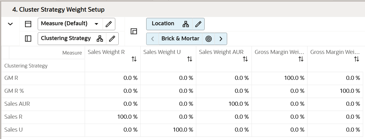

Cluster Strategy Weight Setup View
The Cluster Strategy Weight Setup view is used to enter the corporate-defined weights that correspond to each clustering strategy. The analysis and determination of strategy weights is expected to occur outside of the Assortment Planning solution, with the results available and visible within Assortment Planning to drive assortments that meet corporate objectives for each category. If desired, the Administrator may set up more clustering strategies using the Placeholder Maintenance functionality.
Enter performance metric weights for each Location Cluster strategy and corporate-defined weight. The total sum of the weights assigned to each cluster strategy should be 100%.
Figure 3-14 Cluster Strategy Weight Setup View
Measure Table
Table 3-14 Cluster Strategy Weight Setup View Measure
Sales Weight R, U, AUR, Gross Margin Weight R, and Gross Margin Weight R % |
The administrator-defined percentage weight given to the Sales metrics for the given strategy. The strategy weights are used in generating Combined Scoring for use in Location Clustering. |

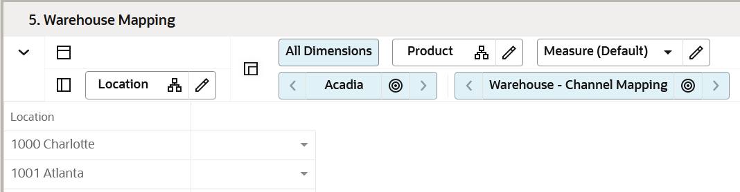

Warehouse Mapping View
The Warehouse Mapping view is used to map the corresponding warehouse to each location.
Select the corresponding warehouse from the drop-down list values to assign to locations.
Figure 3-15 Warehouse Mapping View

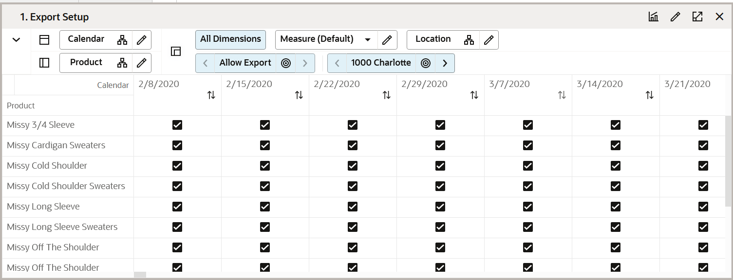

Export Setup View
The Export Setup view is used to select the positions that should be included when exporting plan data.
Select or deselect positions that should be included when exporting plan data.
Figure 3-16 Export Setup View
Measure Table
Table 3-16 Export Setup View Measure
Allow Export |
When the Boolean is checked, it is used to indicate that the position should be exported. |

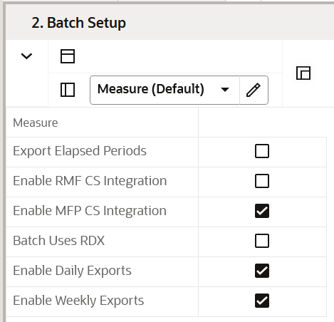

Batch Setup View
The Batch Setup view is used to designate whether elapsed periods should be included when exporting data to enable integration with Oracle Retail Merchandising Foundation Cloud Service (RMF CS) and batch use of Bulk Data Interface (BDI) and RPAS Data Mart (RDM).
Select the Export Elapsed Periods Boolean flag to include elapsed periods in the export.
Select the RMF CS Integration Boolean flag to enable the RMF CS integration.
Select the Batch Uses BDI Boolean flag to enable using BDI for the batch process.
Select the Batch Uses RDM Boolean flag to enable using RDM for the batch process.
Figure 3-17 Batch Setup View
Measure Table
Table 3-17 Batch Setup View Measures
Export Elapsed Periods |
When the Boolean is checked, it is used to indicate that elapsed periods should be exported. |
Enable RMF CS Integration |
When the Boolean is checked, it is used to indicate that RMF CS Integration is enabled. |
Enable MFP CS Integration |
When the Boolean is checked, it is used to indicate that MFP CS Integration is enabled. |
Batch Uses BDI |
When the Boolean is checked, it is used to indicate that batch uses BDI. |
Enable Daily Exports |
When the Boolean is checked, it is used to indicate that planned data should be exported daily. |
Enable Weekly Exports |
When the Boolean is checked, it is used to indicate that planned data should be exported weekly. |
Generate Forecast |
When the Boolean is checked, it is used to indicate that Batch should generate the forecast. |

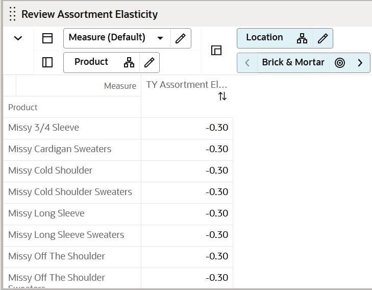

Review Assortment Elasticity View
Review the Assortment Elasticity values for each subclass.
Figure 3-18 Review Assortment Elasticity View
Measure Table
Table 3-18 Review Assortment Elasticity View Measure
TY Assortment Elasticity |
This Year's Assortment Elasticity determines how much of a decrease in the cannibalization factor occurs due to the addition of items of a particular similarity. |
