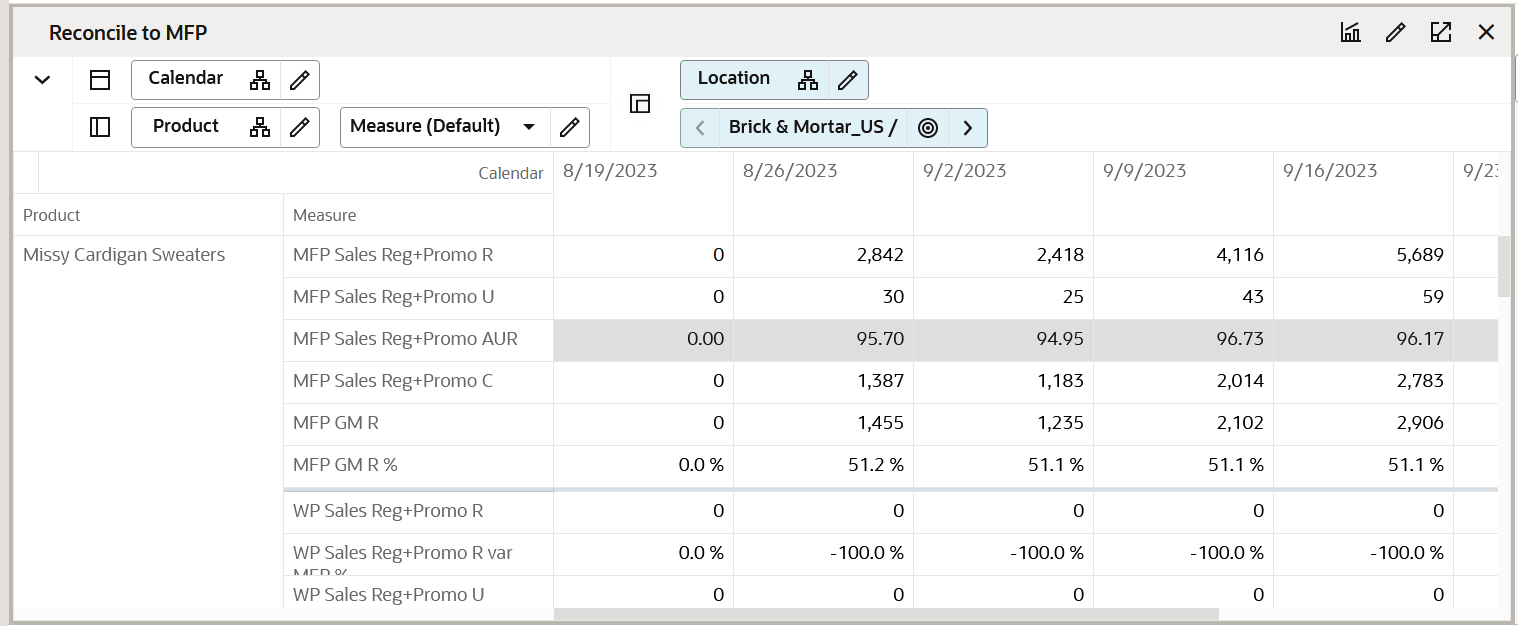

Reconcile to MFP View
The Reconcile to MFP view is used to compare the working plan of the item plan to the approved MFP Current Plan (MFP Tgt) for each subclass and cluster.
The steps to complete this process:
  • Review WP Sales var MFP Tgt % measures to identify variances that are outside of acceptable parameters.
  • Review Sales R, Sales U, Sales C, and GM variances to ensure that all of the financials meet targets.
  • Make adjustments to the sales and the receipt plans to be within an acceptable variance.
Repeat this process for each subclass and cluster in the assortment.
If a Location Plan is not available, the MFP CP view displays the MFP Current Plan by subclass spread to Location using last year's location sales' proportionality. If a Location Plan is available, the MFP CP view displays the MFP Current Plan by subclass spread to Location using the Location Plan CP sales' proportionality.
Figure 12-2 Reconcile to MFP View
Measure Table
Table 12-5 Reconcile to MFP View Measures
Label Definition
MFP Sales R, U, AUR, C, AUC, GM R, GMR%
MFP Sales Retail, Units, Average Unit Retail, Cost, Average Unit Cost, Gross Margin value, Gross Margin percent.
WP Sales Reg+Promo R, U, AUR
IP Working Plan Full Price Retail, Units, Average Unit Retail.
