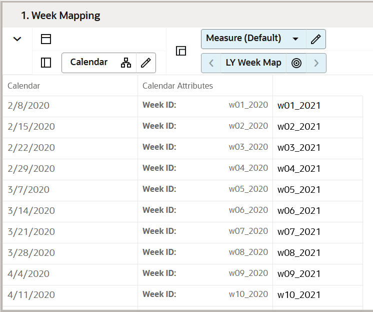

Week Mapping View
The Week Mapping view is used to map a week in this year to a week in last year. By default, the loaded file maps last year's weeks congruently to this year's weeks, meaning, the first week of last year is mapped to the first week of this year, the second week of last year is mapped to the second week of this year, and so on. The mapping for any week can be reassigned in this segment.
The step to complete this process:
  • Enter this year's week that should map back to last year.
Figure 3-1 Week Mapping View
Week Mapping View
Measure Table
Table 3-1 Week Mapping View Measures
Label Definition
LY Week Map
Measure to map this year's weeks to last year's weeks.
Week ID
Week position measure used to indicate last year's week number.

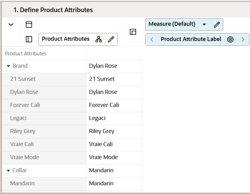

Define Product Attributes View
The Define Product Attributes view is used to view attributes and attribute values that can be used to distinguish items in an assortment based on the features. Example attributes are brand, size, product type, and color which can be used to facilitate planning, measuring, and efficiently managing a category's business. It also allows the creation of new attribute values.
To add a new attribute value, right-click a Product Attribute Value position and use the Add Positions option (Placeholder Maintenance functionality) to maintain new product attribute values (attribute value) mapping to a product attribute name (attribute name).
If attributes need to be updated for an existing item, the best practice is to update them in the source system.
For information on what is exported using the OAT process, see the Oracle Retail Assortment Planning Cloud Service Implementation Guide.
The steps to complete this process:
  • View the existing attributes and attribute values.
  • Use Placeholder Maintenance to create new attribute values, if necessary.
Figure 3-2 Define Product Attributes View
Measure Table
Table 3-2 Define Product Attributes View Measure
Label Definition
Product Attribute Label
Used to store the product attribute values for a specific attribute.

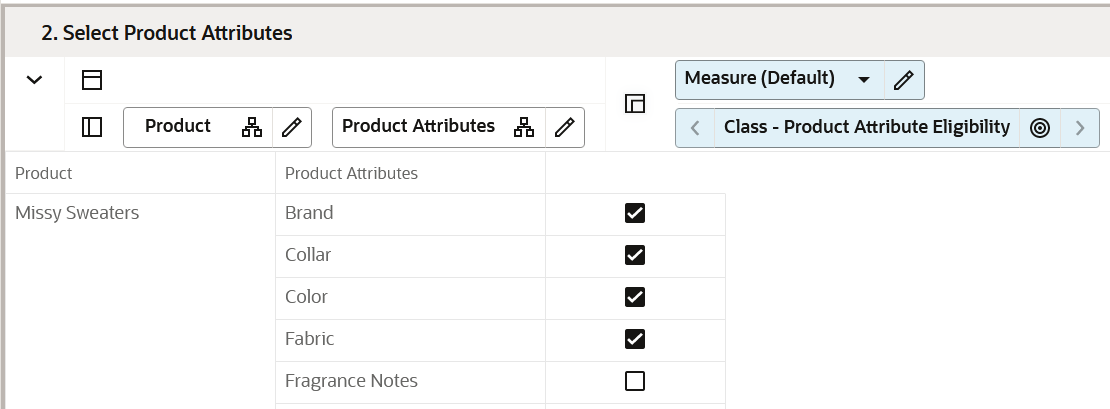

Select Product Attributes View
The Select Product Attributes view is used to maintain the mapping of attribute names to a product category. Depending on the settings selected, different attributes and their respective attribute values are made available to different product categories for attribute value modification. For example, an attribute Sleeve length may apply to the Sweaters product category, but may not apply to the Trousers product category.
  • For each category, use the Class - Product Attribute Eligibility Boolean flag to assign the appropriate attributes that should be visible in the Assortment Planning segment.
Figure 3-3 Select Product Attributes View
Measure Table
Table 3-3 Select Product Attributes View Measure
Label Definition
Enables the mapping of attribute names to a Class. Enabled attributes will be visible to a planner in Assortment Planning segments.

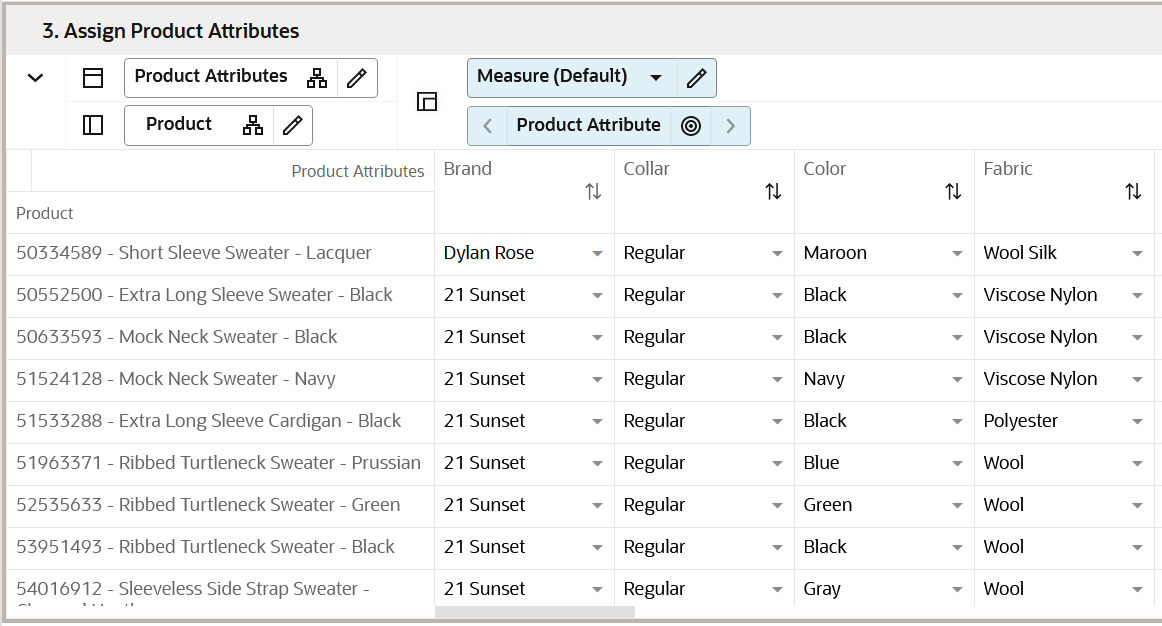

Assign Product Attribute View
The Assign Product Attributes view is used to update the attribute values mapping to a placeholder item. While the Administrator is allowed to make changes to an existing item's attributes in this view, those changes will not be sent back to a master data management (MDM) system such as the Oracle Retail Merchandising System (RMS), which is the system of record for product attribute information.
If a change is made to an existing item here, it will need to be communicated back to the source system. A new Product attribute of Product Type is added to the current list of attributes that will mark an item as a basic/continuous item or a seasonal item to enable you to follow a simplified workflow for basic items and focus more on seasonal items every assortment period.
  • For placeholder items, assign the appropriate attribute values.
Figure 3-4 Assign Product Attributes View
Measure Table
Table 3-4 Assign Product Attributes View Measure
Label Definition
Product Attribute
Drop-down list measure that enables the mapping of style-color attribute values to a style-color.

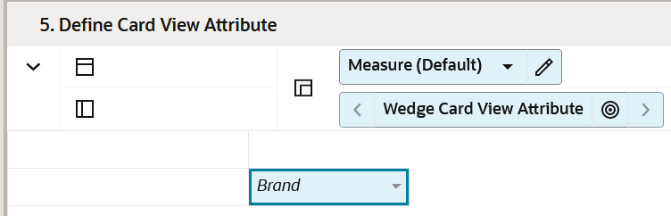

Define Card View Attribute View
The Define Card View Attribute view is used to define the specific attribute that needs to be used in the Assorted Card view that displays in the Plan Assortment - Visual view of the Recommend Assortment step of the Recommend Assortment Workspace. Also, the Planning Administrator can specify the attribute to be used in the Available Options view that displays in the Assorted Options- Visual view of the Plan Assortment step of the Assortment Planning workspace.
  • For Card Views, specify the attribute to be used.
Figure 3-6 Define Card View Attribute View
Measure Table
Table 3-6 Define Card View Attribute View Measures
Label Definition
Wedge Card View Attribute
Drop-down list measure that enables the mapping of product attribute to use in the visual planning card view for Wedge.
Shopping List Card View Attribute
Drop-down list measure that enables the mapping of product attribute to use in the visual planning card view for the Assorted options.

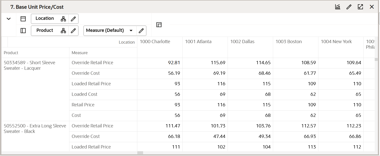

Base Unit/Price Cost View
The Base Unit Price/Cost view is used to set the price and cost of placeholder items.
If all locations have the same retail and cost for the placeholder item, rollup the location hierarchy to All Locations.
While the Planning Administrator is allowed to make changes to an existing item's unit retail price or cost in this view, those changes will not be sent back to a Master Data Management (MDM) system such as the Oracle Retail Merchandise Financial Planning Cloud Service (RMFCS), which is the system of record for product pricing information. If a change is made to an existing item here, it will need to be communicated back to the source system.
  • Locate the placeholder items and enter the base retail and cost.
Figure 3-8 Base Unit/Price Cost View
Measure Table
Table 3-8 Base Unit/Price Cost View Measures
Label Definition
Base Unit Price
An item's retail value, which can be set by location, should only be adjusted for placeholder items in this view.
Base Unit Cost
An item's cost value, which can be set by location, should only be adjusted for placeholder items in this view.

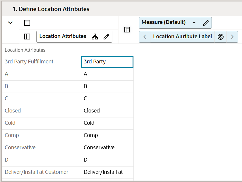

Define Location Attributes View
The Define Location Attributes view is used to view location attributes and their values that can be used to distinguish and group locations for clustering purposes.
  • View the current location attributes.
Figure 3-9 Define Location Attributes View
Measure Table
Table 3-9 Define Location Attributes View Measure
Label Definition
Location Attribute Label
Used to store the location attribute label for a specific attribute.

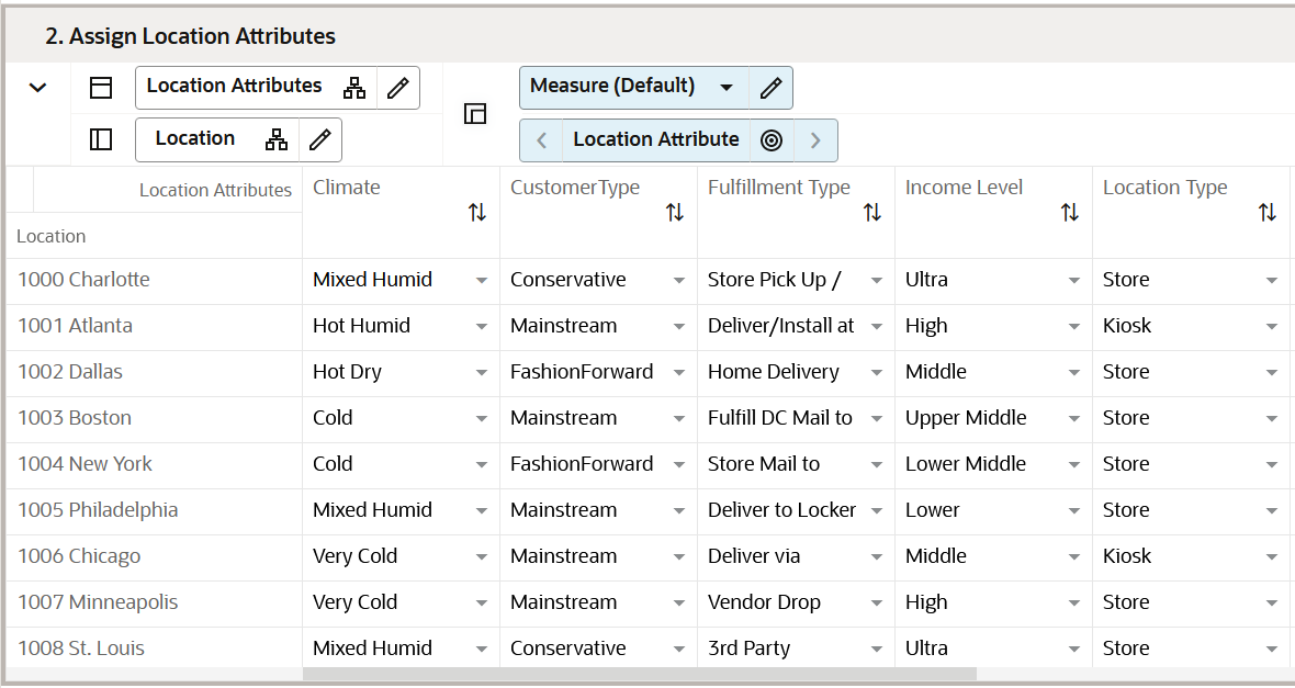

Assign Location Attributes View
The Assign Location Attributes view is used to maintain the mapping of attribute values to a store. The location attributes are available to you in the Location Clustering segment.
While the Administrator is allowed to make changes to an existing attribute in this view, those changes will not be sent back to a master data management (MDM) system such as Oracle Retail Merchandising System (RMS), which is the system of record for location attribute information. If a change is made to an existing location here, it needs to be communicated back to the source system.
  • Use the Location Attribute drop-down lists for each attribute to assign the appropriate attribute values to each store.
Figure 3-10 Assign Location Attributes View
Measure Table
Table 3-10 Assign Location Attributes View Measure
Label Definition
Location Attribute
Drop-down list measure that enables the mapping of location attribute values to a location.

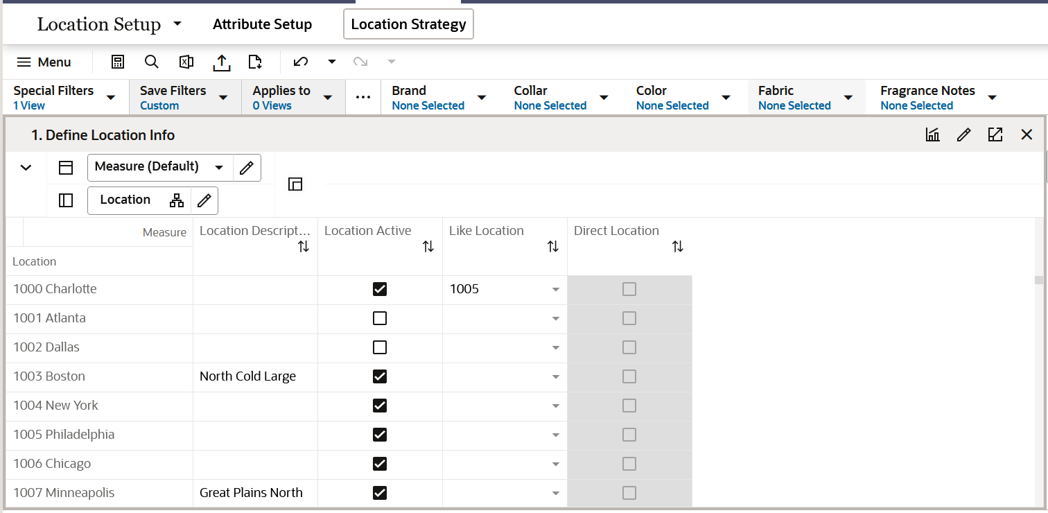

Define Location Info View
The Define Location Info view is used to enter location descriptions, enable active locations and disable inactive locations, and assign like locations to new locations.
  • Optionally, enter a location description.
    The Location Description can be viewed as a dimension attribute used during the clustering process.
  • Enable active locations or disable inactive locations by selecting or un-selecting the Location Active Boolean flag.
    Inactive Locations will not be available in Planning segments.
  • Assign like store locations to new stores by using the drop-down list measure Like Location to select the existing store that will be assigned to a new store.
  • Enable direct locations.
Figure 3-11 Define Location Info View
Measure Table
Table 3-11 Define Location Info View Measures
Label Definition
An optional description that can be applied to a location and viewed as a dimension attribute used during the clustering process.
Location Active
Boolean flag used to make a location active or inactive. If a location is inactive, it will not be available in the Location Clustering wizard or segment.
Like Location
Drop-down list measure used to select an existing store to match with a new store for Sales Retail, Units, and Gross Margin history.
Direct Location
Boolean flag used to indicate whether or not a location is online (direct) or is a physical store.

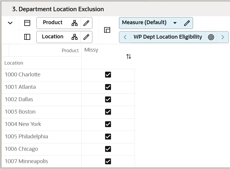

Department Location Exclusion
The Department Location Exclusion view uses a check mark for the selected stores of each department which should be excluded from the clustering process. Exclusions occur for various business reasons such as, not all merchandise is sold for all stores of a cluster.
  • Select the checkbox of the stores for each department from the list to exclude them in the store clustering process.
Figure 3-12 Department Location Exclusion View
Measure Table
Table 3-12 Department Location Exclusion View Measures
Label Definition
Wp Dept Location Exclusion
The measure used to represent the stores to be excluded from store clustering process for each department.

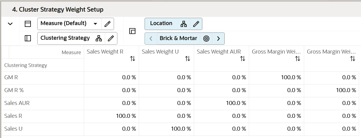

Cluster Strategy Weight Setup View
The Cluster Strategy Weight Setup view is used to enter the corporate-defined weights that correspond to each clustering strategy. The analysis and determination of strategy weights is expected to occur outside of the Assortment Planning solution, with the results available and visible within Assortment Planning to drive assortments that meet corporate objectives for each category. If desired, the Administrator may set up more clustering strategies using the Placeholder Maintenance functionality.
  • Enter performance metric weights for each Location Cluster strategy and corporate-defined weight. The total sum of the weights assigned to each cluster strategy should be 100%.
Figure 3-13 Cluster Strategy Weight Setup View
Measure Table
Table 3-13 Cluster Strategy Weight Setup View Measure
Label Definition
Sales Weight R, U, AUR, Gross Margin Weight R, and Gross Margin Weight R %
The administrator-defined percentage weight given to the Sales metrics for the given strategy. The strategy weights are used in generating Combined Scoring for use in Location Clustering.

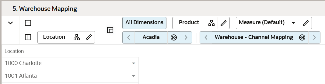

Warehouse Mapping View
The Warehouse Mapping view is used to map the corresponding warehouse to each location.
  • Select the corresponding warehouse from the drop-down list values to assign to locations.
Figure 3-14 Warehouse Mapping View
Measure Table
Table 3-14 Warehouse Mapping View Measure
Label Definition
Warehouse - Channel Mapping
The corresponding warehouse that can be associated with the location showed in the drop-down list values for the administrator to select and assign.

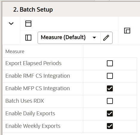

Step 4: Batch Setup
The Batch Setup allows the Administrator to control which periods and positions will be exported using the standard exports within OAT. If particular positions are needed or not needed for export, the Administrator can choose that information in this step.
  • Enable or disable positions for export.
  • Enable or disable elapsed period exporting.
Tabs and Views in this Step:
Batch Setup Tab
This tab is used to select the positions that should be included when exporting plan data and designate whether elapsed periods should be included when exporting data.

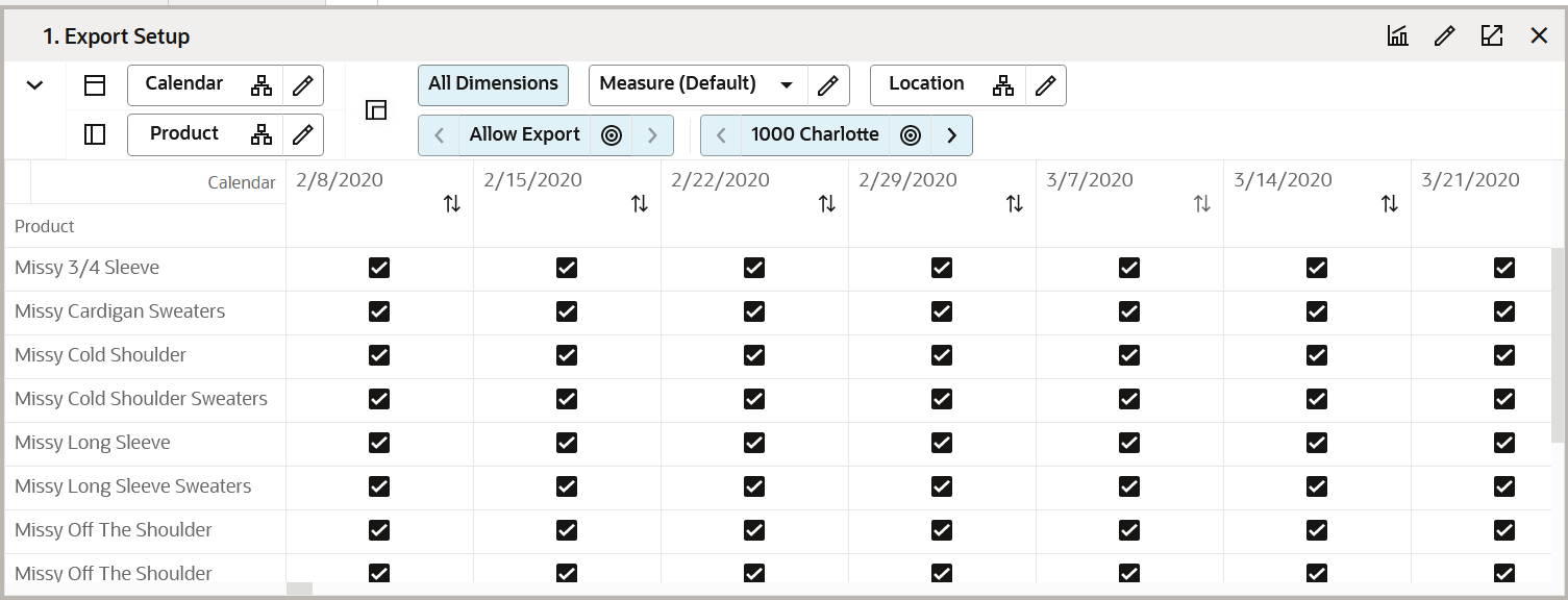

Export Setup View
The Export Setup view is used to select the positions that should be included when exporting plan data.
  • Select or deselect positions that should be included when exporting plan data.
Figure 3-15 Export Setup View
Export Setup View
Measure Table
Table 3-15 Export Setup View Measure
Label Definition
Allow Export
When the Boolean is checked, it is used to indicate that the position should be exported.
Batch Setup View
The Batch Setup view is used to designate whether elapsed periods should be included when exporting data to enable integration with Oracle Retail Merchandising Foundation Cloud Service (RMFCS).
  • Select the Export Elapsed Periods Boolean flag to include elapsed periods in the export.
  • Select the RMFCS Integration Boolean flag to enable the RMFCS integration.
  • Select the MFPCS Integration flag to enable MFPCS integration.
  • Select the Enable Daily Exports flag to indicate that planned data should be exported daily.
  • Select the Enable Weekly Exports flag to indicate that planned data should be exported weekly.
Figure 3-16 Batch Setup View
Batch Setup View
Measure Table
Table 3-16 Batch Setup View Measures
Label Definition
Select the Boolean to indicate that elapsed periods should be exported.
Enable RMF CS Integration
Select the Boolean to indicate that RMF CS Integration is enabled.
Enable MFP CS Integration
Select the Boolean to indicate that MFP CS Integration is enabled.
Select the Boolean to indicate that planned data should be exported daily.
Select the Boolean to indicate that planned data should be exported weekly.
Enable RSP SPO Integration
Select the Boolean to indicate that Batch should consider the integration with Profile Science from AI Foundation. Customers can use this to turn on or turn off Demand Transference integration.
Enable RSP Cluster Integration
Select the Boolean to indicate that Batch should consider the integration with Advanced Clustering from AI Foundation. Customers can use this to turn on or turn off Demand Transference integration.
Enable RSP DT Integration
Select the Boolean to indicate that Batch should consider the integration with Demand Transference from AI Foundation. Customers can use this to turn on or turn off Demand Transference integration.

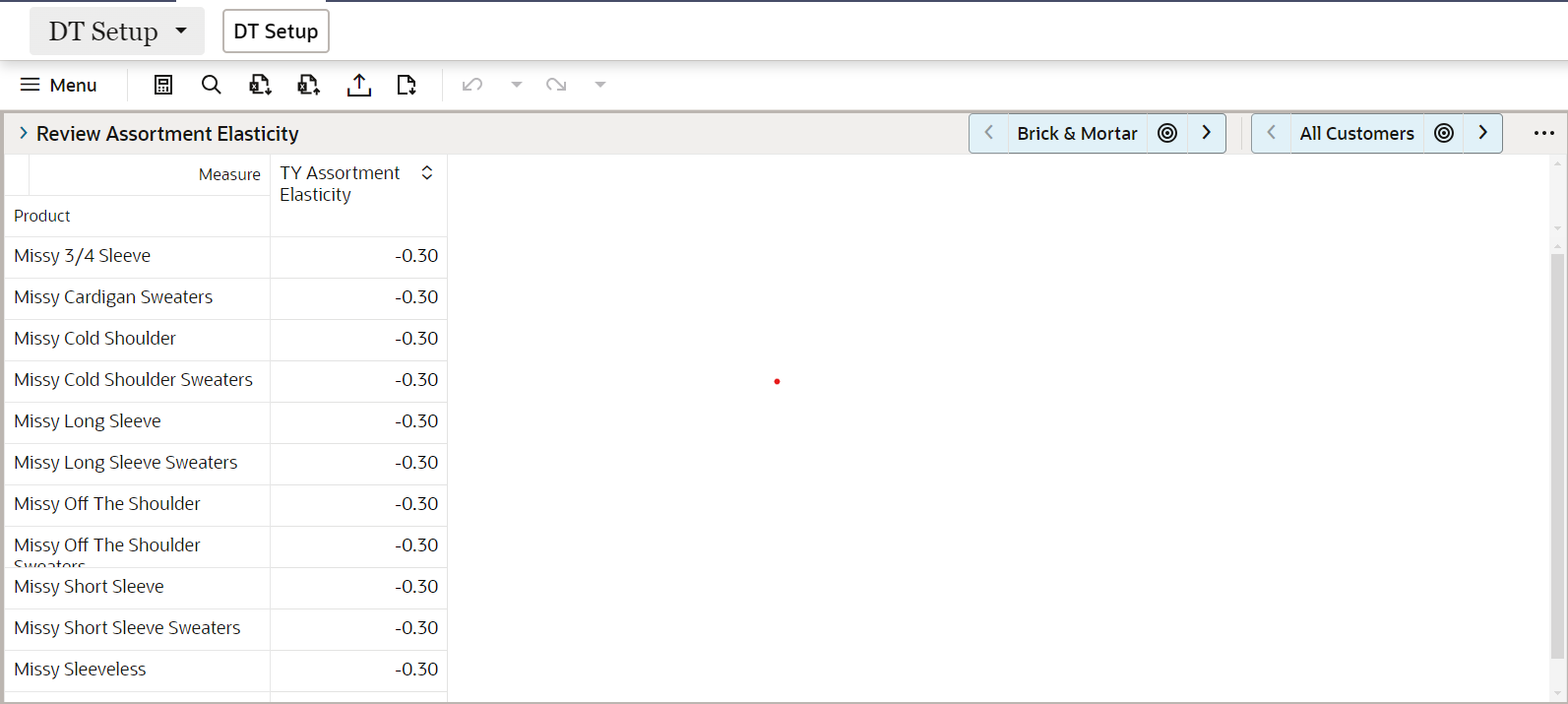

Review Assortment Elasticity View
  • Review the Assortment Elasticity values for each subclass.
Figure 3-18 Review Assortment Elasticity View
Measure Table
Table 3-18 Review Assortment Elasticity View Measure
Label Definition
TY Assortment Elasticity
This Year's Assortment Elasticity determines how much of a decrease in the cannibalization factor occurs due to the addition of items of a particular similarity.
