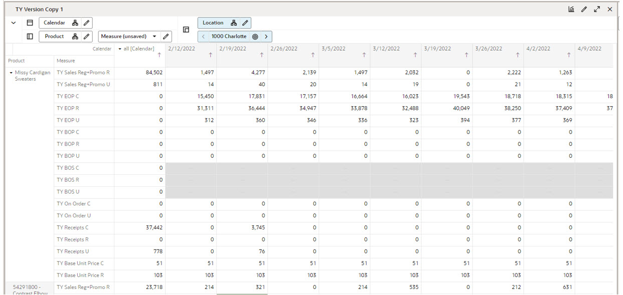

TY Version View
The step to complete this process:
Review actual data.
Additional measures are available in the Measure Show/Hide menu.
Figure 4-1 TY Version View
Measure Table
Table 4-1 TY Version View Measures
Label | Definition |
TY Sales R, C, U |
Loaded actual Sales Retail, Cost, and Units by item, location, and week. |
TY EOP R, C, U |
Loaded End Of Period Inventory Retail, Cost, and Units by item, location, and week. |
TY On Order C, U |
Loaded On Order Cost, and Units by item, location, and week. |
TY Receipts C, U |
Loaded Receipts for Cost, and Units by item, location, and week. |
TY Customer Returns R, C, U |
Loaded Customer Returns for Retail, Cost, and Units by item, location, and week. |
TY Sales Reg R, U |
Loaded regular Sales Retail and Units by item, location, and week. |
TY Traffic Count U |
Loaded Traffic Count Units by item, location, and week. |
TY Transaction Count U |
Loaded Transaction Count Units by item, location, and week. |

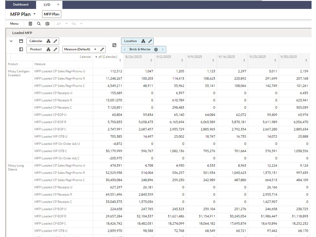

Loaded MFP View
Review MFP CP Sales R, Sales C, Sales U, EOP R, EOP C, EOP U, Receipts C, Receipts U, Customer Returns U, and Customer Returns R, and MFP Loaded WP OTB U, OTB C, On Order Adj U, and Order Adj C data.
Figure 4-2 Loaded MFP View
Measure Table
Table 4-2 Loaded MFP View Measures
MFP Loaded CP Sales R, C, U |
Loaded MFP Current Plan Sales Retail, Cost, and Units by Subclass, channel, and week. |
MFP Loaded CP EOP R, C, U |
Loaded MFP Current Plan End of Period Inventory Retail, Cost, and Units by Subclass, channel, and week. |
MFP Loaded CP Receipts C, U |
Loaded MFP Current Plan Receipts Cost and Units by Subclass, channel, and week. |
MFP Loaded CP Customer Returns U, R |
Loaded MFP Current Plan Customer Returns for Units and Retail by Subclass, channel, and week. |
MFP Loaded WP OTB U, C |
Loaded MFP Working Plan Open to Buy Units and Cost by Sub-class, channel, and week. |
MFP Loaded WP On Order Adj U, C |
Loaded MFP Working Plan On Order Units and Adjusted Units, Cost by department, store, and week. |

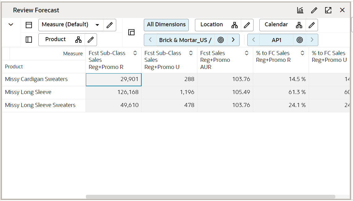

Forecast View
Review Forecast Sales U for Pre-season and In-season at style-color/location level.
Figure 4-3 Forecast View
Measure Table
Table 4-3 Forecast View Measures
Forecast In-season Sales U |
Forecast Sales Units for In-season |
Forecast Pre-season Sales U |
Forecast Sales Units for Pre-season |
