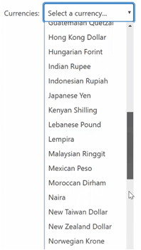

This example application has a single currency selector widget that presents a dropdown list of all of the available currencies as returned by the list-currencies JavaScript endpoint.
Select a currency example
This example has an event listener that listens for selections from this list. When a selection occurs, the ID of the selected currency is passed to the getCurrency REST endpoint to get specific details. When that information is received, it is displayed in an auxiliary panel, showing you the currency symbols for the available currencies. For example:
Currency example - result
