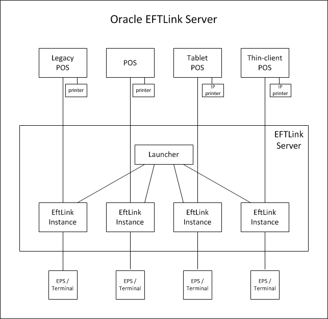

EFTLink Server - Remote Mode
1-1 mapping between the POS and payment system/terminal. Each POS is allocated a fixed pair of sockets (channel 0/1) that connect to a dedicated EFTLink instance.
Figure 2-1 EFTLink Server - Remote Mode
Included with EFTLink is an additional file EFTLinkConfig_Static_Server.properties
. This is a sample file demonstrating EFTLink configuration in this mode.
can be used in place of the standard EFTLinkConfig.properties
by renaming this file to EFTLinkConfig.properties
. A manual comparison of the files will be necessary to ensure core configuration which is set during installation is copied over to the RemoteMode configuration.
MultiJVM
This functionality
is currently incompatible with the PEDPoolEnabled
property.
This property is used to launch each OPIServer in their own Java Virtual Machine (JVM) process when the NumServers property is set to greater than 0.
Each server's channel 0 and channel 1 ports are based on the ServerChannel0 setting. For example, if the ServerChannel0 is set to 10100 and NumServers is set to 3, the additional servers will be created on channel 0 ports 10110, 10120, 10130 and the corresponding channel 1 ports will be 10111, 10121, 10131 therefore, you must ensure that these ports are available for use with EFTLink.
For each server defined under NumServers; EFTLink looks for a corresponding server folder. For example, if NumServers is set to 3, EFTLink looks for server folders named server1, server2 and server3 under the EFTLink directory. These folders must contain their own configuration files, that is; EftLinkConfig.properties and so on.
In order to use this property, you must use the MultiServerLauncher application rather than the OPIServer application.

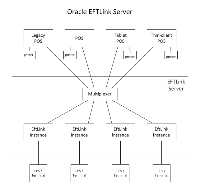

EFTLink Server - PEDPool Remote Mode
Many-many mapping between POS and payment system/terminal. Each POS is allocated a fixed pair of sockets (channel 0/1) that connect to a multiplexer/switch. The multiplexer implements rules and/or uses interactive dialogs with the POS operator to determine which EFTLink instance to pass the request on to.
Figure 2-2 EFTLink Server - PEDPool Remote Mode
Included with EFTLink is an additional file EFTLinkConfig_PED_Pool.properties
. A manual comparison of the files will be necessary to ensure core configuration which is set during installation is copied over to the PEDPool configuration.
