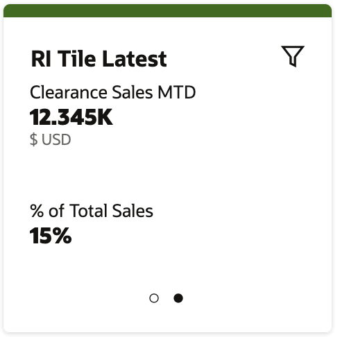

The following tile state uses the BI Two Metric Template tile state layout:
Figure 5-4 Tile State Example
Each metric has a label, value, and optional description. In the above tile state example, the first metric's label is Daily Sales Retail, its value is 5,837K, and its description is USD.

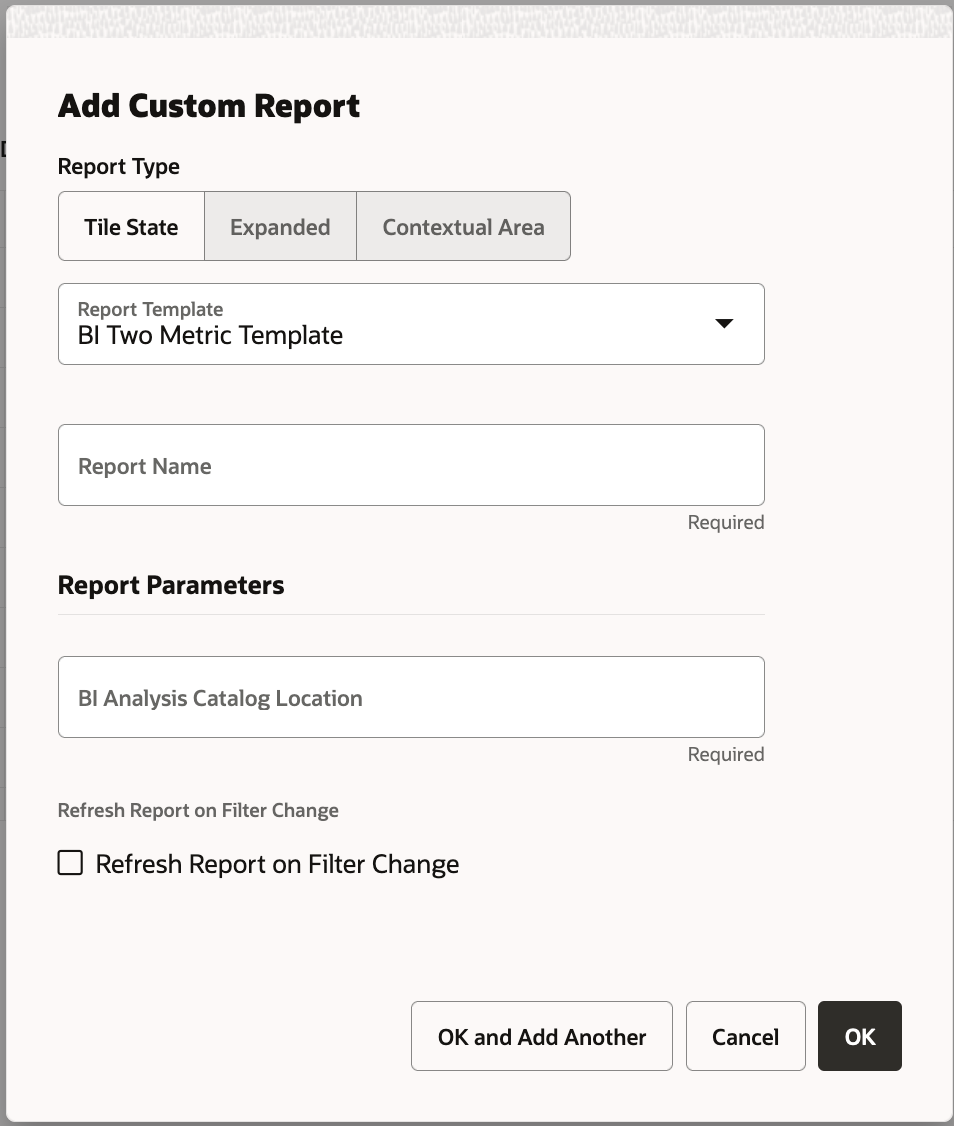

The BI Two Metric Template has the following report parameter configuration:
BI Analysis Catalog Path

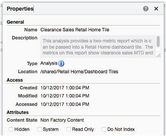

BI templates require one or more BI Analysis Catalog Locations. The BI Analysis Catalog Location is the path to the analysis within RI.
The analysis path is a combination of the analysis's Location and Name, as found in the analysis's Properties within RI.
For example: /shared/Retail Home/Dashboard Tiles/Clearance Sales Retail Home Tile
Figure 5-5 Clearance Sales Retail Home Tile - Analysis Path
In the above example, the analysis's Location is /shared/Retail Home/Dashboard Tiles and the analysis's
Name is Clearance Sales Retail Home Tile. The full BI Analysis Catalog Path is formed by joining the Location
and Name with a "/".

Refresh Report on Filter Change
This parameter when checked indicates that the tile state report should refresh when the user updates the Retail Home dashboard filter. If not checked, the report will not reload. If checked, the report will reload. If the RI analysis supports being filtered by merchandise hierarchy, the report's data will be filtered by the user's merchandise hierarchy selection.
