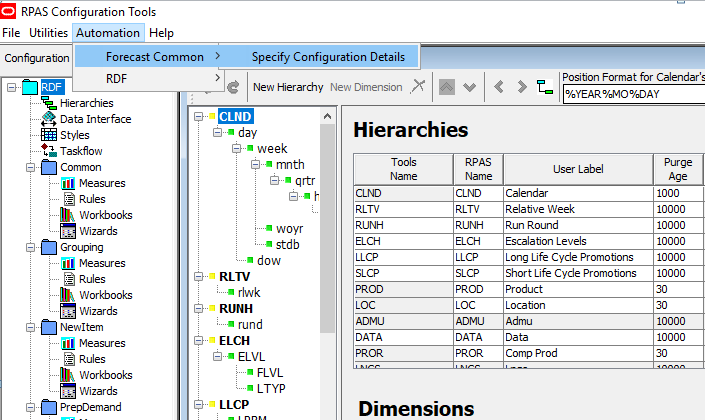

Set Up Common Configuration Details

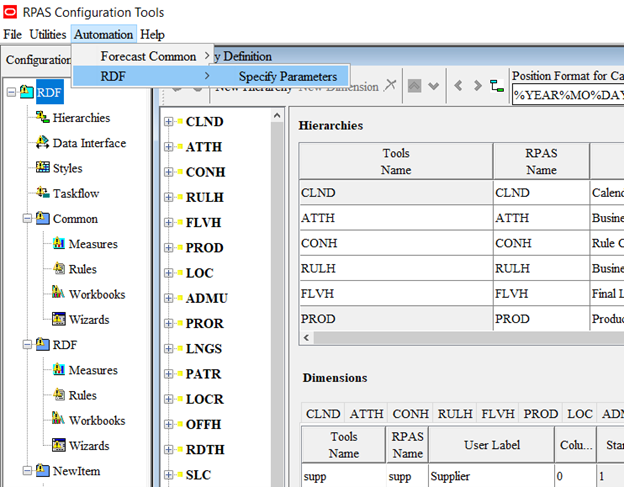

From the Configuration Tools toolbar, select the Automation menu and then from the Forecast Common option, select Specify Configuration Details.
Figure 3-1 Configuration Tools: Forecast Common
Figure 3-2 Select Common Input

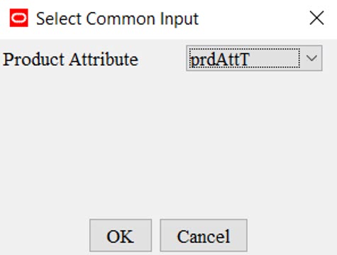

In this step we specify the common input to both New Item and IPOCS-Demand Forecasting / IPOCS-Lifecycle Allocation and Replenishment.
The product attribute measure to be used in the IPOCS-Demand Forecasting / IPOCS-Lifecycle Allocation and Replenishment and New Item solutions has to be specified in the Common Plug-in. The product attribute measure stores the attribute position name and not the attribute label.

From the Configuration Tools toolbar, select the Automation menu and then, from the IPOCS-Demand Forecasting / IPOCS-Lifecycle Allocation and Replenishment option, select Specify Parameters.

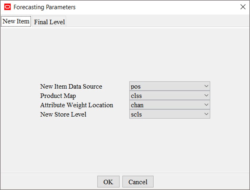

From the Like Item Parameters utility, specify the properties for the New Item plug-in. Refer to Editing New Item Parameters for details.
Figure 3-4 Like Item Parameters
Click OK once editing is finished.
Table 3-3 lists the New Item parameters available for editing.
Table 3-3 New Item Parameters
| Parameter | Description |
New Item Data Source |
Sales data used to generate forecast for New item/store. |
Product Map |
This field specifies the range of the like item available to a new item. If the field is populated with clss, it means that only existing items under the same class as the new item are available as like item candidate. The Similarity Score calculation should only be performed between the new item and existing items with in the class. |
Attribute Weight Location |
Allows you to specify which location level that the attribute weight used in similarity score calculation will be based on. The attribute weight measure intersection is to be on product Map/attribute-weight-loc/patt. In GA, it is clss/chan/patt. |
New Store Level |

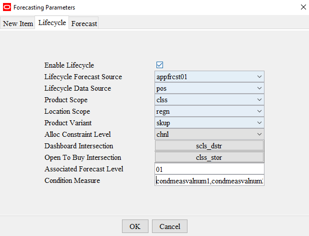

Configuring the IPOCS-Demand Forecasting / IPOCS-Lifecycle Allocation and Replenishment Solution
In IPOCS-Demand Forecasting, the Demand Model to generate the forecast is:
Demand = Base Demand * Seasonality * Promo Effects * Price Effects
This is the basic model used to forecast short lifecycle and long lifecycle items. However the approach to calculate each of these components might differ.
Forecast information is often required for items at the lowest levels in a hierarchy. Problems can arise when historic sales data for these items is too sparse and too noisy to identify clear selling patterns. In such cases, calculating the seasonality curves and effects at a higher level in the hierarchy based on an escalation path, would generate a reliable forecast. The science UI provides a mechanism to define the final levels and escalation levels; and the associated parameters for each level. The default escalation path is the order in which the escalation levels are used also defined in the science UI. Users can also edit default escalation path, override the escalation path at the final level intersection from the science UI. In the IPOCS-Demand Forecasting / IPOCS-Lifecycle Allocation and Replenishment plug-in, implementor need to define the final levels. The final levels specified in IPOCS-Demand Forecasting / IPOCS-Lifecycle Allocation and Replenishment plug-in must match the final levels defined in the science UI.
The IPOCS-Demand Forecasting / IPOCS-Lifecycle Allocation and Replenishment solution can be configured using the final level tab in the RDF plug-in UI:
Table 3-4 IPOCS-Demand Forecasting / IPOCS-Lifecycle Allocation and Replenishment Plug-in UI Tabs
| Tabs | Description |
Final Level |
Define and configure final levels |
Generate IPOCS-Demand Forecasting / IPOCS-Lifecycle Allocation and Replenishment Solutions

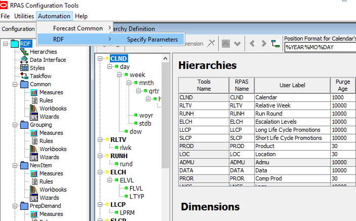

Perform the following steps to generate an IPOCS-Demand Forecasting / IPOCS-Lifecycle Allocation and Replenishment solution:
From the Configuration Tools toolbar, select the Automation menu and then, from the IPOCS-Demand Forecasting / IPOCS-Lifecycle Allocation and Replenishment option, select Specify Parameters. The following steps outline the process for configuring IPOCS-Demand Forecasting / IPOCS-Lifecycle Allocation and Replenishment forecast levels.
Figure 3-5 Configuration Tools: IPOCS-Demand Forecasting / IPOCS-Lifecycle Allocation and Replenishment

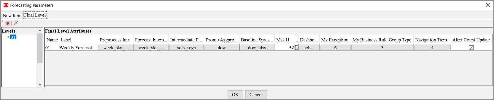

1. Select the final level tab to configure the various parameters for Final Levels.
Configure a final forecast level:
From the Forecasting Parameters utility, click the F icon. A new final level is added, and it is assigned the next available level number. Specify the properties for the final level. See Editing Forecast Level Parameters for details.
To remove a final level, select the forecast level and then click the X icon. Deleting a final level removes all of its associated parameters.
Figure 3-6 Final Forecast Level
Edit Final Level Forecast Level Parameters
Table 3-5 lists all of the Final Level Forecast Level parameters.
Table 3-5 Final Level Forecast Level Parameters
| Final Level Parameters | Description |
Level Name |
The level name is the system-assigned level number when a forecast level is created. This is a read-only parameter. |

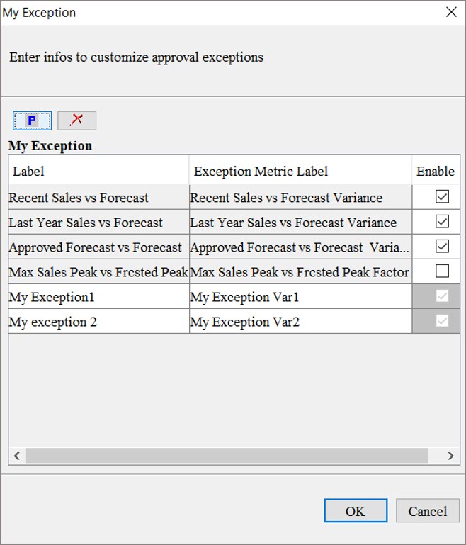

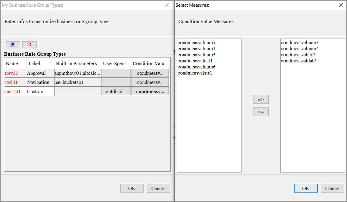

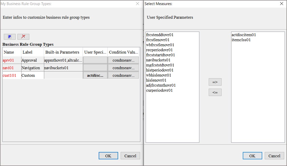

My Exception |
This parameter provides a mechanism for the implementor to configure custom approval exceptions and enable/disable GA provided approval exceptions. These exceptions will be used during the batch for Forecast approvals and is also seen in the dashboard exception profile as a separate tile. The implementor can enter the labels for the exception and the secondary measure such as variance measure. Note that the implementor is responsible to configure the rule/rule group (based on the exception definition) to populate the boolean measure (and variance measure) for the My Exception. |

Configure My Exception
This parameter provides a mechanism for the implementor to configure custom approval exceptions and enable or disable GA provided approval exceptions. These exceptions are used during the batch for Forecast approvals and are also seen in the dashboard exception profile as a separate tile. The implementor can enter the labels for the exception and the secondary measure such as variance measure.
Note that the implementor is responsible to configure the rule or rule group (based on the exception definition) to populate the boolean measure (and variance measure) for My Exception.
To add or remove custom exception, perform the following steps.
Click within a cell of the My Exception table to open a dialog as shown in Figure 3-7. The dialog displays a table with the columns:
Label - Displays the exception label name (read only)
Exception Metric Label - Displays the exception metric label name (read only)
Enable - Allows you to enable or disable GA provided exceptions
Click P to create additional rows for custom approval exceptions. implementors can enter labels and exception metric labels in the new custom exception. Click X to delete the custom exception.
Figure 3-7 Add New Custom Exceptions

User specified Parameters per rule group type can be specified by an implementor if additional parameters need to be included. The parameters are associated with business rule group type so that the values for a certain sku/store can be assigned to a set of value for a business rule which the sku/store belongs.
Click within the cell of user specified parameters to open the
dialog that allows you to add or remove parameters. The Select Measures
box in Figure 3-8 displays all GA parameter measures. Most of these measures
are forecasting parameter at final. Any custom measures with intersection
= forecast intersection without the clnd dimension
and have a valid db will be available for
selection too. For each selected measure, a measure at business rule
is created and added to the parameter for <rule group type> worksheet
for user input.
Figure 3-8 Select User Specified Parameters
Click within the condition value cell to open the dialog that allows
you to select the condition value measures to be used. The measures
available for selection are the ten condition measures GA provides
and any custom non-boolean measure that have an intersection higher
than forecast intersection without the clnd dimension and have a valid db. The selected
measure are used to construct the picklist for condition value (measure)
in the Rule Setup workbook.
Figure 3-9 Select Condition Value Measures

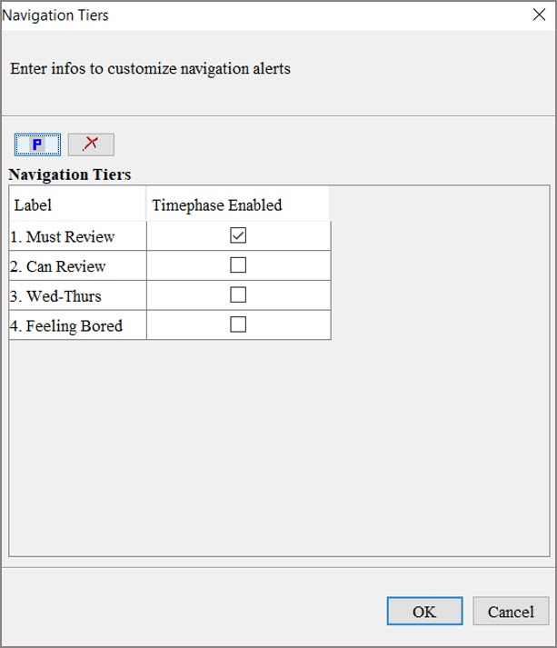

Configure Navigation Tiers
Navigation in the Forecast Review workbook is now tiered. You can decide how many tiers and what is the rule to associate a sku/stores to a tier. There is a corresponding workbook alert associated with each tier. By switching between workbook alerts, you can jump between sku/stores with a different priority to be approved.
Click within the navigation-tier cell to display the dialog that allows you to add or delete a tier.
Click P to add more tiers. implementors can enter the label of the tier and indicate if a time-phase workbook alert is enabled or disabled.
Click X to remove tiers.
For each tier, a workbook alert at prod/loc is created in the Forecast Review workbook. If time-phased is enabled, an additional workbook alert at prod/loc/clnd is created in the Forecast Review workbook.
Figure 3-10 Select Navigation Tiers
Configuring the IPOCS-Lifecycle Allocation and Replenishment Solution
The following steps outline the process for configuring Inventory Planning Optimization Cloud Service-Lifecycle Allocation and Replenishment (IPOCS-Lifecycle Allocation and Replenishment) solution.
Perform the following steps to generate an IPOCS-Lifecycle Allocation and Replenishment solution:
From the Configuration Tools toolbar, select the Automation menu, and then from the IPO option, select Specify Parameters.
Figure 3-11 Configuration Tools Toolbar
Select the Lifecycle tab to configure the various parameters for -Lifecycle Allocation and Replenishment .
Figure 3-12 Lifecycle Tab — Forecast Parameters
Edit the Lifecycle Parameters. Once editing is finished, click OK.
The following table lists the Lifecycle parameters available for editing.
Table 3-6 Lifecycle Parameters
Parameter Description Enable Lifecycle
Boolean that indicates if the Lifecycle taskflow is visible in the UI and whether the Lifecycle batch is run.
Lifecycle Forecast Source
The measure that holds the forecast feed to Lifecycle (if not specified, by default use appfrcst01).
Lifecycle Data Source
The measure that holds the sale history feed to Lifecycle (by default use pos).
Product Scope
The product dimension to base the product scope on (by default use class).
Location Scope
The location dimension to base the product scope on (by default use region).
Product Variant
The product dimension to base the product variant definition on (by default use skup – sku parent).
Alloc Constraint Level
The location dimension that the allocation constraint is based on (by default use channel).
Dashboard Intersection
The intersection that the Lifecycle worksheets in a dashboard workbook should be based on. (by default use scls_dstr).
Open To Buy Intersection
The intersection that the open to buy measure should be based on. (by default use clss_stor).
Associated Forecast Level
This is the final level from the demand forecast module associated to the attributes used in the Lifecycle module. Note that the Business Rule Attribute measures are per final level, hence it is important to use the correct set of attribute measures.
Condition Measures
This is a list of condition value measures that can be used in the rule condition setups in the Lifecycle module. Apart from GA condition measures, custom measures can be added too. Remember to load the range measures LPPmDtbCndValRg and LPPmRulCndValRg. LPPmDtbCndValRg is used to populate the Condition Value Measure picklist in the Databag Review, whereas LPPmRulCndValRg is used in the condition measure value drop down in Network and Replenishment Parameters workspace. These files are loaded by the GA batch control process, but the files need to be created by the implementer.
Sample file for LPPmDtbCndValRg - File:
LPPmDtbCndValRg.csv.ovrdtb.01.01,"condmeasvalnum1(Condition Measure Value numeric 1),condmeasvalnum2(Condition Measure Value numeric 2),condmeasvalstr1(Cn Measure Value String 1)"Sample file for LPPmRulCndValRg- File:
LPPmRulCndValRg.csv.ovrr.01.01,"condmeasvalnum1(Condition Measure Value numeric 1),condmeasvalnum2(Condition Measure Value numeric 2),condmeasvalstr1(Cn Measure Value String 1)"

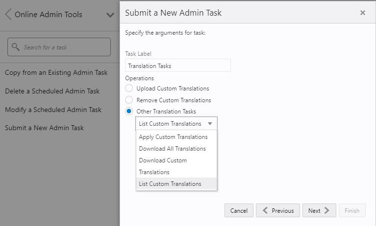

Perform the following steps to access the position names to create the locale specific file:
Make sure the browser locale is English - United States
From the OAT configure batch task, go to the Translation Task and then, Download All Translations.
The
r_msglabel.csv.ovrfile contains the English labels as updated by the implementor in the IPOCS-Demand Forecasting / IPOCS-Lifecycle Allocation and Replenishment plug-in. -
This file can serve as an example to create the locale specific
r_msglabelfile. -
The locale specific file can contain only the records with the updated labels.
Revert the browser language to the original locale.
Upload the locale specific
r_msglabel.csv.ovrfile using the Translation Task .Figure 3-14 Translation Tasks
