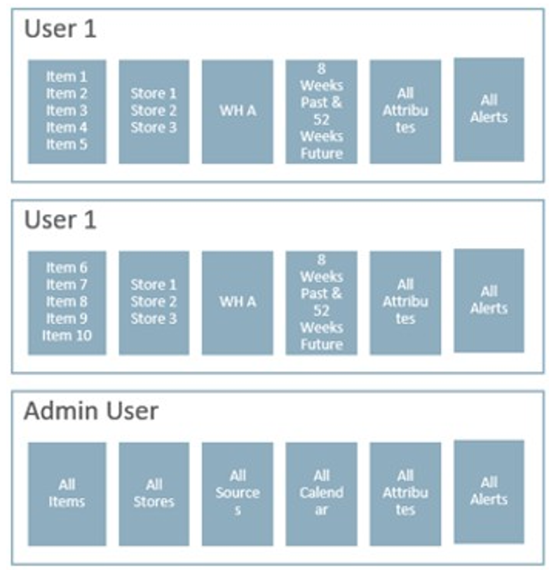

The following image illustrates different databags with different scopes and users. Each databag has its own scope with the assigned products, locations, calendar, attributes, and alerts.
Figure 14-1 Different Databags with Different Scopes and Users

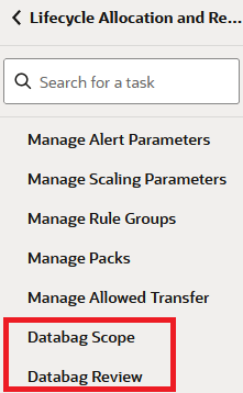

  2. Click the IPO Administration activity and then click Lifecycle Allocation and Replenishment to access the available workspaces.
  3. Click either Databag Scope or Databag Review. The Databags wizard opens.

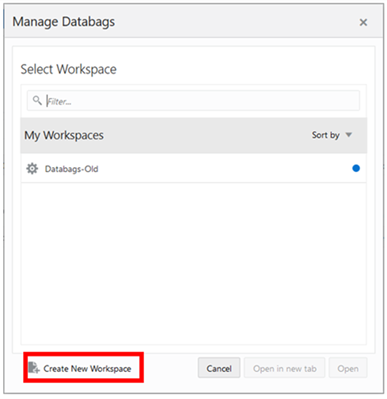

  4. You can open an existing workspace, but to create a new workspace, click Create New Workspace.
    Figure 14-6 Create New Workspace

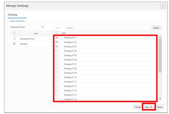

  6. The Workspace wizard opens. Select the databags you want to work with and click Next.
    Figure 14-8 Workspace Wizard: Select Databags

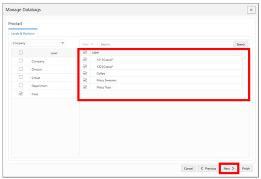

  7. Select the products you want to work with and click Next.
    Figure 14-9 Workspace Wizard: Select Product

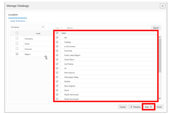

  8. Select the locations you want to work with and click Next.
    Figure 14-10 Workspace Wizard: Select Location

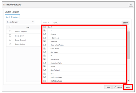

  9. Select the source locations you want to work with and click Finish.
    Figure 14-11 Workspace Wizard: Select Source Location

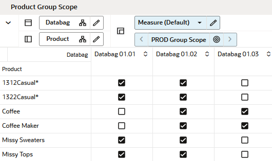

Product Group Scope View
The Product Group Scope View, under the Product Scope tab, allows you to select specific products to include in the scope of the databag if the databag level defined in the Enable & Setup view is either Local or All Product.
Figure 14-14 Product Group Scope View
Product Group Scope View - Default Profile Measures
The Product Group Scope view contains the following measure.
Product Group Scope
Product Group Scope is a checkbox measure used to select which products should be assigned to the databag.

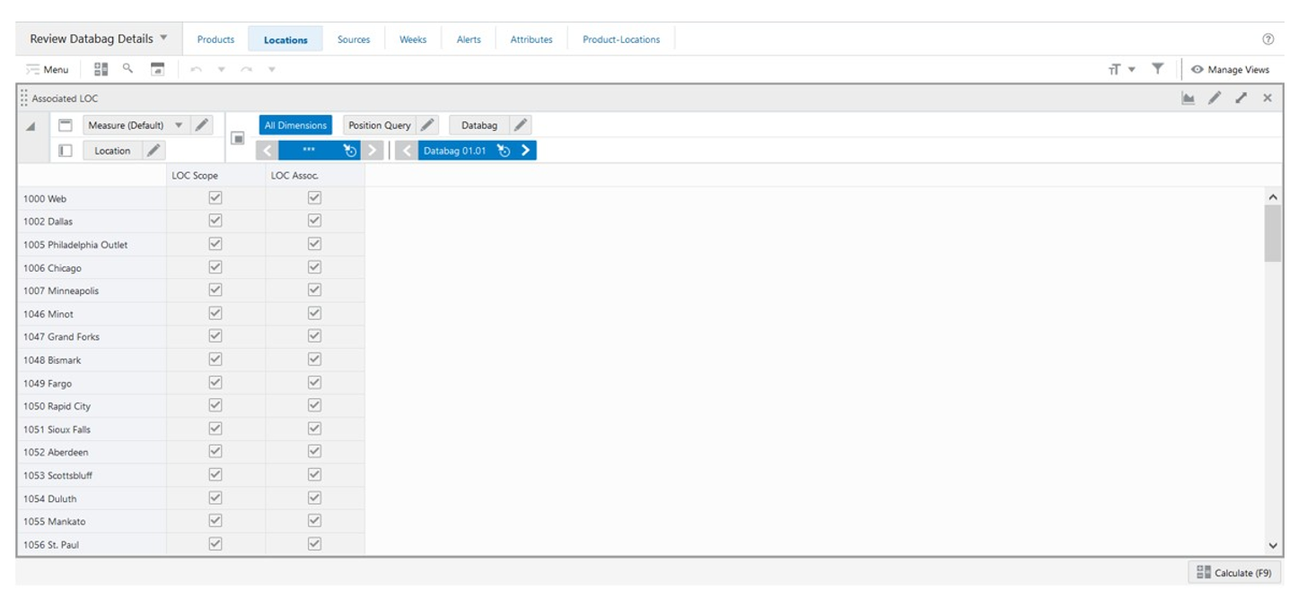

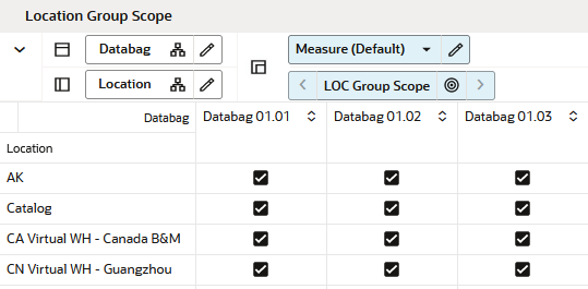

Location Group Scope View
The Location Group Scope View, under the Location Group Scope tab, allows you to select specific locations to include in the scope of the databag if the databag level is defined in the Enable & Setup view as either Local or All Location.
Figure 14-15 Location Group Scope View
Location Group Scope View - Default Profile Measures
The Location Group Scope view contains the following measure.
Location Group Scope is a checkbox measure used to select which locations should be assigned to the databag.

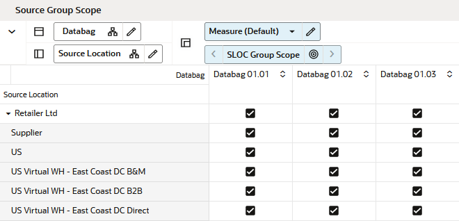

Source Group Scope View
The Source Group Scope View, under the Source Group Scope tab, allows you to select specific source locations, at the location group level, to be included in the scope of the databag.
Figure 14-16 Source Group Scope View
Source Group Scope View - Default Profile Measures
The Source Group Scope view contains the following measure.
Source Location Association Count Group Scope
Source Location Group Scope is a checkbox measure used to select which source locations should be assigned to the databag.

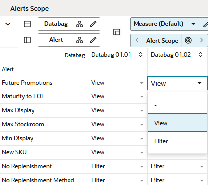

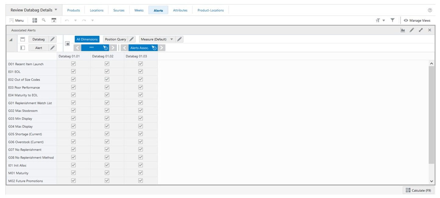

Alerts Scope View
The Alerts Scope View, under the Alerts Scope tab, allows you to select specific alerts to be included in the scope of the databag.
Figure 14-17 Alerts Scope View
Alerts Scope View
Alerts Scope View - Default Profile Measures
The Alerts Scope view contains the following measure.
Alert Scope
This measure allows you to select the alerts to be included in the databag scope and for which purpose they are used.
The valid values are:
  • _
    This empty value indicates that the alert should not be included in the databag.
  • View
    This value indicates that the alert should be included in the databag. The alert is then available in the Replenishment workspaces to aid in analysis and navigation. .
  • Filter
    This value indicates that the alert should be included in the databag scope and the alert is then available in the Replenishment workspace. Additionally, when the Filter values are selected, the scope of the databag is recalculated based on the product and alerts that match the alert.
    For example, if the alert New Item is included in the databag scope and set as a Filter value, the databag is recalculated and only the products associated with the New Item alert, within the defined product scope, are included in the databag. The remaining items are filtered out.

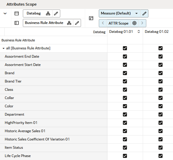

Attributes Scope View
The Attributes Scope View, under the Attributes Scope tab, allows you to select all or any specific product, location, or product-location attributes to be included in the scope of the databag.
Figure 14-18 Attributes Scope View
Attributes Scope View - Default Profile Measures
The Attributes Scope view contains the following measure.
Attribute Scope
Attribute Scope allows you to select which attributes should be included in the databag scope.
By default, if none of the attributes are selected for the databag then the calculation assumes that all attributes are available for the databag. If you select at least one attribute, then only the selected attributes are available for the databag.

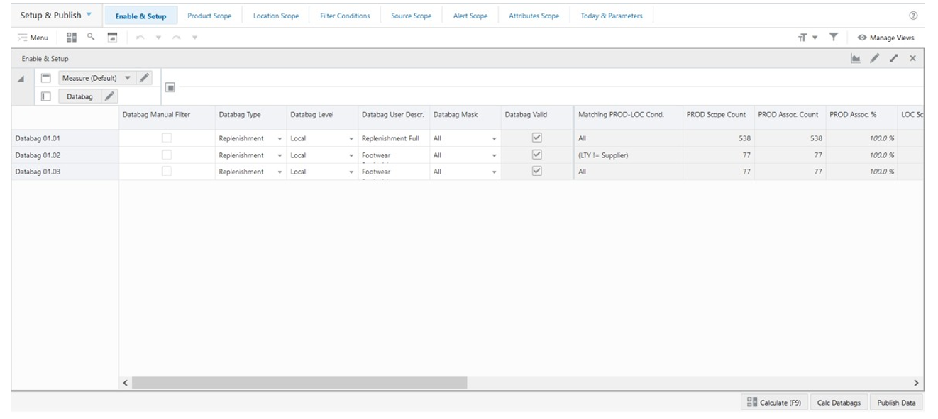

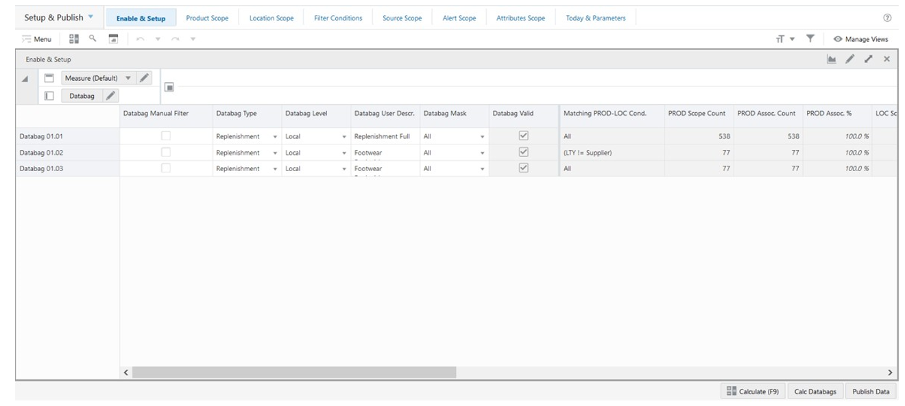

Enable & Setup View: Databag Review
The Enable & Setup View, under the Enable & Setup tab, allows you to select specific alerts to view databag statistics and enable or disable the databag. You can also set a meaningful label to the databag that can be used as a dimension attribute in the databag hierarchy.
Figure 14-19 Enable & Setup View: Databag Review
Enable & Setup View
Enable & Setup View: Databag Review - Default Profile Measures
The Enable & Setup view contains the following measures.
Databag Manual Filter
This is a checkbox measure that you can select or clear to filter all views of the workspace by the databags that are selected as manual filters. When selected, only the selected databags are available. In order to see all databags, no databag should be selected (This is the default behavior).
Databag Type
This measure allows you to enable or disable the databag. The valid values for this measure are:
  • Replenishment: The databag is used to open a Replenishment workspaces.
  • Off: The databag is unavailable.
Databag Level
This measure allows you to choose the level of Product-Location at which the databag is defined. The valid values for this measure are:
  • Local: The Product and Location scope of this databag is based on the set up of the scope defined in the Product Group Scope and Location Group Scope views.
  • All Product: The Product scope of this databag is all Products and it ignores the set up of the scope defined in the Product Group Scope view. While the Location is based on the set up of the scope defined in the Location Group Scope view.
  • All Location: The Product scope of this databag is based on the set up of the scope defined in the Product Group Scope view. While the Location scope is all Location, it ignores the set up of the scope defined in the Location Group Scope view.
  • Global: The Product and Location scope is based on all Products and all Locations and it ignores the set up of the scopes defined in the Product Group Scope and Location Group Scope views.
Databag User Description
Databag User Description is an editable measure used to modify the description of a databag. This databag description can be set as a Visible Attribute for databag hierarchy in any other workspace.
Databag Mask
This measure allows you to select additional filters for the Product and Location scope. The valid values for this measure are:
  • All: The Product and Location scope is based on the scope defined by you in the Product Group Scope and Location Group Scope views. No additional filtering is applied.
  • Associated Valid: The Product and Location scopes defined by you in the Product Group Scope and Location Group Scope views are filtered out if the product and location combination is not assorted. This way, only valid assortment combinations is part of the databag.
  • Lifecycle Valid: The Product and Location scopes defined by you in the Product Group Scope and Location Group Scope views are filtered out if the product and location combination does not have a valid lifecycle. For example, typically, warehouses are not assorted. Therefore they are excluded by the Assorted Valid mask. However, as warehouses source assorted products for one or more stores, then they have a valid lifecycle for the products.
Matching Product-Location Condition
Matching Product-Location Condition is a calculated measure that indicates the filter condition defined in the Filter Conditions view. If there is no condition defined, it displays All. Otherwise, it displays the string with the conditions defined in the Filter Conditions view.
Product Scope Count
Product Scope Count is a calculated measure that indicates the number of products based on the product groups selected in the Product Group Scope view and the databag mask value.
Product Association Count
Product Association Count is a calculated measure that indicates the number of products based on the product groups selected in the Product Group Scope view with the filter conditions applied and the databag mask value.
Product Association %
Product Association Percentage is a calculated measure that indicates the percentage of products that are being considered for the databag. It is calculated as:

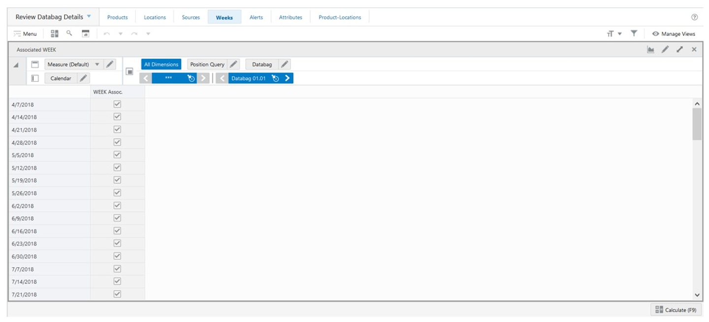

Week Association Count
Week Association Count is a calculated measure that indicates the number of weeks included in the databag scope.

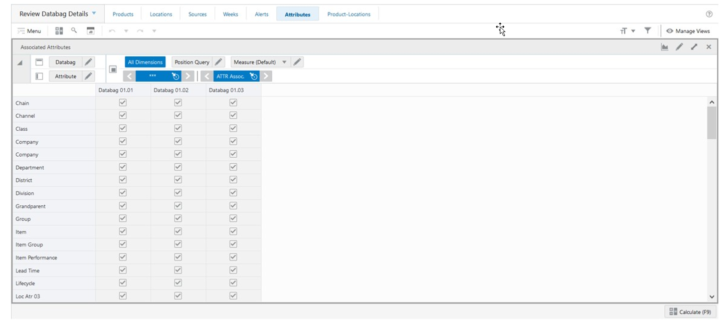

Attribute Association Count
ATTRIBUTE Association Count is a calculated measure that indicates the number of attributes (product, location or/and product-location attributes) included in the databag scope.

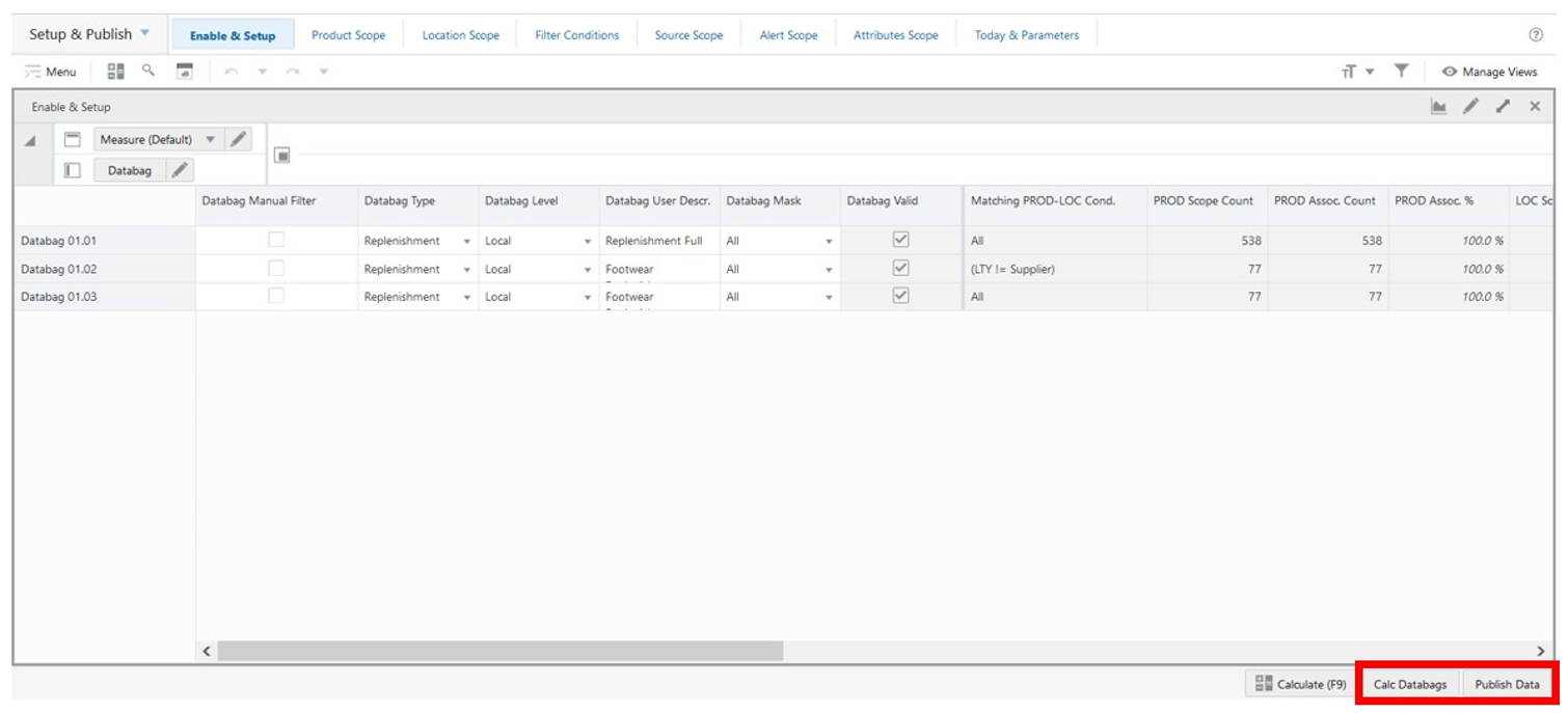

Last Databag Publish User ID
This is a calculated measure that audits the databag Publish Data button. It is populated with the user ID that last ran the Publish Data button.
Last Databag Publish Date
This is a calculated measure that audits the Publish Data button. It is populated with the date and time that last ran the Publish Data button.

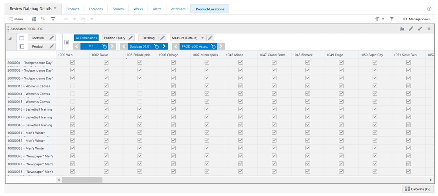

Filter Conditions View
This view allows you to define the conditions for the rules based in product, location, and product-location attributes. A rule condition is what allows the engine to find the product and location combinations where the rule is applicable.
Figure 14-22 Filter Conditions View
Filter Conditions View - Default Profile Measures
The Filter Conditions view contains the following measures.

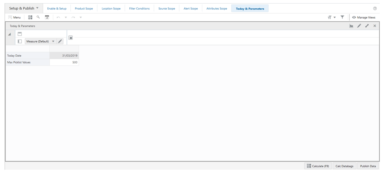

Today & Parameters View
The Today & Parameters View, under the Today & Parameters tab, allows you to review the system date and to maintain the maximum number of positions that can be loaded into the condition value measures in the Filter Condition view.
Figure 14-23 Today & Parameters View
Today & Parameters View - Default Profile Measures
The Today & Parameters view contains the following measure.
Maximum list Values
Maximum list Values allows you to set the maximum number of values that can be loaded into the condition values measure (list measures) in the Filter Condition view. The default value is 500.

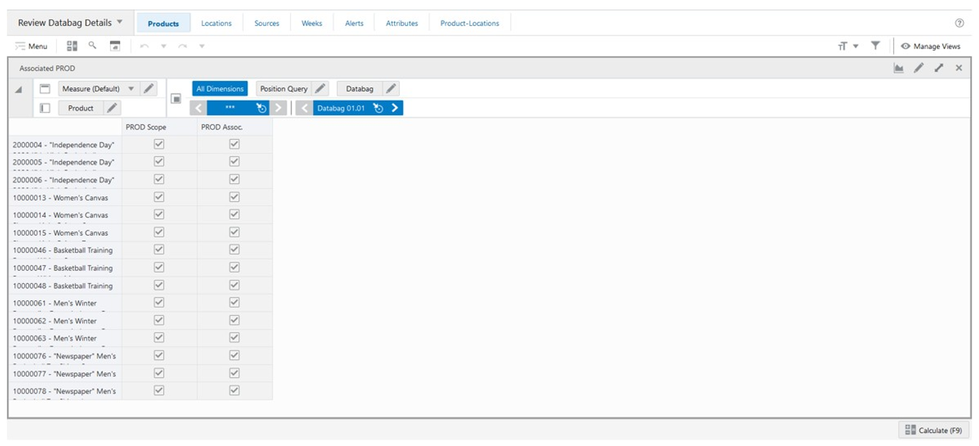

Associated Product View
The Associated Product View ,under the Products tab , allows you to review the products that are in scope and associated with the databag based on the databag set up.
Figure 14-24 Associated Product View
Associated Product View - Default Profile Measures
The Associated Product view contains the following measures.
Product Scope
Product Scope indicates if a product is in the databag scope. When selected, the product is in the databag scope. This indicates that the product met the filter conditions defined in the previous step. When clear, the product is not in the databag scope.
Product Association
Product Associated indicates if a product is associated with the databag. When selected, the product is associated with the databag. This indicates that the product was evaluated within the databag but does not meet the conditions of the filter evaluation. When clear, the product is not associated with the databag.
Associated Location View
The Associated Location View, under the Locations tab , allows you to review the locations that are in scope and associated with the databag based on the databag set up.
Figure 14-25 Associated Location View
Associated Location View - Default Profile Measures
The Associated Location view contains the following measures.
Location Scope
Location Scope indicates if a location is in the databag scope. This indicates that the location met the filter conditions defined in the previous step. When selected, the location is in the databag scope. When clear, the location is not in the databag scope.
Location Associated indicates if a location is associated with the databag. When selected, the location is associated with the databag. This indicates that the location was evaluated within the databag but does not meet the conditions of the filter evaluation. When clear, the location is not associated with the databag.

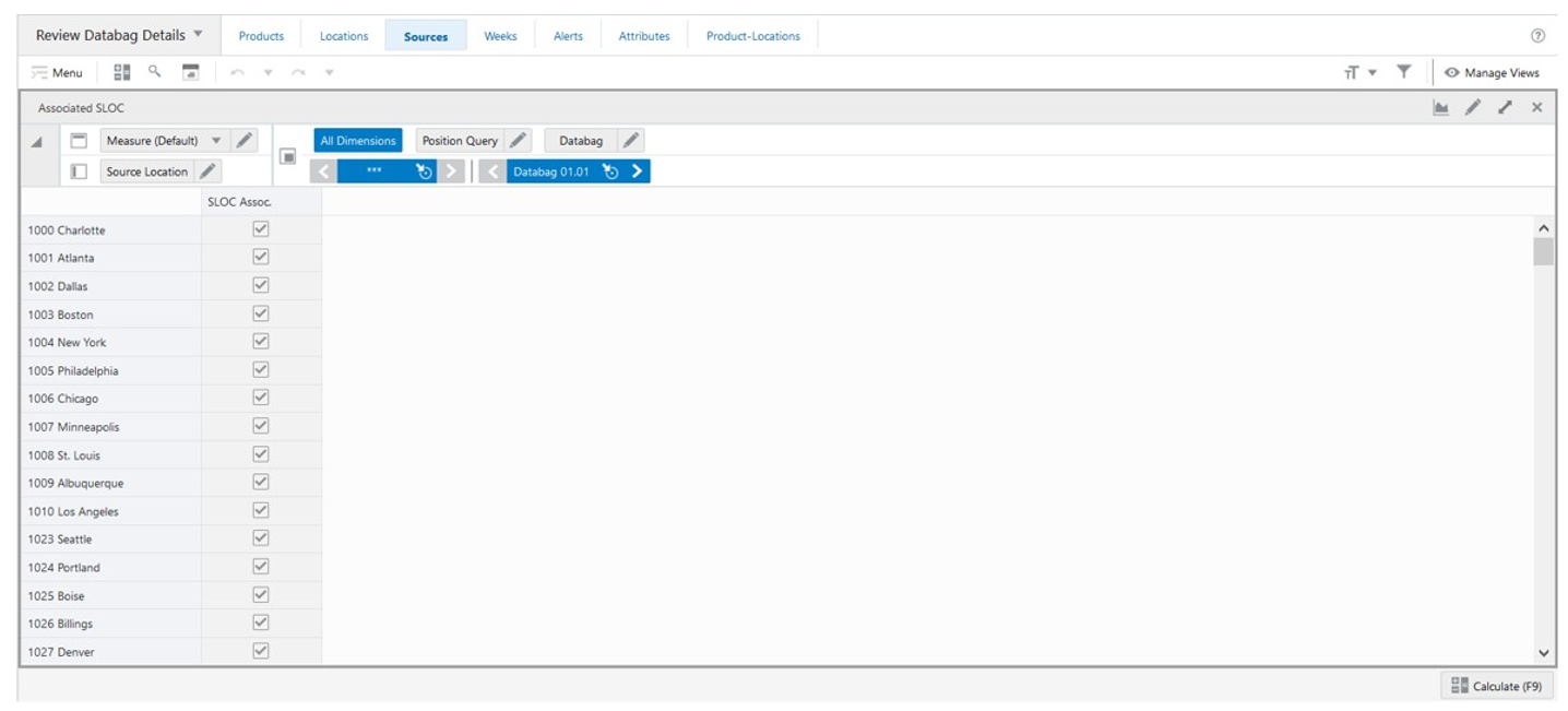

Associated SLOC (Source Location Association Count) View
The Associated SLOC View, under the Sources tab, allows you to review the source locations that are in scope and associated with the databag based on the databag set up.
Figure 14-26 Associated SLOC View
Associated SLOC View - Default Profile Measures
The Associated SLOC view contains the following measure.
SLOC Association
Source Location Associated indicates if a source location is associated with the databag. When selected, the source location is associated with the databag. This indicates that the source location was evaluated within the databag but does not meet the conditions of the filter evaluation.When clear, the source location is not associated with the databag.
Associated Week View
The Associated Week View, under the Weeks tab, allows you to review the weeks that are associated with the databag based on the past and the future number of weeks entered in the databag set up.
Figure 14-27 Associated Week View
Associated Week View - Default Profile Measures
The Associated Week view contains the following measure.
Week Association
Week Associated indicates if a week is associated with the databag. When selected, the week is associated with the databag. When clear, the week is not associated with the databag.
Associated Alerts View
The Associated Week View, under the Alerts tab, allows you to review the alerts that are associated with the databag based on the databag alert scope.
Figure 14-28 Associated Alerts View
Associated Alerts View - Default Profile Measures
The Associated Alerts view contains the following measure.
Alerts Association
Alerts Associated indicates if an alert is associated with the databag. When selected, the alert is associated with the databag. When clear, the alert is not associated with the databag.
Associated Attributes View
The Associated Attributes View, under the Attributes tab, allows you to review the attributes associated with the databag based on the databag attributes scope.
Figure 14-29 Associated Attributes View
Associated Attributes View - Default Profile Measures
The Associated Attributes view contains the following measure.
Attribute Associated indicates if an attribute is associated with the databag. When selected, the attribute is associated with the databag. When clear, the attribute is not associated with the databag.
Associated Product-Location View
The Associated Product-Location View, under the Product-Locations tab, allows you to review product-location combinations that are associated with the databag based on the databag set up.
Figure 14-30 Associated Product-Location View
Associated Product-Location View - Default Profile Measures
The Associated Product-Location view contains the following measure.
Product-Location Association
Product-Location Associated indicates if a product-location combination is associated with the databag. When selected, the product-location combination is associated with the databag. When clear, the product-location combination is not associated with the databag.

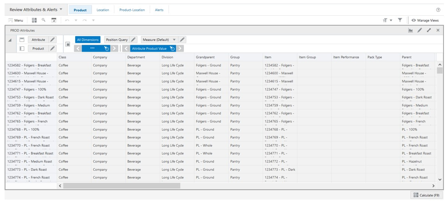

Product Attributes View
The Product Attributes View, under the Product tab, allows you to review the product attribute values.
Figure 14-31 Product Attributes View
Product Attributes View - Default Profile Measures
The Product Attributes view contains the following measure.
Attribute Product Value
This measure displays the product attribute values.

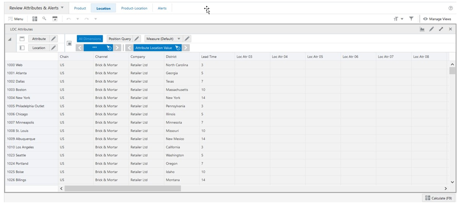

Location Attributes View
The Location Attributes View, under the Location tab, allows you to review location attribute values.
Figure 14-32 Location Attributes View
Location Attributes View - Default Profile Measures
The Location Attributes view contains the following measure.
Attribute Location Value
This measure displays the location attribute values.

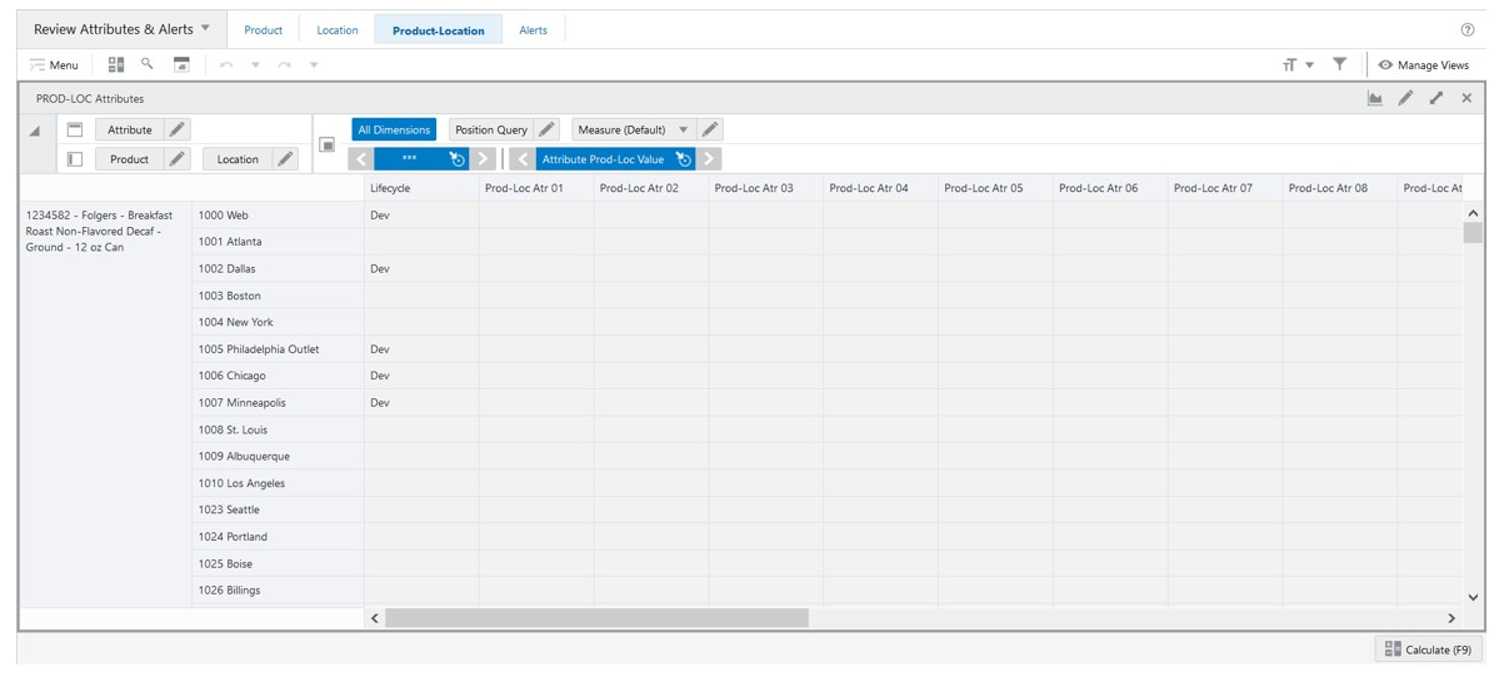

Product-Location Attributes View
The Product-Location Attributes View, under the Product-Location tab, allows you to review product-location attribute values.
Figure 14-33 Product-Location Attributes View
Product-Location Attributes View - Default Profile Measures
The Product-Location Attributes view contains the following measure.
Attribute Product-Location Value
This measure displays the product-location attribute values.

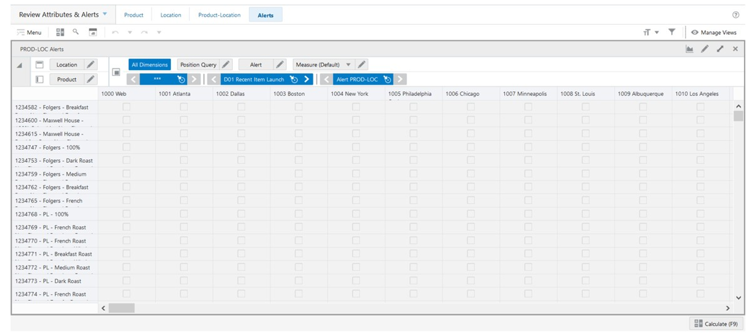

Product-Location Alerts View
The Product-Location Alerts View, under the Alerts tab, allows you to review which alerts are assigned per product-location.
Figure 14-34 Product-Location Alerts View
Product-Location Alerts View - Default Profile Measures
The Product-Location Alerts view contains the following measure.
Manage Databag Action Buttons
The Manage Databag workspace has the following action buttons available:
  • Calculation Databags
    Use the Calculation Databags action button to calculate the databag scope based on all the set up you created. The result is the Boolean measure that is used by the Replenishment workspace to load the correct scope of products, locations, source locations, attributes and alerts.
  • Publish Data
    Use the Publish Data action button to commit the changes made in the Manage Databag workspace. It also saves the audit information of the update and commits the measures Last Databag Publish User ID and Last Databag Publish Date based on who and when the Publish Data was last run.
  • Validate Databag
    Use the Validate Databags action button after you make the desired setup for the databags. If there are no errors, you can run the Calculate Databags action button to create the databags.
  • Lookup Attributes
    Use the Lookup Attributes action button to populate the relevant attribute values when setting up the rule conditions.
The sequence of actions in the Manage Databag workspace is expected to be:
  1. Build workspace.
  2. Click Lookup Attributes action button if you want to set up rules or you want to perform What-if.
  3. Set up rule conditions.
  4. Click Validate Databag action button.
  5. If no errors, click Calculate Databag action button.
  6. View results.
