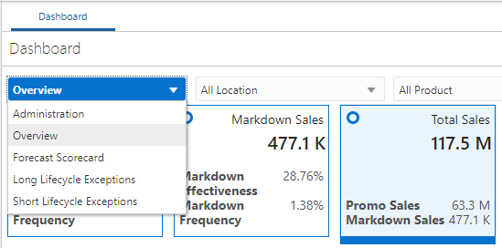

Figure 4-1 shows the IPOCS-Demand Forecasting / IPOCS-Lifecycle Allocation and Replenishment Dashboard as seen in the UI. It consists of two Metric profiles and two Exception profiles.
Figure 4-1 IPOCS-Demand Forecasting / IPOCS-Lifecycle Allocation and Replenishment Dashboard

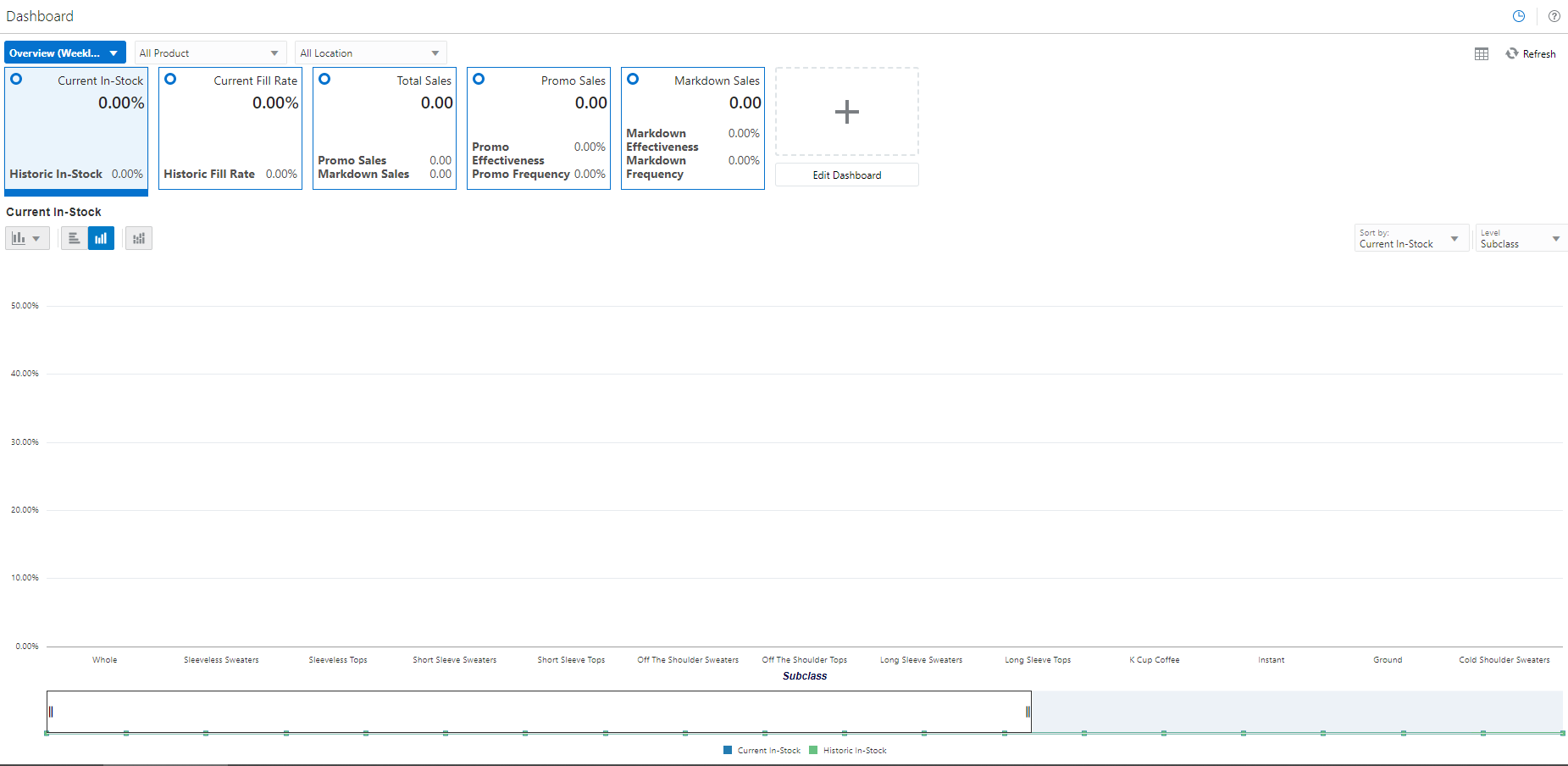

In Figure 4-2, the Overview Metric profile is selected and the Total Sales tile is highlighted with two sub-measures: Promo Sales and Markdown Sales.
Figure 4-2 IPOCS-Demand Forecasting / IPOCS-Lifecycle Allocation and Replenishment Dashboard Selection
IPOCS Forecasting Dashboard Selection
Note that the Exception profiles consist of Exception Tiles, and the Metric Profile consists of metric tiles of the type Comparison Tile. Currently IPOCS-Demand Forecasting does not support the Variance Metric tile.

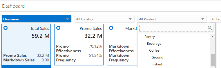

Dashboard Intersection
The IPOCS-Demand Forecasting / IPOCS-Lifecycle Allocation and Replenishment GA Dashboard workbook is built at the Sub-class, District level which is controlled by the Dashboard Intersection specified in the Common plug-in. Refer to Configuring the IPOCS-Demand Forecasting / IPOCS-Lifecycle Allocation and Replenishment Solution The Dashboard intersection also defines the level to which we can drill down the Product and Location filters in the Dashboard.
Figure 4-3 Product / Location Filters in the Dashboard
Product Location Filters in the Dashboard
