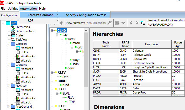

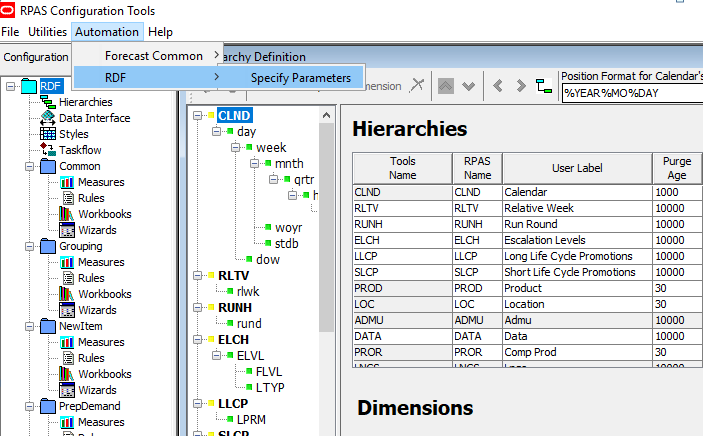

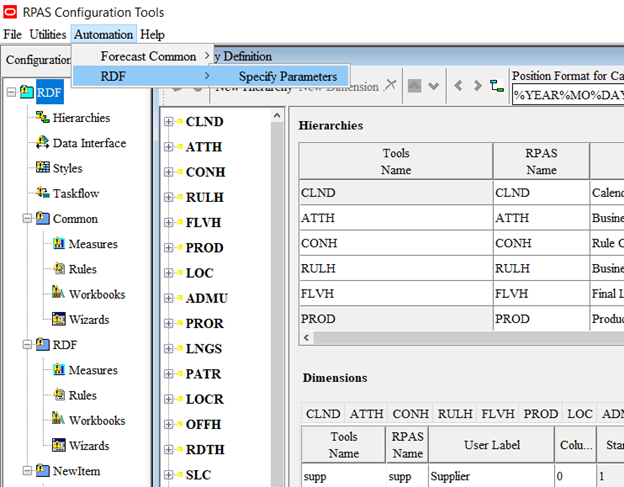

Set Up Common Configuration Details
From the Configuration Tools toolbar, select the Automation menu and then from the Forecast Common option, select Specify Configuration Details.
Figure 3-1 Configuration Tools: Forecast Common
Figure 3-2 Select Common Input
Select Common Input

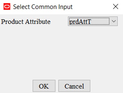

In this step we specify the common input to both New Item and IPOCS-Demand Forecasting / IPOCS-Lifecycle Allocation and Replenishment.
The product attribute measure to be used in the IPOCS-Demand Forecasting / IPOCS-Lifecycle Allocation and Replenishment and New Item solutions has to be specified in the Common Plug-in. The product attribute measure stores the attribute position name and not the attribute label.

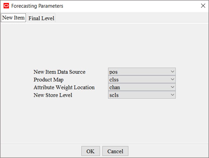

  1. From the Configuration Tools toolbar, select the Automation menu and then, from the IPOCS-Demand Forecasting / IPOCS-Lifecycle Allocation and Replenishment option, select Specify Parameters.
    Figure 3-3 Configuration Tools: New Item
  2. From the Like Item Parameters utility, specify the properties for the New Item plug-in. Refer to Editing New Item Parameters for details.
    Figure 3-4 Like Item Parameters
  3. Click OK once editing is finished.
Table 3-3 lists the New Item parameters available for editing.
Table 3-3 New Item Parameters
Parameter Description
New Item Data Source
Sales data used to generate forecast for New item/store.
Product Map
This field specifies the range of the like item available to a new item. If the field is populated with clss, it means that only existing items under the same class as the new item are available as like item candidate. The Similarity Score calculation should only be performed between the new item and existing items with in the class.
Attribute Weight Location
Allows you to specify which location level that the attribute weight used in similarity score calculation will be based on. The attribute weight measure intersection is to be on product Map/attribute-weight-loc/patt. In GA, it is clss/chan/patt.
New Store Level
This field specifies the product level on which like store is assigned to new store. If the field is selected as scls, it means that the like store assignment can be different per subclass.

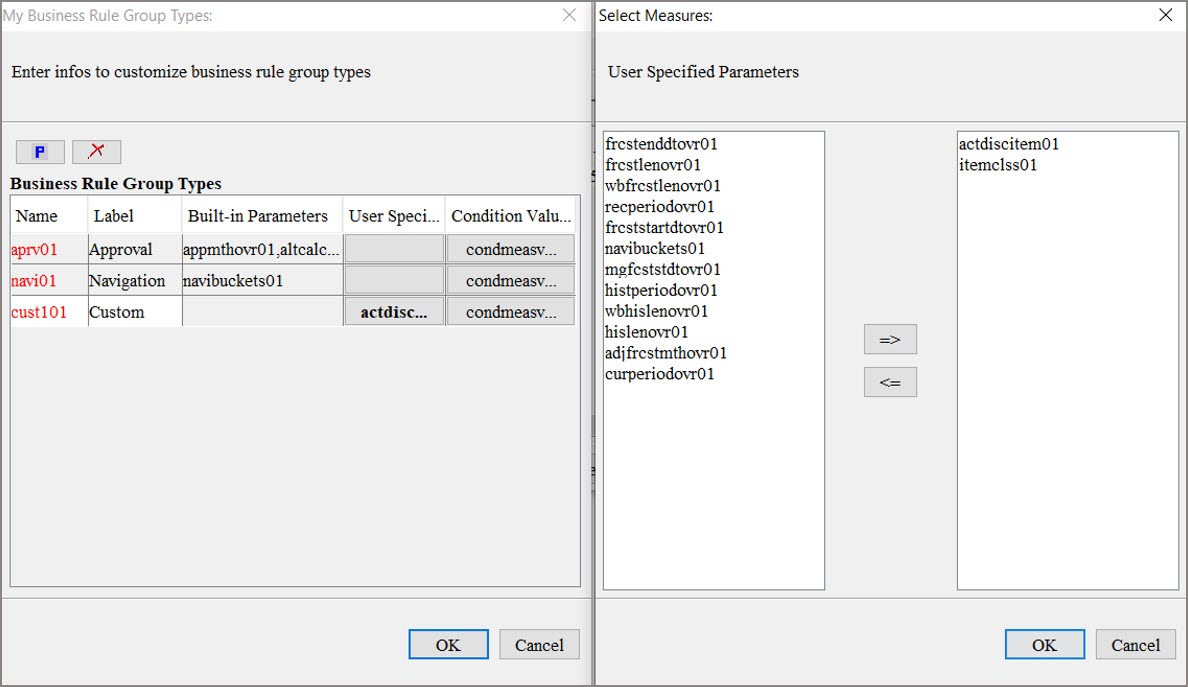

Configure My Business Rule Group Type
Click within a My Business Rule Group Type cell to configure the business rule group types. Business Rule Group Type is a IPOCS-Demand Forecasting / IPOCS-Lifecycle Allocation and Replenishment internal dimension that is part of the Final Level Hierarchy. The Final Level hierarchy file is generated by an IPOCS-Demand Forecasting / IPOCS-Lifecycle Allocation and Replenishment plug-in. There are two dimensions: rulegroup-type and final level.The dimension, rulegroup-type rolls up to the final level dimension. There are two GA rulegroup types per final level, Approve and Navigation.
You can specify additional custom rulegroup types using the IPOCS-Demand Forecasting / IPOCS-Lifecycle Allocation and Replenishment plug-in. Each final level can have its own custom rulegroup type. The Final Level hierarchy data file is generated at domain build/patch time.
The business rule group type table is created with two default rows. The Name and Build-in Parameters are read only. Aprv01 is for approval. It is a rule group type designed for approval process.
The built-in Parameters are:
  • Approve method at final
  • Alert window at final
  • Alert error threshold at final
The rule group type, navi01, is designed for tiered navigation in Forecast Review workbook.
Click P to add more custom rule group types. The name need to be unique across all final levels and thus it is good practice to append level number at the end. Click X to remove custom rule group types.
User specified Parameters per rule group type can be specified by an implementor if additional parameters need to be included. The parameters are associated with business rule group type so that the values for a certain sku/store can be assigned to a set of value for a business rule which the sku/store belongs.
Click within the cell of user specified parameters to open the dialog that allows you to add or remove parameters. The Select Measures box in Figure 3-8 displays all GA parameter measures. Most of these measures are forecasting parameter at final. Any custom measures with intersection = forecast intersection without the clnd dimension and have a valid db will be available for selection too. For each selected measure, a measure at business rule is created and added to the parameter for <rule group type> worksheet for user input.
Figure 3-8 Select User Specified Parameters

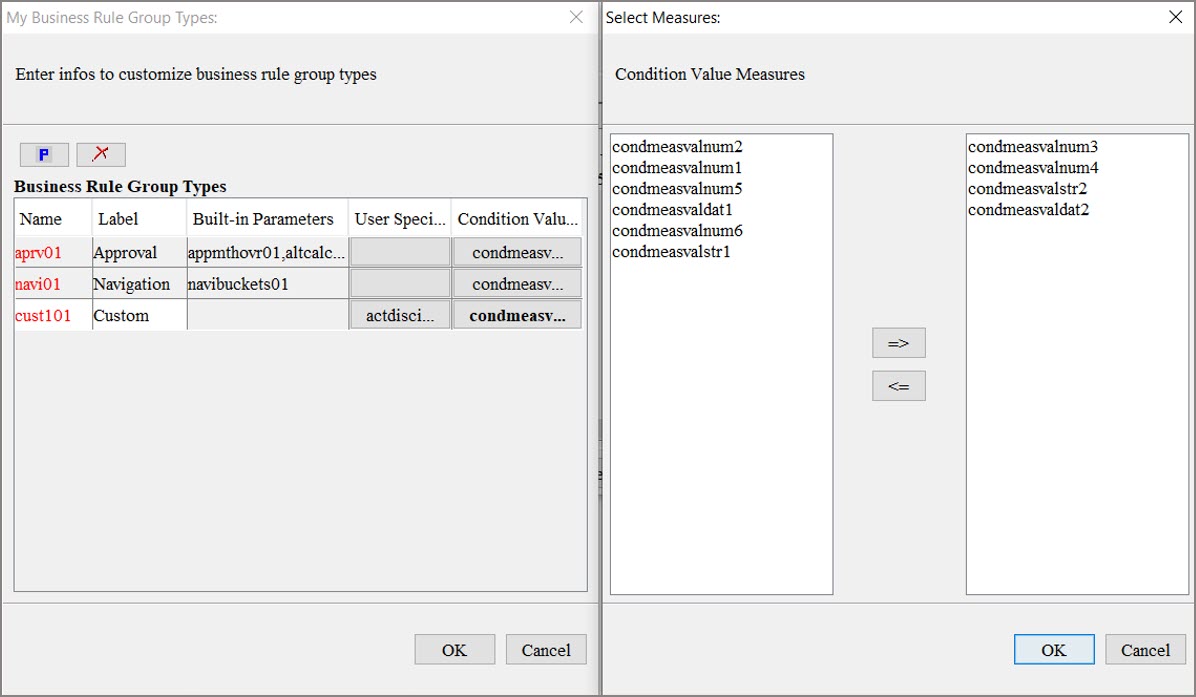

Click within the condition value cell to open the dialog that allows you to select the condition value measures to be used. The measures available for selection are the ten condition measures GA provides and any custom non-boolean measure that have an intersection higher than forecast intersection without the clnd dimension and have a valid db. The selected measure are used to construct the picklist for condition value (measure) in the Rule Setup workbook.
Figure 3-9 Select Condition Value Measures

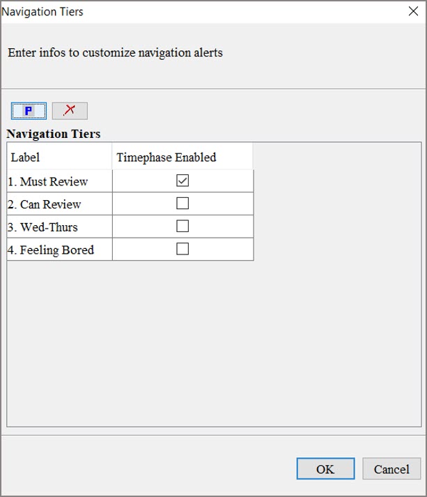

Configure Navigation Tiers
Navigation in the Forecast Review workbook is now tiered. You can decide how many tiers and what is the rule to associate a sku/stores to a tier. There is a corresponding workbook alert associated with each tier. By switching between workbook alerts, you can jump between sku/stores with a different priority to be approved.
Click within the navigation-tier cell to display the dialog that allows you to add or delete a tier.
Click P to add more tiers. implementors can enter the label of the tier and indicate if a time-phase workbook alert is enabled or disabled.
Click X to remove tiers.
For each tier, a workbook alert at prod/loc is created in the Forecast Review workbook. If time-phased is enabled, an additional workbook alert at prod/loc/clnd is created in the Forecast Review workbook.
Figure 3-10 Select Navigation Tiers

Perform the following steps to generate an IPOCS-Lifecycle Allocation and Replenishment solution:
  1. From the Configuration Tools toolbar, select the Automation menu, and then from the IPO option, select Specify Parameters.
    Figure 3-11 Configuration Tools Toolbar
    Config Tools Screen Image

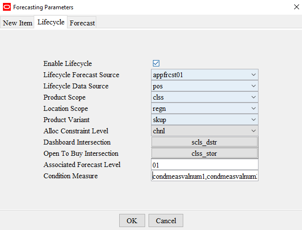

  2. Select the Lifecycle tab to configure the various parameters for -Lifecycle Allocation and Replenishment .
    Figure 3-12 Lifecycle Tab — Forecast Parameters
    Lifecycle tab — Forecast Parameters
  3. Edit the Lifecycle Parameters. Once editing is finished, click OK.
    The following table lists the Lifecycle parameters available for editing.
    Table 3-6 Lifecycle Parameters
    Enable Lifecycle
    Boolean that indicates if the Lifecycle taskflow is visible in the UI and whether the Lifecycle batch is run.
    Lifecycle Forecast Source
    The measure that holds the forecast feed to Lifecycle (if not specified, by default use appfrcst01).
    Lifecycle Data Source
    The measure that holds the sale history feed to Lifecycle (by default use pos).
    Product Scope
    The product dimension to base the product scope on (by default use class).
    Location Scope
    The location dimension to base the product scope on (by default use region).
    Product Variant
    The product dimension to base the product variant definition on (by default use skup – sku parent).
    Alloc Constraint Level
    The location dimension that the allocation constraint is based on (by default use channel).
    Dashboard Intersection
    The intersection that the Lifecycle worksheets in a dashboard workbook should be based on. (by default use scls_dstr).
    Open To Buy Intersection
    The intersection that the open to buy measure should be based on. (by default use clss_stor).
    Associated Forecast Level
    This is the final level from the demand forecast module associated to the attributes used in the Lifecycle module. Note that the Business Rule Attribute measures are per final level, hence it is important to use the correct set of attribute measures.
    Condition Measures
    This is a list of condition value measures that can be used in the rule condition setups in the Lifecycle module. Apart from GA condition measures, custom measures can be added too. Remember to load the range measures LPPmDtbCndValRg and LPPmRulCndValRg. LPPmDtbCndValRg is used to populate the Condition Value Measure picklist in the Databag Review, whereas LPPmRulCndValRg is used in the condition measure value drop down in Network and Replenishment Parameters workspace. These files are loaded by the GA batch control process, but the files need to be created by the implementer.

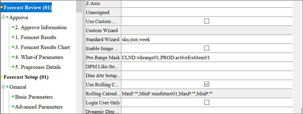

RPASCE Rolling Calendar
IPOCS-Demand Forecasting / IPOCS-Lifecycle Allocation and Replenishment has enabled an RPASCE Rolling Calendar feature for the Forecast Review workbook templates. Refer to the Oracle Retail Predictive Application Server Cloud Edition Configuration Tools User Guide for more details.
In essence this allows us to define a calendar window based on RPAS_TODAY. The main use case for this feature is for auto workbook builds, where in the calendar window advances based on RPAS_TODAY.
Figure 3-13 Rolling Calendar
Rolling Calendar
Out of the four rolling calendar range measures, only the Minimum Future has been set to the Alert Calculation window. This is set during the forecast batch.
The Minimum Past defaults to 0, which means it is not required to pull in any week prior to TODAY.
The Maximum Past and Maximum Future are also not set and will default to the current Calendar pre-range.
The rolling calendar feature is not extensible and implementors cannot edit the rolling calendar range measures.

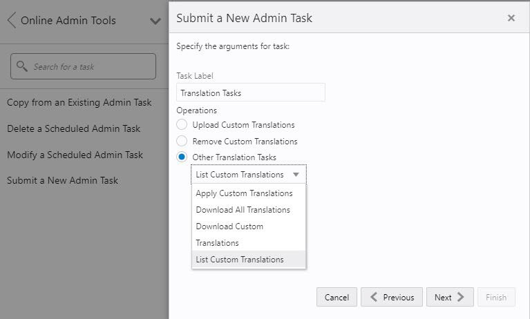

Perform the following steps to access the position names to create the locale specific file:
  1. Make sure the browser locale is English - United States
  2. From the OAT configure batch task, go to the Translation Task and then, Download All Translations.
  3. The r_msglabel.csv.ovr file contains the English labels as updated by the implementor in the IPOCS-Demand Forecasting / IPOCS-Lifecycle Allocation and Replenishment plug-in.
  4. This file can serve as an example to create the locale specific r_msglabel file.
  5. The locale specific file can contain only the records with the updated labels.
  6. Revert the browser language to the original locale.
  7. Upload the locale specific r_msglabel.csv.ovr file using the Translation Task .
    Figure 3-14 Translation Tasks
    Translation Tasks
