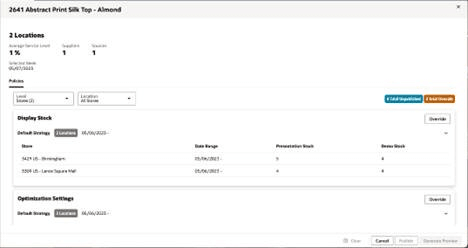

The Level and Location fields permit navigation up and down the supply chain for the product and selected week.
The Level field provides selection of the supply chain tier, for example, Warehouses or Stores.
You can select an individual or all of the locations within the selected level in the Location field. The location selection field is used to not only view policies but also to define the locations to which a policy edit will apply.

Policy Tables
Each policy type will have a card on the Policies tab.
If policy types are defined or overridden, then they are displayed in a table. If none are defined, then an Override button is still available.
All tables share a common layout, including columns for:
Columns Explanation
Stores/Warehouses The locations that have defined policies.
Data Range The dates for when the policy applies. Note that it is possible to not specify an end date if the policy is continual.
Policy Values One column is providedfor each field that is part of the policy (for example, Presentation Stock).
Default rule values are displayed within the white Default Strategy tables.
All policy changes that have been made and published in the Inventory Planning application will be displayed in the table.
Only data that is after today's date can be deleted or edited.

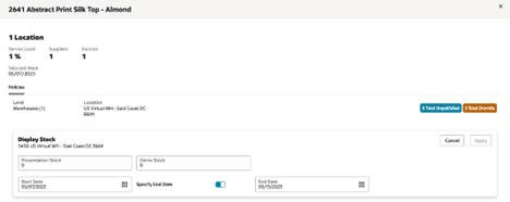

Use the Override button to input new policy overrides for the locations selected in the Locations field.
Click the Override button to display an edit area.
Figure 1-22 Override Button
Override Button
The Edit Area displays a number of fields that can be specified for the relevant policy type, including:
  • Policy Fields:Fields that can each be altered.
  • Start Date:The first date of the alteration.
  • Specify End Date:A switch that allows no end date to be specified.
  • End Date:The last date of the alteration (not displayed if the Specify End Date is toggled off).
All alterations must overlap with the AO Panel's Selected Week.
