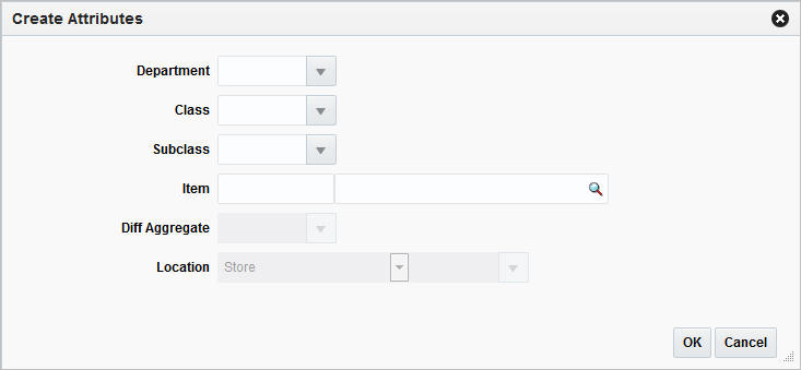

Creating Attributes
The Merchandising replenishment attributes are held at the item/location level. However, Merchandising supports activating, updating, and deactivating items for replenishment at numerous levels, using item lists, location lists, parent items, and so on. Any stockholding location, including company and franchise stores, and virtual warehouses, can be placed on replenishment.
To create replenishment attributes follow the steps listed below.
From the Tasks menu, select Replenishment > Create Attributes. The Create Attributes window appears.
Figure 2-1 Create Attributes Window
In the Department field, enter, select or search for the desired department.
In the Class field, enter, select or search for the desired class.
In the Subclass field, enter, select or search for the desired subclass.
In the Item field, enter, select or search for the item to be replenished.
In the Diff Aggregate field, enter, select or search for the differentiator associated with the selected item.
This field is only enabled, if the Diff Aggregate Indicator is selected for the item chosen for replenishment.
In the Location field, select the location type from the list. Then enter, select or search for the location ID.
Check the Rebuild Location List checkbox, if you wish to rebuild the location list.
This field is only enabled, if you have selected location list as location type.
Then choose one of the following options.
Click OK to create the attribute. The Replenishment Attributes window appears in a new tab.
For more information about the Replenishment Attributes window, see the Replenishment Attributes Window section.
Also the location list will be rebuilt, if you have selected the Rebuild Location List checkbox.
Click Cancel to reject all entries and close the window.

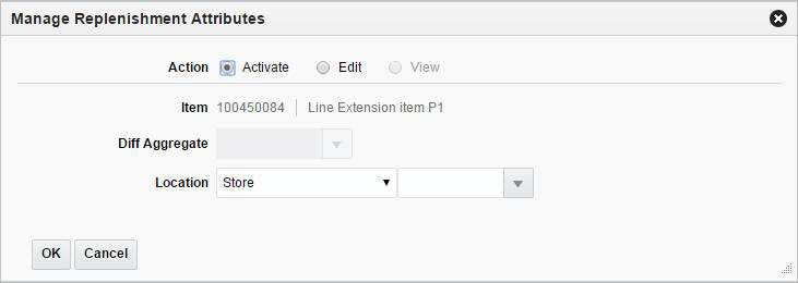

Managing Attributes at the Item Level
To manage attributes at the item level, item child level or item child by diff level, follow the steps below.
From the Tasks menu, select Items > Manage Items. The Item Search window appears.
Enter or select search criteria as desired to make the search more restrictive.
Click Search. The items that match the search criteria are displayed in the Results section.
In the Item column, click the item link, or mark a record and select Actions > Edit, or use the Edit icon
. The Item window appears.
For Items:
Select More Actions > Replenishment. The Manage Replenishment Attributes window appears.
For Item Children:
Select More Actions > List Children. The Item Children or Item Children by Diff window appears.
Then select Actions > Replenishment. The Manage Replenishment Attributes window appears.
Figure 2-2 Manage Replenishment Attributes
Select if you want to activate, edit or view the replenishment attributes for the item.
The Item field displays the item number and description of the selected item.
This field is enabled only if the Diff Aggregate Indicator is selected for the item chosen for replenishment.
In the Location field, select the location type from the list. Then enter, select or search for the location.
This field is only enabled, if you have selected Location List as location type.
Select the Update from Master checkbox, to update the item/location from the existing master replenishment attributes, if available.
The checkbox is only available if you have selected Edit as action.

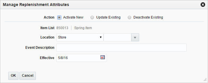

Managing Attributes at the Item List Level
To manage attributes at the item list level, follow the steps below.
From the Tasks menu, select Foundation Data > Items > Manage Item Lists. The Item List Search window appears.
Click Search. The item lists that match the search criteria are displayed in the Results section.
Select a record in the Results section.
Then select Actions > Mass Change > Replenishment. The Manage Replenishment Attributes window appears.
Figure 2-3 Manage Replenishment Attributes
Select if you want to activate new, update existing or deactivate replenishment attributes for the item list.
The Item List field displays the selected item list number and description.
In the Event Description field, enter the event description.
In the Effective field, enter an effective date for the replenishment attribute or use the Calendar icon to select an effective date.
The checkbox is only available if you have selected Update Existing as action.

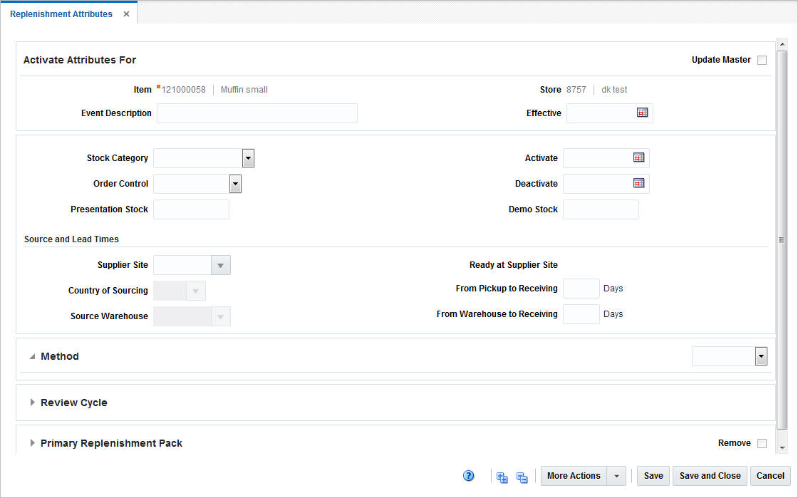

The Replenishment Attributes window allows you to add, edit, and view various replenishment parameters for the defined merchandise hierarchy and location hierarchy level.
In order to set up the replenishment parameters, you need to carry out the following functions in this window:
Select the stock category and type of order control
Specify effective dates
Define source and lead time days
Specify replenishment method and parameters
Determine the replenishment review cycle.
When you update the replenishment attributes for an item, you can choose to update the Master Replenishment Attributes at the same time.
The Replenishment Attributes window consists of the following sections:
Figure 2-4 Replenishment Attributes Window
Header
The title of this section indicates the mode, in which you enter the window, for example, possible headers are Activate Attributes For, Deactivate Attributes For or View Attributes For.
The Header section contains the Update Master checkbox and the values you entered in the Create Attributes window in addition to other fields.
For more information about how to create attributes, see the Creating Attributes section.
Table 2-1 Attributes For - Fields and Description
Fields | Description |
Update Master checkbox |
Check the Update Master checkbox to indicate that you want to update the master replenishment attributes with the replenishment attributes you are adding or updating. |
Department |
Only enabled for department, department/class, or department/class/subclass level maintenance. View only field. You cannot edit this field. Displays the value entered in the Create Attributes window. |
Class |
Only enabled for department/class or department/class/subclass level maintenance. View only field. You cannot edit this field. Displays the value entered in the Create Attributes window. |
Subclass |
Only enabled for department/class/subclass level maintenance. View only field. You cannot edit this field. Displays the value entered in the Create Attributes window. |
Item |
Only enabled for item or item/diff aggregate level maintenance. View only field. You cannot edit this field. Displays the value entered in the Create Attributes window. |
Diff Aggregate |
Only enabled for item/diff aggregate level maintenance. View only field. You cannot edit this field. Displays the value entered in the Create Attributes window. |
Item List |
Only enabled for item list level maintenance. View only field. You cannot edit this field. Displays the value entered in the Create Attributes window. |
Event Description |
This field contains the scheduled replenishment event description, entered in the Create Scheduled Update or Manage Replenishment Attributes window. Edit the event description, if necessary. |
Location |
Displays the location type and location ID. When the location type is All Stores or All Warehouses, the location ID field is disabled. View only field. You cannot edit this field. Displays the value entered in the Create Attributes window |
Created |
Displays the created date and created by values. View only field. You cannot edit this field. |
Effective |
Displays the effective date for when the scheduled event will take place. Enter the effective date or use the Calendar icon to select a date. |
Stock Category |
The Stock Category refers to the method in which merchandise is sourced and delivered to a location on replenishment. Valid values are Direct to Store, Cross-Docked, Warehouse Stocked, and WH/Cross Link. For example, select Cross-Docked. Select the stock category from the list. |
Order Control |
The Order Control parameter determines whether or not purchase orders and transfers should be created during the replenishment process, and if so, in what status they should be created. Valid values are Manual, Buyer Worksheet, Semi Automatic and Automatic. Select the order control method from the list. |
Store User Access |
Allows specification of the default access that a store user should have in terms of updating and approving semi-automatic single location store orders & transfers. The dropdown will support three distinct values namely Restricted, Review and Approve |
Store Tolerance Type |
Allows specification of a Tolerance type that should be applicable for store edits to the replenishment quantity for the item-location. Options available are include Percentage and Units. This field works in conjunction with the Store Tolerance Limit |
This parameter determines the value of the Tolerance Limit specified by the Store Tolerance Type field. Will be assumed to be expressed in % if the Store Tolerance type is Percentage and with units if the Store Tolerance type is units. |
Presentation Stock |
Presentation Stock is the minimum amount of stock required to fill a facing in the store. Merchandising uses the presentation stock as a component in the determination of net inventory and order quantity calculations, as at a minimum replenishment tries to ensure shelves are full. Enter the quantity of the presentation stock for the item. Replenishment algorithm uses the presentation stock quantity in calculating ROQ. |
Activate Date |
The Activate Date is the date on which an item/location becomes active for replenishment. Enter an activate date or use the Calendar icon to select a date. |
Deactivate Date |
The Deactivate Date is the date on which an item/location becomes inactive for replenishment. Enter a deactivate date or use the Calendar icon to select a date. |
Demo Stock |
Demo Stock is the quantity of an item at a location considered not available for sale. Commonly, this is used for a particular product that is made available to customers to demo in the store but could be used for other purposes as well. Enter the quantity of the demonstration stock for the item. The replenishment algorithm uses the demo stock quantity in calculating ROQ. This field is not required when you are adding replenishment attributes for an item at a warehouse. |

The method Store Orders enables the following fields.
Table 2-8 Store Orders - Fields and Description
Apply Size Profile checkbox |
The Size Profile function is used for fashion items. If you set up replenishment parameters for a style/color item (item parent/diff), selecting this checkbox spreads the minimum and maximum value entered for the parent item /diff, based on the size profile of the transaction items. |
Reject Past Due Orders |
This attribute determines whether or not Merchandising will accept store orders that are received ‘late', meaning that the requested date for the store order is after the next delivery date. Select, if you want to reject past due orders. |
Scaling Exempt |
Select, if you do not want to use scaling. |
Maximum Scale Amount |
Enter the maximum scale amount. |
Review Cycle
The Review Cycle section allows you to select the frequency that the item is reviewed for replenishment.
Table 2-9 Review Cycle - Fields and Description
Review |
The review cycle defines the scheduled time in days between examinations of inventory by Merchandising replenishment for reorder opportunities. Select the time span for the review cycle from the list.
Day of the Week checkboxes |
Select the corresponding day/days for review. |
Primary Replenishment Pack
The Primary Replenishment Pack section allows you to define the primary replenishment pack. The section contains the following fields and checkbox.
Table 2-10 Primary Replenishment Pack - Fields and Description
Remove checkbox |
This function is used to remove the primary replenishment pack at the item/location level when attributes are being updated. Select remove to indicate the primary replenishment pack is removed. |
Pack |
If you wish to replenish with simple packs, instead of ordering the component item, use this parameter to designate which simple pack for the component item should be ordered. Enter, select or search for the pack ID number. |
Default Primary Costing Pack |
This function is used to default the primary costing pack to the item/location whose attributes are being updated. This is especially useful when you update at a level above item/location, where different primary costing packs may be applicable at the lowest level. Select the checkbox to indicate the pack is the costing pack for replenishment. |
Replenishment Attributes Toolbar
The toolbar contains the following icons and buttons.
Figure 2-5 Replenishment Attributes Toolbar
Table 2-11 Replenishment Attributes Toolbar - Icons/Buttons and Description
Icons/Buttons | Description |
Help icon |
You can access the online help for this page by clicking the Help icon |
Expand and Collapse icons |
You can expand all the sections and collapse all the sections in the window by clicking the Expand and Collapse icons |
Delete icon |
This icon is only available when you edit a replenishment attribute. Use the icon to delete replenishment attributes subject to existing constraints. |
More Actions |
Click More Actions to see a list of additional actions that can be performed in the Replenishment Attributes window.
Save |
Click Save to save the entered records. |
Save and Close |
Click Save and Close to save the entered records and close the window. |
Cancel |
Click Cancel to reject all entries and close the window. |
Done |
If you opened the window in view mode, the Done button is displayed. Click Done to close the window. |
