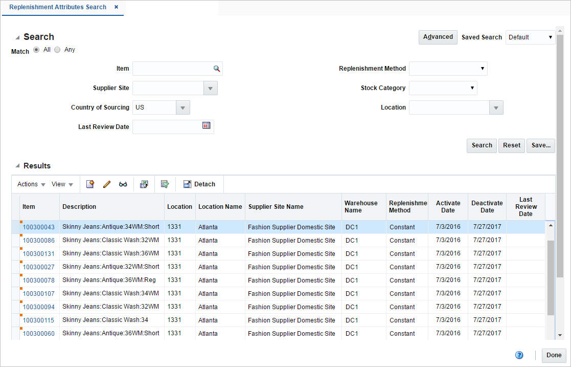

The Manage Attributes option opens the Replenishment Attributes Search window. This window allows you to search for replenishment attributes, as well as view and edit the results of the search.
The Replenishment Attributes Search window contains the following sections:
Search
For more information about how to search for replenishment attributes, see the Searching for a Replenishment Attribute section.
Figure 3-1 Replenishment Attributes Search Window
To search for a replenishment attribute:
From the Task menu, select Replenishment > Manage Attributes. The Replenishment Attributes Search window appears.
You can search for replenishment attributes using basic or advanced search criteria, depending on the requirement. The basic mode is the default search mode.
Click Advanced to access the search section in advanced mode.
Click Basic to return to the basic mode.

Results
The Results section lists the retrieved item/location combinations. The Results table shows the following columns by default.

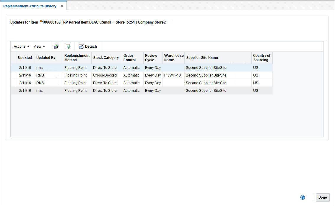

Replenishment Attribute History
The Replenishment Attribute History window allows you to view the update history of a replenishment attribute for item/location.
The Replenishment Attribute contains the following sections.
Header
The header displays the item ID and description as well as the location type, the location ID and location name.
Figure 3-5 Replenishment Attribute History Window
Replenishment Attribute History Table
The table lists all the completed updates for the item/location.

View Replenishment Attribute History
To view the replenishment attribute history, follow the steps listed below.
From the Tasks menu, select Replenishment > Manage Attributes. The Replenishment Attributes Search window appears.
Enter or select search criteria as desired to make the search more restrictive.
Click Search. The attributes that match the search criteria are displayed in the Results section.
Select a record in the Results section.
Then select Actions > History. The Replenishment Attribute History window appears. View the updates for the selected item.
Click Done to close the window.

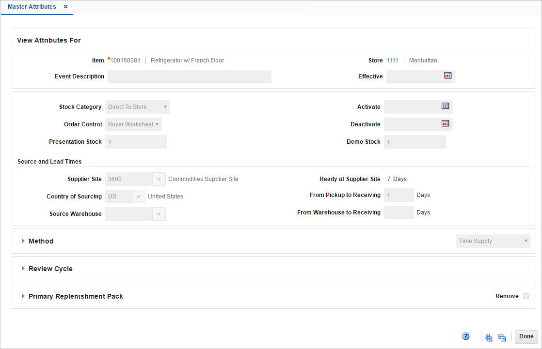

Master Replenishment Attributes
The Master Replenishment Attributes window maintains a record of the master attribute that can be used to restore item/location settings after a temporary change.
When you create the replenishment parameters for an item/location, the master replenishment attributes are created automatically.
For more information about how to create replenishment parameters for an item, see chapter Activating Items on Replenishment, section "Creating Attributes" section.
When you update the replenishment attributes for an item/location, you can choose to update the master replenishment attributes at the same time, by selecting the Update Master checkbox in the Replenishment Attributes window. For more information about the individual fields displayed in this window, see chapter Activating Items on Replenishment, section "Replenishment Attributes Window".
Figure 3-6 Master Attributes Window
Click Search. The items that match the search criteria are displayed in the Results section.
Then select Actions > Master Attributes. The Master Replenishment Attributes window appears.
You can also access the Master Replenishment Attributes window through the Replenishment Attributes window:
In the Item column, click the item link, or mark a record and select Actions > Edit/View or use corresponding icons. The Replenishment Attributes window appears.
In the Replenishment Attributes toolbar, select More Actions > Master Attributes. The Master Replenishment Attributes are displayed.
View the master replenishment attributes for the selected item/location.
