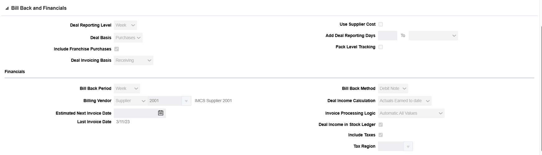

Add Bill Back and Financials Details
The Bill Back and Financials section gets displayed for Bill Back (BB), Bill Back Rebate (BBR), Vendor Funded Markdowns (VFM) and Vendor Funded Promotions (VFP) type deals.
Figure 4-3 Bill Back and Financials Page for Deal Basis as Sales
Figure 4-4 Bill Back and Financials Page for Deal Basis as Purchase and Issues and VFP Deals
The Bill Back and Financials section includes the following fields.
Table 4-2 Bill Back and Financials - Fields and Description
Fields Description
Deal Reporting Level
The deal reporting level determines the length of the reporting periods that would be created for income generation. The options provided to you depends on the calendar type that is being used in the Merchandising instance. For a 4-5-4 calendar, this can be Day, Week, Month, or Quarter, while for a Gregorian calendar, only Day, Month or Quarter can be selected. Income is calculated once per reporting period. The reporting level also indicates the maximum frequency at which an invoice is raised against the income accrued by the deal.
Deal Basis
Select whether the deal will be based on purchase, sales or issues. Bill back deals are based on purchases and sales, while bill back rebate deals can be based on purchases, sales or issues.
Include Franchise Purchases (or Sales)
Select whether the deal will include franchise purchases (for purchase based deals) and sales (for sales-based deals) or not.
To use this feature, the invoicing location (present as COSTING_LOC at the item/franchise store level) needs to be added in the deal and already ranged to the items in the Franchise order for any income to be generated.
Deal Invoicing Basis
Note: This does not apply to VFP/VFM deals.
Select the Deal Invoicing Basis. The options for Deal Invoicing Basis depends on whether the deal is purchase or sales based. Purchase based deals can have this set to the Approved POs, Receiving (uses Net Receipt logic), Gross Receipt, or Invoice Matched Quantity (for purchase based deals). Sales based deals do not have timing specified since they are driven by sales records and are applied only when a sale occurs. Issue (Transfer/Allocation) based deals accrue income based on movement of inventory from a warehouse to a store via a transfer or a PO/ASN sourced allocation and have the timing defaulted to 'Shipment'. All types of inventory movements within the same transfer/legal entity would be eligible for a movement based deal as long as they originate from a warehouse (source location) and terminate at a company store (destination location) which is part of the deal definition.
Use Suggested Retail Indicates whether the Suggested Retail value defined at the item location level needs to be used instead of the actual selling retail in order to determine the deal income for sales-based deals.
Use Supplier Cost Indicates whether the supplier cost defined at the item-supplier or item-supplier-location level needs to be used to determine the deal income. Applicable for Bill Back Bill Back Rebate deals with the basis selected as purchases or issues and for Vendor Funded Promotions.
Add Deal Reporting Days
This field is used to capture the number of extra reporting days that should be added to the deal actual forecast data to cater to the late postings of the transactions after the deal close date.
Pack Level Tracking
For receipt-based Bill Back and receipt or sales-based Bill Back Rebate deals, the indicator for tracking the deal at the pack level is enabled. Select this indicator to generate income for purchase orders which involve receiving at the pack level or sales occurring at the pack level. This is enabled only for receipt based bill back and receipt or sales based bill back rebate deals.
Rebates sub section:
Rebate Calculation Type
Select the rebate calculation type from the list. This field determines the method in which the comparison of thresholds is performed against the actual turnover figures. Here the term turnover refers to the total revenue generated for a period across the merchandise hierarchy for which the deal is applicable. This is defaulted to Linear and disabled for a BB deal, while for a BBR, you can set it to Linear or Scalar.
Growth Rebate
A rebate in which the supplier determines the amount of the rebate, based on increased orders over a specified period of time. The Growth Rebate information is available only for Bill Back Rebate deals and is for informational and reporting purposes. Selecting this indicator enables the Historical Period fields and allows a buyer to set up a growth rebate deal by looking up prior receipt or sales values in the data warehouse system. The growth percentage can then be manually applied to these values to come up with thresholds that would be applicable for the current deal.
Historical Period
Start Date
End Date
The start and end dates of the historical period against which growth will be measured for this growth rebate.
Financials sub section:
Bill Back Period
Select the period for how frequently the vendor is billed. This period needs to be at least as large as the reporting period because income calculation is performed only at the end of a reporting period. For the 4-5-4 calendar, the choices for the invoice periods are: Week, Month, Quarter, Half Year, Annual, or Deal End (one bill for the entire deal period). The same choices apply for Gregorian calendar, except Week. This field remains editable until the first invoice has been raised against the deal.
Billing Vendor
This field indicates the vendor to be billed for the specific deal, which can be different from the vendor specified for the deal in Deal Head. Select the vendor type and enter, select or search for the vendor. Valid Vendor type options include Supplier, Supplier Site, Manufacturer, Distributor, and Wholesaler.
Estimated Next Invoice Date
The estimated date the next invoice is going to be sent to the vendor. Enter the correct date or click the calendar icon and select the correct date. The effective date for raising the invoice will depend on when the financial month is closed. The estimated next invoice date gets populated initially based on the bill back period. It takes the last day of the period that will be invoiced. After the invoicing batch program Vendor Deal Invoicing (vendinvc) runs, this date is updated with a Gregorian week, month, or quarter, or the 4-5-4 week setup based on the calendar configuration in the system. This date can be modified throughout the deal's lifetime, even after approval until the last invoice against the deal has been processed.
Last Invoice Date
This field is updated to hold the last reporting period that was invoiced. Enter the date or click the calendar icon and select the date.
Bill Back Method
This indicates whether invoices raised for this deal are in the form of a credit note or a debit note. The option selected here overwrites the supplier's default setup in Invoice Matching. This field remains editable until the last invoice against the deal has been processed.
Deal Income Calculation
The basis for calculating the amount earned from the deal. Actual will only generate income on real turnover. Pro-rated calculates income based on forecasts and actual turnover and distributing this income over all open periods. For BB and BBR types of deals, you have the option of calculating the deal income based on the actual values earned until the current date, or of using the method of proration on the forecasted amount.
Invoice Processing Logic
Select the method for how invoices will be raised for this deal. You have the following options available in the case of BB and BBR type of deals - Automatic all values, manual all values, automatic positive values, manual positive values only, no invoice processing. This field remains editable until the first invoice has been raised against the deal.
Deal Income in Stock Ledger
Select the check box to indicate that deal income accrual should be written to the stock ledger.
Include Taxes
In the Global Tax Solution (GTS) setup, the system will support multiple tax codes at the item level within a deal as long as this checkbox is selected. In a non-GTS setup, just a single tax can be linked with the items within the deal.
Tax Region Select a tax region different from the one associated with the deal location.

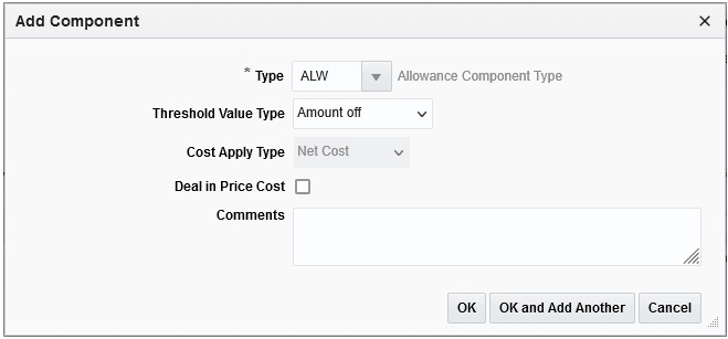

    For a Vendor Funded Markdown type of deal, the user can specify the contribution type and the contribution amount of the vendor to the markdown, that can be defined in the form of a value or a percentage in the Add Component pop up. For values, the amount that is specified will be considered in terms of the currency selected for the specific deal.
    Figure 4-7 Add Components – Vendor Funded Markdown
    Add Components - Vendor Funded Markdown

    Figure 4-12 Allowance – Add Component
    Allowance - Add Component
  6. In the Type field, select the component type.
  7. In the Threshold Value Type, select the threshold value type. This field is used to capture the incentive type that would be received on attaining the threshold limit of the deal. The options are amount off per unit, percentage off per unit, get units for fixed price or buy/get free or discounted items.
  8. For the deal, in the Deal Class field, select the way in which calculations would be performed in case of multiple deal components. The options are Cumulative, Cascade, or Exclusive.
    For a Bill Back, this field will default to Cascade and cannot be changed. For Vendor Funded Promotion and Vendor Funded Markdown, this field will default to Cumulative and cannot be changed.
    For an Allowance Deal no Deal class can be defined.
  9. In the Cost Apply Type field, select how the deal component is used to calculate future costs. The options are Net Cost, Net-Net Cost or Dead Net Cost. The details such as Cost Apply Type is defaulted to Net Cost and can be overridden.
    The value in this field is defaulted based on the type of deal you selected, but can be changed.
    This Field will be defaulted to Net Cost in case of Allowance deal.

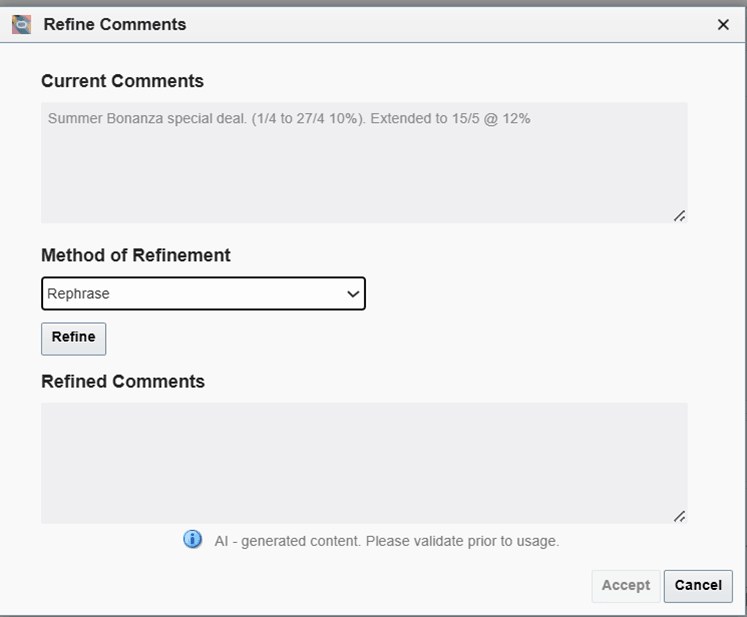

    If AI Assistance is enabled in Merchandising, selecting a deal component displays an AI-generated explanation in the contextual pane for Billback, Billback Rebate, and Vendor Funded Promotion deal types. The explanation is generated using the deal definition together with the associated income calculations, providing users with a concise summary of the deal and a more efficient way to review its details.

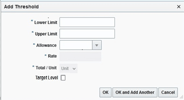

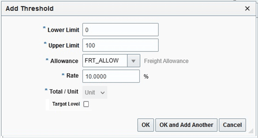

  4. From the Actions menu, click Add or click the Add icon Add icon. The Add Threshold pop-up appears.
    Figure 4-22 Add Threshold Pop-up
    Add Threshold window
    Figure 4-23 Allowance Deal: Add Threshold Pop-up

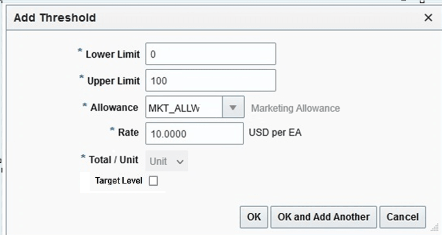

    In case the Threshold Value Type at Deal component level is set to Amount off then the only allowance components with specific amount can be displayed.
    Figure 4-24 Allowance Deal set up as Amount: Add Threshold Pop-up
    In case the Threshold Value Type at Deal component level is set to Percentage off then the allowance components with specific rate can be displayed.
    Figure 4-25 Allowance Deal set up as Percentage: Add Threshold Pop-up
  5. In the Lower Limit field, enter the value of the lower limit of the deal component. This is the minimum value that must be met in order to get the specified discount. This value will be either a currency amount or quantity value, depending on the threshold limit type of this deal component.
  6. In the Upper Limit field, enter the value of the upper limit of the deal component. This is the maximum value for which the specified discount will apply. This value will be either a currency amount or quantity value, depending on the threshold limit type of this deal component.
  7. In the Value field, enter the value of the discount that will be given for meeting the specified thresholds for this deal component. This value will be either a currency amount or quantity value, depending on the threshold limit type of this deal component.
  8. In the Total/Unit field, select the total or unit. It indicates if the value for deal components for which the threshold type is amount off is amount off by unit or in total.
  9. Select the Target Level check box. This indicates if a threshold level is the targeted purchase or sales level for a deal component. This indicator will be used for cost calculations.
  10. Click OK to add thresholds. You can add more thresholds by clicking OK and Add Another.
  11. Click Cancel to return to the Thresholds section.

Add Comments to a Deal
To add comments to a deal:
  1. In the Comments section, enter your comments.
    Figure 4-29 Comments Section
    Comments Section
  2. Click Refine Comments if you intend to use AI to Refine your comments. This option is available only if AI use is opted for through the AI Assistance system option in Merchandising and comment text is available for Refinement. Clicking Refine Comments opens the pop up displayed below.
    Refine Comments Window
    You can specify a refinement method and click Refine to refine the comment text. The refined version proposed can be reviewed. The refined comment can be accepted by clicking Accept if found satisfactory or can be discarded by opting to Cancel.
  3. Click Save to save your changes or click Save and Close to save and close the page.
  4. Click Cancel to discard the changes and close the page.

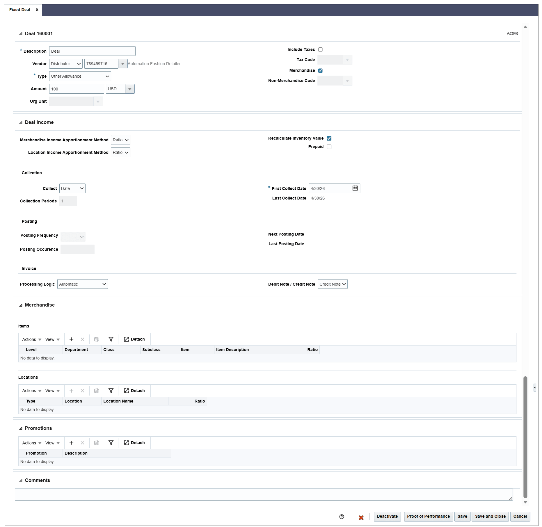

The Fixed Deal page includes the following sections:
Figure 4-42 Fixed Deal Page
Fixed Deal Page

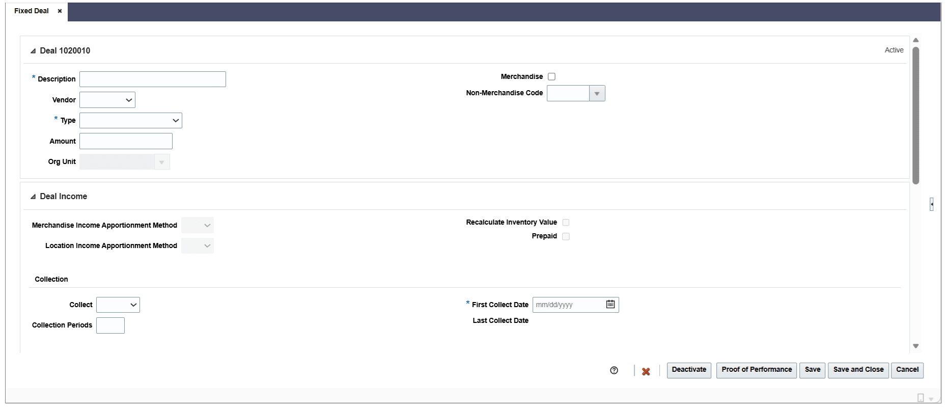

Create a Fixed Deal
To create a fixed deal:
  1. From the Tasks menu, select Deals > Manage Fixed Deal. The Fixed Deal Search page appears.
  2. From the Actions menu, select Create or click the Create icon Create icon. The Fixed Deal widow appears.
    Figure 4-43 Fixed Deal Page
    Fixed Deal Page
    For more information on how to create a fixed deal, see the Create a Fixed Deal section.
Fixed Deal Header
The Fixed Deal Header includes the following fields.
Table 4-11 Fixed Deal Header - Fields and Description
Fields Description
Title
The title displays Fixed Deal ID to the top left of the head container. The Deal Status is displayed to the top right of the head container.
This field contains the deal number by default.
Description
Enter a description of the fixed deal.
Vendor
Select or search for the type of fixed deal vendor. Valid Vendor type options include Supplier, Supplier Site, Manufacturer, Distributor, and Wholesaler.
Type
Select the type of payment.
Amount
Enter the payment amount from the supplier.
Org Unit
Enter, select or search for an organizational ID.
Merchandise
If the deal is associated to the merchandise hierarchy, select the Merchandise check box. For more information on Merchandise Hierarchy, see Merchandise Hierarchy.
Non Merch Code
Enter, select or search for the non-merchandise code.
The Non Merch field is required only if the Merchandise check box is not selected.
Deal Income
The Deal Income includes the following fields.
Table 4-12 Deal Income - Fields and Description
Fields Description
Merchandise Income Apportionment Method
Select the income apportionment method at the Merchandise level. Valid methods are Value and Ratio.
This field is applicable only to merchandise fixed deals.
Location Income Apportionment Method
Select the income apportionment method at the Location level. Valid methods are Value and Ratio.
Recalculate Inventory Value
If the deal income is to be applied back to the inventory value of the impacted item/locations, select the Recalculate Inventory Value check box.
Prepaid
Select the Prepaid checkbox to designate the deal as prepaid, meaning the income is collected upfront but apportioned across item/locations over time, based on the schedule defined by the Posting fields.
This field is enabled only when the Recalculate Inventory Value checkbox is selected.
Deal Collection section:
Collect
Select how often payment for the fixed deal is collected from the supplier.
If you select Date in the Collect field, the number of collection period is always one.
First Collect Date Enter the date, or click the calendar icon and select the date. The date of the collection of the first amount decided as part of the fixed deal.
Collect Periods Enter the number of collection periods.
Last Collect Date
If you enter the date in the First Collect Date field, the Last Collect Date field is displayed by default.
The number of times the collection date is to be repeated after the First Collect Date. On each collection date an invoice may be raised based on the invoicing options selected for the deal.
Posting section: This section is applicable only for prepaid fixed deals.
Posting Frequency Select the frequency of apportioning the income at the item/location level and posting it to stock ledger for prepaid fixed deals.
Posting Occurrence Enter the number of posting periods.
Next Posting Date Display the next future date on which the posting should occur.
Last Posting Date This is automatically populated based on the Posting Frequency, Posting Occurrence, and Next Posting Date parameters. It represents the final date for apportioning and posting income for the identified item/locations, in accordance with the defined deal posting schedule.
Invoice section:
Processing Logic Select how invoices are created for the fixed deal. The options of creating invoices are: Automatic, Manual, No Invoice Processing depending on the option selected.
Debit Note/Credit Note Select whether you want to send a Debit or Credit Note request to the supplier.
If the income apportionment method is set to Value at the merchandise level, the location-level method defaults to Value and is locked, as the proration is based on item/location stock value once locations are determined.
Additionally, if Recalculate Inventory Value is not selected, you cannot choose the Value method for deals created at the merchandise hierarchy level (Department/Class/Subclass), since income proration at the item/location level does not apply in this case.
Taxes
Multiple tax codes can be supported per merchandise hierarchy or non-merchandise code in the Global Tax Solution (GTS) setup. The Taxes table allows you to manually add one or more taxes relevant to the fixed deal. The tax amount will get split between the set of hierarchies added in the Merchandise Hierarchy table and then further divided into the locations added in the Locations table based on the user defined ratio.
The Add Tax pop-up allows you to add the taxes to the above table.
Figure 4-44 Add Tax
Add Tax pop-up

Activate/Deactivate a Fixed Deal
A fixed deal present in the system might need to be activated or deactivated at different points of time based on the specific requirements of the business. This activation/deactivation of the deal can be done using the process mentioned below.
Activate a Fixed Deal
Any fixed deal is created within the system is in Active state by default. However, if any active deal has been previously deactivated and is currently in the Inactive state, it can be activated using the Activate button in the Fixed Deal page. Clicking Activate will also change the label on the button to read Deactivate, to provide an option for future deactivation.
Any deal which is in Active status can be deactivated using the Deactivate button in the Fixed Deal page. This can be done while creating the deal or later via an Edit operation. Clicking the Deactivate button will also change the label on the button to read Activate, to provide an option for future activation.

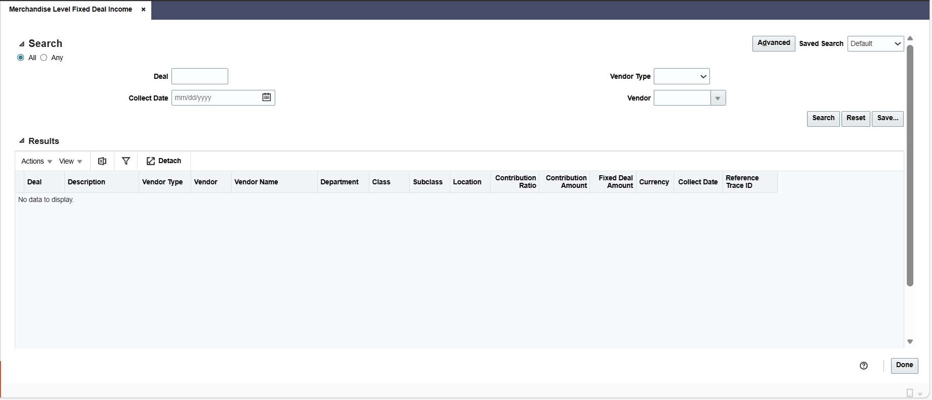

The Merchandise Level Fixed Deal Income page allows you to search for and view income collections for deals created at the department, class, or subclass levels.
Figure 4-53 Merchandise Level Fixed Deal Income
To view income postings for a fixed deal:
  1. From the Tasks menu, select Deals > Merchandise Level Fixed Deal Income. The Merchandise Level Fixed Deal Income page appears.
  2. You can search a fixed deal by providing search criteria in the search section. The criteria can be provided either Basic or Advanced mode, depending on the requirement. Basic is the default mode when the search page is entered. Click Advanced to access the search panel in advanced mode. You can return to Basic mode by clicking Basic.
