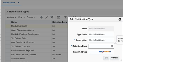

Notifications
From the Settings menu, you can access the Notifications option. Selecting this option will open the Notifications page in the Retail Application Administrator Console. This page will display two tables.
Figure 6-1 Notifications
This image shows the notifications Page
The top table shows the notification types that are configured in the solution, along with the number of days that the notifications are retained when they occur for a user. Existing notifications can be edited to change the type code and description, along with the retention days. Retention days must be a number greater than zero, or it can be set to -1 to keep the notification indefinitely, unless deleted by a user. However, this is not recommended.
The description is displayed in the notification displayed to the user:
Figure 6-2 Data Upload Request Notification
Data Upload Request Notification popup
You can also add one or more email addresses to have a message sent when the action occurs to trigger a notification.
New notifications can be added in on premise implementation of Merchandising solutions only. Adding new notifications also would require customization if you want the action to be triggered from an action within the application.
Deleting a notification type removes the notification type and all of the notification type's associated roles and groups. Any past notifications are also removed from user's queues.
The second table in the screen is used to create groups for the notification type selected in the top table. Click the Create iconic button create icon to create a new group. Then, associate roles or another group with the group by selecting the Add Job Role iconic button Add Job Role Icon or the Add Notification Groups iconic button add group icon. This will allow the notification to be delivered to all users assigned to the roles configured for the group. If no group is assigned, then the notification is delivered to the user who initiated the action the created the notification.

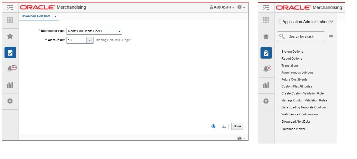

  3. Assign the required privilege to Business Users, so that they can access the Alert Data screen and download the data linked to an alert wherever applicable. If the user has one or more of the following privileges, the Download Alert Data link under the Application Administration folder in Merchandising will be displayed.
    • Duty: RMS_ALERT_DATA_MONTH_END_INQUIRY_DUTY
    • Privilege: VIEW_MONTH_END_HEALTH_CHECK_ALERT_DATA_PRIV
  4. Users with required privileges can access The Download Alert Data screen via the Download Alert Data task under Application Administration task hierarchy as shown below.
    Figure 6-4 Download Alert Data
    Download Alert Data
  5. The list of Notification types visible to the user on the Download Alert Data screen will depend on the privileges assigned to the user (Refer step 3). Users will be able to download the alert data by keying in result is contained in the email alert. The result id would be included in the email for all alerts for which there is linked data.
