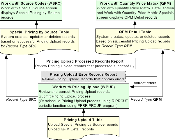

Pricing Upload Process
Use the following steps to upload Special Pricing by Source records and Quantity Price Matrix Detail records from an external system.
| # | Step |
1. |
Populate the Pricing Upload Table with Special Pricing by Source and Quantity Price Matrix Detail records from an external system. |
2. |
Review, and optionally change, the Pricing Upload records in the Work with Pricing Upload (WPUP) menu option. |
3. |
When you are ready to upload the records from the Pricing Upload table, use the Work with Pricing Upload Screen to submit the Pricing Upload process. The Record Type field indicates whether the record is a Special Pricing by Source Upload record or Quantity Price Matrix Detail Upload record.
Scheduling the Pricing Upload process: You can also schedule the Pricing Upload process to run periodically by setting up the RIPRCUP periodic function using the PFRRIPRCUP program. See Scheduling Jobs for background. |
