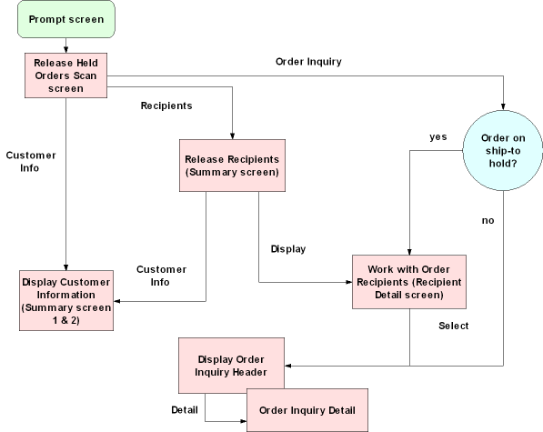

Releasing Held Orders
Topics in this part: The following sections describe how to review and release held orders:
- Introducing Order Hold Reason Codes describes system-assigned hold reason codes and their application to orders, and presents the screens you work with to create user-assignable hold reason codes.
- Working with Customer Fraud Tables (WCFD) discusses the process of creating, changing, and deleting fraudulent customers based on customer name and address.
- Working with Miscellaneous Frauds (WMFF) discusses the process of creating, changing, and deleting fraudulent customers based on postal or zip code, credit card, and check.
- Displaying Order Hold Information presents the customer screens you can use to investigate customer detail on a held order, and the Order Inquiry function you can use to review order status.

Recap of Screen Relationships
Purpose: From the Release Held Orders Screen (Working with Releases), you can advance to summary and detail screens that will enable you to review, evaluate, and release held orders.
Diagram: This diagram shows you the routes you take from one screen to another when you are working from the Release Held Orders Screen (Working with Releases).
