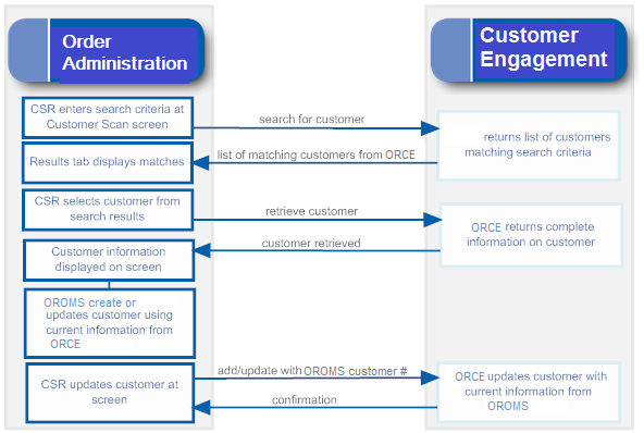

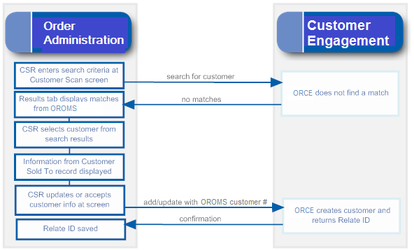

- Searching for a customer: When you search for an existing customer in an Order Administration menu option, Customer Engagement returns a list of customers matching the search criteria. See Notes on Searching for a Customer on Order Administration Screens for more information.
- Synchronizing customer information (add/update customer): Synchronization occurs when:
You create a new customer in Order Administration Classic View or Contact Center Order Entry. Order Administration sends a message indicating to create the new customer in Customer Engagement.
You retrieve an existing customer record from Customer Engagement. When Customer Engagement sends the current customer information to Order Administration, Order Administration creates or updates its customer record based on the information received from Customer Engagement. The creation or update occurs through both Classic View and Modern View.
You update an existing customer at an Order Administration Classic View or Modern View screen. Order Administration sends an update message to Customer Engagement.
You update an existing customer through the order API, in certain cases. See Customer Synchronization through the Order API for a discussion.
You use a periodic function to synchronize Order Administration customer records with Customer Engagement. Order Administration sends its current customer information to Customer Engagement and stores the Relate ID in the Customer Sold To table. See Synchronizing Customer Information through a Periodic Function for more information.

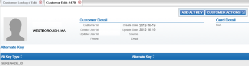

How are synchronized customers linked? A pair of synchronized Order Administration and Customer Engagement customer records are linked by matching customer numbers:
- Order Administration: the Relate Id in the Customer Sold To table identifies the customer ID in Customer Engagement
- Customer Engagement: the Alternate key in Customer Engagement identifies the customer number in Order Administration. The ORCE_ALT_ID_OROMS setting in Working with Customer Properties (PROP) defines the alternate key type for the Order Administration customer number in Customer Engagement.

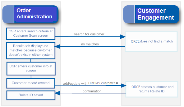

When the Customer Contacts the Call Center
Overview: A customer can also create an order by contacting the call center. When the customer contacts the call center to place an order, request a catalog, create a customer membership outside of order entry, or update name and address information, the CSR needs to first search for the customer in order to keep the Customer Engagement and Order Administration customer records in sync and prevent creating duplicate records. The process when a customer contacts the call center is:
- Search Customer Engagement first: When the CSR performs a search, Order Administration first checks in Customer Engagement for any matches. Unlike the process used for the order API, the customer search can send various criteria to Customer Engagement. If the CSR selects a customer from the search results and enters any updates, Order Administration syncs these updates with the Customer Engagement customer record.

Searching Customer Engagement for the Customer
When the customer contacts the call center to place an order, request a catalog, create a customer membership outside of order entry, or update name and address or other information:
Searching:
- The CSR enters the search criteria at the Customer Scan Screen.
- There is at least one customer record in Customer Engagement that matches the search criteria.
- The Results tab at the Customer Scan screen displays the names, home addresses, email addresses, and primary phone numbers of any customers in the Customer Engagement database matching the search criteria. The Results tab displays the error message Maximum search results exceeded, please refine your search if the number of matching records exceeds the Customer Lookup Limit system configuration setting in Customer Engagement. In this situation, you need to make your search criteria more specific to make sure that you can find the customer record you are looking for.
Selecting a customer from the Customer Engagement search results:
- If the CSR selects a record from the Results tab:
Order Administration requests information on the complete customer record from Customer Engagement
Customer Engagement sends the customer information, including the alternate key, if any, that maps to the Order Administration customer number.
If the alternate key identifies an existing customer in the Customer Sold To table, Order Administration updates the customer record with the current information from Customer Engagement. Also:
If more than one record in Customer Engagement is assigned the same alternate key mapping to the Order Administration customer number, Order Administration uses the information from the first matching record to update the customer record in the Customer Sold To table.
If the alternate key that identifies an existing customer in the Customer Sold To table has a different ORCE customer ID, Order Administration updates the ORCE customer ID for the customer record.
If there is not an alternate key that identifies an existing customer in Order Administration, Order Administration creates a new customer record.
Searching Order Administration for the Customer in Classic View
Searching:
- There are no records in Customer Engagement that match the search criteria, but there is at least one match in the Order Administration Customer Sold To table.
- The Results tab at the Customer Scan screen displays the names, home addresses, email addresses, and primary phone numbers of any customers in Order Administration’s Customer Sold To table that match the search criteria.
Selecting a customer from the Order Administration search results:
- If the CSR selects a record from the search results:
Order Administration retrieves the current information from its Customer Sold To table.
When the CSR updates or accepts the customer information, Order Administration sends an add/update message to Customer Engagement.
Customer Engagement creates the customer record, assigning the Order Administration customer number as an alternate key, and sends the Customer Engagement customer number to Order Administration.
Order Administration updates the Customer Sold To record with the Relate Id.
Creating a New Customer
Searching:
- There are no records matching the search criteria in either Customer Engagement or Order Administration.
- The results do not include any records.
Creating the customer:
- When the CSR enters the information on the new customer:
Order Administration creates the customer record in its Customer Sold To table.

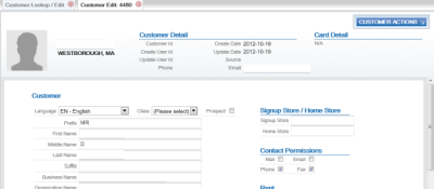

Reviewing the customer in Customer Engagement: Use the Customer Lookup / Edit option in Customer Engagement to search for, review, or update a customer.
Which tables? Customer records are stored in:
- Order Administration: the Customer Sold To table, except where noted below.
- Customer Engagement: the CST_CUSTOMER table.
For more information: See the Information that is not mapped for a listing of some of the fields that are not mapped as part of the Customer Engagement customer integration.

Displaying in Customer Engagement: Under Customer. |
Prefix |
Prefix |
Truncated in Order Administration to 3 positions. Any trailing spaces are removed. |
First name |
First name |
Truncated in Order Administration to 15 positions. Any trailing spaces are removed. |
Middle initial |
Middle name |
Truncated in Order Administration to 1 position. Any trailing spaces are removed. |
Last name |
Last name |
Truncated in Order Administration to 25 positions. Any trailing spaces are removed. |
Suffix |
Suffix |
Company |
Business Name |
Truncated in Order Administration to 30 positions. Any trailing spaces are removed. |

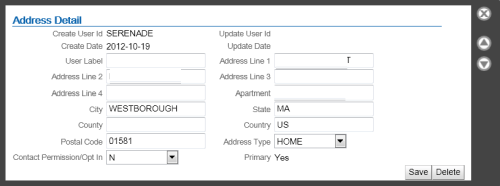

| Address Note: Only the customer’s HOME address in Customer Engagement is mapped to Order Administration. If more than one HOME address exists in Customer Engagement, the system uses the primary HOME address. This information is required in order for Order Administration to create the customer record correctly.Customer Engagement automatically creates an Address type of HOME when it receives a customer from Order Administration interactively or through the Customer Engagement Add or Update Customer Message. In this situation, Customer Engagement also adds a row to the CST_ADDR_TYPCODE table for ADDRESS_TYPECODE HOME in the Customer Engagement database if it does not already exist. |
No address validation in Customer Engagement: Unlike Order Administration, Customer Engagement does not require an address for a customer, and does not validate that the address includes certain required components; for example, no address lines are required. To prevent problems in Order Administration, it is important that any other means you use to create customers in Customer Engagement, such as through your e-commerce site, always creates a home address when you use the Customer Engagement customer integration. If a home address does not exist in Customer Engagement, Customer Engagement displays the customer in Order Administration without an address. Also, if certain fields for the home address are not defined in Customer Engagement, these fields will be blank when you display the customer in Order Administration. However, when you update the customer’s address in Order Administration so that is passes validation, the system will also update the customer’s home address in Customer Engagement |
Displaying in Customer Engagement: Select Address. ![]() |
N/A |
Primary |
Set to Yes in Customer Engagement. |
Street |
Address line 1 |
Truncated in Order Administration to 32 positions. Any trailing spaces are removed. |
Apt/Suite |
Apartment |
Truncated in Order Administration to 32 positions. If deleted in Order Administration, also deleted in Customer Engagement. Any trailing spaces are removed. |
Address (lines 2-4) |
Address lines 2-4 |
Truncated in Order Administration to 32 positions. Stored in the Customer Sold To Extended table. If deleted in Order Administration, also deleted in Customer Engagement. Any trailing spaces are removed. |
City |
City |
State |
State |
Truncated in Order Administration to 2 positions and validated against the states in the Country table. Any trailing spaces are removed. |
Postal code |
Postal code |
Truncated in Order Administration to 10 positions and validated against the SCF table. Any trailing spaces are removed. |
Country |
Country |
Must be a 2-position country code; validated in Order Administration against the Country table. Note: Use the two-position ISO country code; for example, use US instead of USA.Any trailing spaces are removed. |

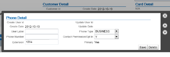

| Phone numbers The phone numbers in Order Administration map to the soft-coded Telephone types based on the Customer Engagement Properties. Customer Engagement automatically creates the Telephone type codes of HOME, BUSINESS, and FAX or MOBILE when it receives a customer from Order Administration interactively or through the Customer Engagement Add or Update Customer Message. In this situation, Customer Engagement also adds rows to the CST_PHONE_TYPCODE table for types of WORK, HOME, and FAX or MOBILE in the Customer Engagement database if they do not already exist. Note: Phone number extensions are not mapped between Customer Engagement and Order Administration. |
Phone numbers in Order Administration are stored in the Customer Sold To Phone # table. Any formatting is removed from the phone number before sending to Customer Engagement. Removing a phone number: If you delete a phone number in either Customer Engagement or Order Administration, the system deletes the associated phone number in the other system. |
Displaying in Customer Engagement: Select Phone. Optionally, highlight a phone number to open the Phone Detail window. ![]() |
Day |
varies |
The ORCE_DAY_PHONE_LABEL setting in the Customer Engagement Properties file indicates the Telephone Type in Customer Engagement that maps to the daytime phone number in Order Administration; this setting should be set to BUSINESS. Any trailing spaces are removed from the phone number. Primary? If there is a daytime phone number, this phone number in Customer Engagement is flagged as Primary by default after synchronizing customer information with Order Administration. |
Eve |
varies |
The ORCE_EVE_PHONE_LABEL setting in the Customer Engagement Properties file indicates the Telephone Type in Customer Engagement that maps to the evening phone number in Order Administration; this setting should be set to HOME. Any trailing spaces are removed from the phone number. Primary? If there is no daytime phone number, then the evening phone number in Customer Engagement is flagged as Primary by default after synchronizing customer information with Order Administration. Also, if you delete the daytime phone number in Order Administration, then the evening phone number is flagged as Primary in Customer Engagement. |
Mbl or Fax |
varies |
The ORCE_FAX_PHONE_LABEL setting in the Customer Engagement Properties file indicates the Telephone Type in Customer Engagement that maps to the third phone number in Order Administration; this setting should be set to FAX or MOBILE. Any trailing spaces are removed from the phone number. Note: The Third Phone Number Type (L53) system control value controls whether the third phone number is labeled as the mobile or fax number in Order Administration.Primary? If there is no daytime or evening phone number, then the fax/mobile phone number in Customer Engagement is flagged as Primary by default after synchronizing customer information with Order Administration. Also, if you delete the daytime and evening phone number in Order Administration, then the fax/mobile phone number is flagged as Primary in Customer Engagement. |
N/A |
Contact permission/opt in setting (phone-level) |
For the day and evening phone numbers: Y defaults if a corresponding phone number is defined; otherwise N defaults. If the Third Phone Number Type (L53) system control value is set to FAX:
If the Third Phone Number Type (L53) system control value is set to MOBILE: Y defaults if a mobile phone number is defined; otherwise, N defaults. |

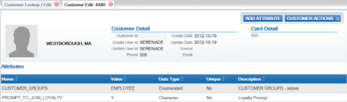

| Profile data In Order Administration, profile data is stored in the Customer Profile table. |
Included in the integration? The Send Profile Data to ORCE (L51) system control value controls whether to include demographic profile data when synchronizing customer information. Required setup: You need to complete the setup described under Order Management System Customer Profile > Customer Engagement Attribute Definition in order to synchronize the information between the systems. Examples are provided below. |
Displaying in Customer Engagement: Select Attributes. ![]() |
Profile description |
Attribute name |
Use the Setting Up Customer Profiles (WPFL) option in Order Administration to set up the type of demographic information you are capturing, and also use the Attribute Definition screen in Customer Engagement to create a corresponding attribute definition for each Order Administration profile code. Example: To capture marital status, you can set up:
Profile data description |
Attribute value |
Use the Setting Up Customer Profiles (WPFL) option in Order Administration to set up each valid profile data value that you can capture. It is not necessary to set up valid data in Customer Engagement; Customer Engagement stores the data as a text string. Example: In the Setting Up Customer Profiles (WPFL) option in Order Administration, set up profile data options such as:
Customer Engagement stores an attribute value of MARRIED. |

County: If the county is populated in Customer Engagement, this information is cleared when the customer record is synched with Order Administration.
Address type: Only the address with a type of HOME is used as part of the integration. If the customer record in Customer Engagement does not have a HOME address, then the address you enter for the customer in Order Administration is created as the HOME address in Customer Engagement.
Email address: Only the email address with a type of HOME is used as part of the integration.

Phone number extensions: If you add an extension to an existing phone number:
- if you add the extension in Order Administration, the extension is not added to Customer Engagement.
- if you add the extension in Customer Engagement, the extension is not added to Order Administration and is removed when the customer information is resynchronized.

- if communication has failed for any reason during normal operations, so that customer information was not synchronized interactively
- to initially export customer information from Order Administration to Customer Engagement
Synchronization trigger: If the Synchronize with remote DB flag in the Customer Sold To table is set to Y, the SYNCRDB periodic function attempts to synchronize the customer record with Customer Engagement. Order Administration sets this flag to Y automatically when communication with Customer Engagement fails. To initially export existing customer information to Customer Engagement, you can use a SQL statement to set this flag to Y for all customer records if you do not use the conversion periodic function.

- Relate Id: Customer Engagement customer number = Relate Id in the Order Administration Customer Sold To table
- Customer number: Customer Engagement alternate key record whose Alt Key Type matches the ORCE_ALT_ID_OROMS setting in Working with Customer Properties (PROP) = the Order Administration customer number
- E-commerce ID: Customer Engagement alternate key record whose Alt Key Type matches the ORCE_ALT_ID_WEB setting in Working with Customer Properties (PROP) = the e-commerce site’s customer number. From the ecommerce_id passed in the CWOrderIn message, and saved as the E-commerce ID in the Customer Sold To table only if the order API was unable to synchronize the Order Administration and Customer Engagement customer records

- If a Relate Id or an e-commerce ID is specified in the Customer Sold To table and the Synchronize with remote DB flag is set to Y, Order Administration sends the current Order Administration customer number, e-commerce ID (if any), and customer name and address, including phone numbers and the primary email address.
Customer Engagement returns its Customer Engagement customer number; if this number is different from the current Relate Id in the Customer Sold To table, Order Administration updates the Relate Id. The current Relate Id might be different if, for example, a merge/purge took place in Customer Engagement.
- If no Relate Id or e-commerce ID is specified in the
Customer Sold To table, and the Synchronize with remote DB flag is set to Y, Order Administration first searches Customer
Engagement based on primary email address. If Customer Engagement
returns:
any matching customers, Order Administration synchronizes the customer with the first customer returned that is not already assigned a Order Administration alternate key; if all matching customers already have Order Administration alternate keys, it selects the first customer returned in the response
no matching customers, Order Administration sends an add/update message to create a new customer in Customer Engagement

- Must search before creating a customer at Order Administration screens: Because the Customer Engagement customer integration is based on using Customer Engagement as the system of record for customers, you need to use the Customer Scan Screen to search for a customer and make sure that the record does not already exist before creating a new record to avoid the possibility of creating a duplicate. Creating the customer without searching first indicates that you want the customer created, regardless of any existing duplicates.
- Customer Engagement customer ID: The Customer Engagement customer ID is stored in the Order Administration Customer Sold To table, and may be included in web service requests or used for customer matching as described above, but is not displayed on any screens in Order Administration.

Phone number extension: Phone number extensions are not passed between Customer Engagement and Order Administration.
