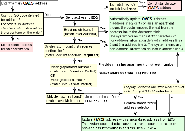

Experian Address Standardization Process when using REST API
Interactive Address Standardization Process Illustration
The figure shows the Interactive Address Standardization process.
Remote Address Standardization Process Illustration
The figure shows the Remote Address Standardization process.
Experian Address Standardization Process Flow
The system determines if a Order Administration address requires standardization each time you create a new address or update the following fields on an existing address:
  • Street address
  • Apartment/Suite
  • Address lines 2-4
  • City
  • State/Province code
  • Postal code
  • Country code

Experian Address Response Match Level
Purpose: The address response match level returned by Experian determines the action Order Administration performs.
Match Level Address Results
None
Experian does not update the Order Administration address because it could not find a match to the address.
Remote address standardization: The system does not standardize the Order Administration address. If the address is on a remote order and a hold reason is defined in the Address Interface User Hold Code (I68) system control value, the system places the order on user hold.
If a hold reason is not defined in the Address Interface User Hold Code (I68) system control value, the system does not assign a hold reason to a remote order at the user level.
  • If the remote order does not contain any errors, the system creates the order in an open status.
  • If the remote order contains errors, the system places the order in an order batch with an error status.
Interactive address standardization: The system displays the Address Standardization: No Address Match Found Screen. At this screen you can select to return to the Order Administration screen and either:
  • Retain the Order Administration address without any updates from Experian.
  • Update the Order Administration address to resend it for standardization.
Apartment Triggers: Experian does not apply apartment triggers when the match level is None. See Apartment Triggers.
Non-Address Information: The system retains any non-address information defined in address lines 1, 2, and 3 in address line 3. See Retaining Non-Address Information in Address Lines 1-4.
See Match Level None Example.
Verified
Experian found one address match with a high level of confidence. The system automatically updates the Order Administration address with the address returned by Experian.
Apartment Triggers: If address lines 2 or 3 contains an apartment trigger, the system moves the text from the address line to the Apartment field. See Apartment Triggers.
Non-Address Information: The system retains the first 32 characters of non-address information defined in address lines 1, 2, and 3 in address line 3. The system clears any non-address information defined in address line 4. See Retaining Non-Address Information in Address Lines 1-4.
See Match Level Verified Example.
Interaction Required
Experian found a single match to the Order Administration address but requires you to confirm the address update.
Interactive address standardization: The system displays the Address Standardization: Verify Recommendation Screen. At this screen you can:
  • Update the Order Administration address with the recommended address returned by Experian.
Apartment Triggers: If address line 2 or 3 contains an apartment trigger, the system moves the text from the address line to the Apartment field. See Apartment Triggers.
Non-Address Information: The system does not retain the non-address information defined in address lines 1, 2, 3, and 4.
See Match Level Interaction Required Example.
Premise Partial
Experian found a match to the Order Administration address, but requires you to provide the apartment number for the address or select an address from a list of valid addresses returned by Experian.
Interactive address standardization: The system displays the Address Standardization: Verify Apartment/Suite Number Screen. At this screen you can:
  • Provide the missing apartment number and standardize the Order Administration address.
If you provide an apartment number that Experian does not recognize as a valid apartment number, the system does not update the address with the apartment number you provided. Instead, you remain on the Verify Apartment/Suite Number screen until you provide a valid apartment number; you can review the pick list returned by Experian to determine the valid apartment numbers for the address.
  • Display a list of possible address matches in a pick list returned by Experian and replace the Order Administration address with a standardized address selected from the pick list.
The address matches in the pick list returned by Experian provide an idea of the acceptable range of apartment numbers you can define for the address.
  • If an address in the pick list displays as a hyperlink, you can select the address from the pick list to replace the Order Administration address with this standardized address.
  • If an address in the pick list does not display as a hyperlink, you can enter the apartment number defined for the address in the Apartment number field to standardize the Order Administration address.
Non-Address Information: The system retains the first 32 characters of non-address information defined in address lines 1, 2, and 3 in address line 3. Address line 4 will be cleared of any non-address information.
Apartment Triggers:
  • If you provide an apartment number for the address, and address line 2 or 3 contains an apartment trigger, the system moves the text from the address line to the Apartment field.
  • If you select an address from the pick list returned by Experian, Experian does not apply apartment triggers to the address.
See Match Level Premise Partial Example.
Street Partial
Experian found a match to the Order Administration address, but requires you to provide the street number for the address or select an address from a list of valid addresses returned by Experian.
Interactive address standardization: The system displays the Address Standardization: Verify Street Number Screen. At this screen you can:
  • Provide the missing street number and standardize the Order Administration address.
If you provide a street number that Experian does not recognize as a valid street number, the system does not update the address with the street number you provided. Instead, you remain on the Verify Street Number screen until you provide a valid street number; you can review the pick list returned by Experian to determine the valid street numbers for the address.
The address matches in the pick list returned by Experian provide an idea of the acceptable range of street numbers you can define for the address.
  • If an address in the pick list displays as a hyperlink, you can select the address from the pick list to replace the Order Administration address with this standardized address returned from Experian.
  • If an address in the pick list does not display as a hyperlink, you can enter the street number defined for the address in the Street number field to standardize the Order Administration address.
Apartment Triggers:
  • If you provide a street number for the address, and address line 2 or 3 contains an apartment trigger, the system moves the text from the address line to the Apartment field.
See Match Level Street Partial Example.
Multiple
Experian found multiple matches to the Order Administration address and requires you to select an address from the list of valid addresses.
Interactive address standardization: The system displays the Address Standardization: Select from Multiple Addresses Screen. At this screen you can:
Apartment Triggers: Experian does not apply apartment triggers when the match level is Multiple.
See Match Level Multiple Example.

Purpose: Use this screen to confirm the address match returned by Experian.
How to display this screen: This screen displays during Interactive Address Standardization when the Experian Address Response Match Level returned by Experian is Interaction Required, indicating Experian found a single match to the Order Administration address but requires you to confirm the address update.
Screen Option Procedure
Select Select/Edit. The system returns you to the Order Administration screen and does not standardize the address.
The system determines if the address requires standardization the next time you create the address or update the address; see Experian Address Standardization Process Flow.
Select Select. The system returns you to the Order Administration screen and standardizes the address.
Purpose: Use this screen to provide the missing apartment number for the Order Administration address or select an address from the pick list returned by Experian.
How to display this screen: This screen displays during Interactive Address Standardization when the Experian Address Response Match Level returned by Experian is Premise Partial, indicating Experian found a match to the Order Administration address but the address is missing the apartment number.
Provide the missing apartment/suite number and update the Order Administration address with the recommendations returned by Experian
Enter the apartment/suite number in the Apartment number field and select OK. The system returns you to the Order Administration screen and standardizes the address.
Apartment preface: When you enter the apartment/suite number, make sure you preface the number with apartment text, such as APT or STE; for example APT D. See Apartment Triggers for a list of valid apartment text that you can enter before the number.
If you provide an apartment number that Experian does not recognize as a valid apartment number, the system does not update the address with the apartment number you provided. Instead, you remain on the Address Standardization: Verify Apartment/Suite Number Screen until you provide a valid apartment number; you can review the pick list returned by Experian to determine the valid apartment numbers for the address.
Display a list of possible address matches returned by Experian
Select Matches to display a list of valid address returned by Experian.
The address list indicates the valid apartment numbers available for the address. You can use this list to determine the apartment number to enter in the Apartment number field, or if an address displays as a hyperlink, you can select it.
When you select one of these matches:
Purpose: Use this screen to provide the missing street number for the Order Administration address or to select an address from the pick list returned by Experian.
How to display this screen: This screen displays during Interactive Address Standardization when the Experian Address Response Match Level returned by Experian is Street Partial, indicating Experian found a match to the Order Administration address but the address is missing the street number.
Provide the missing street number and update the Order Administration address with the recommendations returned by Experian
Enter a valid street number in the Street number field and select OK. The system returns you to the Order Administration screen and standardizes the address.
If you provide a street number that Experian does not recognize as a valid street number, the system does not update the address with the street number you provided. Instead, you remain on the Address Standardization: Verify Street Number Screen until you provide a valid street number; you can review the pick list returned by Experian to determine the valid street numbers for the address.
Select Matches to review a list of possible address matches returned by Experian.
The address list indicates the valid street numbers available for the address. You can use this list to determine the street number to enter in the Street number field, or if an address displays as a hyperlink, you can select it.
Purpose: Use this screen to select an address from the pick list returned by Experian.
How to display this screen: This screen displays during Interactive Address Standardization when the Experian Address Response Match Level returned by Experian is Multiple, indicating Experian found multiple matches to the Order Administration address and requires you to select an address from the list of valid addresses returned by Experian.
Select an address from a list of possible matches
Select an address from the list of valid addresses returned from Experian.
Address Standardization: Verify Recommendation (from Pick List) Screen
Purpose: This screen allows you to review the address you selected from the pick list returned by an address service interface such as Experian before updating the Order Administration address.
How to display this screen: This screen displays during Interactive Address Standardization when you select an address from a list of valid addresses returned by the address service interface on the following screens and the Address Validation Values (J01) system control value is selected:
Select the address that you have selected from the pick list returned by the address service interface.
Display a list of possible address matches returned by the address service interface and update the Order Administration address with the updates defined for one of these addresses.
Select Matches to display a list of valid address returned by the address service interface.
When you select one of these matches, the system displays the address under the Recommended Address section of the screen for you to review.

Serenade Map
The address information and placement of the information returned from Experian is based on a layout defined in the Serenade map. For example, the address mapping details specify:
  • whether the data should be returned in upper case letters.
  • if non-address data such as Leave at back door should be retained, and if retained, in which address field the information should be stored.
The Order Administration integration with Experian supports address standardization for United States and Canadian addresses; it does not support address standardization for European countries at this time.
Experian maps the following information to each Order Administration address field.
OACS Field Mapping Details
Street address
Experian updates this field with the primary number and street address.
Example: 1234 SAMPLE STREET updates to 1234 SAMPLE ST.
Address line 2
Based on the Experian Address Response Match Level, Experian may clear address line 2 of any information.
Address line 3
Based on the Experian Address Response Match Level, Experian may update this field with the first 32 characters of non-address information that was defined in address lines 1, 2, and 3 in Order Administration.
Example: The following non-address information was defined in address lines 2 and 3 for the Order Administration address:
KAT’S FRUITS AND VEGETABLES
LEAVE PACKAGES ON FRONT PORCH
Experian moves the first 32 characters of this information to address line 3:
KAT’S FRUITS AND VEGETABLES LEAV
See Retaining Non-Address Information in Address Lines 1-4 for more information.
Address line 4
Experian clears address line 4 of any information.
Apartment
Experian updates this field with a valid apartment/suite/unit number and includes an abbreviation such as APT or STE.
Example: APT 3
Apartment Triggers
Certain text in address lines 2 and 3 and the Experian Address Response Match Level triggers Experian to move the text to the Apartment field on an address. For example, if you enter NO 3 in Address line 2, the system moves this text to the Apartment field.
See Apartment Triggers for a list of the text that Experian will move from address lines 2 and 3 to the Apartment field. Any number that follows this text is also moved to the Apartment field.
City
Experian updates this field with the valid city name for the address.
Example: WESTBORO updates to WESTBOROUGH
State code
Experian updates this field with the valid state code for the address.
Example:MA
Postal code
Experian updates this field with the valid zip + 4 postal code for the address.
Example:01468 updates to 01468-1566.
Country code
Experian translates the ISO country code for the address to the associated country code defined in Order Administration.
Example:US
