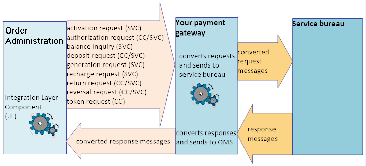

External Payment Service
External payment service is a RESTful web service that provides an interface from Order Administration for sending stored value card transactions and receiving responses. Using this service, you can build a custom payment processor that maps to your payment provider.
This payment service needs to be configured to use the integration layer component of Order Administration, as this component controls payment service processing.
Supported stored value card transactions:
activation request
authorization request
balance inquiry
deposit request
generation request
recharge request
return request
reversal request
