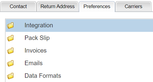

Preferences tab
Each vendor preference category is available by clicking the folder in the left-hand tab.
Illustrates the folders available at the Preferences tab.
Integration options
Use these fields to configure the integration between the vendor’s system and Order Orchestration, so the vendor can receive new purchase orders and confirm shipments through JSON messages rather than using the Vendor Portal screens.
See the Vendor Integration for background, and the Vendor Integration Guide for more details.

Preferences tab
