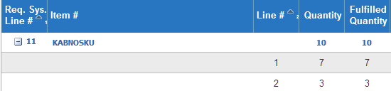

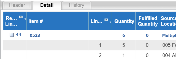

Is line split? Provided the Allow Split Order preference is selected, a line can split if:
Even if your preferences support splitting lines or partial status update, this does not necessarily mean that the lines on an order will split. Split lines at Detail tab: If any line on the order is split, you need to expand the requesting system line number at the Details tab in order to see and work with the details for all lines and see additional options: ![]() Non-split lines at Detail tab: If none of the lines on the order are not split, the details and options are displayed when you open the Detail tab: ![]() For more information: See Selecting a Location for a Delivery Order for some of the different scenarios that are possible in creating or updating detail lines on delivery orders if you have Order Orchestration configured to split orders or order lines. Also, see Updating Order Status at the Line or Unit Level for an overview on processing partial status updates for order lines. |

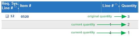

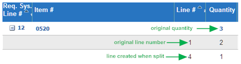

Req. Sys. Line # (Requesting system line number) |
The line number identifying the order line in the requesting location. From the line_item_no passed in the submit order message. A single line from the requesting system can create multiple order lines in Order Orchestration if the Allow Split Line preference is selected. Also, a line can split as the result of a partial status update if the Allow Partial Updates preference is selected. Even if a line is not split in Order Orchestration, the requesting system line number can be different from the line number in Order Orchestration. For example, this situation can occur if the placed (originating) location sends only the third line on a multi-line order to Order Orchestration; in this case, the line number in Order Orchestration is #1. If split: If any lines on the order are split, you need to expand the line to see additional details and options. Click the plus sign next to the requesting system line number to expand: ![]() |
Line # |
The order line number assigned by Order Orchestration. May be different from the requesting system’s line number if the system did not send all of the order lines to Order Orchestration for fulfillment and the version specified in the submit order message was lower than 3.0, or if an order line is split. If split: If any of the lines on the order are split, the Item # is before the Order Orchestration Line # and is always displayed, even if you have not expanded the line by clicking the plus sign next to the Req. Sys. Line # (Requesting system line number); however, the Line # and other fields are not displayed until you click the plus sign. Examples of line splitting:
Different line numbers even if not split: It is possible for the Order Orchestration line number and requesting system line number to differ if, for example, the requesting system sends line 3 of a multi-line order to Order Orchestration (requesting system line number); when the Routing Engine creates the order, it assigns a line number of 1 because it is the only order line received from the requesting system. Line numbers might not be consecutive: If the Routing Engine splits a line or receives a partial status update, the line numbers assigned in Order Orchestration to the resulting split lines might not be consecutive. For example, a system sends 3 lines, which produce lines 1, 2, and 3. Subsequently, the Routing Engine receives a partial update for line 1 and creates line 4 for the quantity in the updated status. If not split: If none of the lines on the order are split, just a single line number is displayed. |
Item # |
The system product code for the user’s Default Organization. If the user’s Default Organization is not the same as the organization associated with the order, the system product code for the fulfilling location is displayed. Up to 26 positions. If split: If any of the lines on the order are split, the Item # is before the Order Orchestration Line # and is always displayed, even if you have not expanded the line by clicking the plus sign next to the Req. Sys. Line # (Requesting system line number). No item #? If your user ID is not assigned a Default Organization through the Users screen, the Item # might not be displayed here. Note: You can display the item description by moving your cursor over the item code. |
Quantity |
Original quantity: If the line is split, the quantity displayed on the first line without a current line number is the quantity of the item that was originally assigned to the Fulfilling Location or Sourced Location. This quantity might differ from the quantity originally submitted to Order Orchestration if the Allow Split Line preference is selected, and the Routing Engine initially split the line across multiple fulfilling or sourcing locations. Also, the original quantity in Order Orchestration might subsequently be split across multiple order lines in Order Orchestration if the original fulfilling or sourcing location rejects the assignment and the Routing Engine splits the line when it reassigns it, or if a location submits a partial status update. Current quantity: The quantity that is currently assigned to the fulfilling, sourcing, or pickup location. This quantity might be different from the original quantity if the Allow Split Line preference is selected, and the Routing Engine split the line across multiple fulfilling or sourcing locations after it was initially rejected by the first location, or if a location submits a partial status update. Not split: If the line is not split, the original and current quantities are the same. If none of the lines on the order are split, then just a single quantity is displayed. |

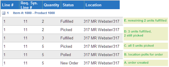

History tab |
This tab displays the status history for each line on the order, created whenever a line is:
The History tab lists records for each item in reverse chronological order (newest to oldest). A single transaction can create multiple history records if the transaction splits the line due to a partial status update or reassignment of a rejected order to multiple fulfilling locations. Optionally, you can collapse the history for an item by clicking the box next to the line number. ![]() Note: Status history and changes to the Under Review indicator are tracked at the line level even if the organization does not split orders or order lines.![]() |
Item # |
The system product code and item description for the user’s Default Organization defined through the Users screen. If the user’s Default Organization is not the organization associated with the order, the system product code and item description for the fulfilling or sourcing location is displayed. Up to 26 positions. |
Line # |
The current line number at the time the activity took place. This number might differ from the current line number if the Routing Engine split the line after initial creation in Order Orchestration because the original fulfilling location rejected it. Which line number? The status history entry always lists the line number referenced in the status update request, even if the status update creates a new line number. Example: Line 10 currently includes 5 units in picked status. A partial status update indicates to change the status of 3 units on the line to fulfilled status. This update changes the quantity of line 10 to 2, and creates a new line, line 11, for 3 units in fulfilled status. However, both status history entries list line number 10, since that was the line number referenced in the status update request. The Routing Engine does not write a separate status history record for the creation of line 11. Under Review update: An update to the Under Review indicator creates a history record for each line on the order. Pickup By Date update: An update to the Pickup By Date creates a history record. |
Requesting System Line Number |
The line number identifying the order line in the requesting location. From the line_item_no passed in the submit order message. A single line from the requesting system can create multiple order lines in Order Orchestration if the Allow Split Line preference is selected. |
Quantity |
The order line quantity at the time the activity took place. Might differ from the current quantity if the line was rejected by the original fulfilling or sourcing location and split by the Routing Engine at reassignment, or if the transaction was a partial status update. |
Status |
The status as a result of the activity indicated. See Order and Line Statuses. Note: When an order is rejected and it cannot be reassigned and, as a result, the Routing Engine changes its status to unfulfillable, 2 history records are written: 1 for the rejected status, and 1 for the unfulfillable status.Under Review update: An update to the Under Review indicator creates a history record using the order-level status, even if the status of an individual line is different; however, this update does not affect the actual status of individual lines. Example: An order includes a line in polled status and a line in new order status, so the status of the order is open. You update the Under Review indicator for the order. The history record indicates a status of open on both lines, although the status of the polled and new order lines does not change. |

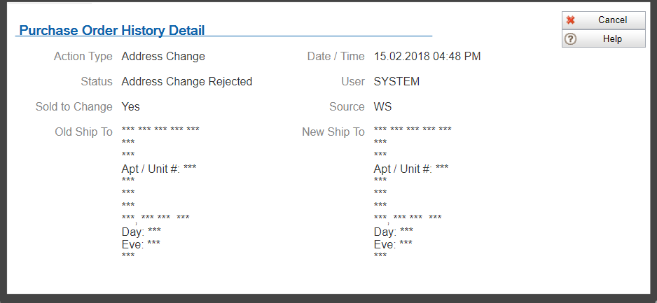

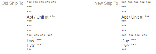

Order History Detail - Address Change Window
Purpose: Use the Order History Detail - Address Change window to review the changes made to the shipping address on a delivery order. The old ship to address is on the left side of the window and the new updated ship to address is on the right side of the window with the changes indicated in red for comparison.
Used for the Store Connect module.
Submitting address changes: A store associate with authority to edit the shipping address can update the address in Store Connect.
Customer name anonymized? If the customer data on an order has been anonymized (deleted and replaced with asterisks), the customer name is displayed as:
See Anonymizing Data for background.
How to display this window: Select the icon () in the Details column at the History tab of the Order screen. This
icon is displayed only if a store associate updated the shipping address
on a delivery order in Store Connect.
Fields at this window
Field | Description |
User |
The user ID of the person who performed the activity. |
Date / Time |
The date and time when the shipping address change was received. Format is based on the settings defined through the Users screen. |
Old Ship To |
The ship-to name and address before applying the change. Includes:
Customer anonymized? If the customer data on an order has been anonymized, asterisks are displayed for the ship-to information. See Anonymizing Data for background. |
New Ship To |
The ship-to name and address with the changes indicated in red. Includes the same name and address fields as the Old Ship To. Note: The system does not flag changes in case; for example, updating the country from US to us, in red.Customer anonymized? If the customer data on an order has been anonymized, asterisks are displayed for the ship-to information. See Anonymizing Data for background. |

Line # |
The line number of the item on the order in Order Orchestration. How might the line numbers be different? It is possible for the line number, requesting system line number, and original line number to differ; for example:
Different line numbers even if not split: It is possible for the Order Orchestration line number and requesting system line number to differ if, for example, the requesting system sends line 20 of a multi-line order to Order Orchestration (Requesting system line number); when the Routing Engine creates the order, it assigns a line number of 1 because it is the only order line received from the requesting system. Line numbers might not be consecutive: If the Routing Engine splits a line or receives a partial status update, the line numbers assigned in Order Orchestration to the split lines might not be consecutive. For example, a system sends 3 lines, which produce lines 1, 2, and 3. Subsequently, the Routing Engine receives a partial update for line 1 and creates line 4 for the quantity in the updated status. |
Original Line # |
The line number from which this line was split. Set to 0 if the line was not split after initial order creation. |

Line Status |
See Order and Line Statuses for a listing of possible statuses. |

Quantity |
The quantity that is currently assigned to the fulfilling, sourcing, or pickup location. This quantity might be different from the Original quantity if:
Original Quantity |
The quantity of the item that was originally assigned to the fulfilling or sourcing location. See the Quantity field, above, for a discussion. |

Polled Count |
Indicates the number of times the fulfilling or sourced location has sent a fulfillments message for information on assigned delivery orders, or the pickup location has sent an intransit message for information on assigned ship-for-pickup orders, and the Routing Engine has responded with a message that included this order line. Polled status updates: This counter is used only if the requesting location’s system has the Require Status Update flag at the System screen selected; otherwise, the Routing Engine sets the poll count to 1 when it receives the fulfillment request message, and sets the status to polled. See Require Status Update for Assigned Orders? for a discussion. Resetting the polled count: Changing the status of an order or order line to new_order, canceled, or fulfilled resets the polled count to 0. Intransit status updates for ship-for-pickup orders: When the sourcing location updates the status of a ship-for-pickup line to intransit, the Polled Count is set to 0. Then when the assigned pickup location sends an intransit message, the Polled Count is reset to 1. This counter is used for ship-for-pickup orders if the Require Status Update flag for the system is selected. Resetting the polled count: Changing the status of an order or order line to new_order, canceled, or fulfilled resets the polled count to 0. |

history of activity related to the purchase order, such as processing and shipment, or cancellation, address change, cost change, or due date revision

History tab: activity that has taken place for the purchase order, See the History tab for more information. From this tab, you can also advance to the Purchase Order History Detail window if there has been an address change request for the purchase order

Details |
If you have requested an address change,
click the details icon ( This option is displayed only if the address change was:

Address Change Requests | ||||
Address Change |
You submit an address change request for a purchase order in New Order status. |
WS |
New Order |
Address Change Automatically Applied |
Address Change |
You submit an address change request for a purchase order in In Process or Held status. |
WS |
unchanged |
Address Change Requested |
Address Change |
The vendor declines an address change request. |
UI |
unchanged |
Address Change Rejected |
Address Change |
The vendor accepts an address change request, either at the Purchase Order Change Requests screen or automatically when a line returns to New Order status after the vendor releases the line from hold, ships a partial quantity and returns the line to New Order status, or voids (but doesn’t reprint) the pack slip. |
UI |
unchanged |
Address Change Approved |
Address Change |
The vendor ships a purchase order with an outstanding address change request. This message is written only for the first item on the shipment. |
UI |
Shipped |
Address Change Auto Rejected |
If the purchase order is in Open status: A purchase order in Open status can include lines in New Order, Held, Shipped, Cancelled, In Process status. In this situation, each line remaining line is treated separately. |
Purpose: Use the Purchase Order History Detail window to review:
an address change applied automatically to a line because you submitted the change when the line was in New Order status
an address change you requested when a line is in In Process or Held status; these address changes do not apply until the vendor accepts them
Used for the Supplier Direct Fulfillment module.
Submitting address changes: The system originating the purchase order, such as Order Administration or CWDirect, can submit an address change through the SetDSAddress Change message.
Automatically rejected? Address change requests are not available for review in this window if they arrive when the line is already in Cancelled or Shipped status. These address change requests are automatically rejected.
Address changes for different lines on the purchase order: Even though the address change request is related to the purchase order header, Order Orchestration evaluates the status of the individual lines on the purchase order when determining whether to apply the change, reject it automatically, or submit it to the vendor for review.
Example: A purchase order is in Open status, with one line in In Process status and one line in Shipped status. The vendor needs to approve or reject the address change for the line in In Process status. The address change is automatically rejected for the line in Shipped status.
What if you submit multiple address changes for the same line? If you submit a second or third address change for the same In Process or Held line before the vendor has accepted or rejected the previously rejected change, Order Orchestration automatically rejects the previous address change. In this situation, when you display the Purchase Order History Detail window, only the name and address information for the most recent address change is displayed.
If you submit multiple address changes for a New Order line before the vendor generates the pack slip, each address change is automatically applied, and is displayed at the Purchase Order History Detail window.
Customer data anonymized? If the customer data on a purchase order has been anonymized (deleted and replaced with asterisks), asterisks are displayed for the Old Ship To and New Ship To customer name, address, phone numbers, and email address:
The address change data is anonymized regardless of whether the address change applies automatically, is accepted by the vendor, or is rejected by the vendor.
the Details column at the History tab of the Purchase Order screen. This icon is displayed only if there is an address
change request that was received when the line was in New Order, In Process, or Held status.
Available if Use Vendor Portal is selected at the Tenant screen. Only users with Purchase Order Inquiry authority can display this window. See Roles for more information.Window displayed for multiple history records? If the address change was:
accepted by the vendor = The window is available next to the history record marking both when the address change was requested and when the vendor approved the address change. The status indicated in both windows is Address Change Approved.
rejected by the vendor = The window is available only next to the history record marking when the address change was requested. The status indicated is Address Change Rejected.
Action Type |
Always set to Address Change. |
Date / Time |
The date and time when the address change request was received. Format is based on the settings through the Users screen. |
Status |
The current status of the address change (not the status at the time the history record was created). Possible statuses are:
User |
The user ID of the person who performed the activity:
Sold To Change |
Indicates whether the sold-to address for the purchase order is the same as the shipping address, so you request that both addresses be changed. Possible settings:
Source |
Indicates where the activity originated. Possible settings:
Old Ship To |
This information is from the CreateDSOrder message. Note: Not all of the information above might be available for each customer. Replaced with asterisks? If the customer data on a purchase order has been anonymized (deleted and replaced with asterisks), asterisks are displayed for the Old Ship To and New Ship To customer name, address, phone numbers, and email address. |
New Ship To |
Note: The ship-to name and address with the changes indicated in red. Includes the same name and address fields as the Old Ship To. This information is from the SetDSAddress Change message. Replaced with asterisks? If the customer data on a purchase order has been anonymized (deleted and replaced with asterisks), asterisks are displayed for the Old Ship To and New Ship To customer name, address, phone numbers, and email address. |
