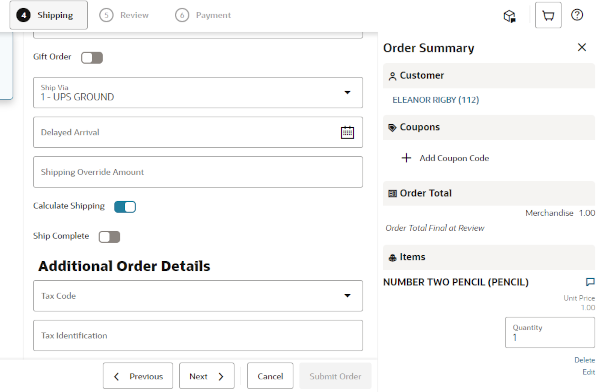

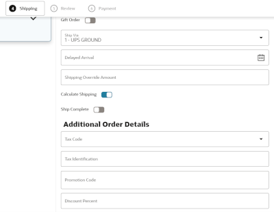

Modern View Order Entry has been changed when SCV Use ORPE Promotion Engine (M77) is enabled to support the deal types and promotions. The following now occurs:
The Promotion Code and the Discount Percent fields are hidden from view.

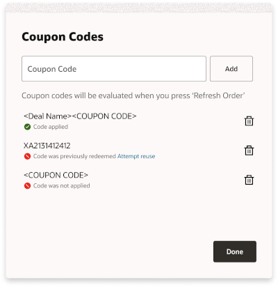

When Allow Manual Entry of Promotion Code (I63) system control value is enabled there is a new Coupons section in the Order Summary panel.
When using a source code with price method Reg Plus Reprice and the Add Coupon Code button is selected from the Coupons section of the Order Summary panel, a modal window opens so that the user can enter coupon codes. Entered coupons are evaluated during order review, rather than immediately upon closing the modal window, since additional order changes may be incorporated.
If the source code used at order entry has price method other than Reg Plus Reprice, a warning message is displayed within the Coupons section advising Source code does not support Coupons and the Add Coupon Code button is not displayed.
At the Review step, or after Refresh Order if changes were added, the Coupons section may display a message indicating that Codes were not applied; this occurs if any serialized coupons were previously redeemed or coupons were submitted for evaluation but were not applied.
At the Final Submit step, a System Update entry is written in the Order Activity tab when:
a coupon code is entered but not successfully applied by ORPE.
a serialized coupon is successfully applied by ORPE and it is successfully redeemed or not.

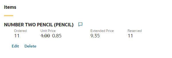

Item Level Discounts
When the offer price is greater than the unit price, the system now displays the offer price with a strike through before the discounted Unit Price. This is controlled by Display Order Line Discount Messages (F01) system control value.
Additionally, hovering over a new icon will display the discount details for each promotion applied, including the unit discount amount and the associated deal description. If the promotion was triggered by a coupon, the coupon code is included in parenthesis following the deal description.
