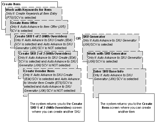

The SKU Generator is used to create all the SKUs for an item automatically. Once you define the item and the SKU group, you can run the SKU generator to automatically build all the SKU records.
When generating SKUs for an item, you can accept the defaults as defined in the SKU Groups or you can add or subtract individual SKUs.
For more information about SKU elements, SKU groups and the SKU generator, see Setting up SKUs.

Create a SKU
Select Create to advance to the Create SKU 1 of 2 (With Overrides) Screen.

SKU Item Screen Flow
SKUed item screen flow: The system automatically advances you through the following screens if the item you are copying is a SKUed item.
  1. Create Item Screen. The information on this screen defaults from the copied item; however, you can change any value.
  2. First Work with Keywords for Item Screen (only if the Create Keywords at Item Entry (F78) system control value is selected). The information on this screen does not default from the copied item.
  3. Create Item Offer Screen (only if the Auto Advance to Item Offer (J05) system control value is selected). The information on this screen does not default from the copied item.
Once you have completed creating the item, the system returns you to the Work with Items Screen. Every SKU defined for the copied item is automatically created for the new item.

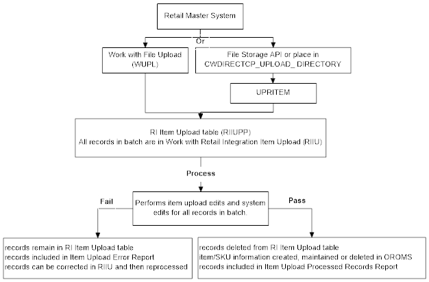

Copy Item to Company Process
Instructions: Complete the following steps to create an item upload record in the RI Item Upload Table (RIIUPP) in order to add or change item information for an item with the same item number as the copied item in each shared company, based on the action code and record types selected at the Copy Item to Company Window.
# Step
1.
In the Action to perform field, indicate the type of item activity you wish to perform.
  • A = The system creates an item upload record with a Request type of A (add), indicating the system creates the item information in the shared company. However, if the system finds a record in the Order Administration database that matches the information in the RI Item Upload record, the system updates the existing record.
  • C = The system creates an item upload record with a record type of C (maintain), indicating the system updates the item information in the shared company. However, if the system cannot find a record in the Order Administration database that matches the information in the RI Item Upload record, the system creates a new record.
2.
Select the record types you wish to create. This represents the item information you wish to create or update, based on the specified action code. See:
3.
Select Accept. The system returns you to the Work with Items Screen with a message similar to the following: Copy Item To Company program has been submitted to batch.
4.
The system creates item upload records in the RI Item Upload Table (RIIUPP), based on the action code and record types selected. Each item upload record is created with:
  • A Key type of IT (item/SKU), indicating the system identifies the item in the shared company using the Item and SKU fields in the item upload record. The Copy Item to Company program populates these fields with the item number and optionally, SKU code, defined for the copied item.
  • A Status of U (unprocessed), indicating the item upload record is ready to be processed.
5.
Once the Copy Item to Company program has created all of the item upload records, the system automatically submits the RI Item Upload process to process the records in the RI Item Upload Table (RIIUPP). See RI Item Upload Process for processing details.
If item upload records already exist in the RI Item Upload table, the system processes those records along with the records created through the Copy Item to Company program.
6.
The system creates supporting table values for items/SKUs through the item upload if the value does not exist in the shared company. For example, if the buyer code does not exist in the shared company, the system creates it. See Tables Updated by the RI Item Upload for a list of the tables for which the RI Item Upload process will create new records.
9.
The system places any records that contain errors in an error status in the RI Item Upload Table (RIIUPP) and Retail Integration Item Upload Error table. You can review the records in error on the Item Upload Error Report and on the Work with Retail Item Upload Errors Screen in Working with Retail Integration Item Upload (RIIU). See Retail Item Upload Errors for a list of errors that may occur.
Item upload records in error are listed in the Work with Retail Integration Item Upload (RIIU) menu option in the shared company, not the company where the copied item is located. For example, if you create the copied item in shared companies 100 and 200 and both item upload records error, you must review and correct the item upload record in error in each shared company (companies 100 and 200).
10.
Once the Item Upload process completes, the system generates the following reports:
Item Upload Records Created
The table below indicates the type of item upload record created, based on the action code and record type selected.
Action / Record type Item Upload Record Created
  Item upload records created for record type Item/SKU
A
Item/SKU
The item upload record contains:
  • Record type 01 (item/SKU), indicating the system populates the item and SKU fields in the item upload record using the item/SKU information defined for the copied item. See Fields for 01 Item/SKU record type for a list of the fields populated.
  • Request type A (add), indicating the system creates the item in the shared company. If the copied item contains SKUs, the system creates a separate item upload record for each item/SKU.
If the item already exists in the shared company, the system automatically changes the Request type to C (maintain).
Short SKU: The system generates a new short SKU code for each item/SKU created in the shared company.
Long SKU department and long SKU division: The system creates the long SKU department in the shared company if it does not already exist. In addition, if a long SKU division is defined for the long SKU department being created, the system also creates the long SKU division in the shared company. However, if the long SKU department does not need to be created, the system will not create the long SKU division in the shared company if it does not already exist.
Cost: The system copies the cost defined.
**DFLT ITEM: If a field for the copied item is blank, the system creates the item upload record and leaves the field blank. However, if the **DFLT ITEM Item/SKU exists as an item in the shared company, the system defaults the value defined for the **DFLT ITEM item to the blank field in the RI Item Upload record. For example, if the buyer code is blank from the copied item, but the **DFTL ITEM contains buyer code BTM, the system defaults BTM to the item upload record and creates the item in the shared company with buyer code BTM. See **DFLT ITEM Item/SKU for more information on setting up this item.
Item Upload Processing Results: The system creates an item/SKU in each shared company, using the item number and item/SKU information from the copied item. If the copied item contains SKUs, the system creates a SKU for each SKU defined for the copied item.

Item Upload Processing Results: In each shared company, the system updates the item/SKU with the same item number as the copied item, using the item/SKU information from the copied item.
  Item upload records created for record type Item Offer
A
Item Offer
  • Record type 03 (item offer), indicating the system populates the item offer fields in the item upload record using the item offer information defined for the copied item. See Fields for 03 Item Offer record type for a list of the fields populated.
  • Request type A (add), indicating the system creates the item offer in the shared company. If the copied item contains SKUs, the system creates one item upload record for the main item only. If the item offer already exists in the shared company, the system automatically changes the Request type to C (maintain).
Item Upload Processing Results: In each shared company, the system creates item offers for the item with the same item number as the copied item, using the item offers from the copied item.
C
Item Offer
  • Request type C (maintain), indicating the system updates the item offer in the shared company. If the copied item contains SKUs, the system creates one item upload record for the main item only. If the item offer does not exist in the shared company, the system automatically changes the Request type to A (add).
Item Upload Processing Results: In each shared company, the system updates the item offer(s) for the item with the same item number as the copied item, using the item offer information from the copied item.

Introducing SKU Setup
Purpose: This topic contains an explanation of SKUs, SKU types, SKU elements, SKU groups, SKU sort sequence numbers and the SKU generator.
Definition: A SKU (stock keeping unit) is used to further define an item number. An item that is sold in multiple colors and sizes is often represented by a base item number, which is common to all of the colors and sizes, and a SKU which specifically defines the color and size. For example, the base item number for a dress could be 9201 and the SKUs associated with that item number could be RED SML, RED MED, RED LRG, BLUE SML, BLUE MED, and BLUE LRG.

The SKU Generator is used to create an array of SKUs for an item automatically. Once you define the item and the SKU group, run the SKU generator option to automatically build all the SKU records.
See Using the SKU Generator (ESKG).
Before you can work with SKUs, you must create the SKU information on the system. You can also create SKUs by selecting Create at the Work with SKUs Screen.

Item Upload Batch Processing
Batch processing overview: This flowchart summarizes the process of passing batch item upload records from a retail system other than RMFCS to Order Administration.
This image shows the workflow for the Item Upload Batch Processing
How do you upload retail merchandise information? Use the File Storage API or Work with File Uploads (WUPL) to upload retail merchandise information into the RI Item Upload Table (RIIUPP).
  • If you use the File Storage API to upload the generic Retail Integration Item file named RIIUPP into the FILE_STORAGE table in the database, you need to use the UPRITEM Upload Retail Item File (Program name PFR0134, Parameter RIIUPP) periodic function to create records in the RI Item Upload Table (RIIUPP).
  • If you use Work with File Uploads (WUPL), the RI Item Upload Table records are created through the upload process.
How do you process records in the RI Item Upload table? Once you have passed item upload records from your retail master system to the RI Item Upload table, you can view all the records in the batch using the Working with Retail Integration Item Upload (RIIU) menu option. In order to process the records in the RI Item Upload table:
Records that pass all edits: The system deletes these records from the RI Item Upload table and the requested update (create or maintain) is made in Order Administration.
Records that fail one or more of the edits: The system retains these records in the RI Item Upload table and also creates a record for each RI Item Upload record in error in the RI Item Upload Error table. You can review and correct the errors, or delete the record(s) using Working with Retail Integration Item Upload (RIIU). You can review item upload records in error on the:
Retail Item Upload email: If a valid email is defined in the Email address field for the user that submitted the RI Item Upload Program, the system sends a Retail Item Upload Email to the user’s email address when the job completes indicating whether all records were processed successfully or whether any records contain errors.
For more information: See Working with Retail Integration Item Upload (RIIU).

You can schedule the periodic functions, including the UPRITEM Upload Retail Item File (Program name PFR0134,ParameterRIIUPP), the RI Item Upload Translation Program, and RI Item Upload Edit Program to run the Item Upload Process periodically. See Scheduling Jobs for background.
Creating Default and Change Item/SKU Upload Values: **DFLT ITEM and **DFTCHG
You can create the following items in Order Administration for the system to consider when uploading RI item upload records for record type 01 (item/SKU information).
  • **DFLT ITEM: create this item in Order Administration to define the values to default to add or change item upload records; see **DFLT ITEM Item/SKU.
  • **DFTCHG: create this item in Order Administration to determine when the system updates an existing item/SKU with the values defined in a change item upload record; see **DFTCHG Item/SKU.
You are not required to create the **DFLT ITEM item or **DFTCHG item, however it is recommended.

Creating SKU'ed Items Screen Flow
Select the SKUs field on the Create Item Screen to create a SKU’ed item. The system automatically advances you through the following screens to create a SKU’ed item.
# Step
1.
Create Item Screen
2.
3.
4.
Depending on whether you are using the SKU Generator:
  1. Create SKU 1 of 2 (With Overrides) Screen (only if the Auto Advance to SKU Create (B34) system control value is selected and the Auto Advance to SKU Generator (J06) system control value is unselected)
  2. SKU Generator Screen (Entering SKU Information) (only if the Auto Advance to SKU Generator (J06) system control value is selected)
6.
  1. Create SKU 2 of 2 (With Overrides) Screen (only if the Auto Advance to SKU Create (B34) system control value is selected and the Auto Advance to SKU Generator (J06) system control value is unselected)
  2. Work with SKU Generator Screen (only if the V system control value is selected)
7.
  1. Create Vendor Item Screen (only if the Auto Advance to SKU Create (B34) system control value is selected, the Auto Advance to Vendor Item Create (E78) system control value is selected and the Auto Advance to SKU Generator (J06)system control value is unselected)
  2. Enter SKU Base Information Pop-Up Window (only if the Auto Advance to SKU Generator (J06) system control value is selected)
Once you have completed creating the item and SKU, you return to the:
SKU’ed item screen flow:
Sku’d Item screen flow
Create Item Screen

Completing this screen: If you are creating a SKU'ed item, you advance to the Create Item Offer Screen. If you are creating a non-SKU'ed item, you advance to the Create Item (Base Information) Screen.
Purpose: Use this screen to create SKU level information for a non-SKU’ed item.
How to display this screen: Complete the Create Item Screen with the SKUs field unselected.

Completing this screen: You advance to the Create Vendor Item Screen if the Auto Advance to Vendor Item Create (E78) system control value is selected; otherwise, you advance to the Create Item Offer Screen.

Completing this screen: If you advanced to this screen through initial item creation, you return to the Create Item Screen.
Select Exit at this screen if you do not want to create an item/offer.
Purpose: Use this screen to create a SKU for a SKU’d item.
Completing this screen: Select OK to advance to the Create SKU 2 of 2 (With Overrides) Screen. This screen contains additional SKU attributes, including those related to long SKU and physical dimensions.
After you create a SKU, the system returns you to this screen, allowing you to create another SKU. You can select Exit when you have finished creating all SKUs.
You can also select Exit if you wish to create a SKU’ed item without creating the individual SKUs at this time.
