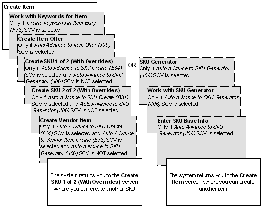

Creating and Working with Items
Purpose: The following chapters describe how to create and work with items.
- Performing Initial Item Entry (MITM) describes selecting items, creating items, creating item (base information), creating offers, and creating SKUs with overrides.
- Working with Existing Items (MITM) includes scanning, changing, deleting, and displaying items that have been created.
- Working with SKUs defines split SKU elements, SKU groups, and the SKU generator. This topic includes how to scan for, change, delete, and display SKUs.
- Assigning Items/SKUs to Offers includes how to work with item/SKU offers, price breaks, page letters, aliases, and accompanying items.
- Assigning Items to Warehouses discusses item warehouse information and item location information.
- Entering Additional Item Information describes comments and source prices.
- Working with Item Tax Exemptions (WITX) describes how to set up tax exemptions or exceptions for specific items or item classes by location.
- Working with GST Tax Exemption Status (MGTX) describes how to set up tax exemptions or exceptions for specific items by Canadian province.
- Updating Harmonize Codes (UPHC) describes how to update harmonize codes quickly for multiple items or SKUs.
- Working with Freight Exempt Items (WFEI) describes how to exclude items from freight.
- Working with Item Ship Via Overrides describes how to set up eligible shippers for an item.
- Working with Item Coordinate Types (WICT) describes how to create and work with item coordinate types.
- Copying Items describes how to copy item information from one item to a newly created item in the same company or copy item information from one item to another item, with the same item number, in one or more shared companies.

SKUed item screen flow: The system automatically advances you through the following screens if the item you are copying is a SKUed item.
- Create Item Screen. The information on this screen defaults from the copied item; however, you can change any value.
- First Work with Keywords for Item Screen (only if the Create Keywords at Item Entry (F78) system control value is selected). The information on this screen does not default from the copied item.
- Create Item Offer Screen (only if the Auto Advance to Item Offer (J05) system control value is selected). The information on this screen does not default from the copied item.
Once you have completed creating the item, the system returns you to the Work with Items Screen. Every SKU defined for the copied item is automatically created for the new item.
Table updates: The system copies the Item record and SKU record when you copy item information from one item to a newly created item. However, the following fields are not copied.

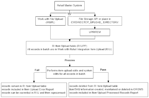

Copy Item to Company Process
Instructions: Complete the following steps to create an item upload record in the RI Item Upload Table (RIIUPP) in order to add or change item information for an item with the same item number as the copied item in each shared company, based on the action code and record types selected at the Copy Item to Company Window.
# | Step |
1. |
In the Action to perform field, indicate the type of item activity you wish to perform.
2. |
Select the record types you wish to create. This represents the item information you wish to create or update, based on the specified action code. See:
3. |
Select Accept. The system returns you to the Work with Items Screen with a message similar to the following: Copy Item To Company program has been submitted to batch. |
4. |
The system creates item upload records in the RI Item Upload Table (RIIUPP), based on the action code and record types selected. Each item upload record is created with:
5. |
Once the Copy Item to Company program has created all of the item upload records, the system automatically submits the RI Item Upload process to process the records in the RI Item Upload Table (RIIUPP). See RI Item Upload Process for processing details. Note: If item upload records already exist in the RI Item Upload table, the system processes those records along with the records created through the Copy Item to Company program. |
6. |
The system creates supporting table values for items/SKUs through the item upload if the value does not exist in the shared company. For example, if the buyer code does not exist in the shared company, the system creates it. See Tables Updated by the RI Item Upload for a list of the tables for which the RI Item Upload process will create new records. |
9. |
The system places any records that contain errors in an error status in the RI Item Upload Table (RIIUPP) and Retail Integration Item Upload Error table. You can review the records in error on the Item Upload Error Report and on the Work with Retail Item Upload Errors Screen in Working with Retail Integration Item Upload (RIIU). See Retail Item Upload Errors for a list of errors that may occur. Note: Item upload records in error are listed in the Work with Retail Integration Item Upload (RIIU) menu option in the shared company, not the company where the copied item is located. For example, if you create the copied item in shared companies 100 and 200 and both item upload records error, you must review and correct the item upload record in error in each shared company (companies 100 and 200). |
10. |

Batch processing overview: This flowchart summarizes the process of passing batch item upload records from a retail system other than RMFCS to Order Administration.
How do you upload retail merchandise information? Use the File Storage API or Work with File Uploads (WUPL) to upload retail merchandise information into the RI Item Upload Table (RIIUPP).
- If you use the File Storage API to upload the generic Retail Integration Item file named RIIUPP into the FILE_STORAGE table in the database, you need to use the UPRITEM Upload Retail Item File (Program name PFR0134, Parameter RIIUPP) periodic function to create records in the RI Item Upload Table (RIIUPP).
- If you use Work with File Uploads (WUPL), the RI Item Upload Table records are created through the upload process.
How do you process records in the RI Item Upload table? Once you have passed item upload records from your retail master system to the RI Item Upload table, you can view all the records in the batch using the Working with Retail Integration Item Upload (RIIU) menu option. In order to process the records in the RI Item Upload table:
- Select Process at the Work with Retail Item Upload Screen.
- Select Accept at the Copy Item to Company Window in Working with Existing Items (MITM).
- Submit the RIUPLD function using the PFR0084 program. See Scheduling Jobs for background.
Records that pass all edits: The system deletes these records from the RI Item Upload table and the requested update (create or maintain) is made in Order Administration.
Records that fail one or more of the edits: The system retains these records in the RI Item Upload table and also creates a record for each RI Item Upload record in error in the RI Item Upload Error table. You can review and correct the errors, or delete the record(s) using Working with Retail Integration Item Upload (RIIU). You can review item upload records in error on the:
- Item Upload Error Report: lists item upload records that are in error.
- Record Deleted from RI Item Upload Report: lists item upload records that you manually deleted at the Work with Retail Item Upload Screen.
Retail Item Upload email: If a valid email is defined in the Email address field for the user that submitted the RI Item Upload Program, the system sends a Retail Item Upload Email to the user’s email address when the job completes indicating whether all records were processed successfully or whether any records contain errors.
For more information: See Working with Retail Integration Item Upload (RIIU).

- Creating Items Screen Flow
- Creating Non-SKU’ed Items Screen Flow
- Creating SKU'ed Items Screen Flow
Purpose: Select Create at the Select Items Screen or the Work with Items Screen to add an item.
Select the SKUs field on the Create Item Screen to create a SKU’ed item. The system automatically advances you through the following screens to create a SKU’ed item.
# | Step |
1. |
2. |
First Work with Keywords for Item Screen (only if the Create Keywords at Item Entry (F78) system control value is selected) |
3. |
Create Item Offer Screen (only if the Auto Advance to Item Offer (J05) system control value is selected) |
4. |
Depending on whether you are using the SKU Generator:
6. |
7. |
Once you have completed creating the item and SKU, you return to the:
- Create SKU 1 of 2 (With Overrides) Screen if you are not using the SKU Generator, where you can create another SKU.
- Create Item Screen if you are using the SKU Generator, where you can create another item.
SKU’ed item screen flow:
Purpose: Use this screen to create a SKU for a SKU’d item.
How to display this screen:
- You advance to this screen automatically when you create a SKU’d item if the Auto Advance to SKU Create (B34) system control value is selected and the Auto Advance to SKU Generator (J06) system control value is unselected. See Creating SKU'ed Items Screen Flow.
- Select Create at the Work with SKUs Screen.
Completing this screen: Select OK to advance to the Create SKU 2 of 2 (With Overrides) Screen. This screen contains additional SKU attributes, including those related to long SKU and physical dimensions.
After you create a SKU, the system returns you to this screen, allowing you to create another SKU. You can select Exit when you have finished creating all SKUs.
You can also select Exit if you wish to create a SKU’ed item without creating the individual SKUs at this time.
Purpose: Use this screen to enter additional information for a SKU.
The values you enter in the "override" section of the screen override the values you entered for the base item. If you leave any of these fields blank and you have entered values at the base item level, the system uses the base item values. For example, if you leave height, length, and width blank and there is a height, length, or width defined at the base item level, the system uses the values at the base item level.
How to display this screen: Select OK at the Create SKU 1 of 2 (With Overrides) Screen.
Completing this screen: When you select OK at this screen, the system:
- If the Auto Advance to Vendor Item Create (E78) system control value is selected, automatically advances you to the Create Vendor Item Screen.
- If the Auto Advance to Vendor Item Create (E78) system control value is unselected, creates the SKU after validating your entries and highlighting any errors, if necessary.
After you create a SKU, the system returns you to the Create SKU 1 of 2 (With Overrides) Screen, allowing you to create another SKU. You can select Exit when you have finished creating all SKUs.
