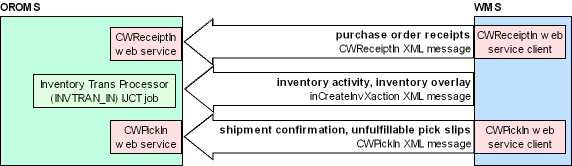

Purchase Order Receipt In API: You can use the Purchase Order Receipt In API to process PO receipts received from another system, such as a warehouse management system. See the Purchase Order Receipt In API for an overview and the required setup.
PO download triggers: The setting of the Create Generic PO Download Trigger for PO Receipt (K27) system control value determines whether the system creates a purchase order download (POH) trigger when a purchase order line is received. See Generic Outbound Purchase Order API for an overview.
For more information see the Order Administration Web Services Guide on My Oracle Support (ID 2953017.1).

Warehouse Management System Integration Overview
Warehouse management systems control inventory movement, such as receiving merchandise, inventory transactions, picking and packing, and shipping merchandise to a customer.
The Warehouse Management System integration allows Order Administration and a warehouse management system (WMS) to pass inventory information in order to keep inventory information in both systems accurate. The WMS is where the actual inventory is located, but Order Administration needs to keep track of the changes to inventory that occur in the WMS so that the data in Order Administration remains accurate. For example, if the WMS adjusts the inventory for an item and does not notify Order Administration, orders placed in Order Administration may reserve items that do not have enough inventory in the warehouse.
The warehouse management system integration creates a bridge between Order Administration and a WMS. This bridge allows Order Administration and a WMS to pass data between the two systems using XML messages transmitted via a queue or web service.
In this topic:
What Does Order Administration Send to the Warehouse Management System?
What Does the Warehouse Management System Send to Order Administration?
Order Administration controls item information, vendor information, purchase order information, pick slip information, and return information. Any time you create or modify information in these areas, Order Administration sends the information to the warehouse management system.
The warehouse management system controls changes to inventory, such as purchase order receipts, inventory transactions, and shipping merchandise to customers. Any time the warehouse management system adds or removes inventory in a warehouse, the WMS sends the information to Order Administration.
Warehouse Integration Summary
| Function | Performed By: |
Items: Order Administration sends new or changed items to the warehouse management system (WMS) |
Generic Item Download API For more information see the Order Administration Web Services Guide on My Oracle Support (ID 2953017.1). |

Purchase orders: Order Administration sends new or changed purchase orders to the WMS |
Generic Outbound Purchase Order API For more information see the Order Administration Web Services Guide on My Oracle Support (ID 2953017.1). |
Purchase order receipts: Order Administration receives information on purchase order receipts sent from the WMS |
Purchase Order Receipt In API For more information see the Order Administration Web Services Guide on My Oracle Support (ID 2953017.1). |
Inventory activity: Order Administration receives information on inventory activity, such as transfers or adjustments, from the WMS |
Generic Inventory Transaction Upload For more information see the Order Administration Web Services Guide on My Oracle Support (ID 2953017.1). |
Inventory overlay: Order Administration receives updated inventory information from the WMS |
Pick slip generation: Order Administration sends information on generated pick slips to the WMS |
Generic Pick Out API For more information see the Order Administration Web Services Guide on My Oracle Support (ID 2953017.1). |
Pick slip void: Order Administration sends information on voided pick slips to the WMS |
Shipment confirmation: Order Administration receives information on full or partial shipments; information on carton contents can also be included |
Generic Pick In API (Shipments, Voids, and Backorders) For more information see the Order Administration Web Services Guide on My Oracle Support (ID 2953017.1). |
Unfulfillable pick slips: Order Administration receives information on pick slip voids from the WMS |
Returns: Order Administration sends updates on customer returns to the WMS |
NA |
