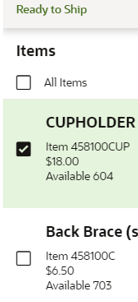

Items: For each item on the order that is assigned to your current store location and ready to be shipped, the following information is displayed. Items on the order that are assigned to a different store location for shipping or sourcing are not displayed on this screen. You can review all order lines at the View Full Order screen. |
| All items |
Optionally, clear this check box if you would like to ship one or more, but not all order lines. This check box is available only if your organization supports shipping one or more order lines without shipping the entire order, but does not support shipping a partial quantity of an order line, and if you have selected Change to Ship Partial Order. |
| Unlabeled check box |
Optionally, clear this check box if you do not want to ship this item at the current time, but want to ship one or more other items. This check box is available only if your organization supports shipping one or more order lines without shipping the entire order, but does not support shipping a partial quantity of an order line, and if you have selected Change to Ship Partial Order. |
| Item description |
A description of the item. An image of the item may also be displayed. |
| Item code |
A code identifying the item. |
| Price |
The price of a single unit of the item. |
| Available Quantity |
The available quantity of the item after subtracting the quantity on any open orders. |
| Quantity Picked |
The current quantity of the order line that has been picked. |
