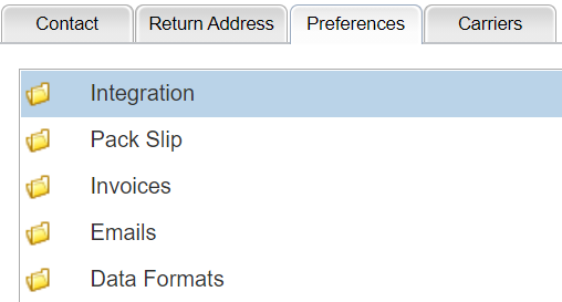

Each vendor preference category is available by clicking the folder in the left-hand tab. ![]() |

| Carriers tab |
Use this tab to indicate which carriers the vendor can use for shipping drop ship orders. Only carriers flagged as Active are available at this tab. All other fields at this tab are display-only; use the Carriers screen in Modern View to work with these settings for a carrier. Assigned by default: When you create a new vendor, all active carriers are assigned to the vendor by default. Also, when you create a new active carrier, it is automatically assigned to all existing vendors by default. Automatic creation of carrier: When you create a new carrier through the CreateDSOrder message, Order Broker creates a new carrier record, using a description of Auto Created XYZ, where XYZ is the carrier_cd passed in the message. The carrier is automatically assigned to all existing vendors as an active carrier, with the Tracking # Required, Weight Required, and Rate Required flags all unselected, indicating that the vendor does not need to supply this information when confirming a shipment for the carrier. For more information: See the Carriers screen in Modern View for more information on setting up carriers. |
