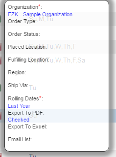

| review a summary of the report schedule |
Move the cursor over the active ( ![]() |

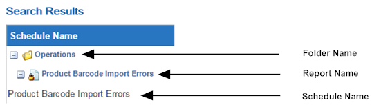

| Results Fields |
The left-hand part of this area of the screen includes:
Each of these fields is described below. ![]() |
| Report Folders (unlabeled field) |
| Report Name (unlabeled field) |
The report to generate using the options selected at the Schedule Report window. |
| Schedule Name |
The name describing the schedule you created so that Order Broker can generate the report on a periodic basis, using the settings from the Schedule Report window. |
Note: The dates and times are based on the retailer’s time, which may be different from your local time zone. |

You can also review a summary of the report schedule by moving the cursor over the active (Creating or editing a schedule: Enter or change the information at this window and click Save. See the field descriptions below for more information.
