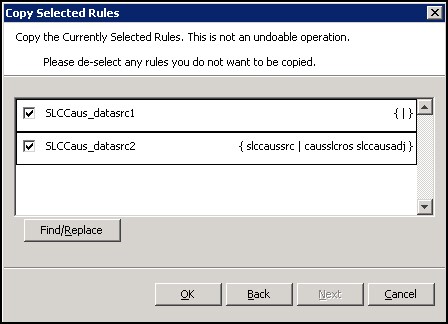

Copy a Solution
Complete the following steps to copy a solution.
Select the solution to be copied.
Right-click in the Configuration Components pane and click Copy. The Copy solution window opens.
Type the new name for the solution in the text box.
This is the name that the solution is called after it has been copied.
Select the project where the solution is to be copied.
Click Finish to save the copied solution in the specified project.

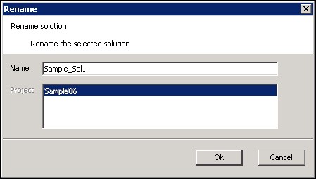

Rename a Solution
Complete the following steps to rename a solution.
Select the solution to be renamed.
Right-click in the Configuration Components pane and select Rename. The Figure 4-3 opens.
Delete the old name from the resulting field and type the new name.
Click OK to save the new name.

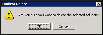

Delete a Solution
Complete the following steps to delete a solution.
Select the solution to be deleted.
Right-click in the Configuration Components pane. The Figure 4-5 opens.
Click OK to complete the deletion.

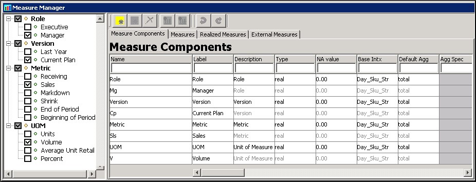

Measures and Components
This section describes:
Measure Manager

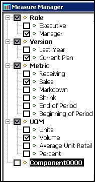

The Measure Manager window allows you to define major and minor components of measures and to specify properties for each component. Once the component structure is defined, the Measure Manager generates measures by combining the components that are selected. You may then select (realize) the valid measures and further update the properties for individual measures.
Measure Properties
This section describes the fields displayed in the Measures tab.
Inheritance
Measure properties are inherited at the component level. The properties defined for a component are inherited by the minor components that belong to that component and to the measures that are associated with that component unless it is overridden at a lower level.
When a measure can inherit a property from more than one of the components that construct it, the measure inherits from the component that belongs to the highest major component in the component tree. For many properties, it is a good practice to set the properties for just one major component or for minor components in just one major component branch.
Measure Components
A major component is the highest level in the component inheritance hierarchy. Properties defined at this level are inherited by all minor components that are created under the major component.
Within each major component, you can create one or more minor components. You can also create a minor component under a minor component and also modify properties at the minor component level.
Once major and minor components are defined, the Measure Manager generates measures that are based on the combination of selected components. These measures cannot be used elsewhere in the configuration tools until the valid prototype measures are realized.
Components have no structural impact on the built solutions, and they are not exposed to end users. Components are intended to be a convenience to aid the configuration administrator to easily group measures together and to set measure properties at higher levels.

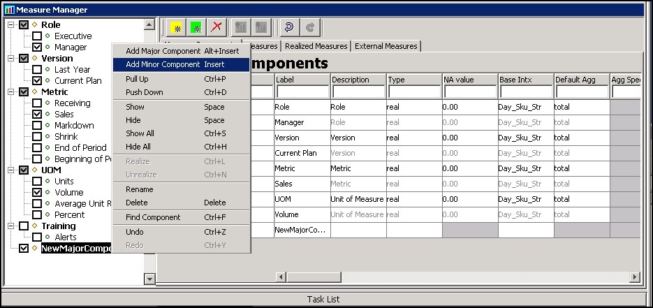

Create a Major Component
Complete the following steps to create a major component.
Navigate: In the Configuration Components pane, select Project then Solution then, Measures and then the Measure Components tab. The Measure Manager window opens in the workspace.
Figure 4-7 Measure Manager Window - Measure Components Tab
Description of "Figure 4-7 Measure Manager Window - Measure Components Tab"

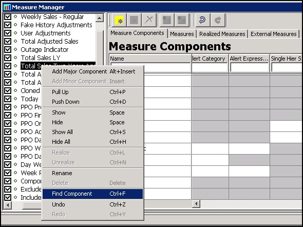

Right-click in the left-hand pane of the Measure Manager window and select Add Major Component or click Add Major Component. The major component displays in the Measure Manager navigation tree with a default name.
Figure 4-8 Measure Manager Navigation Tree
Description of "Figure 4-8 Measure Manager Navigation Tree" -
To change the component name, right-click on the component and select Rename, or select the component from the navigation tree and then modify its Label field from the Measure Components tab.
Create a Minor Component
Complete the following steps to create a minor component.
Figure 4-9 Major Measure Component Selected
Description of "Figure 4-9 Major Measure Component Selected"
Select the major or minor component that the new minor component is to be added beneath. In Figure 4-9, NewMajorComponent is selected.
Choose one of the following methods:
Right-click the Measure Definition navigation tree and select Add Minor Component.
Click Add Minor Component.
Press Insert.
The minor component displays in the Measure Manager navigation tree with a default name.
To change the name, right-click on the component from the navigation tree and select Rename. You can also select the component from the navigation tree and modify the Label field from the Measure Components tab.
Defining Measure Component Properties
Complete the following steps to define the Measure Component properties.

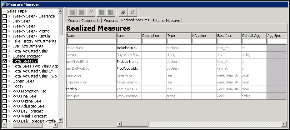

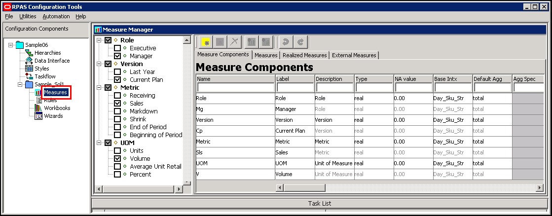

Once components have been created, open the Measure Manager and select the Measure Components tab.
Select the major or minor components you want to view from the Measure Manager navigation tree. The selected components display in the Measure Components tab.
Specify the information for the component properties (for example, Name, Label, Description, and so on), which will apply to the measures that are inheriting property values from the component.
The values that are entered for major components are inherited by the child minor components and the auto-generated measures. Not all properties need to be entered for all components. Properties that are grayed out in the component properties table cannot have a value in the current context. Typically, this is based on the data type of the measure. For example, only components of Boolean data type can have an alert category or an alert expression.
This section describes the fields displayed in the Measure Components tab.
Name
The name (identifier) of a component is used to identify the component within the Configuration Tools. Measure names are built by concatenating the names of the components from which the measure is built. They are concatenated in the order (from top to bottom) of the sequence that the components display in the list of components. You can override the measure name by manually entering a new name in the Name field. Measure names can be up to 30 characters in length. They can include letters and numbers but must start with a letter.
Label
The label of the component is used to generate measure labels in a similar way that measure names are generated. Labels are displayed to RPASCE end users. There is no maximum size limit but keep the grid display limitations in mind when creating a measure label.
Even though measure/fact labels are not required to be unique, RPASCE strongly suggests against duplicate labels, because they are used as identifiers within the user interface of RPASCE applications. The labels of Report Category measures are used in OAS UI and have additional restrictions. See the Create Reporting Views in PDS section of Oracle Retail Predictive Application Server Cloud Edition Administration User Guide for fact label restrictions.

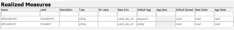

Base Intx
The Base Intersection. The lowest level at which data is used for a measure. In the PDS, the measure is stored as a fact. For non-shared measures, they are stored at the measure’s base intersection. For shared measures, the measure’s base intersection may be higher than the fact intersection. Inside a workbook (for performance reasons), values for the measure may be stored higher than the base intersection. Nevertheless, whether stored or not, values for aggregated levels may be viewed in a workbook and used in calculations in workbooks or applications. Double-click this field to open the Select Intersection window. The hierarchies that were defined using the Hierarchy tool are displayed. One dimension from each hierarchy can be selected, but a dimension is not required for each hierarchy. Alternatively, a measure may be marked as scalar. A scalar measure has only one value at any combination in the positions of dimensions of the application. A Labeled Intersection may also be selected as the base intersection of a measure. The Labeled Intersection field is populated based on the Labeled Intersections defined through the Labeled Intersection window accessed in the Hierarchy Definition manager.
RPASCE imposes a limit of five dimensions that can be defined in a measure's base intersection.
Multi-Level Display
Deprecated. This property indicates whether the measure supports the display of its data at intersection levels lower than its base intersection. Possible values are true and false. See the Oracle Retail Predictive Application Server User Guide for more details about multi level display and about editing a measure.
Default Agg
The default aggregation method should be selected from the valid aggregation methods for the component. The valid aggregation method depends on the data Type selected for the component. See Appendix – Calculation Engine User Guide and Appendix – Rules Function Reference Guide for more information on aggregation and spread methods.
Only measures with an aggregation type of ambig, pst, or pet can be aggregated from lower than the partition levels to higher than the partition levels in a global application.

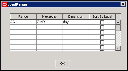

Suppose that XYZ must be aggregated to the level of mnthclssrgn_. The process of generating this new value is accomplished by three successive aggregations:
day_sku_str_ to day_clssstr_ by total (product)
day_clssstr_ to day_clssrgn_ by total (location)
day_clssrgn_ to mnthclssrgn_ by first (calendar)
In this example, the user is allowed visibility to and control over the mechanism by which pst is performed.

When a measure is specified for hybrid agg, the agg spec (aggregation specification) field becomes editable.

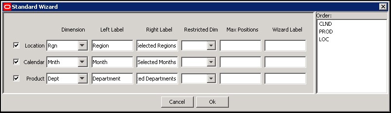

An agg spec can be typed in or built through a window (double-click the agg spec editor or select Ctrl-Space to launch it).
This window looks very similar to the standard wizard for workbooks. On the right, the ordering of hierarchies in the intersection of the measure is set by dragging the hierarchies in the list. On the left, a separate aggregation type is selected for each hierarchy. For the most part, these are the aggregation types that are available for the measure based on its type.
Exceptions are as follows:

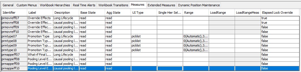

UI Type
The UI Type property affects how the user interacts with a measure within the client. There are two supported values for UI Type; by default, UI Type is unspecified, meaning that the measure exhibits no special behavior within the client.
Picklist – When a measure is given a UI Type of picklist, it will no longer accept edits within the client. Instead, the user will be provided with a drop-down box that contains a set of valid values. Selecting an item in this drop-down will set the cell of the measure to the appropriate value. For picklist measures, the contents of the drop-down box are determined by the range attribute.
Media – When a measure is given a UI Type of media, the RPASCE Client will not display the values of the measure's cells. Instead, it will examine the contents of a cell to extract image location information, retrieve the appropriate image resource and display that image in the cell. For a measure to have a UI Type of media, that measure must be a string type measure.
For information regarding the values that should be loaded into a media UI Type measure; see the Media Measures section of the Oracle Retail Predictive Application Cloud Edition Administration Guide.

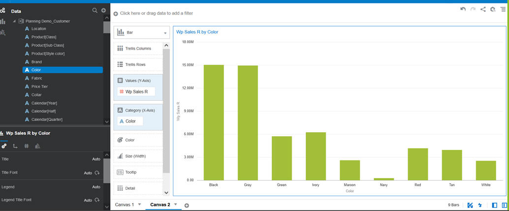

Enable Viewing Fact Data by Dimension Attributes in Data Visualization (DV)
Figure 4-14 An Example of Viewing Sales Data by Color Attributes in DV
The one-dimensional and two-dimensional attribute measures must have the Report Category values configured; the following assumptions and requirements apply.
| 1 | View generation based on Attribute measures. The views only contain the base dimension levels (no roll up levels). |
| 2 | The configurator must assign Report Category for the attribute
measures:
| 3 | In the application configuration, multiple levels of the same hierarchy can have their own two-dimensional attribute measures. So, one hierarchy may have multiple two-dimensional attribute measures with different measure base intersection. |
| 4 | In PDS, one hierarchy may have multiple attribute hierarchies that come from different applications. For example, PROD may have attribute hier PAT1 in app1 and PAT2 in app2. The dimensions within PAT1 and PAT2 must have different dim names. |
| 5 | In PDS, the two-dimensional attribute measures of the same measure base intersection (due to multiple applications) must not have the same report category. If they do, the integration configuration generation will fail. |
| 6 | In PDS, if the two-dimensional attribute measures are shared measures, then they are just the same fact; if they are not shared, then their requirements are covered above. |

Edit Components
Navigate: In the Configuration Components pane, select Project, then Solution, and then Measures. The Measure Manager window opens in the workspace.
Move Components
From the Measure Manager navigation tree, select the component to be moved.
Drag the component to the new location and release it.
A minor component cannot be moved to a different major component.
The configuration administrator cannot move a component so that it would be a descendent of another component that is used in the specification of a realized measure.
Push Components Down
From the Measure Manager navigation tree, select the component to be pushed down.
Right-click in the Measure Definition menu and select Push Down.
The component is pushed down one level in the component hierarchy, and a new component is created to take the place of the pushed down component.
A major component cannot be pushed down.
Pull Components Up
From the Measure Manager navigation tree, select the component to be pulled up.
Right-click and select Pull Up. The component is pulled up one level in the component hierarchy.
A minor component cannot be pulled up to become a major component, nor can a major component be pulled up.
Display or Hide Components
To display information about a component, select the check box next to the component name.
To hide information about a component, clear the check box next to the component name.
Selecting or clearing a check box for a major or minor component causes the check boxes for all minor components underneath it to be selected or cleared. This check box is also used to enable a component so it becomes active when measures are generated.
Find a Component
Right-click in the Measure Manager navigation tree and select Find Component. The Input window opens.
Type in the name of the desired component and click OK. The tree will scroll to bring the specified component into view.
Select the desired component.
The full name (case sensitive) of the component is required in order to find it. If there is no component with the exact name entered, the tree will not scroll.
Rename a Component
Navigate: From the Measure Manager navigation tree, select the component to be renamed.
Right-click in the Measure Manager navigation tree and select Rename. Type the new name for the component.
Double-click the component and type the new name.
Select and change the name of the component in the Measure Component tab.
Changing the name of a component results in a change in the name of any measure that inherits from the component unless the measure has overridden the name property.

Working with Measures
Measure Manager Overview
The Measure Manager allows you to create and name measures by selecting major and minor components that are already defined. By default, the measures inherit the properties that are defined for the components. To create a measure, select the components that will be used to construct measures. The Measure Manager will generate measures for all of the combinations of selected components. This saves you from the tedious task of manually creating all required measures.
You may then override the properties for individual measures by entering them the same way as on the Measure Components tab. Once properties are overridden at the measure level, changes made at the component level will no longer spread down to that measure as it will retain the overridden value. An overridden value can also be restored to its inherited value or you may override an inherited value to be unspecified.
When a measure is auto-generated by the Measure Manager, it cannot be edited or used in any other configuration component such as rules and workbooks until it is realized. A measure does not need to be realized if it is not going to be used.
The Measures tab displays all auto-generated measures for the selected components.
The Realized Measures tab only displays those measures that are realized.
Figure 4-20 Measure Manager Realized Measures Tab
Description of "Figure 4-20 Measure Manager Realized Measures Tab"

In the components tree, select the check boxes for the components that will be filtered. The Measure Manager will show measures using all the combinations of selected components. This process filters the list of prototype measures that are shown from all combinations of components to the combinations of components that have been selected. It uses those components to determine which prototype measures to show.

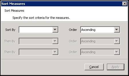

Sort Measures by Property Value
In the Realized Measures tab, measures can be sorted by property value.
Select the Realized Measures tab.
Hold down the control key (Ctrl) and click in the filter field at the top of the table for the property of the measures to be sorted.
The measures are sorted in alphabetical order according to the value of the property.
In the Realized Measure tabs, the configuration administrator can filter measures by property value.
In the Realized Measures tab, click in the filter field at the top of the table for the property of the measures to be filtered.
Enter the value on which ti filter the measures.
This field is case sensitive.
External Measures
Under most circumstances, measures exist only within the solution in which they are defined. When working with a project with multiple solutions, it is sometimes desirable to make use of a measure defined in a different solution. The Measure Manager allows the import of a measure defined in a different solution (but not a different project) into the current solution. These measures (called external measures) then become visible in the External Measures tab of the Measure Manager. Within this tab, it is possible to modify certain measure properties so that the use of the measure in the Solution into which it has been imported will differ from its use in the Solution in which it was originally defined. For example, the configuration administrator may want to modify a writable measure so that it is read-only in the solution into which it is imported.
Figure 4-22 Measure Manager External Measures Tab
Description of "Figure 4-22 Measure Manager External Measures Tab"
Within the Measure Selectors present in the Rule and Workbook tools and the Expression Builder, there is a check box named Include External Measures. When this check box is selected, the Measure Selector will include those measures that were imported into the solution in addition to those that are present due to component selections in the Measure Selector.
The following properties may be overridden for an external measure:
Label
Description
Base State
Agg State
UI Type
Range

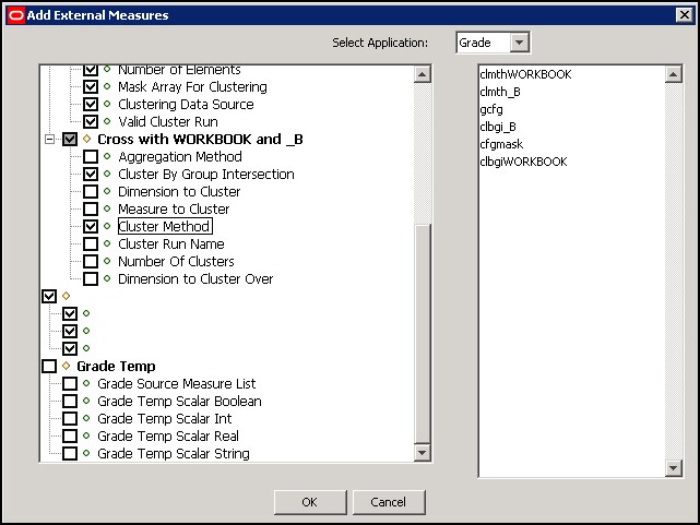

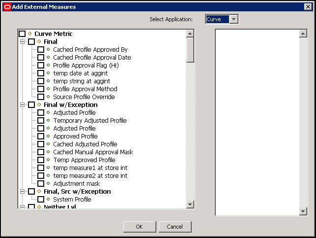

Import a Measure
You may only import a measure into a solution for a project that has at least one other solution.
Select the External Measures tab, and click Import Measure on the toolbar. The Figure 4-23 opens.
In the Add External Measures window, select the solution in which the desired measure is defined.
Use the measure selector (left-hand side) to select the measures to import.
Figure 4-24 Selecting Measures to Be Imported
Description of "Figure 4-24 Selecting Measures to Be Imported"External measures that are already imported display in bold.
From the right-hand list, select the measure to import and click OK. The selected measures display in the External Measure tab.
Remove an Imported Measure from a Solution
Click the External Measures tab, and select the measure to remove.
Click Remove Imported Measure from the Measure Manager toolbar, or right-click and select Remove Import. The selected imported measure is removed from the External Measures tabs.

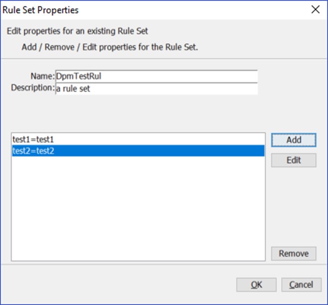

Edit Rule Set Properties
Navigate: In the Configuration Components pane, select Project, then Solution, and then Rules. The Rule Definition window opens in the workspace.
In the Rule Definition window, select the rule set, right click, select Edit Properties, then select Rule Set. The Rule Set Properties Window opens in the workspace.

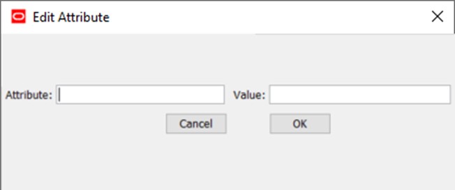

In the Rule Set Properties window, Click Add to open the Edit Attribute window in order to add a new rule set attribute.
Figure 4-28 Rule Set Edit Attribute Window
Description of "Figure 4-28 Rule Set Edit Attribute Window" -
To edit an existing rule set attribute, select the attribute/value pair and then click Edit. The Edit Attribute window opens in the workspace. The window is pre-populated with the selected rule set attribute and value that the users can edit.
To remove an existing rule set attribute, select the attribute/value pair and then click Remove.

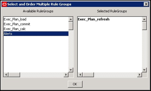

The Configuration Tools and RPASCE support the use of multiple refresh rule groups. Within the rule tool, there is the ability to create multiple refresh rule groups within a rule set. These multiple refresh rule groups can then be assigned to a workbook template using the Workbook Designer, and they will be available for selection within the RPASCE Client.
A workbook contains all of the rule groups in a single rule set, so if multiple refresh rule groups are required in a workbook, they must all be in the same rule set.
You may consider naming rule groups so the usage of the refresh rule groups are reflected in their names, such as
refresh_all,refresh_actuals, andrefresh_manager.

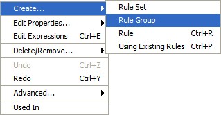

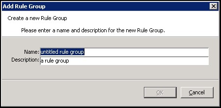

Create a Rule Group
Navigate: In the Configuration Components pane, select Project, then Solution, and then Rules. The Figure 4-29 opens in the workspace.
In the Rule Definition window, select the rule set to be used to create a new rule group.
From the toolbar, click New and select Rule Group, or select Create – Rule Group from the right-click menu.
The Figure 4-31 opens.
Complete the following:
In the Name field, enter the name of the rule group.
A rule group name can be a maximum of 16 alphanumeric or underscore characters. It must not have a name that is the same as any other rule group that exists in the project.
In the Description field, enter a description of the rule group.
Click OK to save any changes and close the window. The new rule group displays in the Rule Definition tree window.

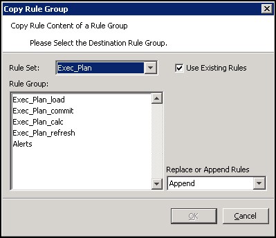

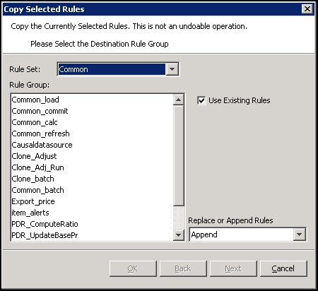

Copy a Rule Group
If two rule groups are similar, it may be beneficial to copy one rule group into the other to prevent having to create a rule group from scratch. When copying the rules of a rule group into another rule group, it is possible to specify whether existing rules will be used or copies of the rules will be created. The Use Existing Rules check box defaults to using any existing rules in the rule pool. If this check box is selected, the copy rule group operation will use the same rules that the source rule group has. If this check box is unchecked, the copy rule group operation will create copies of the rules and use those copies for appending to or replacing rules in the destination rule group.
The rule group to be copied into must already exist. A new rule group cannot be created through this process.
In the Rule Definition window, select the rule group to be copied.
From the toolbar, click Advanced, and select Copy Rule Group. The Copy Rule Group window opens.
Using the Rule Set list, select the destination rule set.
From the Rule Group area, select the desired destination rule group.
Using the Replace or Append Rules list, select either:
Replace – To overwrite all rules that already exist in the destination rule group.
Append – To add to the rules already in the destination rule group.
Click OK. The Confirm Operation window opens.
Click OK. The rules are copied to the selected rule group.

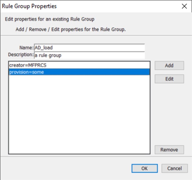

Edit Rule Group Properties
In the Rule Definition window, find the rule set containing the rule group to be modified. Select the rule group, right click, select Edit Properties, then select Rule Group. The Figure 4-33 opens in the workspace.
In the Rule Group Properties window, click Add to open the Edit Attribute window in order to add a new rule group attribute.
Figure 4-34 Rule Group Edit Attribute Window
Description of "Figure 4-34 Rule Group Edit Attribute Window" -
To edit an existing rule group attribute, select the attribute/value pair and then click Edit. The Edit Attribute window opens in the workspace. The window is pre-populated with the selected rule group attribute and value that the user can edit.
To remove an existing rule group attribute, select the attribute/value pair and then click Remove.

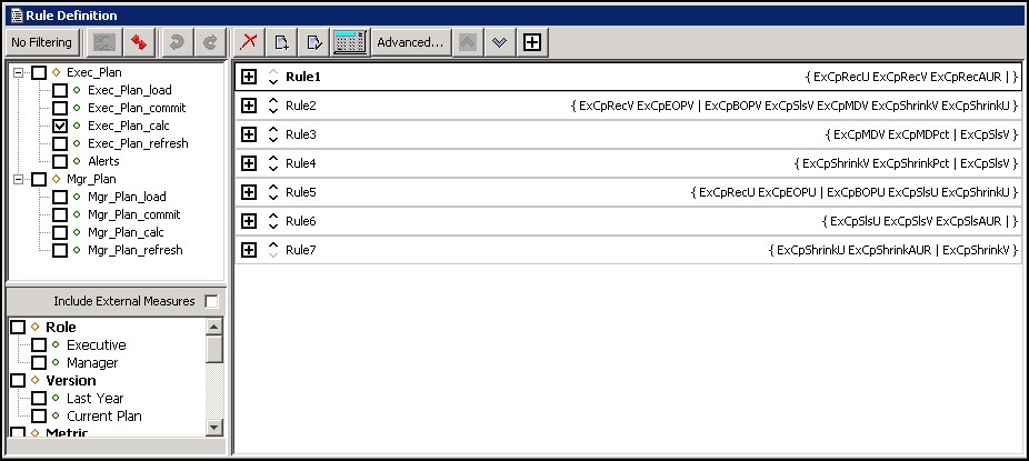

Rule Definition
The Rule Definition tool allows the configuration administrator to define, organize, and manage rule sets, rule groups, and rules. It also allows for the creation of expressions and addition of expressions to rules.
Rules are groups of expressions that describe the relationship between measures.
When a rule has multiple expressions, those expressions are given a priority sequence to help the calculation engine select a calculation path that follows business priorities. When given a choice, the calculation engine will always select the highest priority expression in the rule that is available to be selected. Considerable care should be taken in the design of rules to ensure that appropriate expression priorities are established. The business priority may vary from implementation to implementation, and it may vary from one type of plan to another in the same implementation.
Rules are also given a priority sequence within a rule group to help the calculation engine select a calculation path that follows business priorities. When given a choice, the calculation engine will always select the highest priority rule that needs to be calculated.

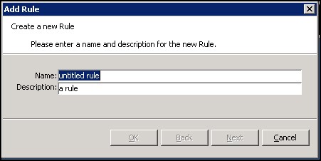

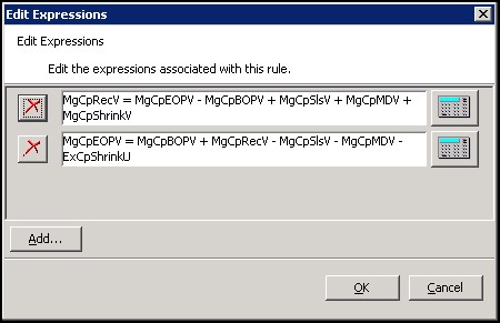

Create a Rule and Add It to a Rule Group
Complete the following steps to create a rule and add it to a Rule Group.
In the Rule Definition window, select the rule group in which you want to create a rule. If you want the rule to be created in a particular position in the sequence of rules in the rule group, select the rule before which you want the new rule to be placed. The new rule will be created higher than the selected rule.
From the toolbar, click New and select Rule.
Click Create..., then Rule from the right-click menu.
Press Ctrl+R.
The Figure 4-36 opens.
In the Name field, enter the name of the rule.
A rule name can be a maximum of 24 alphanumeric or underscore characters. It must not have a name that is the same as any other rule that exists in the project. Rule names may start with a letter or an underscore but may not start with the letter r or R followed by a number.
In the Description field, enter a description of the rule.

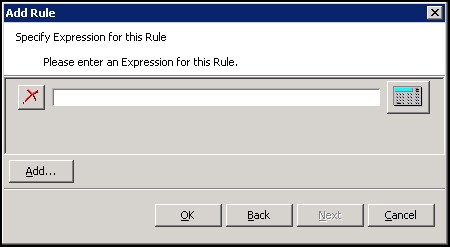

Click Next. The Expression Builder window of the Add Rule window opens.
Figure 4-37 Specify Expression for Add Rule
Description of "Figure 4-37 Specify Expression for Add Rule" -

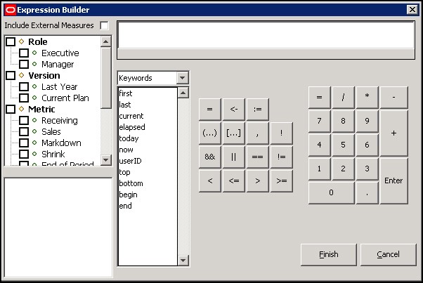

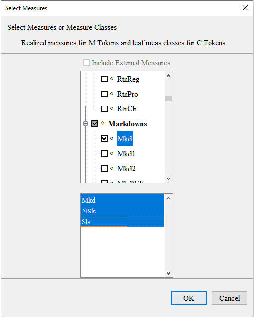

Type the expression in the input box or complete the following to use the Expression Builder.
Click Expression Builder (located to the right of the text box). The Expression Builder window opens.
In the upper left-hand pane, select the measure components to filter measures to be visible for pasting into the expression. If External Measures are required in the expression, check the Include External Measures check box. Realized measures meeting the filtering conditions are displayed in the lower left-hand pane.

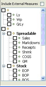

Figure 4-39 Include External Measures Check Box
Description of "Figure 4-39 Include External Measures Check Box" -
In the lower left-hand pane, double-click any measures to be used in the expression to get the measure name pasted at the insertion point in the expression.

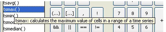

Place the mouse over the name of a function, procedure, keyword, or modifier to see a tooltip that explains its function.
From the drop-down list, select a category of functions, procedures, keywords, or modifiers. Double-click on a specific function, procedure, keyword, or modifier to be used in the expression, and (if appropriate) outline syntax pasted at the insertion point in the expression.
The outline syntax of a function, procedure, keyword, or modifier is pasted with components of the syntax separated with braces {}. When the insertion point is in a component of the outline syntax in the expression, you will see a description of the component at the bottom of the expression window. When the insertion point is in a component of the outline syntax, anything that is entered or pasted replaces the whole component.

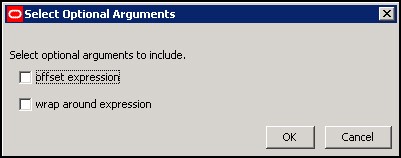

If the function, procedure, keyword, or modifier that is pasted has optional arguments (for example, the cover function has optional arguments for an offset expression and a wrap-around expression), you will be presented with the following window to select which of the optional arguments to use in the expression. Note that all arguments are positional, so if a later argument is selected, all earlier arguments will be automatically selected. If an earlier argument is cleared, then all later arguments are automatically cleared.
Figure 4-44 Select Optional Arguments Window
Description of "Figure 4-44 Select Optional Arguments Window"If the function, procedure, keyword, or modifier that is pasted has repeating arguments (for example the min function finds the minimum of a variable number of expressions), a window opens to select how many of the repeating arguments to use in the expression.
Use the keyboard or buttons to add the appropriate mathematical operators and constants to construct the expression.
When you have defined the expression as needed, click Finish and close the window.
If an invalid expression is created, a warning message is displayed.
To add further expressions to the rule, click Add, and repeat the process of entering an expression.

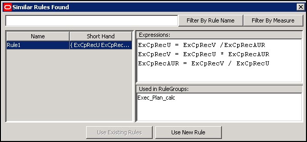

If the newly defined rule's expressions use exactly the same measures as another rule that already exists in the Rule Pool, the Figure 4-45 opens. The window shows all rules that use exactly the same measures as the newly defined rule. This provides you with an opportunity to use an existing rule from the Rule Pool or to continue with the new rule. The Similar Rules Found window allows you to view rules, associated expressions, and rule groups that contain the rules. The rule table may be filtered based on the rule name or by measure. Click Use Existing Rule or Use New Rule to save changes and close the window.
The new rule is placed preceding the rule that was selected at the start of the process in the sequence of rules in the rule group or at the end of the rule group if no rule was selected.
If Use Existing Rule or Use New Rule is not selected and the window is closed manually, a new rule is created.

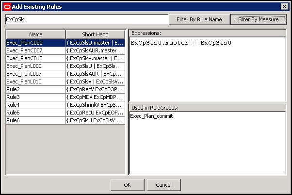

Add an Existing Rule to a Rule Group
Using the Add Existing Rules window, you may select multiple rules to add to a rule group. If at least one of the selected rules is already in the rule group, the OK button will gray out disallowing the operation until that rule is cleared. When multiple rules are selected, the expression and rule group displays will go blank. However, if there is only one selected rule, the rule's expressions and the list of rule groups that use the rule will be displayed.
In the Rule Definition window, select the rule group to be used to add an existing rule. If the rule is to be placed in a particular position in the sequence of rules in the rule group, select the rule in which the new rule is to precede.
From the toolbar, click New and select Using Existing Rule.
Select Create – Using Existing Rule from the right-click menu.
Press Ctrl+P.
The Figure 4-46 opens.
Filter by Rule Name or by Measure and view the associated expressions to find the correct rule. Filtering means that all data are compared, but only matching data is allowed to pass through. In order to filter by Rule Name or by Measure, type a filter string (for instance, ExCpSls in the input box directly under the Title Bar. Click Filter by Measure, and only those measures with ExCpSls display.
Click the rule in the table to select it.
Click OK to save changes and close the window.
The rule is placed higher than the rule that was selected at the start of the process in the sequence of rules in the rule group or at the end of the rule group if no rule was selected.

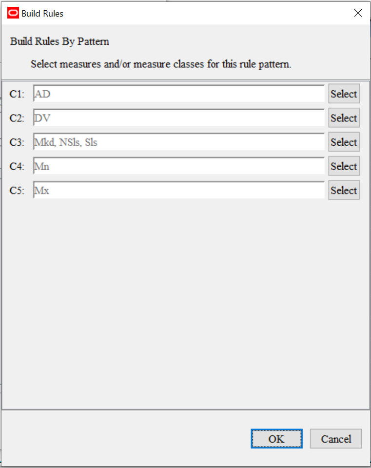

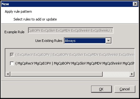

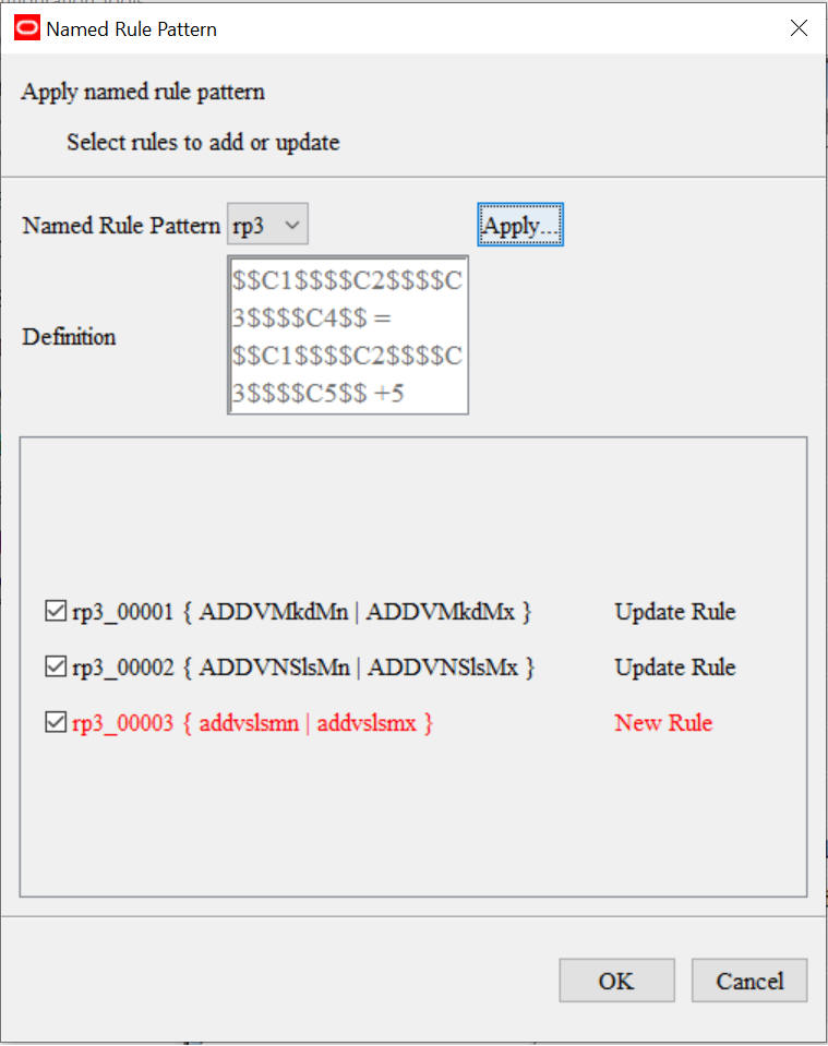

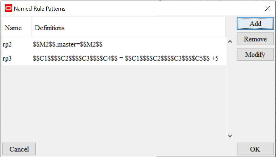

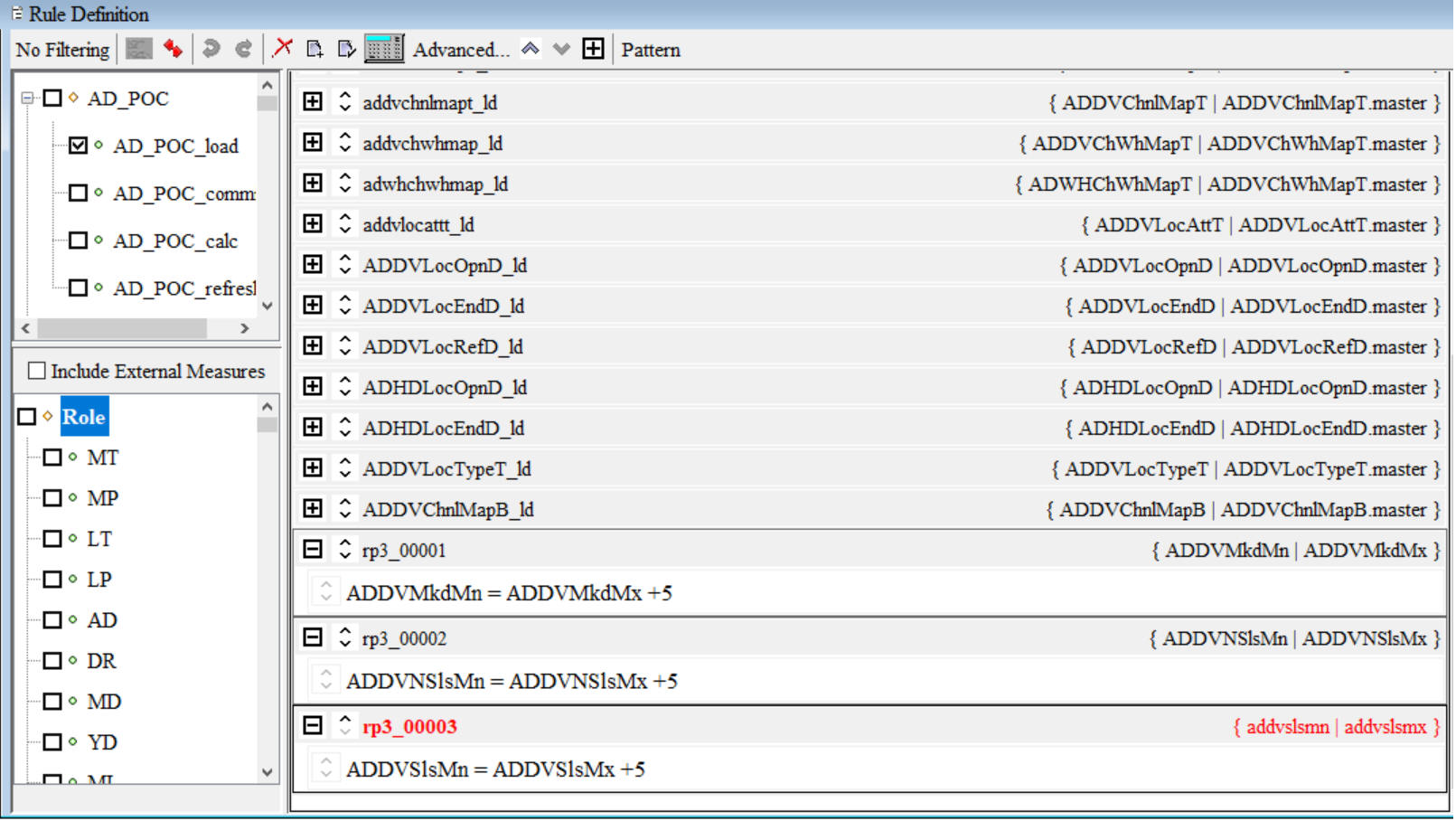

Apply a Rule Pattern to Create New Rules or to Update Existing Rules
The Apply Rule Pattern functionality allows you to create new rules or update existing rules according to a pattern established by a selected base or template rule. The rule tool recognizes inherent similarities or patterns in measure components used in some rules when compared to the base or template rule. Based on these similarities, the rule tool allows for the creation of new rules or update of existing rules to fit the pattern set by the base or template rule.
When the Apply Pattern capability is enabled, there is a possibility that some of the New or Updated rules will have the same expressions as a rule that already exists in the rule pool. If this happens, the Similar Rules Found window opens and provides the option of using the existing rule or actually creating a new one.
In the Rule Definition window, select any rule group that contains the rule to use as the pattern basis.
Select the rule whose pattern is to be used as a basis for creating or updating rules.
From the toolbar, click Advanced and then select Apply Pattern, or right-click and select Advanced and then, Apply Pattern.
A Figure 4-48 opens containing a set of rules that are presented for selection. This set is composed of rules whose measures follow the selected rule's pattern in terms of the individual measure components used. The set of rules are composed of potential new rules or potential updated rules.
Example:
Consider a configuration with three components in the measure naming scheme:
a version (such as Wp)
a metric (such as Shrink)
a unit of measure (such as V)
If the selected base rule is:
{ WpShrinkU WpShrinkAUR | WpShrinkV }
...then the rules:
Rule1: { WpSlsU WpSlsV WpSlsAUR | }
...and
Rule2: { WpRecU WpRecV WpRecC | }
...would fit the pattern and be included in the list.
Rule1 fits the pattern because its measures use the same measure components with the exception of the metric component. For the Metric component, the base rule uses Shrink, and Rule1 uses Sls consistently. In this case, the tool will present the rule:
{ WpSlsU WpSlsAUR | WpSlsV }
...as a possible update for Rule1.
The update results in the conversion of Rule1 to a rule that uses the same measures as the original Rule1, but it has the expression pattern of the base rule.
Rule2 fits the pattern because it uses the same Version as the base rule. For the Metric component, the base rule uses Shrink, and Rule2 uses Rec consistently. Unlike Rule1, Rule2 uses C as the Unit of Measure in one of its measures. This is not an exact fit like Rule1. In this case, the tool will present the rule { WpRecU WpRecAUR | WpRecV } as a possible new rule. Notice that this rule is forced to be an exact fit as Rule1 was.
Select the rule replacement policy in the Use Existing Rules drop-down menu. This allows the user to select, on a rule-by-rule basis, which rules to reuse and which to re-create. By default, this is set to Always.
When Always is selected, rules that already exist elsewhere in the configuration will always be used in place of the newly generated rules.
When Never is selected, new rules will always be created, even if an identical rule already exists elsewhere in the configuration.
When Prompt is selected, the Rule Locator window will be presented for each rule whose expressions already exist elsewhere in the configuration.
From the list of possible new and updated rules, select those to be updated or added to the rule group. In either case, if rule reuse is specified in Step 4, a new rule will not be created, but the rule existing elsewhere in the configuration will be used in its place.
Click OK.
A selected rule that is labeled New Rule will be added to the end of the rule group. The new rule's name will default to the template rule's name suffixed with a number to keep the name unique. A selected rule that is labeled Update Rule is already in the rule group and will be replaced. This means that the old rule will be removed and replaced with a new rule whose expressions follow the base rule's expression pattern. In both cases, the rule will follow the pattern of the base rule's expression.

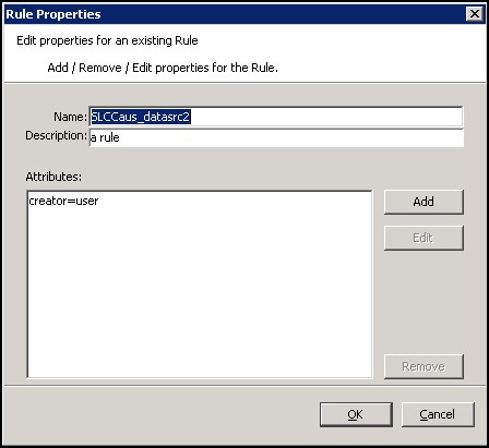

Edit Properties of a Rule
Complete the following steps to edit the properties of a rule.
In the Rule Definition window, select any rule group that contains the rule to edit.
From the rule group, select the rule to edit.
From the toolbar, click Edit and then Select Rule, or select Edit Properties..., then Rule from the right-click menu. The Figure 4-50 opens.
To edit the name of the rule, enter a new name in the Name field.
To edit the description of the rule, enter a new description in the Description field.
To edit attributes for a rule:
Select the attribute to edit.
Click Edit. The Figure 4-51 opens.
Update the information as necessary.
To remove attributes from a rule:
Select the attribute to delete.
Click Remove. The attribute is removed from the display box.

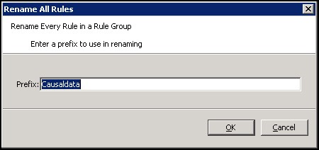

Rename All Rules in a Rule Group
Complete the following steps to rename all rules in a Rule Group.
In the Rule Definition window, select the rule group that contains the rules to rename.
From the toolbar, click Advanced and select Rename All Rules, or select Advanced – Rename All Rules from the right-click menu. The Figure 4-52 window opens.
In the Prefix field, enter a prefix up to ten characters in length, which is the start of all rule names.
Click OK. The Figure 4-53 window opens.
Click Yes.
All of the rules in the rule group are renamed with the prefix followed by a 4-digit numeric identifier generated by the rule tool. The rule tool will maintain the order that the rules were in before they were renamed, and it uses that order in generating the numeric identifier.
Since rules may appear in more than one rule group, use of this feature may generate rule names that look out of place in other rule groups, especially if the prefix implies the rule group.

Copy Selected Rules to Another Rule Group
Complete the following steps to copy selected rules to another Rule Group.
When copying selected rules of a rule group into another rule group, it is possible to specify whether existing rules will be used or copies of the rules will be created. The Use Existing Rules check box defaults to using any existing rules in the rule pool. If this check box is selected, the copy selected rules operation will use the same rules that the source rule group has. If this check box is not selected, the copy selected rules operation will create copies of the rules and use those copies for appending to or replacing rules in the destination rule group.
When the user uses the Find/Replace feature, it is possible that a changed rule will have the same expressions as a rule that already exists in the rule pool. If the Use Existing Rules check box is selected, the Similar Rules Found window opens. You have the option of using the existing rule or creating a new one.
Select the Rule Group that contains the rules to copy, and select the individual rules to be copied.
To select multiple rules, press the Ctrl key and click the rules to select, or click one rule and hold Shift key as selecting another rule, which selects all rules between the two that have been selected. A selected rule is indicated by a bold rule name.
Complete one of the following methods:
From the toolbar, click Advanced, and select Copy Selected Rules.
Select Advanced – Copy Selected Rules from the right-click menu.
Press Ctrl+C.
The first Figure 4-56 opens.
Figure 4-56 Copy Selected Rules Window (1)
Description of "Figure 4-56 Copy Selected Rules Window (1)" -
In the Rule Set field, select the copy's destination rule set.
In the Rule Group area, select the desired copy's destination Rule Group.
Check the Use Existing Rules check box if the rules should be added to the destination Rule Group. If the User Existing Rules check box is clear, copies of the selected rules are created for the destination Rule Group instead.
If the Find or Replace functionality is used, copies are created for affected rules even if the Use Existing Rules check box is checked.
In the Replace or Append Rules field, select:
Replace – To remove all rules that already exist in the destination rule group before the copy.
Click Next. The second Figure 4-57 opens. This window allows you to select or clear rules from those originally selected to copy when the check box beside the rule name is selected.
Figure 4-57 Copy Selected Rules Window (2)
Description of "Figure 4-57 Copy Selected Rules Window (2)"
Find and Replace Measures in the Copied Rules
The ability to find or replace in the copy rules is a very powerful and useful feature. This feature can be used to build a collection of rules and clone them to a very similar collection of rules. For example, a collection of rules that calculate a series of variances with one version can be cloned to produce rules that calculate a series of variances with another version.
Click Find/Replace. The Figure 4-58 opens.
In the Find field, enter the portion of the measure to replace.
The Find function is case sensitive.
In the Replace With field, enter the string to replace the portion of the measure name.
Complete one of the following:
Select Forwards to search the rules in order
Select Backwards to search the rules in reverse order.
Searching Forwards proceeds from left to right starting with the first measure of the first expression of the first selected Rule and will go through all expressions in all selected Rules. Similarly, searching Backwards flows in the reverse direction starting with the right most measure of the last expression in the last Rule selected.
Click Find Next. The first candidate measure to be replaced displays in the bottom left field.
Complete the following as needed:
Click Replace/Find Next to replace the current candidate measure and display the next candidate measure.
Click Replace All to replace all instances in all the selected Rules of the current candidate measure. For example, if a search for Wp finds WpRecV, click Replace All to complete a replace on all instances of WpRecV in all the selected Rules.
Click Find Next to skip over that occurrence of the portion of the measure name and go onto the next one.
The Figure 4-59 opens.
Replace the rules.
Using the Figure 4-59, you can replace a portion of the rules (for instance a prefix) either for all instances of the rules or only for the new instances (where the old instances are not affected).
Example:
Suppose you create a series of rules for the Executive (Ex) Calc Rule Group and you want to use these as a model for the Manager (Mg) Calc Rule Group. Each of these original rules contains expressions with the Ex prefix. Each such instance needs to be replaced with Mg.
Click Use Existing Rules to replace every instance of Ex.
Click Use New Rule to replace the new instances of Ex without affecting the previous rules that contain Ex.
Click X to close the Figure 4-58.
Click OK.
Click Yes to confirm.
The copies of the rules are placed in the target rule group. These copies have names that start with as many characters as possible from the name of the original rule and end with an underscore and number.

Edit an Expression in a Rule
Complete the following steps to edit an expression in a Rule.
In the Figure 4-29, select the rule whose expression is to be edited.
From the toolbar, click Expression Builder.
Select Edit Expressions from the right-click menu.
Press Ctrl+E.
The Figure 4-61 opens.
Choose one of the following methods to edit an expression:
Edit the expression in its text box.
Click Expression Builder for the expression to edit. The Figure 4-62 opens. Use the Expression Builder to make necessary changes and click Finish when complete.
Click OK to save the changes and close the window.

Add an Expression to a Rule
Complete the following steps to add an expression to a Rule.
In the Rule Definition window, select the rule that will have an expression added.
Press Ctrl+E.
Click Add to add a new expression in the Edit Expressions window.
Enter the expression in its text box.
Use the Expression Builder to define the rule and click Finish when complete.
Click OK to add the expression.
Named Rule Pattern
The named rule pattern functionality allows user to simplify rule generation by defining rule patterns explicitly and then generate large quantity of similar rules from them. Two steps are required: First, define rule patterns using tokens and expressions, and give a unique name for each pattern; second, provide token values and generate rules from the selected pattern.
The named rule patterns are saved into a separate rulepattern.xml file. When user opens the application configuration in ConfigTools, the saved rule patterns are loaded and can be used to generate new rules.
When applying the pattern, users need select which pattern, which realized measures or measure components to replace tokens in the pattern definition.
Note: Although example below show sophisticated rule generation, currently RPASCE limits support to only Load and Commit rules, while other types might be supported in future releases.
