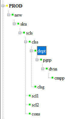

The patching process supports adding new dimensions or removing existing dimensions. The new dimensions can be added anywhere in the hierarchy. Changes to the existing roll-up relationship of existing dimensions are not supported by the patching process.

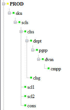

The following example shows PROD hierarchy in original configuration, and some changes made to it.
Figure 6-1 shows the original configuration.

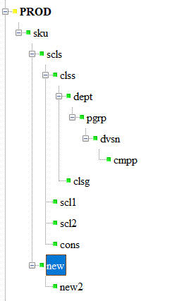

Figure 6-2 shows an example of adding new dimensions (new, new2) to construct a new branch off the existing hierarchy.
Figure 6-3 and Figure 6-4 show more examples of adding new dimensions in two cases.
Figure 6-3 Adding New Dimensions - Example 1
Description of "Figure 6-3 Adding New Dimensions - Example 1"
Figure 6-4 Adding New Dimensions - Example 2
Description of "Figure 6-4 Adding New Dimensions - Example 2"
For the steps to patch your existing application, see your application's Administration Guide.
In general, the configuration tools do not allow this use case; however, it is possible that this use case can occur when using plug-ins. If the RPASCE name of the new level being added collides with RPASCE name of any existing level in any hierarchy, then the patching of the application will fail. Users must use unique dimension names when modifying the configuration.
