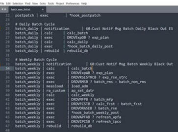

The Batch Notification Window defines a period before a batch run, during which non-administration users are restricted in the same way as they are in the Notification window of the ad hoc blackout window. Administration users are similarly restricted. The user can configure a batch hard notification window by modifying the batch control file. For example, the following figure shows a section of a batch control file.
Figure 19-15 Notification Window Batch Control File
This image shows the notification window batch control file.
The first line of the batch_daily task is modified. It has a task type of notification, which indicates that a batch notification window will appear at the beginning of the batch. The argument to it, in the third column, is as follows:
60:Cust Notif Msg Batch Daily Black Out ES.
The value of 60 is the number of minutes for the window. The rest of the text after the ":" separator provides a customized notification message to display to the user. The notification window starts when the batch starts. If an administrator wants the daily batch task to begin at 9:00, with a 60-minute notification window at the beginning, the batch daily task must instead be scheduled to start at 8:00 so that the notification window can start at 9:00.
