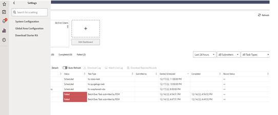

System Configuration
System Configuration provides administrators with the capability to update client-side system properties from the application. The administrator can now update various properties relating to administration status tasks, alert, chart, dashboard, export, image, logging, and separators, and format properties from the application. This feature lets you manage and support your team's operational needs.
The administration user can access System Configuration from the Ask Oracle icon available at the right bottom of the main page.

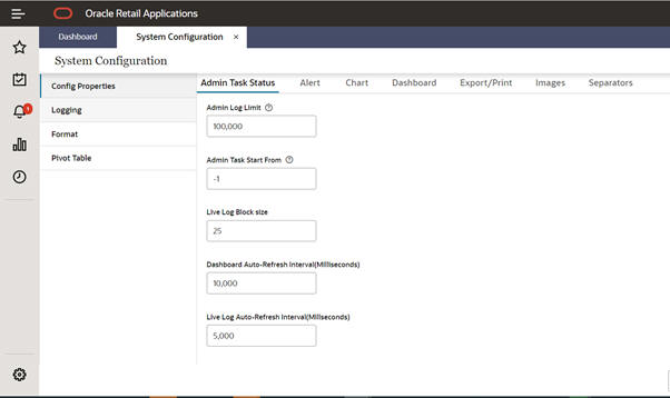

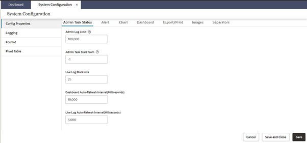

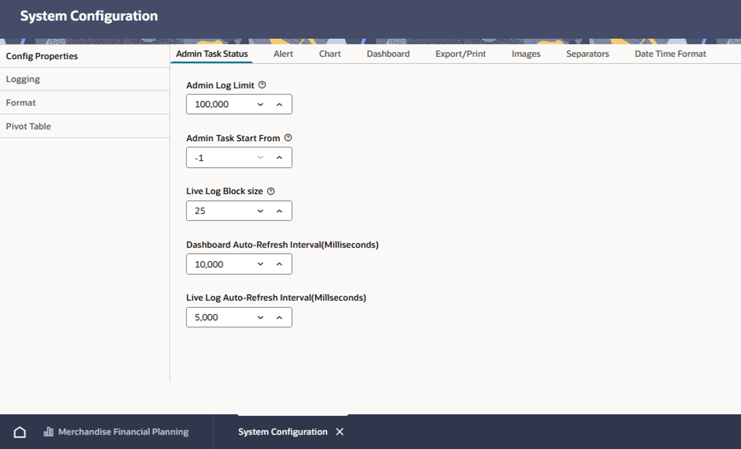

Admin Task Status
Use this tab, shown in Figure 14-2, to update the properties related to administration task status. The following properties can be updated:
  • Admin log Limit - Specify the number of lines in the administration logs. The range of permitted values is between 5,000 and 200,000.
  • Admin Task start from - Define the logging start from start (0) or end (-1) of the file.
  • Live Log Block Size - Enter the block size of the live log. The range of permitted values is between 20 and 30.
  • Use short name for entities - Toggle button to indicate whether you require short names for the entities in the status.
  • Dashboard Auto-Refresh interval - Update the auto-refresh interval time for the administration dashboard in milliseconds. The range of permitted values is between 1,000 and 86,400,000.
  • Live Log Auto-Refresh interval - Update the auto-refresh interval time for the live log. This is in milliseconds. The range of permitted values is between 1,000 and 86,400,000.

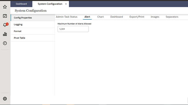

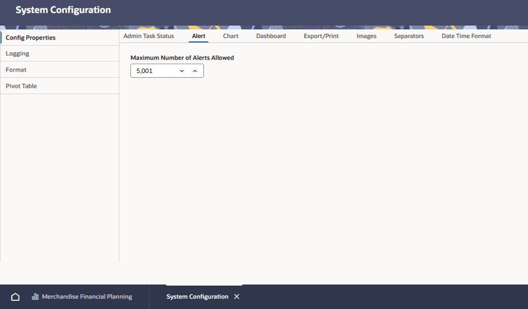

Alert
Use this tab, shown in Figure 14-3, to update the alert properties. You can update the maximum number of alerts allowed. The range of permitted values is between 1,000 and 10,000 alerts.
By default, the alerts displayed in the Select drop-down list are sorted by the ascending order of priority assigned to each alert during alert configuration. To change the default behavior, enable the Disable Priority Sorting on the Alerts property in Systems Configuration. You access this property in the Additional Setting Tab under Oracle Support Administration. The default setting for Disable Priority Sorting on Alerts is false. When default sorting is disabled, the alerts will be sorted as defined in the setting value of Disable Default Sorting.

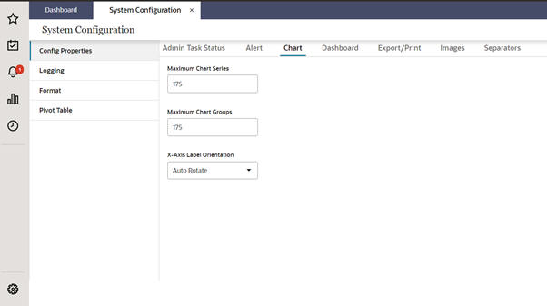

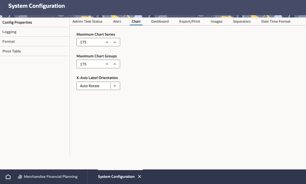

Chart
Use this tab, shown in Figure 14-5, to update the chart properties. The following properties can be updated:
  • Maximum chart series - The maximum number of series allowed in charts. The range of permitted values is between 100 and 200.
  • Maximum chart group - The maximum number of groups allowed to plot in charts. The range of permitted values is between 100 and 200.
  • X-axis Label Orientation - Select x-axis label orientation. The auto-rotate option is used to select the orientation of the x-axis labels, depending on the number of items in charts. The horizontal orientation option is used to display the x-axis label horizontally.

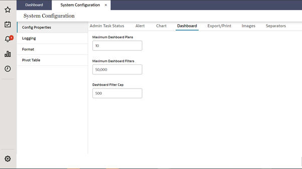

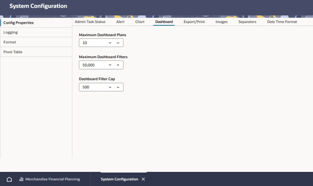

Dashboard
Use this tab, shown in Figure 14-6, to update the properties related to dashboards.
  • Maximum Dashboard Plans - The maximum number of plans for a dashboard. The range of permitted values is between 0 and 50.
  • Maximum Dashboard Filter - The maximum number of filters permitted in a dashboard. The range of permitted values is between 0 and 100,000.
  • Dashboard Filter Cap - The filter cap for a dashboard. The range of permitted values is between 0 and 1,000.

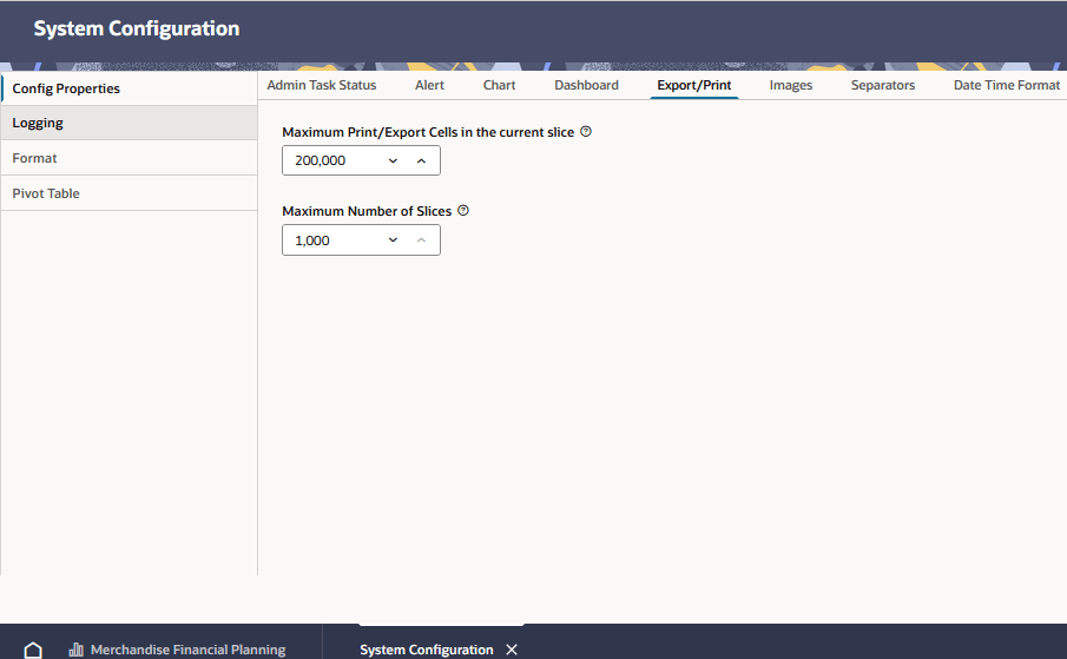

Export/Print
Use this tab, shown in Figure 14-7, to update the properties related to export and print functionality. The following properties can be updated:
  • Maximum print/Export cells - The number of cells that can be exported from the system. The range of permitted values is between 0 and 5,000,000.
    Note that this limit applies to both Excel and txt export of the current slice. This limit does not apply to the txt export of all slices.
    Note that in the Export/Print tab, you can set the property for the maximum print/export cells. If this property is set to 0, all the cells are exported. However, an out-of-memory error may occur on the server, depending on the size of the data being exported. Use this setting with caution. Users can use the export All slice feature for exporting a large amount of data.
    Even if the property is set to 0 to export all the cells, the export will comply with the Excel limit. Excel supports only 1048576 rows and 16384 columns. If the data you are exporting exceeds this limit, you will see one of the following failure messages:
    • There are too many rows in the view. The file cannot be exported with more than 1,048,576 rows and 16384 columns. Please reduce the amount of rows and try again.
    • There are too many columns in the view. The file cannot be exported with more than 1,048,576 rows and 16384 columns. Please reduce the amount of columns and try again.

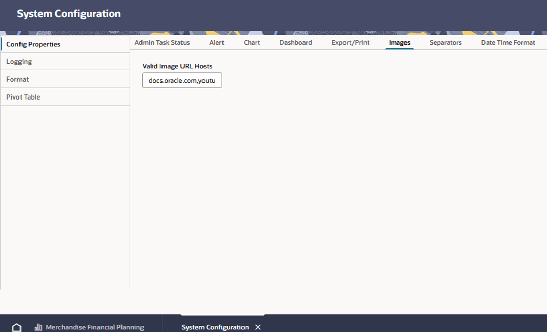

Images

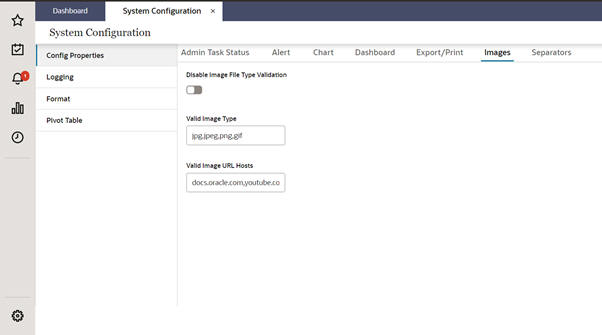

Use this tab, shown in Figure 14-8, to update the following image-related properties.
  • Disable Image file type Validation - Toggle button to indicate whether or not you require file type validation for the images in your system.
  • Valid image type - The image file types that are valid for your application.
  • Valid Image URL hosts - The valid URL hosts for your application.

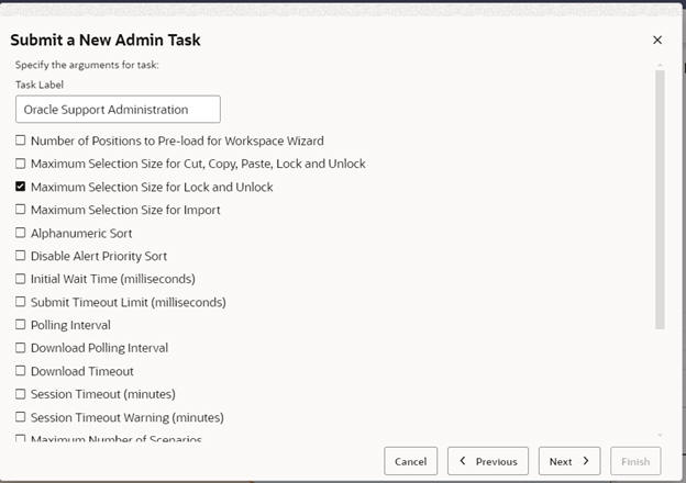

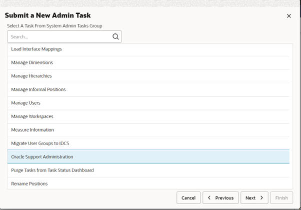

Maximum Selection Size for Lock and Unlock
From Submit Admin Task, select Oracle Support Administration and click Next. Then, select Maximum Selection Size for Lock and Unlock and click Next and then Submit.
Figure 14-10 Maximum Selection Size for Lock and Unlock
This image shows the maximum selection size option.
Once the task is complete, you can update the setting in the System Configuration screen.
Figure 14-11 Maximum Selection Size Setting
This image shows the maximum selection size setting.
The setting for Maximum Selection Size for Lock and Unlock displays under Additional Settings tab. Change the default setting of 8500 and save the system configuration. The setting will take effect after the user logs in again.

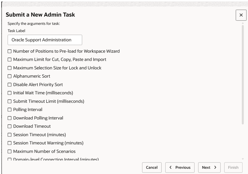

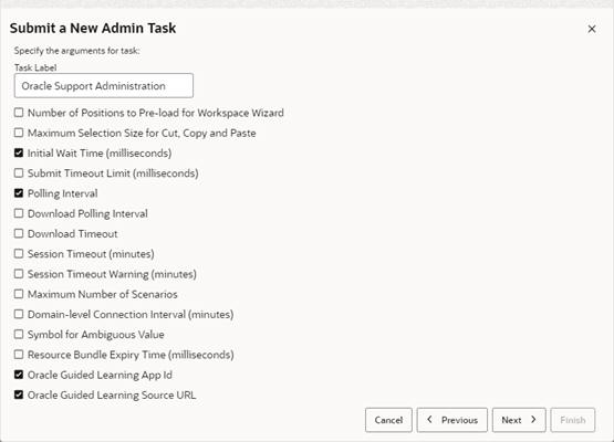

Maximum Selection Size for Cut, Copy, Paste and Import
From Submit Admin Task, select Oracle Support Administration and click Next. Then, select Maximum Selection Size for Cut, Copy, Paste and Import and click Next and then Submit.
Figure 14-13 Submit a New Admin Task
This image shows the Submit a New Admin Task.
This sets the maximum selection size for the Cut, Copy, Paste and Import operations. The range of permitted values is between 5,000 and 100,000. The default value is 10000. The setting for Cut, Copy, Paste, and Import displays under the Additional Settings tab. Change the default setting of 10000 and save the system configuration. The setting will take effect after the user logs in again.
Figure 14-14 Maximum Selection Size
This image shows the Maximum Selection Size.

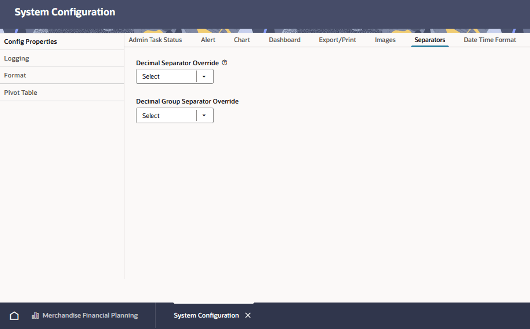

Separators
Use this tab, shown in Figure 14-15, to set the separators.
  • Decimal separator override
  • Decimal group separator override
Note the following:
  • Either both or neither of the separators must be defined.
  • The value of both the separators must be unique.
  • If a decimal group separator override must be a space, then you must enter the word "space" instead of the character space.

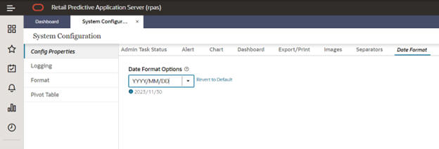

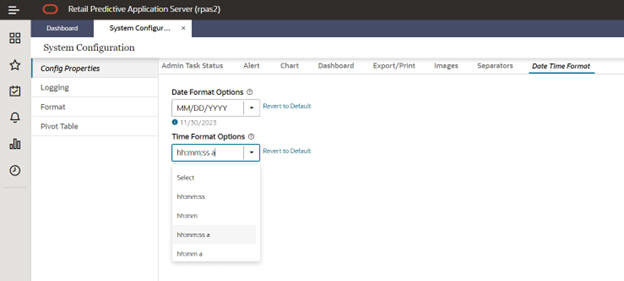

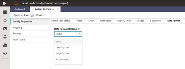

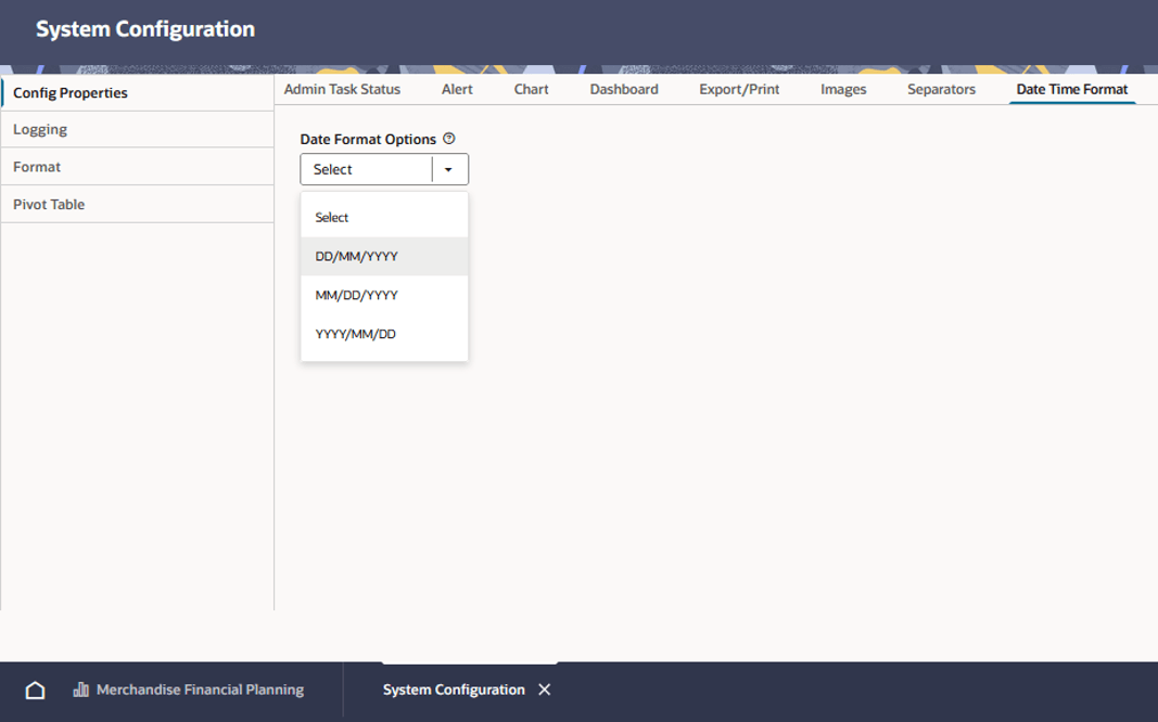

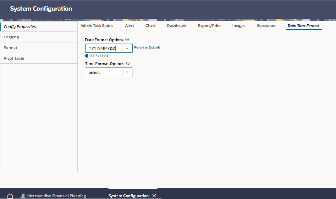

Date Time Format
This tab provides a Date Format option and a Time Format option.
Use the Date Format option to specify a global date format that overrides the format specified in the application. The format selected is applied to the application for all users. Three formats are available:
  • DD/MM/YYYY
  • MM/DD/YYYY
  • YYYY/MM/DD
Figure 14-16 Date Format OptionThis image shows the date format tab.
When the user applies the date format, the change is applied to the Pivot Table, the Recent Plan, the Last Commit (bottom bar), and the Admin Dashboard.
When you select an option, the sample date format to be applied is displayed.
Figure 14-17 Sample Date OptionThis image shows a sample date option.

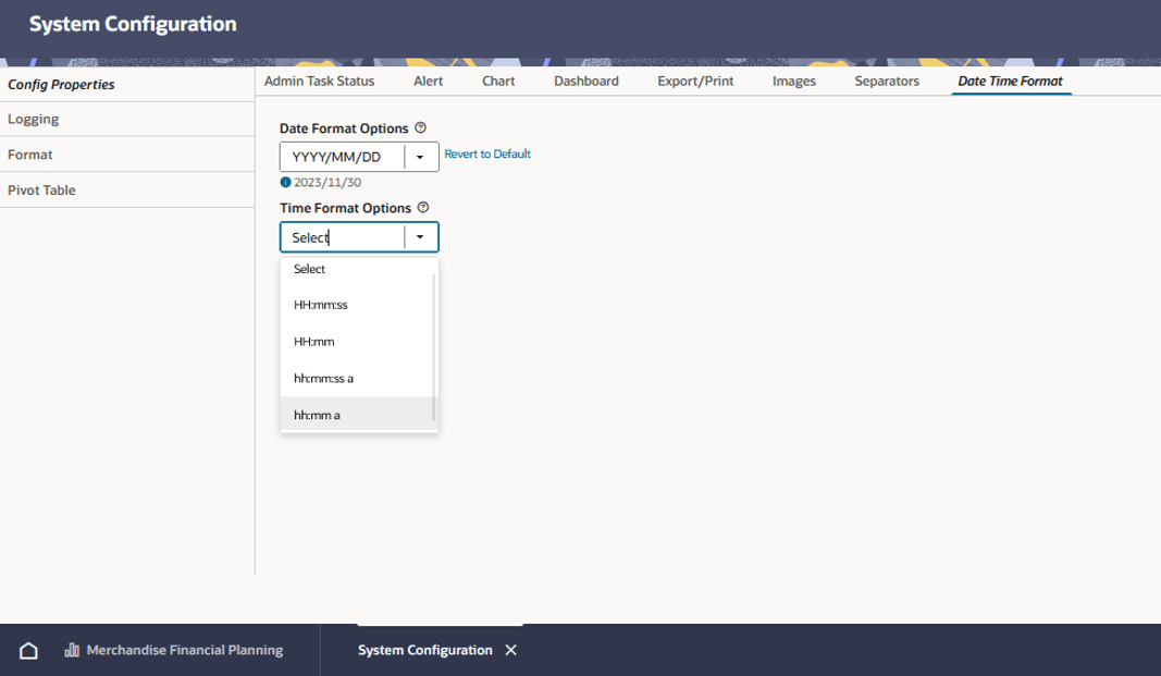

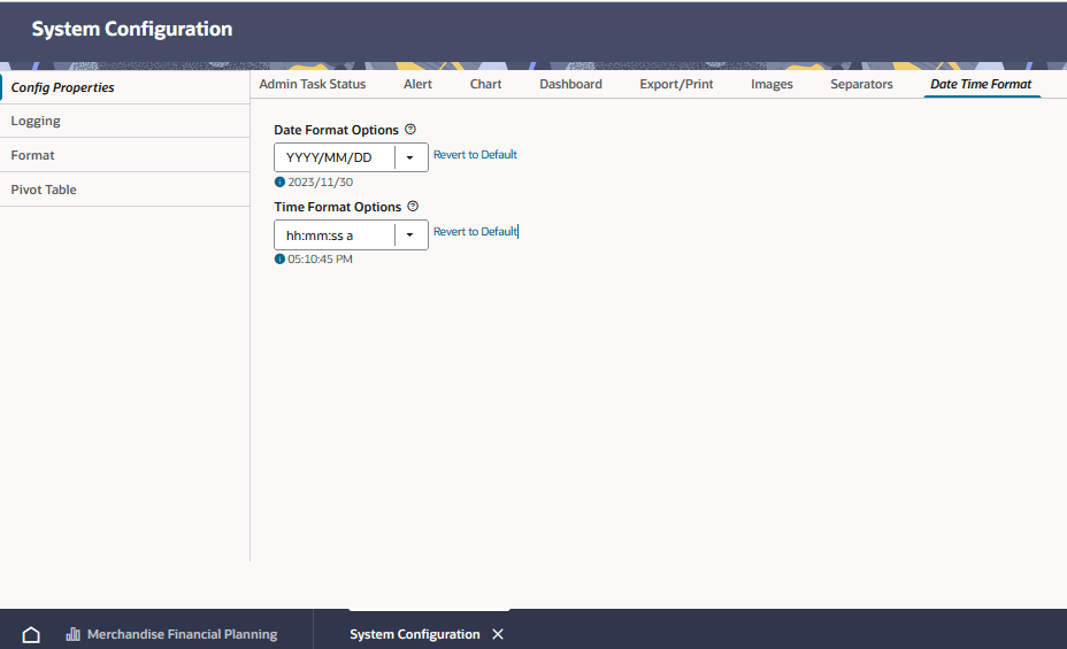

The Time Format option provides a global format settings for time that is independent of language of application. The user can change the time format as required and the selected format will be applied to the application for all users.
A user can select one of the four time formats from the drop-down list to override the time format in the application:
  • hh:mm:ss
  • hh:mm
  • hh:mm:ss a
  • hh:mm a
Figure 14-18 Time Format Option
This image shows the time format option.
The format the user selects are applied to:
  • Pivot Table
  • Last Commit (bottom bar)
  • Admin Dashboard

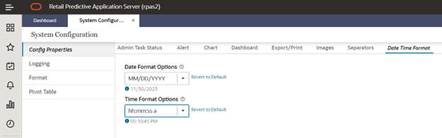

Selecting an option also displays the sample time format that will be applied.
Figure 14-19 Sample Time Format
This image shows the sample time format.

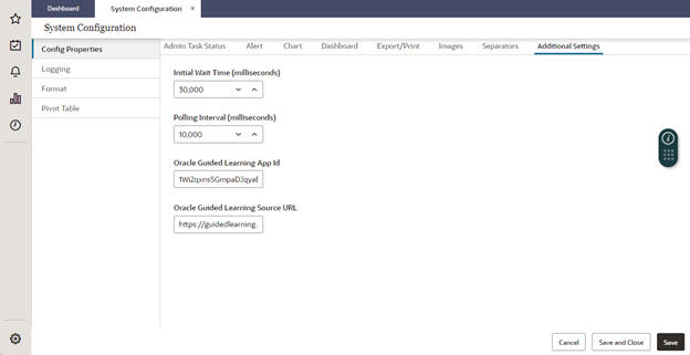

Additional Settings
This tab, shown in Figure 14-22, is hidden by default and can be accessed via Online Admin Tools.
  1. Launch Online Admin Tools and select the System Admin Tasks. Click Next.
  2. Select Oracle Support Administration, as shown in Figure 14-20.
    Figure 14-20 Oracle Support Administration
    Description of Figure 14-20 follows
    Description of "Figure 14-20 Oracle Support Administration"
  3. Select the appropriate settings, as shown in Figure 14-21, and submit the task.
    Figure 14-21 Oracle Support Administration Settings
    Description of Figure 14-21 follows
    Description of "Figure 14-21 Oracle Support Administration Settings"
  4. Once the task is complete, the Additional Settings tab, shown in Figure 14-22, becomes visible and the settings/configuration properties selected in the task are available.
    Figure 14-22 Additional Settings Tab
    Description of Figure 14-22 follows
    Description of "Figure 14-22 Additional Settings Tab"
Oracle Guided Learning
Customers can realize their cloud application's value more quickly with Oracle's Digital Adoption Platform, Oracle Guided Learning (OGL). OGL accelerates user adoption with guided and contextual learning and also helps to manage continuous business change. In an OGL-enabled environment, users will see guided content from Oracle.
Customers can further customize the content as per their business need. There are two new properties under Additional Settings to configure for OGL, shown in Figure 14-21:
  • Oracle Guided Learning App ID- the unique identifier for your OGL account
  • Oracle Guided Learning Source URL - source from which to pull the guides and content

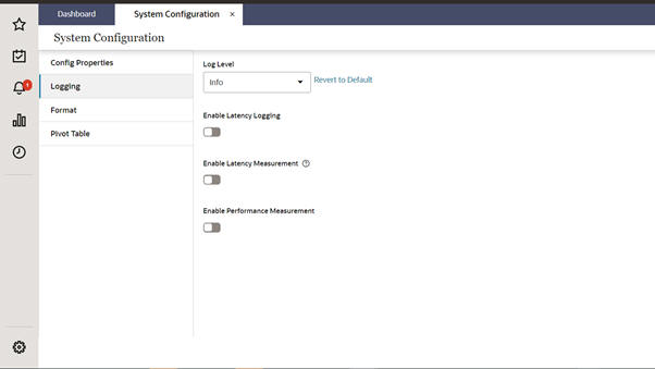

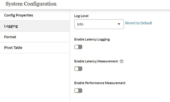

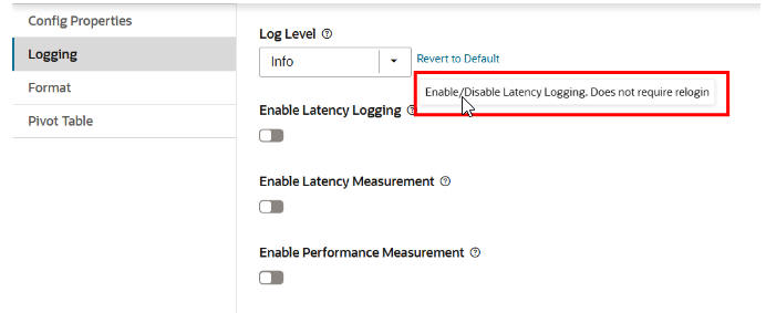

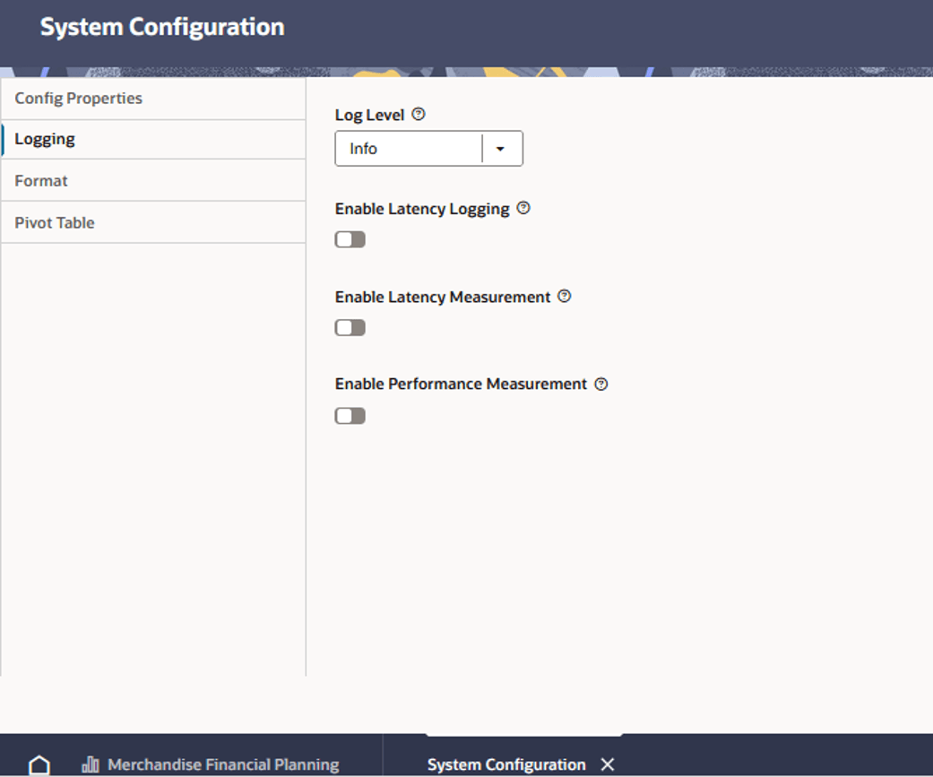

Logging
Use this tab, shown in Figure 14-23, to set the log level and enable/disable latency-logging, latency-measurements, and performance-measurements. You must save and log in again in order for the changes to take effect.
Log Level
Use the log level drop-down list to select appropriate log levels. The RPASCE Client application supports the following log levels.
Table 14-1 Log Levels
Log Level Name Log Level Definition
Off
Used to turn off all logs.
Fatal
Used to log severe errors that require immediate attention. These situations either impact the normal operation of the entire application or a component within the application.
Error
Used to log errors. Critical errors and information are logged at this level.
Warn
Used to log messages regarding potentially harmful situations. These situations do not affect the running of the RPASCE Client application, but may not give the desired result. For this reason, it is preferable to warn the user about such situations.
Audit
Used to log messages that indicate a change, including workbook builds, save, commit, and so on. Most of these may already be reflected in the UI or are available on Admin Task Status.
Info
Used to log general information about user actions and main events (for example, if the login was successful or not). This is the default log level.
Profile
Used to log performance characteristics of user actions.
Debug
Used for debug logging. At this level, more logging occurs than at the other levels. Debug information that can help in application debugging is provided at this level. This must only be used for debugging purposes, as the number of logs generated may cause performance issues. When a customer wishes to report a defect, customer support can advise the customer to turn on logging at this level, run the problem scenario, capture the logs, and attach them to the trouble report.
Verbose
Used for very detailed logging. At this level, more logging occurs than at the debug level. Fine-grained information that can help in application debugging is provided at this level. This must be used only for debugging purposes, as the number of logs generated may cause performance issues. When a customer wishes to report a defect, customer support can advise the customer to turn on logging at this level, run the problem scenario, capture the logs, and attach them to the trouble report.
All
Used to turn on all the logging.
Enable Latency Logging
Use the toggle button to enable or disable latency logging. Once enabled, the network latency from the user browser to the application is measured and logged at defined intervals. This can help the customer administrator to work with Oracle support on any network latency-related performance issues.
Enable Latency Measurement

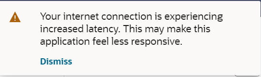

Use the toggle button to enable or disable latency measurement. Latency measurements depends on Latency Logging and so that must also be enabled, along with latency measurements.
Once this is enabled, users will see the following warning when their network latency exceeds certain thresholds.
Figure 14-24 Network Latency Warning

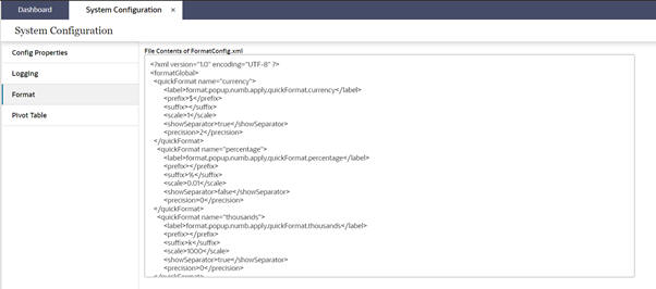

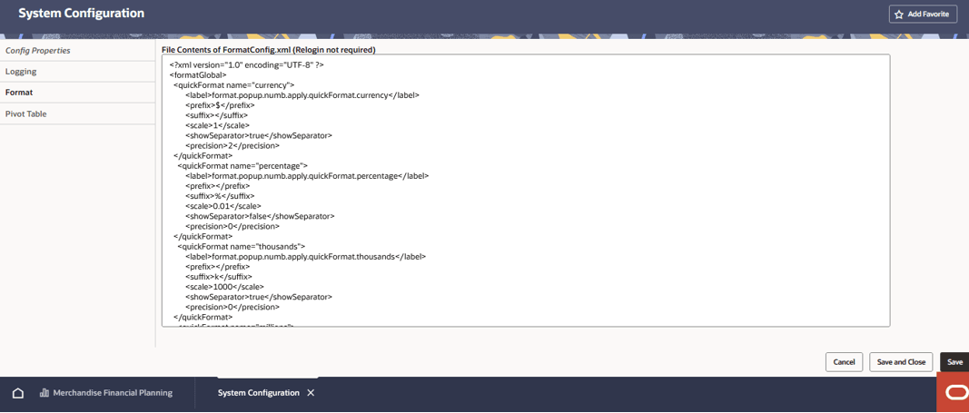

Format
Use this tab, shown in Figure 14-26, to change the FormatConfig.xml file, which controls the formatting properties for the application (that is, currency, percentage, and millions separator).
To save your changes, click Save or Save & Close.
To apply the saved changes, you must re-log into the application.
Figure 14-26 File Contents of FormatConfig.xml
Description of Figure 14-26 follows
Description of "Figure 14-26 File Contents of FormatConfig.xml"

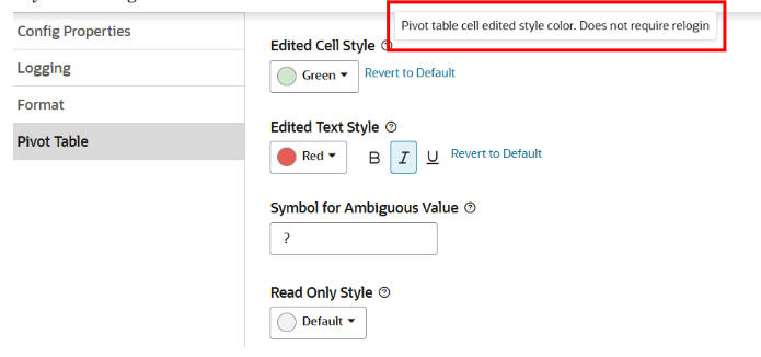

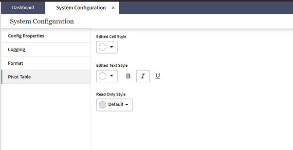

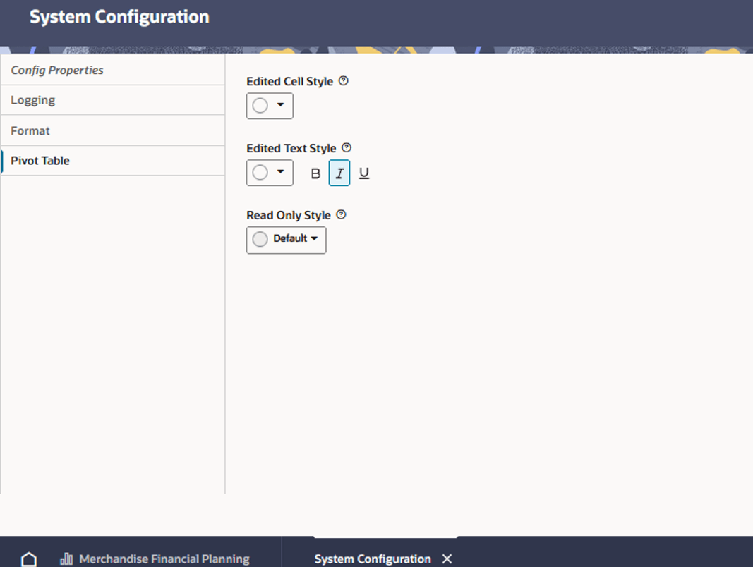

Pivot Table
Use this tab, shown in Figure 14-27, to change the format style of edited uncalculated cells. You can update the color of the edited cell background, edited cell text color, and style.
Note the following:
  • The system configuration can be edited only by one administration user at a time. If a second administration user tries to edit the configuration, the following message is displayed: "Configuration is currently being edited by <username>".
  • You cannot navigate to another tab if an error occurs on the current tab.
  • You cannot submit the page if errors occur until those errors are resolved.
  • The property not exposed through the Self-Service system will go through the regular service request process.
  • For more details about property files, refer to the sections of this chapter.

The Global Area Configuration page can be reached through the Settings menu (from Settings go to System Configuration then go to Global Area Configuration). The application name update is centrally managed within Retail Home, while the logo can be updated from this screen. After making changes, click Save or Save and Close to apply the updated logo. To revert to the default logo, remove the custom logo and click Save.
Downloading the Starter Kit
The Download Starter Kit option provides administrators with the capability to download the Configuration Tools starter kit for their applications. An administration user can access the Download Starter Kit menu from the Ask Oracle icon.
A dialog box is displayed that lists the available Configuration Tools starter kit versions specific to the application. Select the appropriate version and click OK. The started kit file will be downloaded to the user's system.

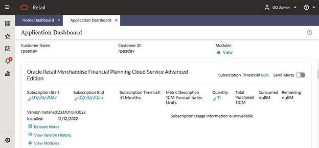

Monitoring Subscription Usage in Retail Home
All Oracle Retail cloud service subscriptions include a subscription metric that defines in some way the capacity of the systems provisioned as a part of the subscription. The actual metric varies across Oracle Retail cloud services.
For RPASCE applications, the subscription metric is tens of millions of annual sales in units, or 10M annual Sales Units, as it often appears.Users with administrative rights for Retail Home can view information on the quantity of units defined for their subscription and see information on actual usage over time for RPASCE application subscriptions (and any other Oracle Retail cloud service subscriptions) as well as for the AI Foundation component that is a part of every Oracle Retail cloud service subscription.This information is accessible on the Application Dashboard screen of Retail Home, shown in Figure 14-29.
Figure 14-29 Retail Home Application Dashboard
Description of Figure 14-29 follows
Description of "Figure 14-29 Retail Home Application Dashboard"
For more information on accessing the Application Dashboard, as well as information on the information presented on that screen, refer to the chapter "Application Dashboard" of the Oracle Retail Home Administration Guide.

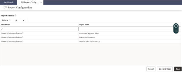

DV Report Configuration
An administrative user can use the DV Report Configuration page to configure Data Visualization (DV) Reports that are created in the Oracle Analytics DV Environment. The user can add, rename, and delete DV Reports. The user can access the DV Report Configuration feature from the Settings icon available at the bottom of the left sidebar menu, as shown in Figure 25.
Figure 14-30 DV Report Configuration
This image shows the dv report configuration
Indicators for Report Details provide a brief description of report path and report name properties. Log into the Oracle Analytics DV environment to obtain the report path and report name. DV Reports in the Oracle Analytics environment are stored with or without subdirectories under My Folders or Shared Folders as the parent directory. The report path for the Shared Folders starts with /shared and My Folders starts with /users.
Figure 14-31 DV Report Environment Path
This image shows the dv report environment path.
You can add and delete reports using either the + / x buttons or the Action menus..
Figure 14-32 DV Reports Adding and Deleting
This image shows adding and deleting functionality for dv reports.
Once you have configured your reports, click Save or Save & Close to save your changes. Note that, o apply the saved changes, you must re-log into the application.
Images and Contextual Help
Valid Hosts: Users can specify a web URL as the source of an image(s) (typically the content management server) or source for contextual help. Due to security reasons, the RPASCE client will only use images or contextual help links from these configured hosts. Users are only allowed to enter URLs from the hosts defined by this setting in System Configuration.
The dimension for which the images are to be displayed must have a dimension attribute measure registered of type string that has the UI Type property set to media. For example, consider that the name of the dimension attribute measure is addvskupimgt for dimension skup. The measure must beloaded into PDS using Load Fact Data.
Each record in the input file is a position ID followed by the image URL wrapped in the <image> tag. The example input file below is in the .csv format and hence named addvskupimgt.csv.ovr.
70063172,"<image id=""main"" label=""Front""><url
size=""thumb"">http://127.0.0.1:7001/contentserver/imgfetch/1000396_Front_full.jpg</url></image>"
73137693,"<image id=""main"" label=""Front""><url
size=""thumb"">http://127.0.0.1:7001/contentserver/imgfetch/CardiganLS.jpg</url></image>"
96880516,"<image id=""main"" label=""Front""><url
size=""thumb"">http://127.0.0.1:7001/contentserver/imgfetch/1000399_Front_full.jpg
88805005,http://127.0.0.1:7001/contentserver/imgfetch/1000378_Front_full.jpg
72939751,http://127.0.0.1:7001/contentserver/imgfetch/1000439_Front_full.jpg
96666402,http://127.0.0.1:7001/contentserver/imgfetch/1000440_Back_full.jpg
The use of the double quotes in the lines above is the standard way of escaping double quotes in any RPASCE measure's csv input files.
Configuration Settings Not Requiring Relogging
The following configuration settings do not require relogging.
Logging Log Level
Enable Performance Measurement
Format File Contents of FormatConfig.xml
Pivot Table Edited Cell Style
Edited Text Style
Read Only Style
Admin Task Status Admin Log Limit
Admin Task Start From
Live Log Block Size
Examples:
Figure 14-33 Latency Logging
This image shows latency logging.
