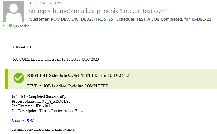

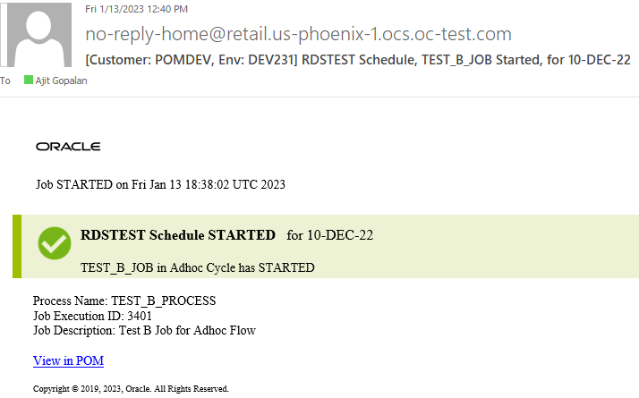

| Start of Job | JobStarted Created when a Job starts. See Job Start Email below. | Job | All |
| Completion of Job | JobCompleted Created when a Job completes successfully. See Job Completion Email below. | Job | All |

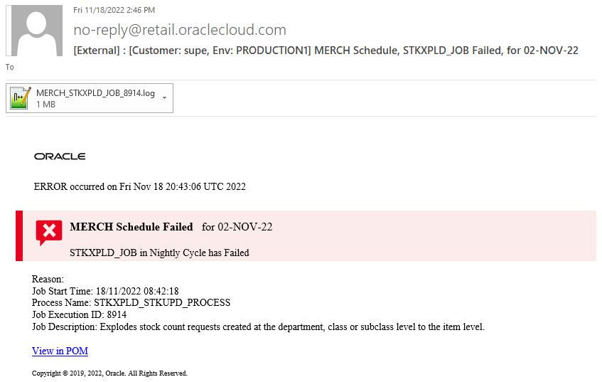

| Job Execution failure | ErrorNotification Created when a running Job fails. This notification is for Oracle internal use. See Job Error Email below. | Schedule | Oracle Internal |
| Job Execution failure | ErrorNotificationExternal Created when a running Job fails. This notification is for customers use. See Job Error Email below. | Schedule | Customers / System Integrators |

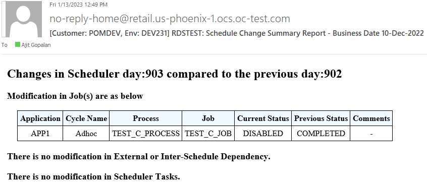

Schedule Change Summary Email
This summary is generated as part of the Scheduler Day creation process. It highlights any differences between the configuration of the previous Scheduler Day and the current. It also highlights differences in scheduling between the Schedule instances. This email has no attachments.

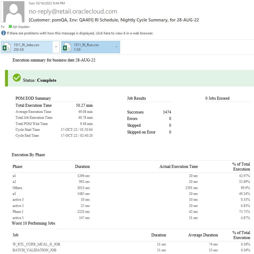

Nightly Summary Email
At the end of the Nightly Cycle, a summary report is created that is sent as an email. This report is sent to email addresses, configured for the NightlySummaryReportExternal and NightlySummaryReport Notification Types. The former Notification Type is meant to be subscribed by Customers, while the latter is for Oracle Internal.
This email also contains two attachments. One is a summarized report (CSV) of all the Job executions of that Nightly cycle. The other attachment contains a summarized report of the Nightly cycle completion times for the last 15 days. The latter attachment is only available to email recipients of the NightlySummaryReport Notification Type.

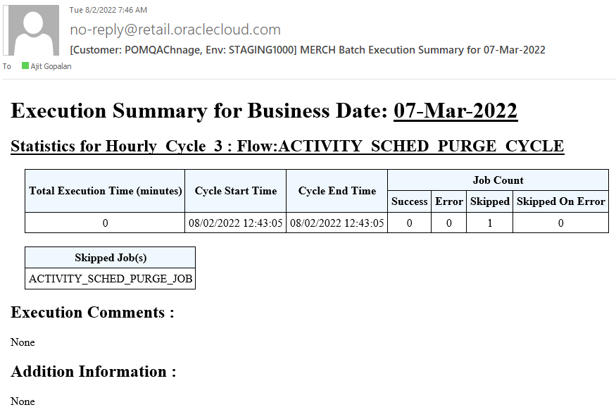

Hourly Flow Summary Email
This email is generated when a Flow on the Hourly Cycle completes successfully. It is sent to the email addresses that subscribed to the Notification Type – IntradayCycleSummaryReport.
Job Error Email
When a Job fails during execution, a Job Error email is sent. This email will include as an attachment the log file of
the failed Job execution. This email will be generated, even if the skip-on-error flag is set on the Job.
The Job Error email sent to email addresses configured on the ErrorNotification type, will contain the log file attachment, while the email sent to email addresses configured on the ErrorNotificationExternal type will not contain this attachment.
